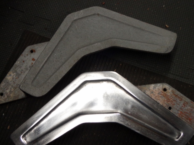

Aluminum Polsih Tips:
Scotch Brite Pads
Maroon
Then Gray
Then White
Next NuVite Polish
#5
Then #7
Finally White Diamond Metal Polish to seal.
This is the only way to go

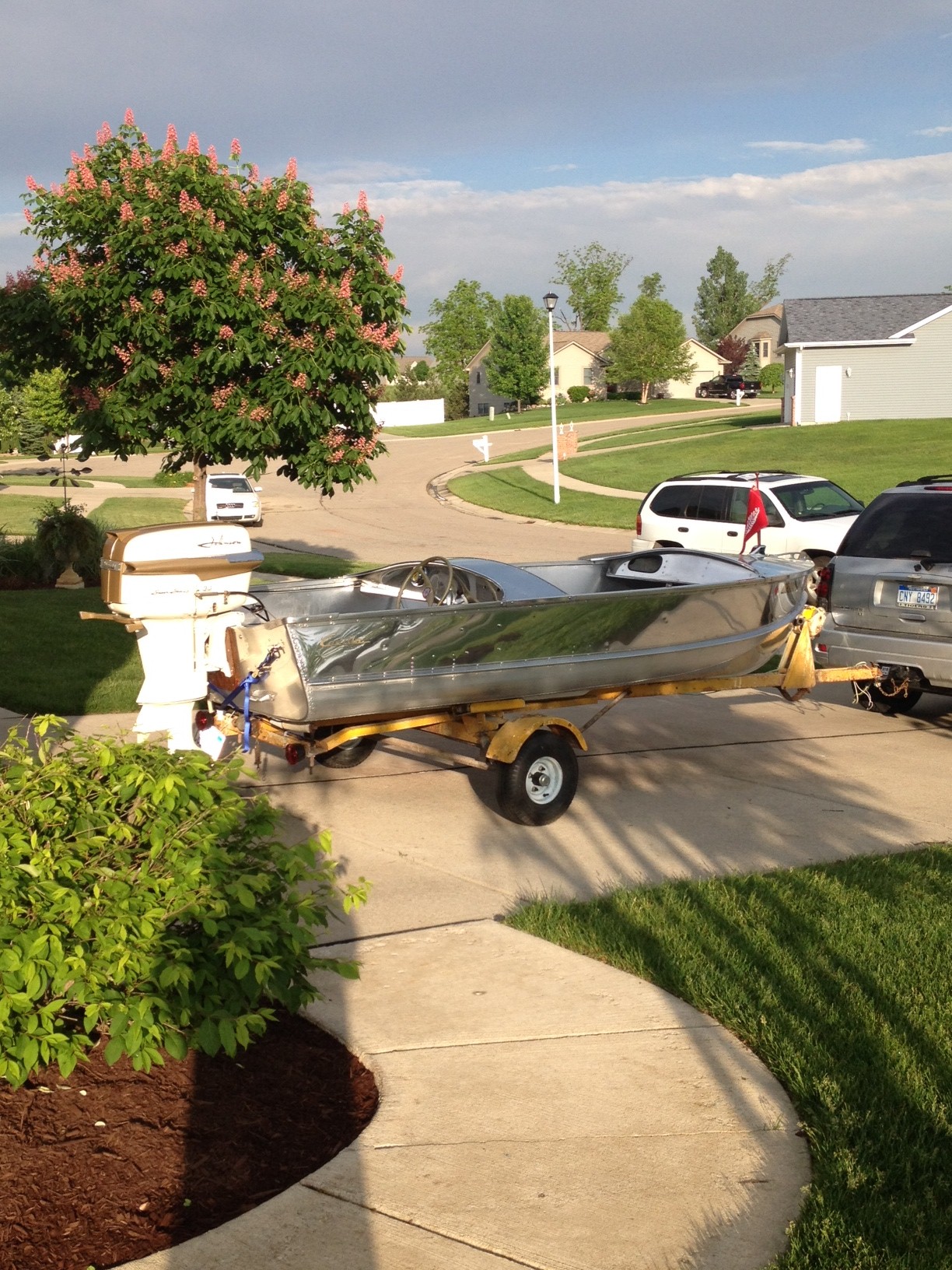

Before and after shots.
Regards,
StevieB

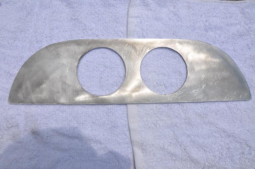

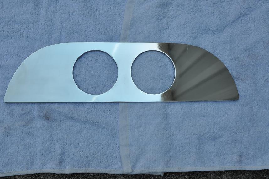

Here are some BEFORE and AFTER photos of a billet aluminum dash backing plate for our G-3 I polished with the "Mothers Billet Aluminum Polish":
BEFORE:
[img] AFTER: [img]http://www.fiberglassics.com/media/kunena/attachments/legacy/images/DSC_0609-20140625.JPG

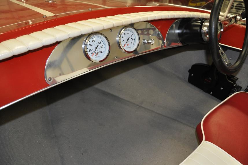

Here is what it looked like once we installed it in our 1960 G-3 and got the new "Mercury Marine" Gauges in:
