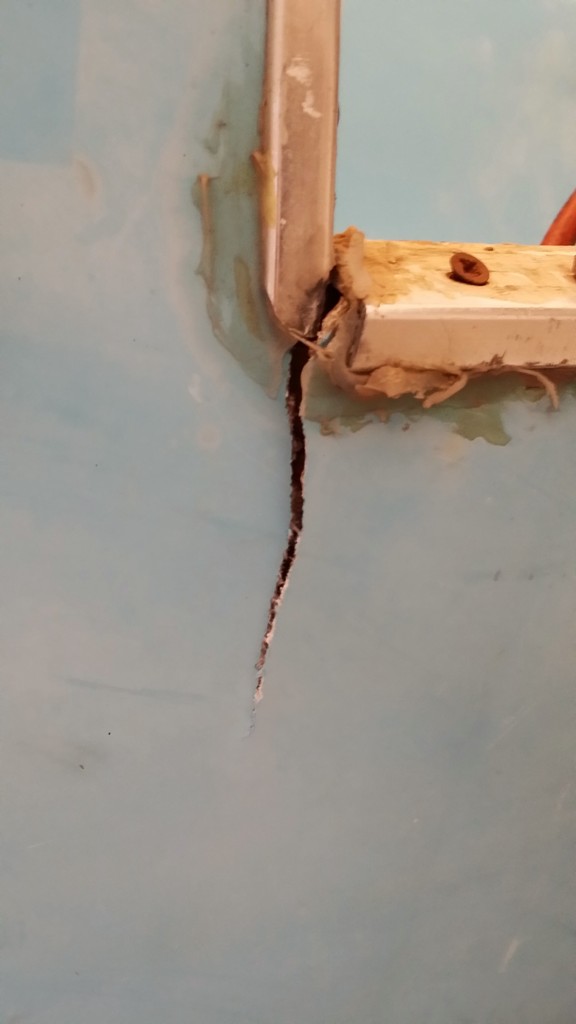

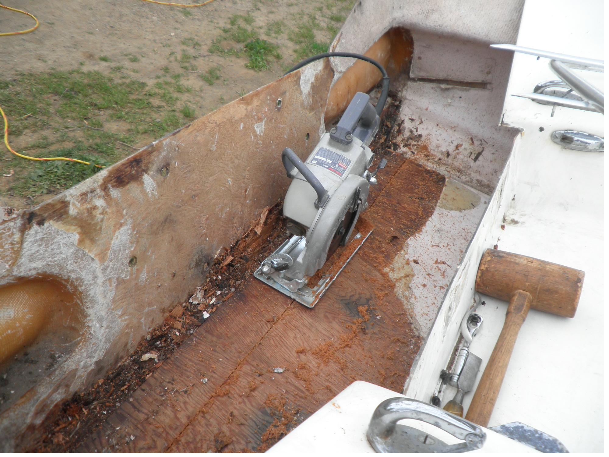

As mentioned in a previous post, on inspecting the transom I've found a rather severe crack. Additionally, some moron ripped out one of the seats and left the holes open to the elements for the 4 years the Belmont sat in a field. So lets assume (and I would gladly consider advice that I'm wrong on this) the whole transom is shot. Where do I start the demolition process? I've tried looking at the transom rebuilding link but the pics are all gone.

Re:Um, Where do I start cutting? 12 years 3 months ago #96050
Yup Joe that's how I would do it from the inside.
When I replace a transome i start by cutting just enough of the "splash well" out so I have room to get new wood in and have room to work. Then i cut down the sides and across then floor to get the inside fiberglass out and then the "fun" task of getting stubborn pltywood out! That's usually very time consuming! Lots of luck to you zoom! Matt

Re:Um, Where do I start cutting? 12 years 3 months ago #96062
  • morris
  • morris's Avatar
  • Posts: 393
  • Karma: 38
Joe and matty are correct. This repair would be best working from the inside. First determine the height of the transom from the inside. Some transoms go above where the deck and gunwales mount and some do not. Some motor splash wells are molded in other are removable. This is important because you may need to raise the deck or remove it completely. If you don't need to remove the deck, COOL. Use a multi tool to remove the inner skin of the transom. Cut the skin about 1/2 inch from the sides, DO NOT CUT THE SIDES OF THE HULL!, cut only the inner transom skin. This will expose the transom's wood. Please be careful not to damage the out skin of the transom. The crack you have is a fairly simple repair. Please keep us posted on what you find.

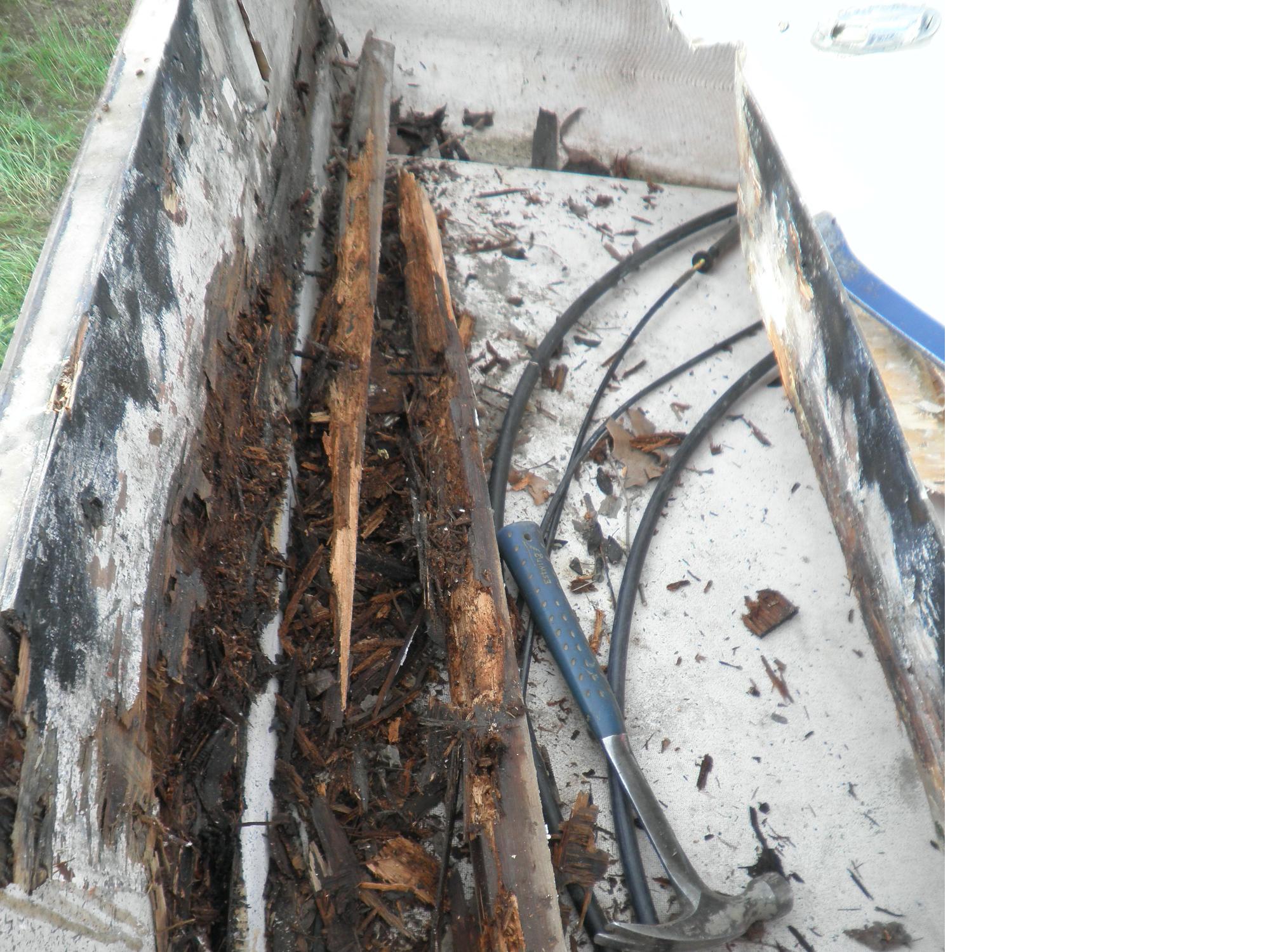

Re:Um, Where do I start cutting? 12 years 3 months ago #96074
Zoomnbyu,
Welcome to the world of rotted boats. I've owned more rotted boats than I can remember - so here is my take on your question:
It is likely that your boat has more problems than just the transom. More often than not, the stringers under the floor are rotted as well. Taking on a project like this a lot of work, usually costs more than you think it will, and takes more time than you thought it would to complete. Because of these factors, ask yourself if this particular boat is truly worth it to YOU to go through the time, work, and cost to fix it. Seriously think about it. If the answer is "yes" , then you have some choices on how to go about dissecting the boat to assess what the repair needs are.
The back skin of the hull can be cut around the perimeter and peeled off to expose the plywood core (or what's left of it) I personally wouldn't do it this way, as it creates a lot of work and will severely weaken the structure of the boat, unless replaced correctly.
The rear couple feet of the deck and splashwell can be excised from the boat to give access to the area. Again, there will be a lot of work to graft this section back onto the rest of the boat after repairs are completed.
You can remove the entire top deck off of the hull. This sounds like a lot of work, and it pretty much is. However, removal of the deck will allow complete access to all parts of the hull. It isn't nearly as bad as it sounds, and having the hull opened up will make work far easier. Best of all, the deck can be put back on the hull the same way it came off. The other methods will require lots of glassing and skill to put back correctly.
