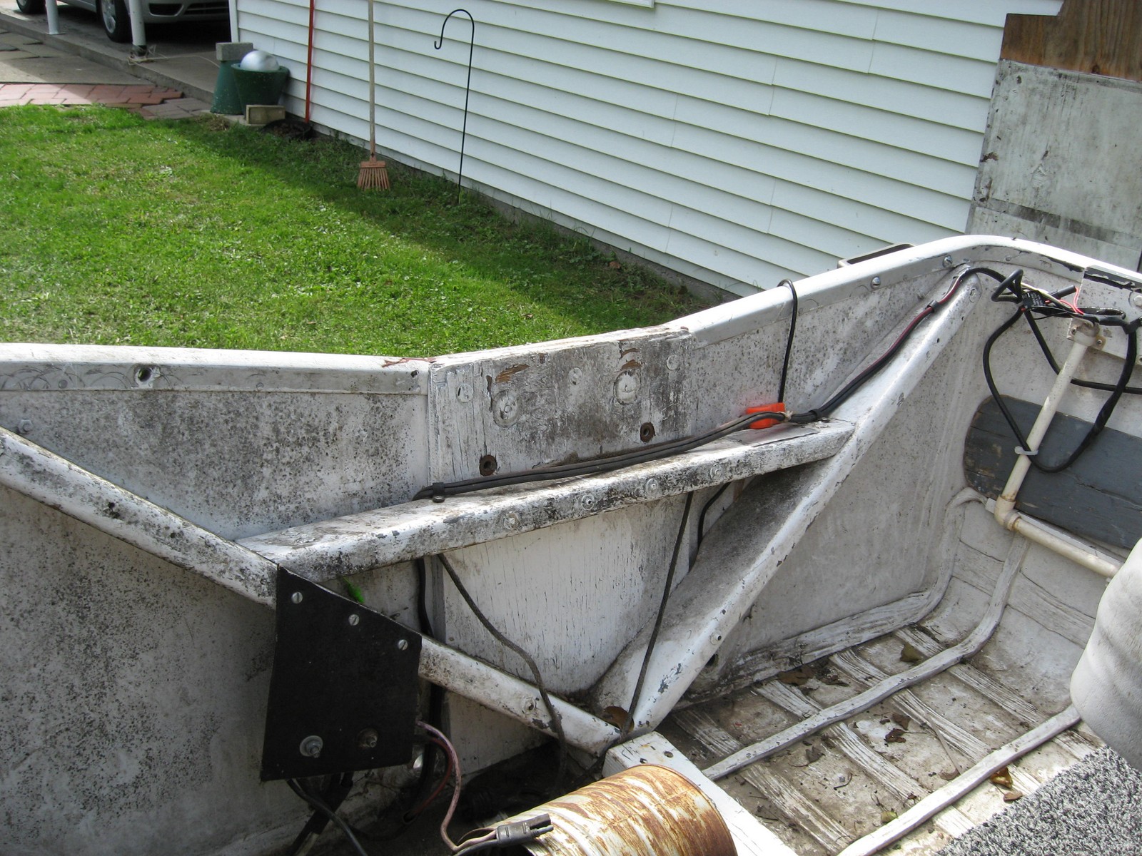

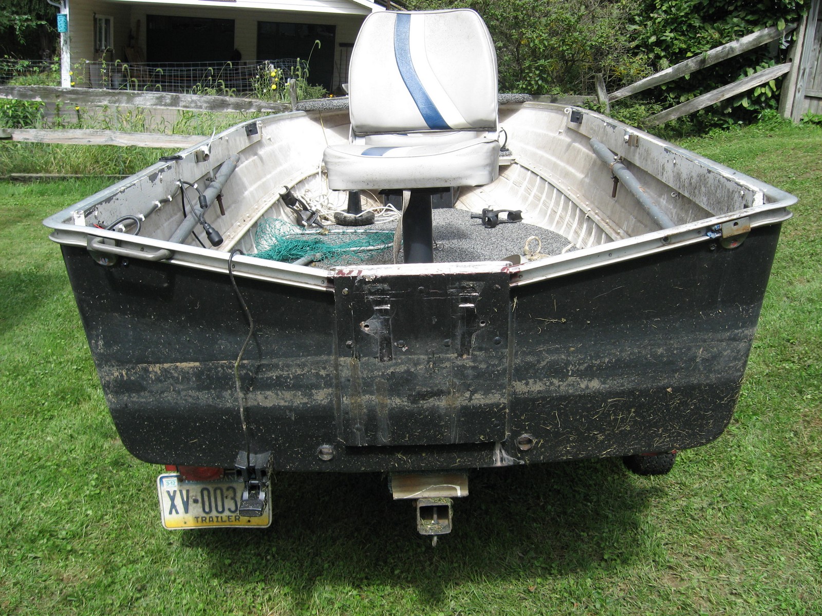

I found the two plug set-up,in my Leavens as well.
The usual main drain was in the little well at the transom, but as water and crud ran out, a smaller 2nd plug revealed itself in the port side of the little well.Not really visible in the pic.
Upon removing this 2nd plug, water continued to drian from the cavity between the hull & floor for quite some time. Hmmmmm seems like a good idea to me.
Haven't started to open up the floor yet, but I'm expecting lots water logged foam in there?
