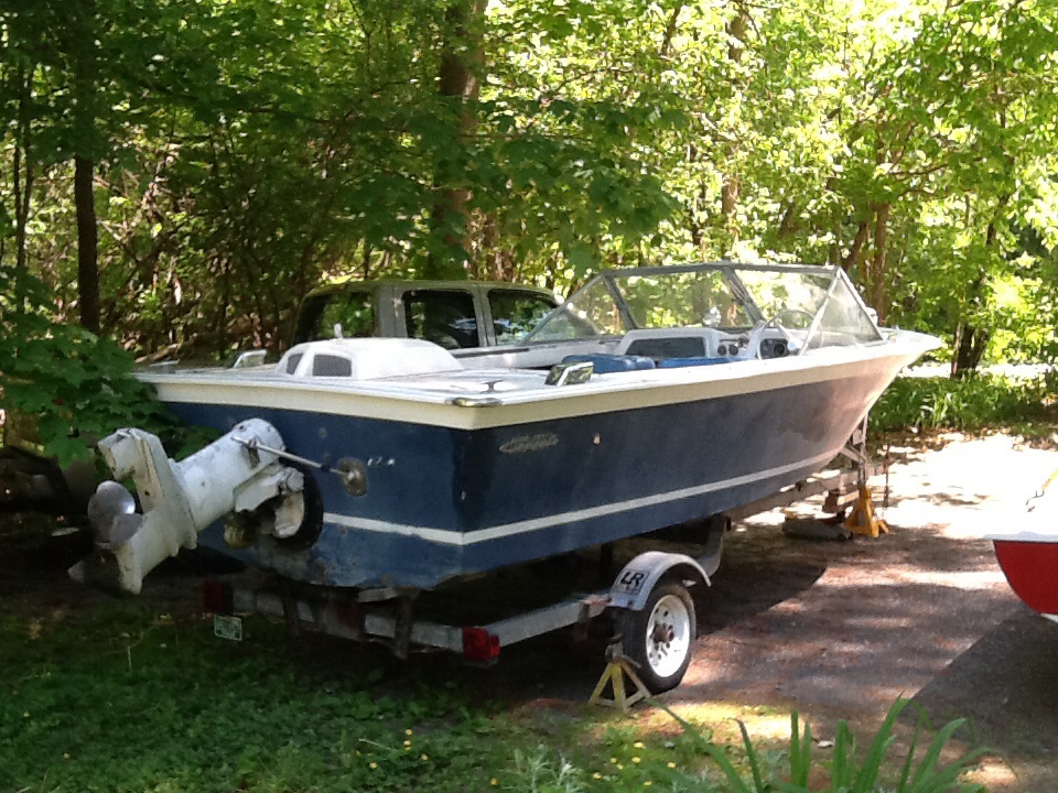

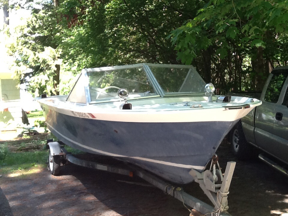

Hello,
I have found what will turn out to be a large project. The fine gent I acquired it from thought it might be a 1968, I found an old registration that has it at 1967 but the hull number orez 2170235 N I believe is for a 1966.
It has a v6 that I can not find a number on but I believe it may be a Buick? Dauntless? The out drive is an OMC.
I have gleaned some information on a few other websites but really don't know much about her just yet. Any information in regards to this vessel is most appreciated.
Best,
Brett

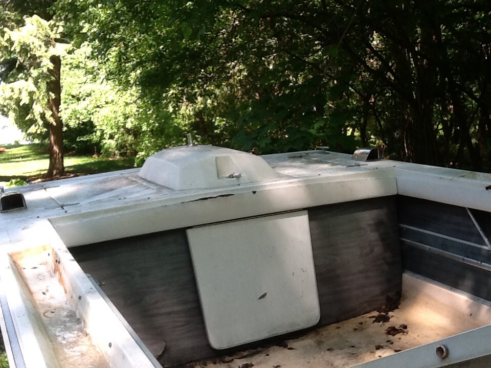

Re:Chris Craft corsair 12 years 2 months ago #95617

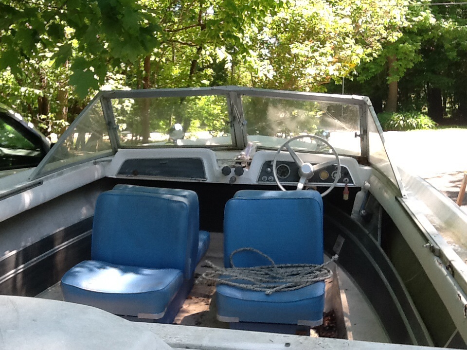

Another view
Re:Chris Craft corsair 12 years 2 months ago #95618
Another view

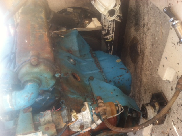

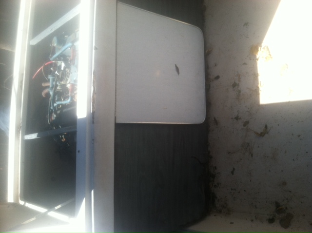

Re:Chris Craft corsair 12 years 2 months ago #95620
Can we post more than one picture at a time?
Re:Chris Craft corsair 12 years 2 months ago #95621
Fold up table to access engine from front. V6 of some type, haven't found markings yet. Yes I have tried ;)

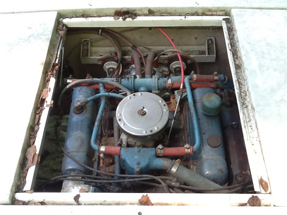

Re:Chris Craft corsair 12 years 2 months ago #95622
One more piece of eye candy

Welcome to the site. Look for a tag on the motor. The little Buicks were 14 series motors. I have a 66 Buick out of an old Grady White. Electric shifting outdriveers.
hhscott.com/evinrude/omc_stringer.htm
Have fun
Al

yessir I can verify that your boat is a 1966 OREZ-17-001 to OREZ-17-250 are 1966, engine options were chris craft 225B, Mercury 120, or Eaton 140.
length 17-9"
Beam 7'-5"
weight 1540 lbs
fuel 21 us gallons
Re:Chris Craft corsair 12 years 2 months ago #95654
  • Shake
  • Shake's Avatar
  • Posts: 983
  • Karma: 29
and it looks like you have the chris craft 225 engine option in yours, as Brunswick owned both chris craft and omc at the time your boat was built, I do believe....

Welcome aboard. Nice boat! I have a 1966 Chris-Craft Corsair Sport V outboard 17 1/2' ! If you search on the forum I am certain you will find some previous discussions and photos of my boat.
These boats were made at Cortland, NY by Thompson Boat Company of New York, Inc. - a wholly owned subsidiary of Chris-Craft. There should be a builder's plate near the helm, attached to the vertical portion of the wood grain cockpit liner thingy.
Brunswick never owned Chris-Craft or OMC. Brunswick owns Mercury, the builders of Mercury outboards and MerCruiser stern drives.
Andreas

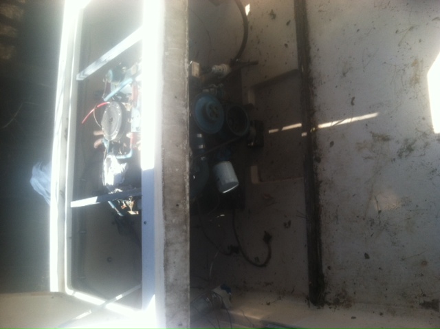

I pulled the boat up from her winter rest and started to see what I have to do to get her going. I have found an outdrive that may work for parts on the lower end.
I started by removing engine masking and table from in front of the engine bay
before
after
Lots of room to get around :)
Not sure why my photos are turned 90* ?

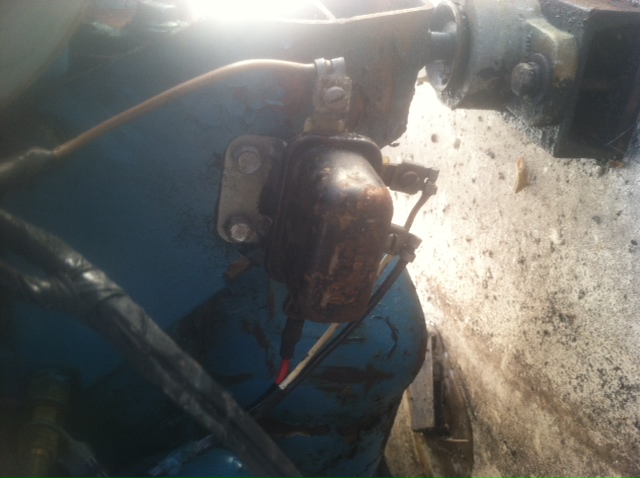

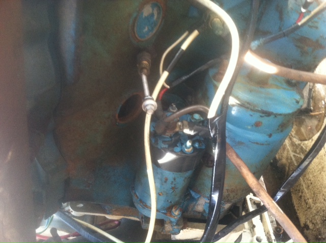

I tried to turn my photos 90* on my end but no go. Oh well, at any rate at least there was progress today. I discovered that the starter is done for. Pulled her out and found bits of acorn and grassy stuff. I'm also missing two freeze out plugs and Im hoping that was done on purpose. I'm also concerned the same critter didn't build a nest inside the block.
One of my exhaust manifolds has a definite crack and both of them have been repaired before,
As a side note. I learned my phone is better than a mirror for finding the hidden starter bolt where I couldn't stick my head. I turned the viewing lens backwards (as if you were to "selfie") and stuck it where my head couldn't go (the 6" between the deck and engine block) and sure enough I can see under the blue beauty right on my screen.
Is this a neutral safety switch?
