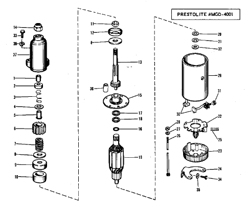

Welcome aboard JS, glad to have you join us! Does your starter have the part number stamped into it, like maybe MGD4001?

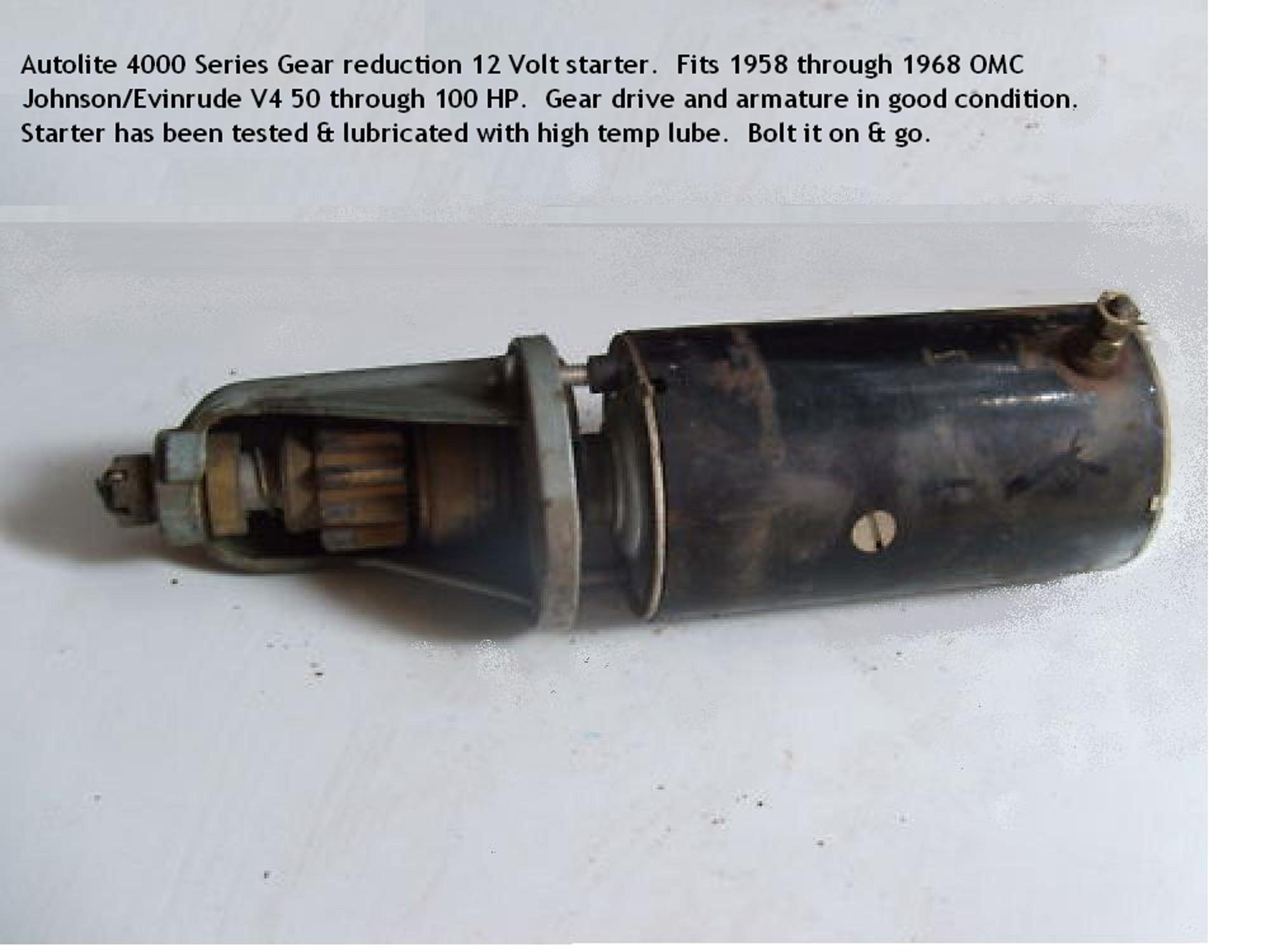

Here you go JS. Should work.I think the v-4s with electric shift took the same starter and bendix from 62 to 68. I know some were Delco-Remy,some were Autolite,but they all should bolt up.

The ebay item id given is invalid, no result has been sentThe ebay item id given is invalid, no result has been sentHere's a couple of eBay queries with results that might help you find the parts you need:
Just be sure to check the parts # at www.marineengine.com (as previously mentioned).
www.marineengine.com/parts/johnson-evinrude-parts.php
BTW, be sure to check out the bronze bushing that's pressed into the starter bracket which is part of the block.
If that bushing is worn, it'll cause problems with the starter operation and can even lead to stripped drive teeth, such as what happened to your motor.
