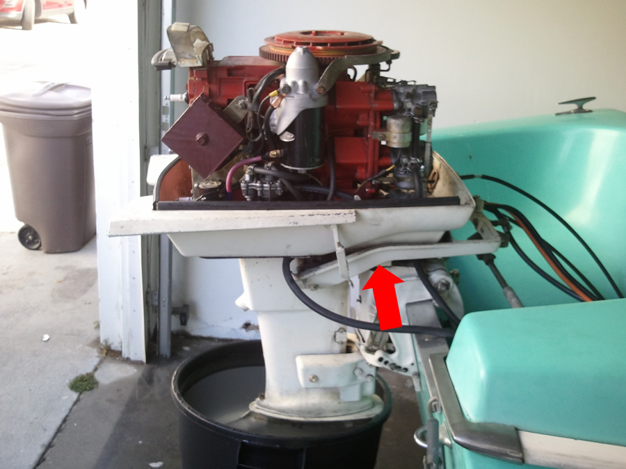

Here's my new self-created drama (Rookie mistake 2?). I changed the lower oil and I over-filled it. After the oil change When I fired the motor I had quite a bit of exhaust smoke coming out of the top of the leg. (Just below where the powerhead bolts on.) I redrained the lower unit and refilled to make sure I had the proper amount of oil, I guessing I had 4-6 oz more than spec.
So I'm wondering. Do you think the smoke is from blow by oil from the lower? I recently replaced the lower powerhead seal. But I wasn't getting smoke until I did the lower oil change.
If it is from the lower, do you think the smoke will burn off and what seals should I check to see if I blew them out?

I'm not familiar with the Scotts, but based on where you are indicating the smoke is coming from I suspect it is typical 2 stroke exhaust smoke that is unable to go out the underwater exhaust port due to back pressure created by the barrel of water - and the exhaust smoke is sneaking out around the top front mounts' seals that connect the driveshaft housing to the transom mount.
This is a common thing to experience on older Mercs that develop gaps between these mount points and the related seals that dry out.
I'll bet that if you are able to run the beast on a set of muffs and a garden hose the below water exhaust port would have the same smoke.

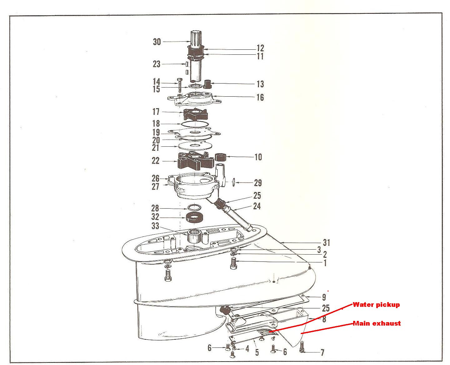

It's hard to believe that you have overfilled the lower unit to the point the gear lube would get into the exhaust chamber, and if it did, and it got hot enough, it should smoke out of the auxiliary exhaust tube below the power head.
As the good doctor stated, running in a barrel could push water up high enough to cause enough back pressure to seal off the bottom exhaust, and force it out somewhere else, but in the case of a Scott, is has a special idle system chamber in the leg that allows exhaust and water to be expelled from the auxiliary exhaust when the water level gets too high in the leg. This usually happens at the dock when the boat is heavily loaded.
There are only two ways gear lube could get into the exhaust chamber that I am aware of. One is up through the driveshaft cavity and that is blocked by a lip seal number 32 in the parts diagram. Number 28 is the lower water pump seal and 33 is a bearing.
The second way is up through the shift rod. but there are O rings to prevent that from happening. It's possible that the lip seal is in upside down.
Still,to get the gear lube to go through the seal you would have to have a lot of gear lube in the lower unit to get it to go that high.
Is there exhaust and water coming out of the auxiliary exhaust? It sounds more like the auxiliary is plugged.
If, and it's a big if, if you were to have gotten gear lube in the auxiliary idle chamber itself the viscosity of the gear lube might be causing too much back pressure and the exhaust is finding another way out.
Check the auxiliary and if it's OK try running with less water in the barrel, but be careful to keep the pick-up covered. Running a Scott with muffs isn't easy. The pick-up is a rectangular screen facing down and it takes a some work to come up with a way of forcing water into the pick-up.
