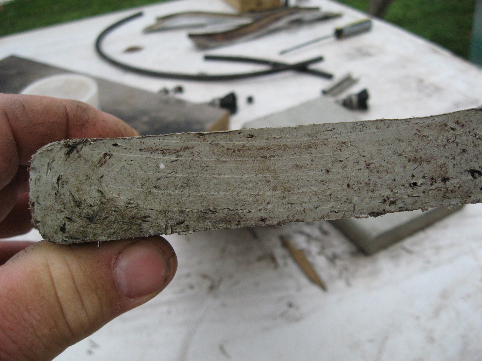

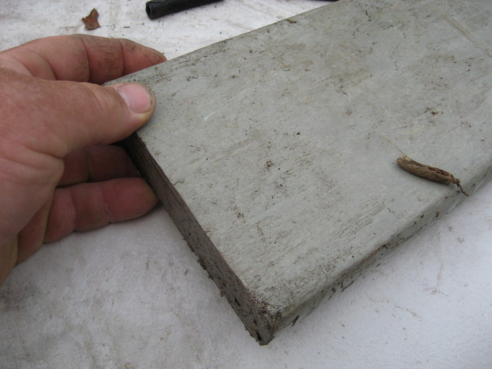

I have been contemplating using composite deck boards to replace 1"x Stringers in my Dorsetts. I would completely encapsulate them in fiberglass. Any thoughts?

I used to be a custom deck builder here on the lake. I used treated 5/4 x 6 lumber exclusively. The reason for that is that decks that had been build a few years before using the composite decking, commonly referred to in the industry as "Trex," had real problems. Even screwed-down 16" on center, the planks sagged between joists making the deck look like a roller coaster.
Stringers are the main structural component of your decking; they support everything. On an inboard boat, that includes about 1,000 lbs of engine and transmission. I wouldn't consider using a product that has proven to sag after a few years.
I use white oak or mahogany for stringers...one long 1-1/2" piece, stern to bow. I'm not sure if "Trex" comes in 1-1/2" pieces but even if it did, I wouldn't use it. All things considered, after the project is finished, the cost between oak and "Trex" is not enough money to be concerned about.
Sure it might work...for awhile or maybe for a long while but the uncertainty is enough to make me reject the idea. I restrict my gambling to the "sure thing."

Thank you Nautilus and Hornet, very great insight. Composite decking now officially out of the equation.
Re:restorer's thoughts?? 11 years 1 month ago #94317
Another reason not to use it resin probably wont stick to it .
Re:restorer's thoughts?? 11 years 1 month ago #94321
That is what I was going to say. I thought about replaceing some of my original wood with it. After looking at some samples of cut off ends I decided they would be to slippery for that purpose. :unsure:
