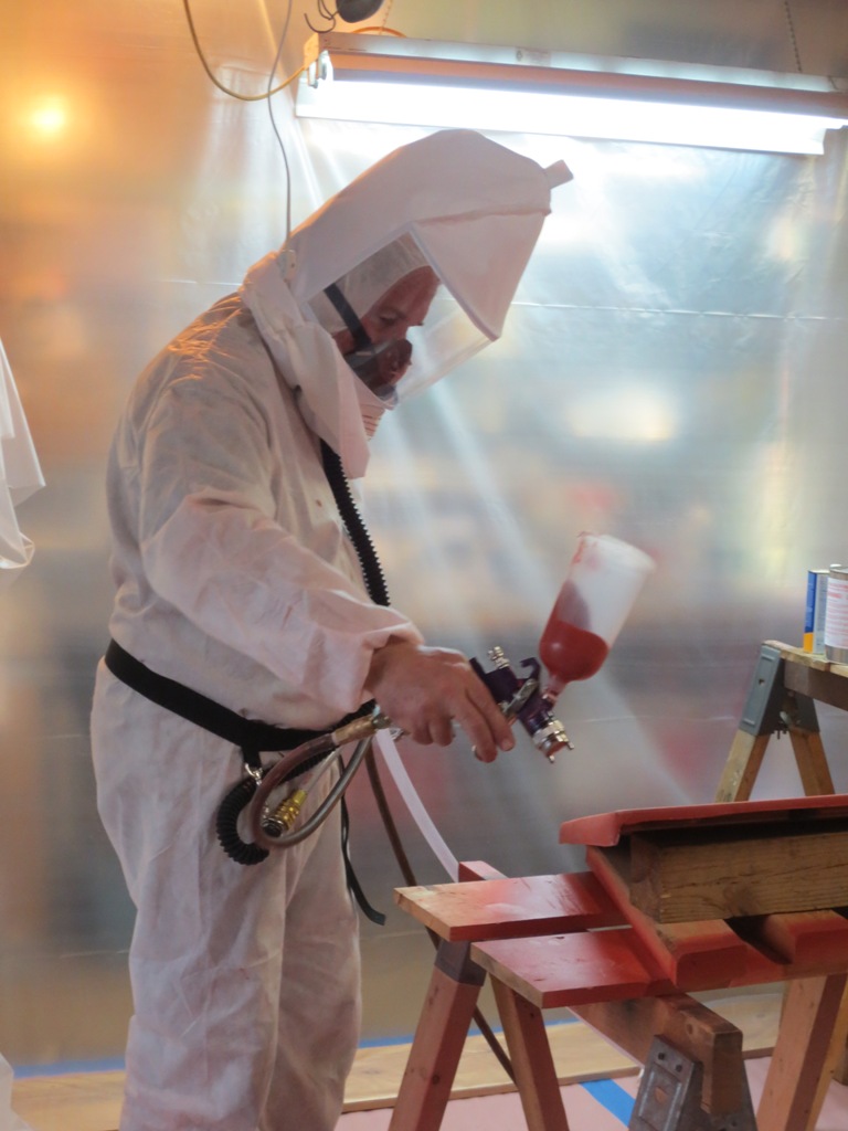

I invested in this setup when I did gelcoat and Zolatone last year. It is literally a breath of fresh air when spraying.
You can them find cheaper online rather than buying direct from axispro.
axispro.net/?categoryID=2/
I have heard of guys putting them together using a bilge pump for the blower.
