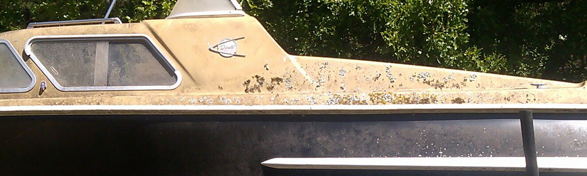

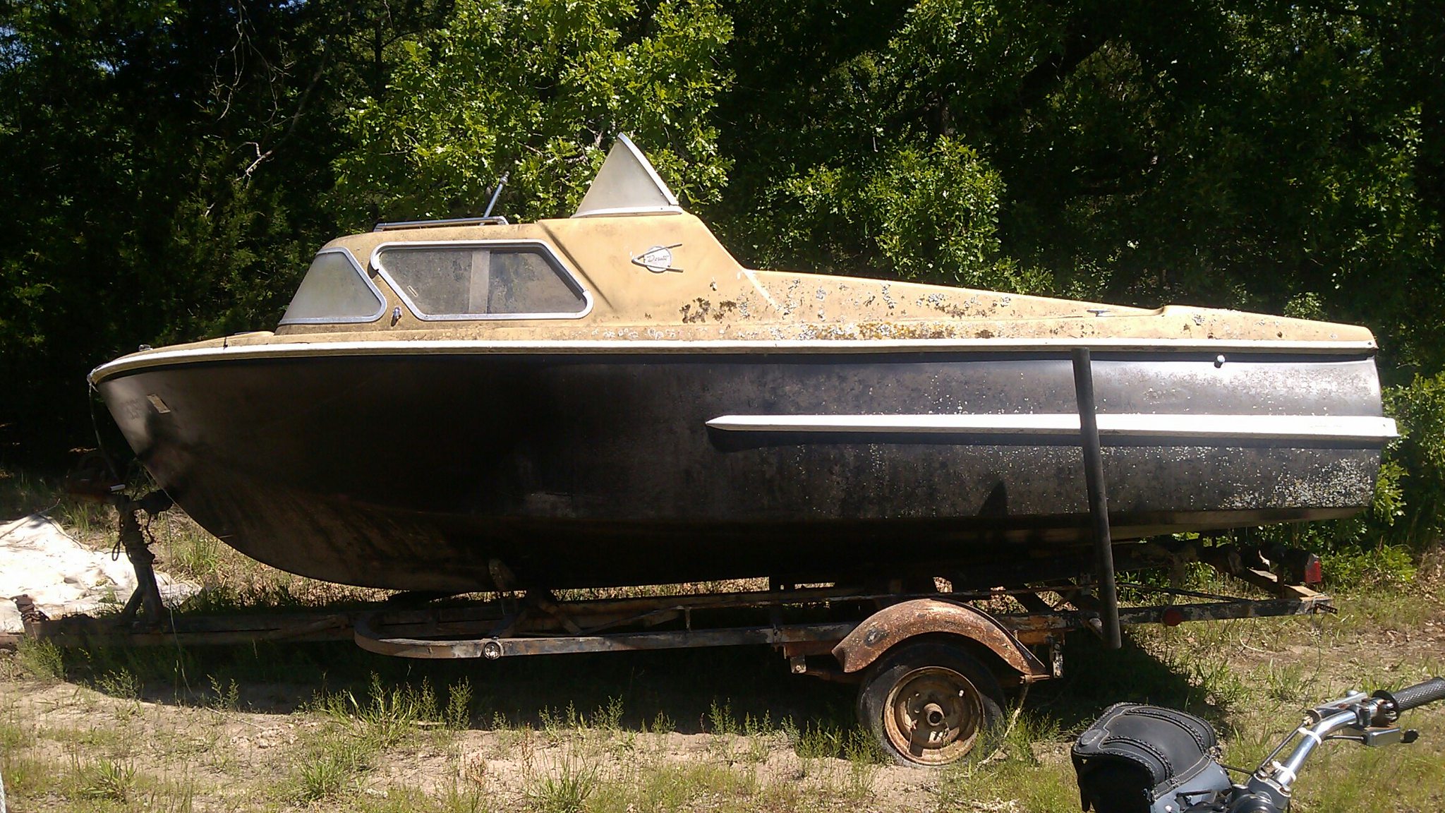

Found this catalina.1963 , I think? Need help deciding if its too far gone. The top cap deterioration worries me. Is it a matter of sanding and reglassing? Opinions?

closer..

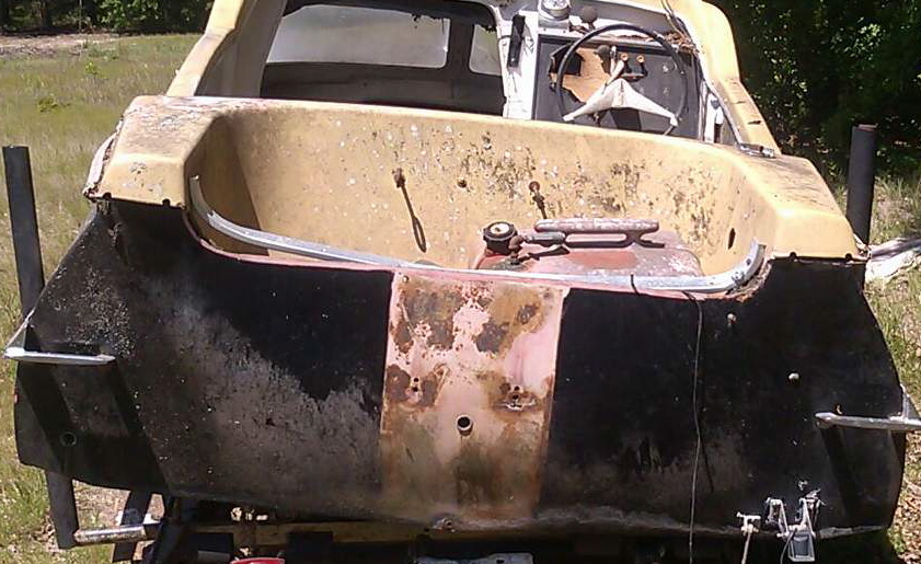

the back end looks pretty bad also. I can handle the rotten inside, but not sure about this exterior work..

Nice looking cruiser. A big project for sure. What I've leaned is, if you want a boat to use on the water in the near future, go for a used one that's ready to go now and expect some little glitches. If you want a long term project that will be a head turner in a year (or 5) then dig in and start on the Dorsett, one small task at a time. :) Lots of good help and advice here on the forum.

Welcome aboard crash11, You say the top cap is deteriorated, what does that exactly mean? Is the gel coat crazed (cracking), chipped, or just ruff like sandpaper? I see a lot of lichens growing on the boat, those can be washed and sanded off, and you would be amazed at how you can bring gel coat back to a shin from a dull finish.

looks like she has a lot going for her....if that's what you want...do it....if you want something less labor intensive pass...looks like a good start to me...john

hmm, Looks better than mine did when I got it, and what is it with these catalina's sitting tilt on their trailers like this, this is the third cat I've seen like this, mine being one of them... I say go for it. Good luck

No boat is ever too far gone if you REALLY want to put it back together. That said. If it is your first boat and you want it in the water next month then run away. Expect that every bit of wood is rotten. Someone who knows boats can tell you how bad it really is. Stringers and transom replacement are not overly complicated but cost time and money. I got my Catalina then found out it had a cored floor. That was a surprise that cost a lot more time and money than I had expected. Less than 1 square foot of the core was not mush. I don't regret it at all however. The journey has been fun. BUT. I have another boat to go out and play on. If you want to make money on fixing and selling it, run away. It is a labor of love.

by the way, do you have some pictures of the interior? mine had an insert that made the floor seem like it was not rotten. it also added to the difficulty of getting at the transom and stingers. i can help with the pros and cons of the way I did mine.
