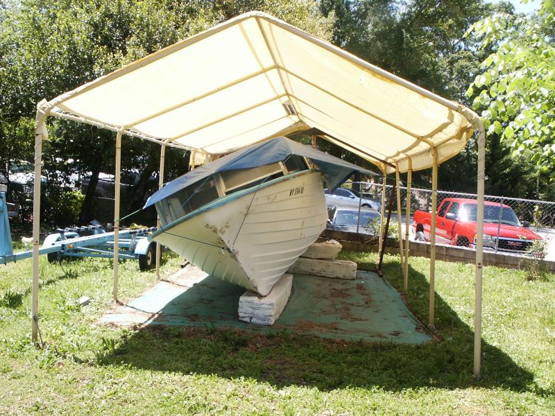

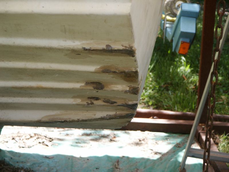

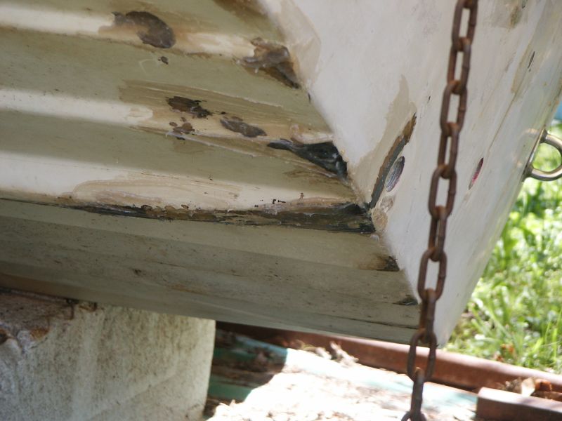

i have started on the hull now. getting ready to start panting the interior and i want to start filling the holes. no need to take short cuts now. i am using a combination of silica and resin to make a paste .. grinding out the spots with a stone on a dremel .... then filling and sanding back down. i thought about applying a coat of gelcoat back to blend in, and then primer and paint. but all in all it is good weather now. change the resin mix and sand sand sand ... i appreciate all the help and i hope i wont let anybody down.
