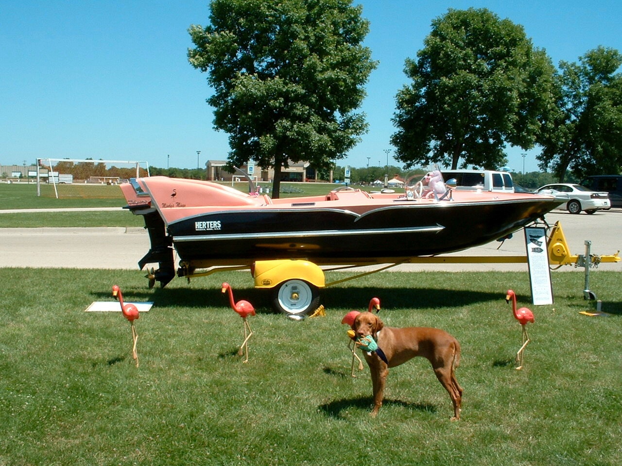

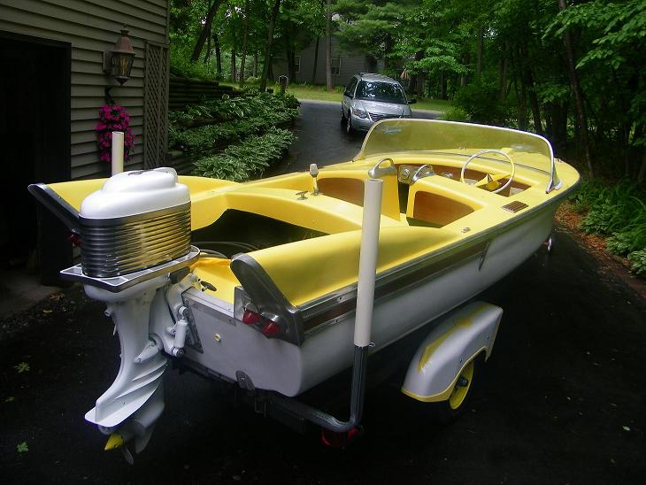

First pic is a 59
Second pic is Bryan Fenwicks Mindys Mingo
D

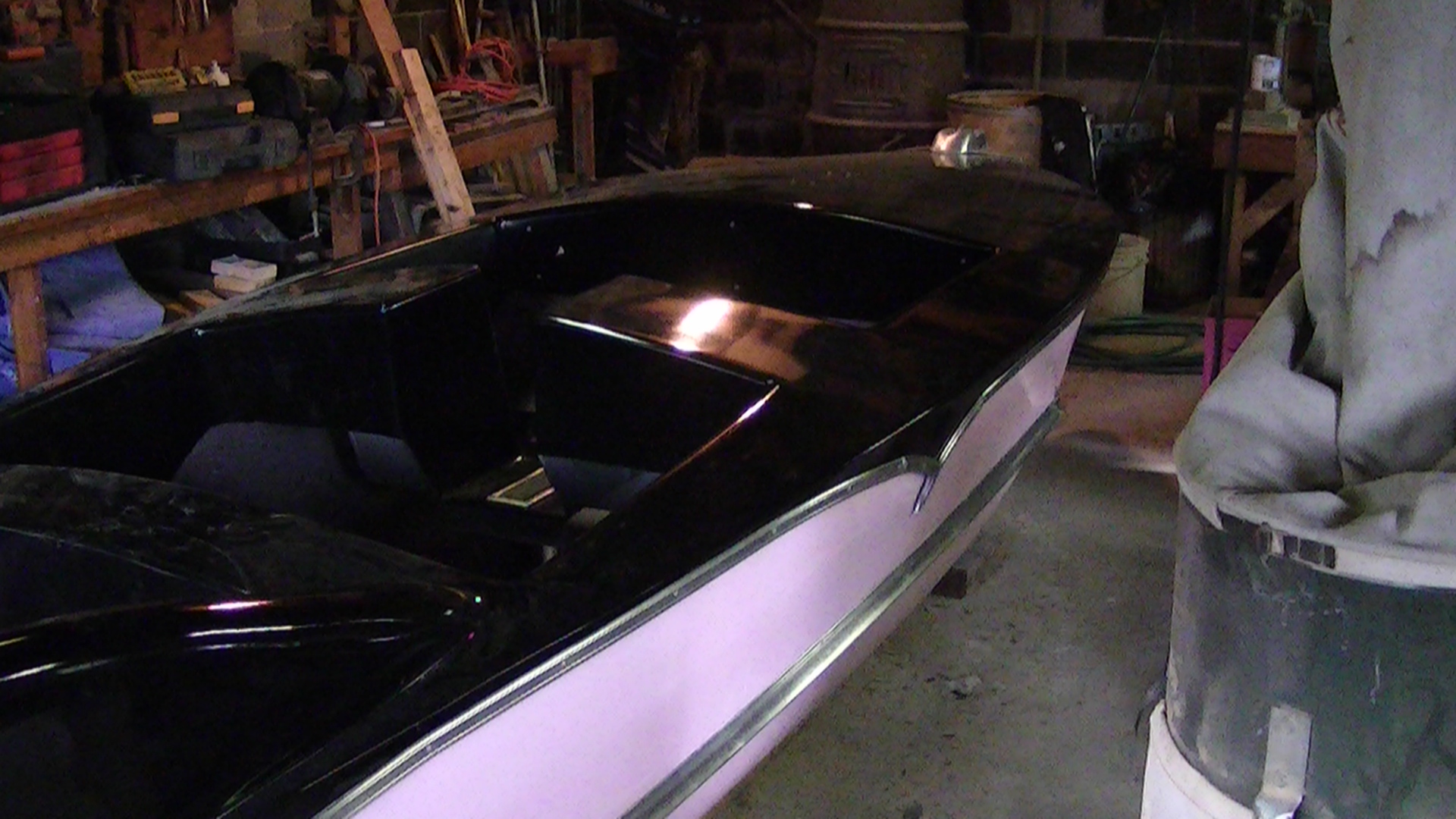

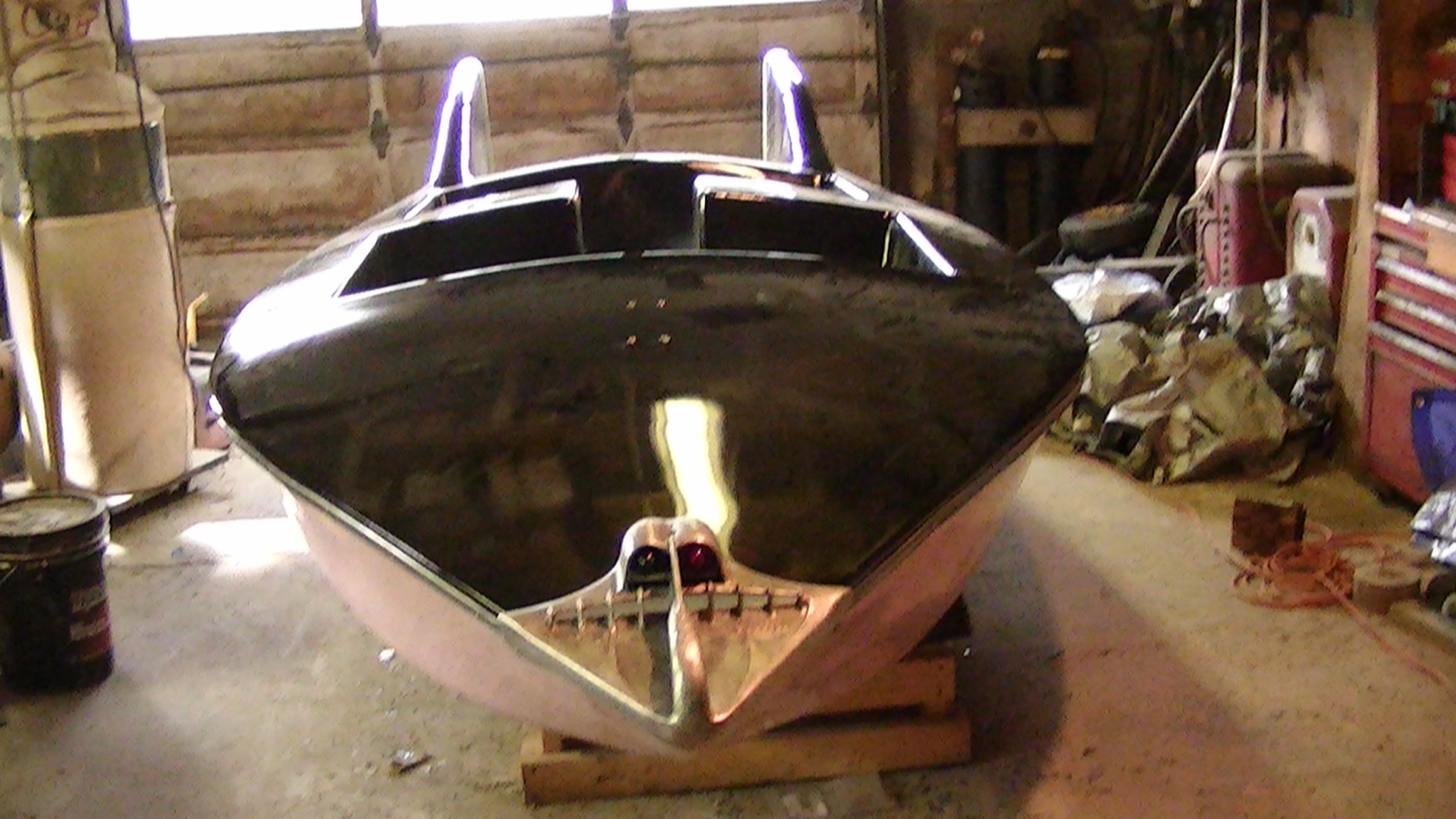

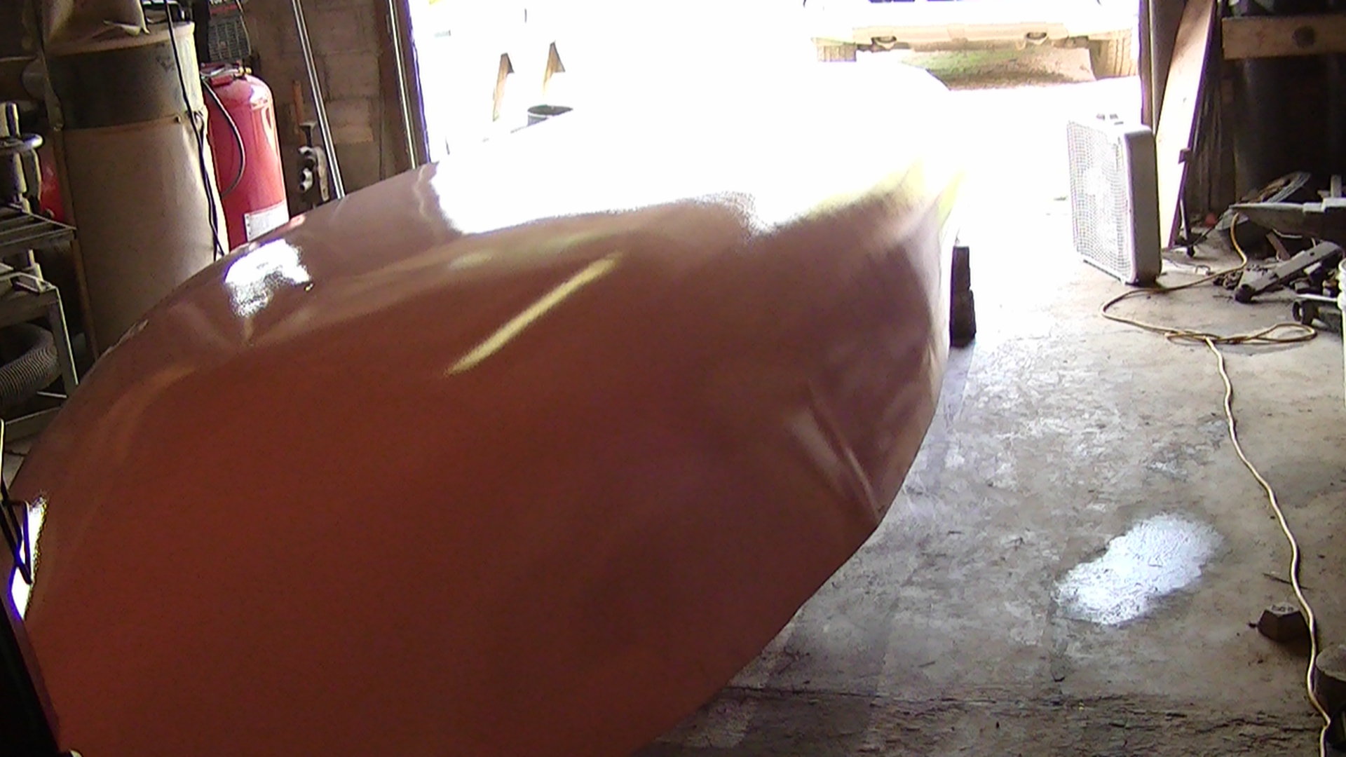

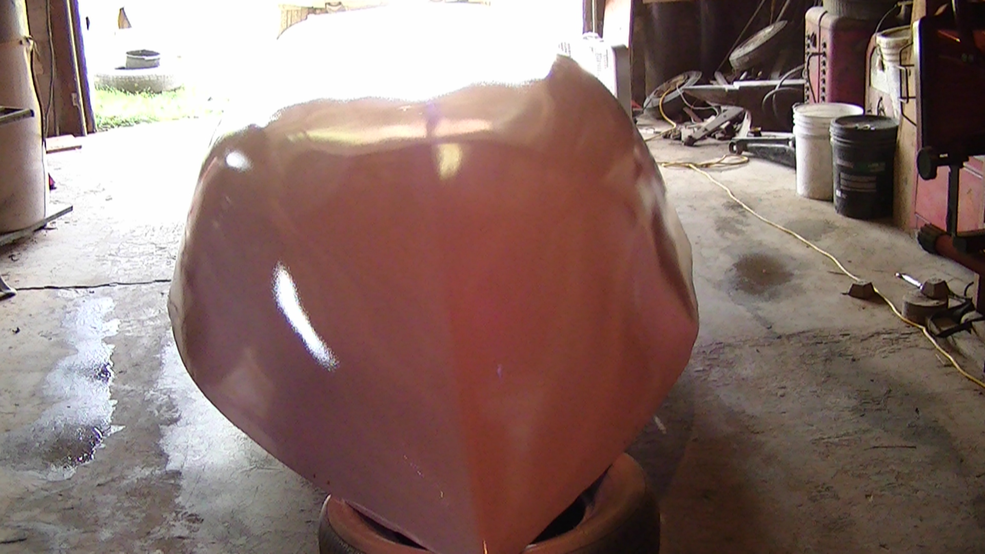

As I promised some photos!!! I had a chance to do some painting yesterday. Didn't turn out to bad a few small dust spots in the clear to buff out. Here are some photos. Once I get it sanded and buffed I will pull it out and give some better pictures hopefully. Next step will be putting the runner on the bottom. what is everyones suggestions for sealant and bolts for that.

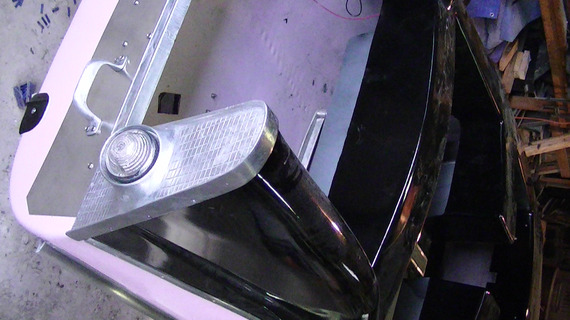

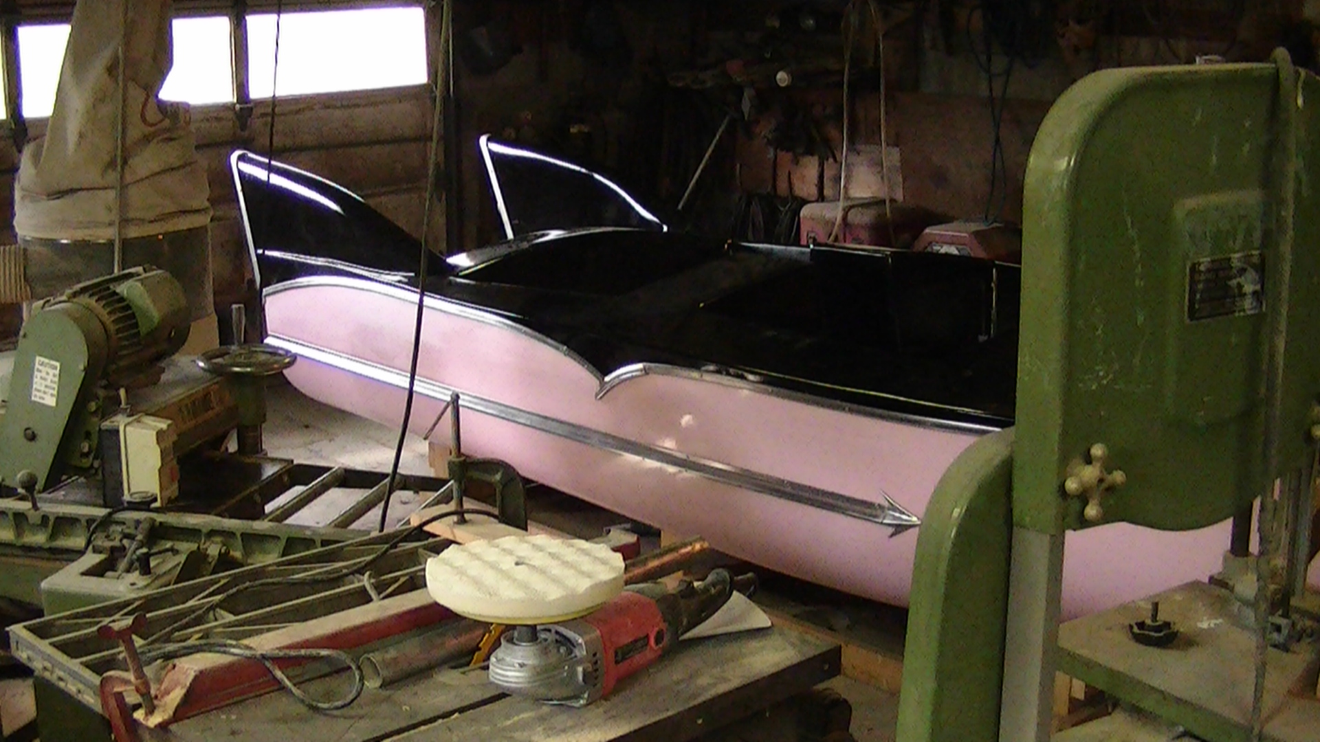

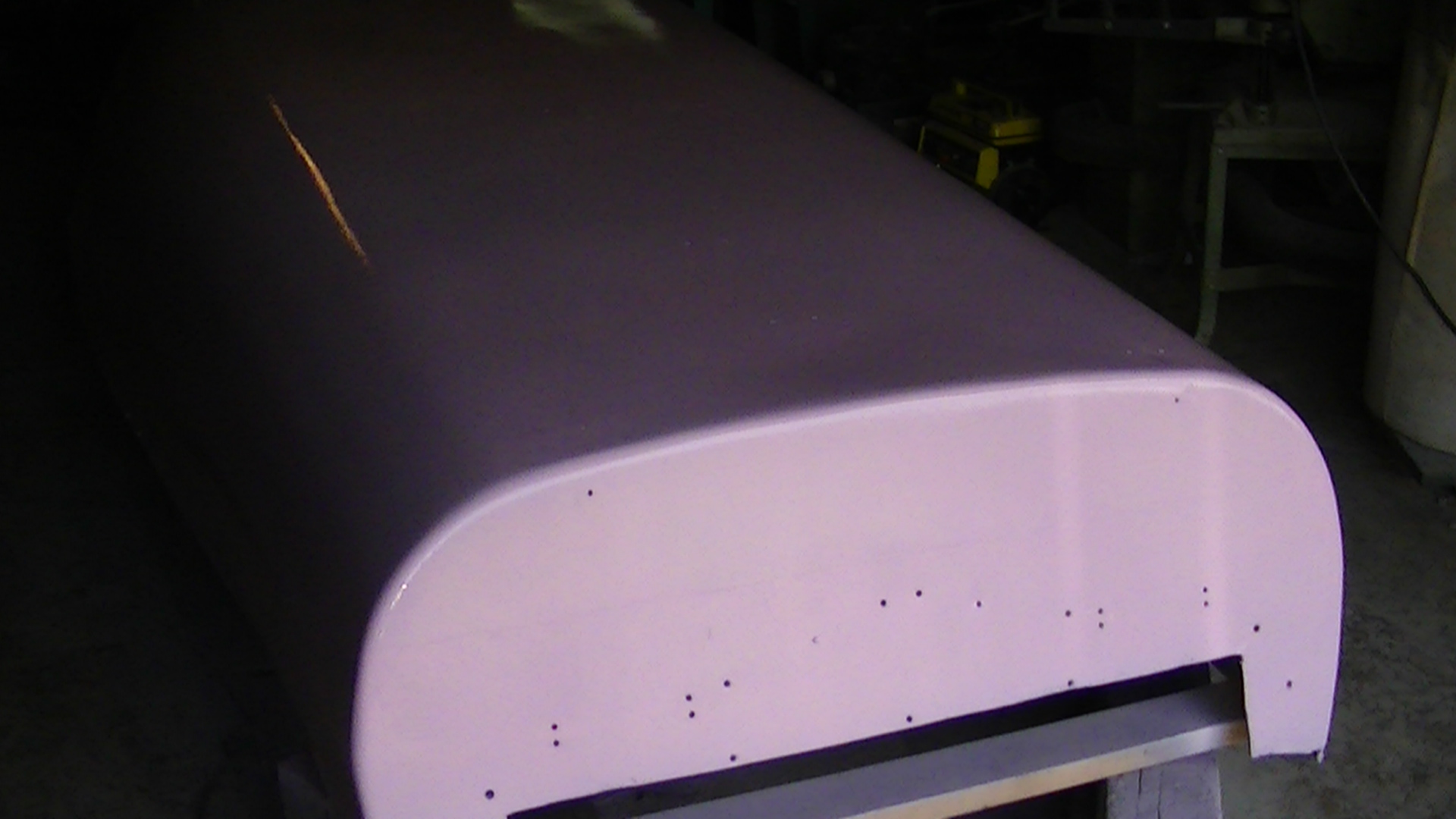

I've been slacking on posting any photos but I'm coming down the home stretch. Waiting on motor and making a windshield. May also need some help with tiller cable and pulley steering system but here is some photos.

That is one shiny fish! Lookin' great Al.
Re:57 herters flying fish 11 years 10 months ago #100993
Outstanding Anthony!!!!!!!!!!

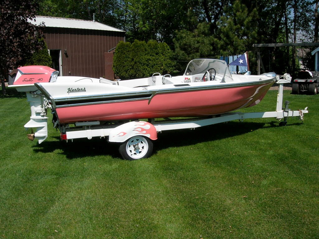

This is one I rebuilt a four years ago. Listed and sold locally for $3800. The girl fell in love with it. Had a Mark 55.
