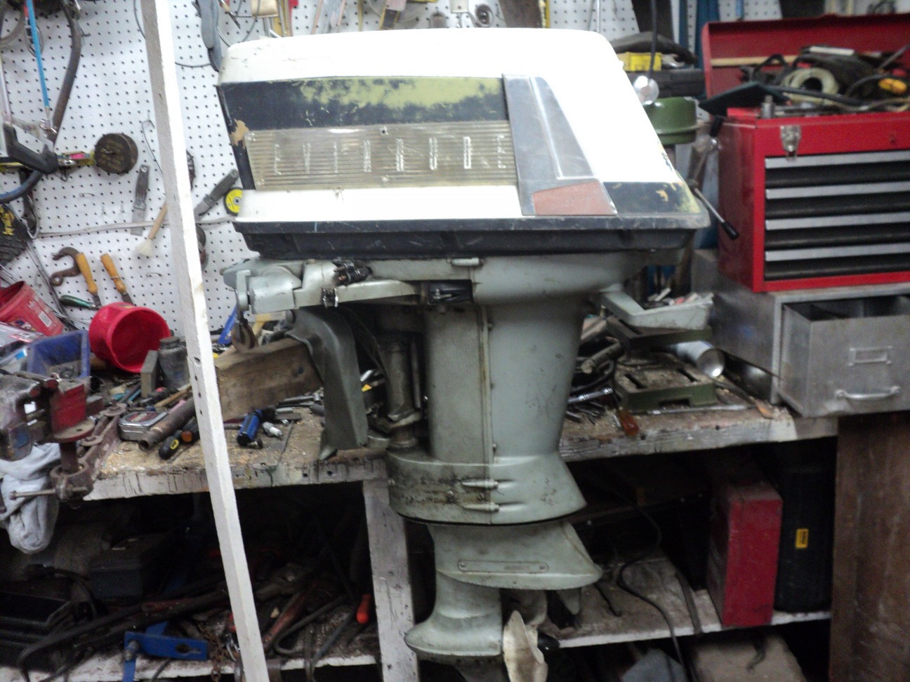

Re:LF info: 58 Evinrude 35 Lark / 54 10 HP Seahorse 11 years 2 months ago #93210
I'm working on getting one ready now. I ran out of money too soon fixing the boat itself up. Hopefully real soon though. Parts are easy to get.
Re:LF info: 58 Evinrude 35 Lark / 54 10 HP Seahorse 11 years 2 months ago #93223
robert-lorigan What year is that one? Looks a little different than mine? Basically the cover is different the lower half looks the same.
Re:LF info: 58 Evinrude 35 Lark / 54 10 HP Seahorse 11 years 2 months ago #93232
59 Golden Jubilee. :kiss:
