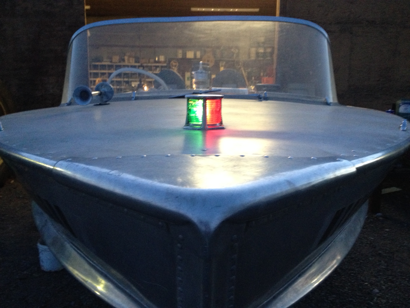

Guys,
I'm getting closer to getting my Alumacraft on the water but I'm hoping to get some educated information on proper cleaning and care of the windshield. Thoughts?
