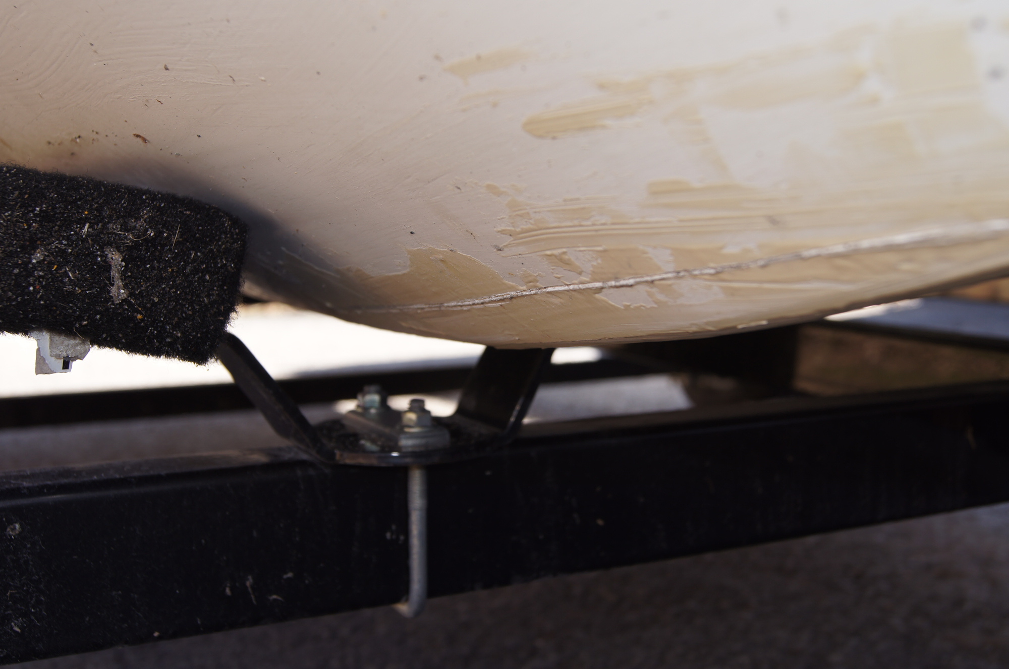

I just bought Brian's 2010 shoreland'r Trailer and got a free PowerCat.
Sometime on the way home (drove from Ravena NY to Castile NY to Hellam, PA) 4 of the lag screws worked their way out of the bunks. No major damage that i can find, in the middle bunk the hull was sitting on the bunk support for a while.
From one of the pictures below it looks like this may have happened before, or the Cat scraped something on the trailer or in the water after Brian finished it.
I want to make sure this trailer fits the boat well. Does anyone have pics of their PowerCat trailer bunks? I'm thinking of rebuilding the bunks 'cuz i just don't trust bolt heads (from the u- bolts) an inch from my hull.
The other question is just basic 'glass. It looks like he filled her pretty well after the scratch, as you can see. Just fair it and paint for now?

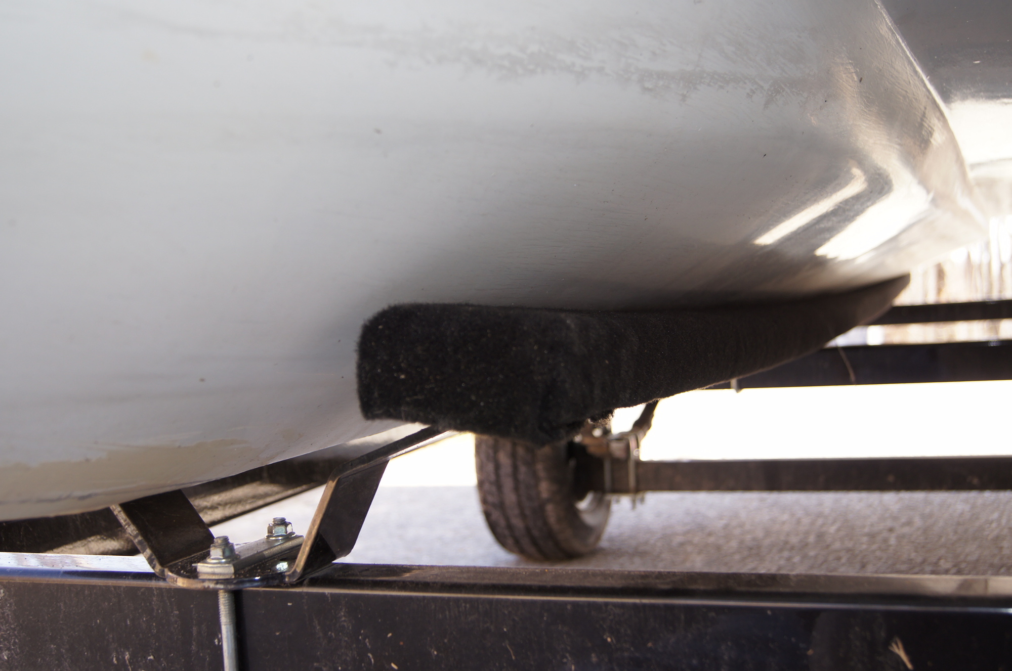

As you can see in this one, i can't even get the bunk back around between the support and the hull. The weight of the Cat is too much for the thin bunk supports, i think.

Re:61 PowerCat 18DC and trailer questions. 11 years 2 months ago #92073
There is so much wrong with the way that it is rigged I am surprised you got it home without ripping a hole in the hull
groups.yahoo.com/neo/groups/PowerCatBoat/info
1 The angle of the bunk is so far from the angle of the hull.
2 the brackets that are holding the bunk are really too light for the boat. If you load this boat with items and hit a hard bump in the road the hull most likely will bottom out on the trailer.
3 may be a bit over kill, however with a boat that size and how far the cross members are I would not use anything less than treated 2 X 6
I would make me a cardboard cut out of the hull, and then off load the boat. I would bend the brackets where a 2 X 6 would fit on both side bottoming out on the trailer and the hull will fit in between.
Then for insurance I would cut out some triangles and bolt them to the trailer behind the bunks as to keep them from moving because of the light brackets
CAVU

TallTexan
I was in too much of a hurry that day to get all around NY and back to PA. I'm lucky there was no major damage. I'm not happy with the bunks or their supports at all. I was able to bend the supports with a short piece of cheater pipe.
If 2x6 is overkill what does that make the 2x8 or 2x10 lumber i was thinking about using? :)
I think i'll remove those brackets completely. They are only on by U-bolt.
