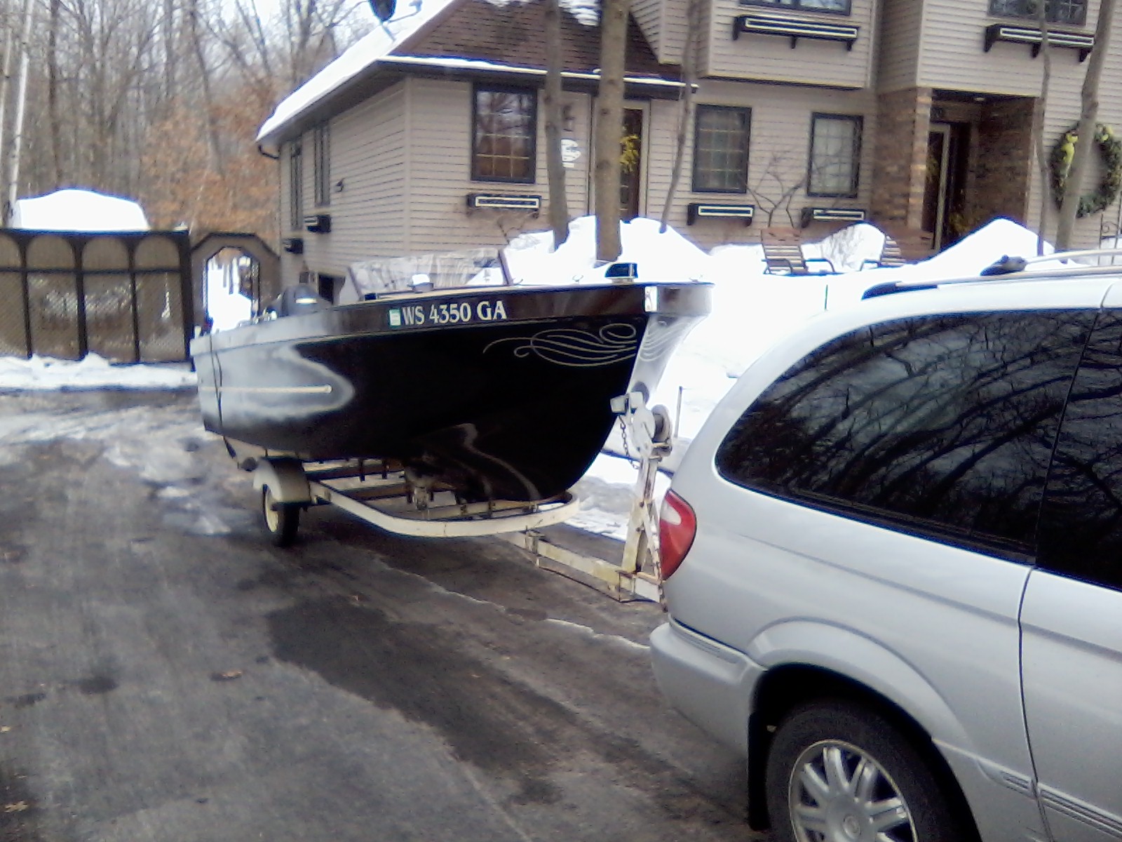

Went to fill my inboard gas tank today, go for a little cruise, dogone ramp was closed! Go figure :(
