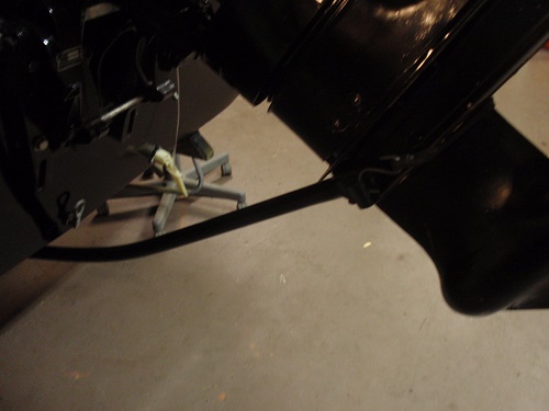

Thanks guys, pictures to follow sometime today. Great minds run in the same gutter. I welded up some 1/4" stock that was laying around, bolted it to the trailer cross member with a 1/2" carriage bolt/nylon lock nut, drilled a 1/2" hole through it, got a 1" black iron pipe and a trailer hitch pin. Had to bend the pipe to fit around and under the transom. Did this by laying the pipe on the garage floor and blocking one end up on some 4X4's and drove my jeep up the pipe. Perfect bend angle! I welded on a "V" to fit somewhere by the lower gear housing, put some carpet padding on the V, drilled some 1/4" holes to hold a heavy duty bungee. Looks pretty strong, at least I can sit my 230# carcass on it without it moving so I think we're good.

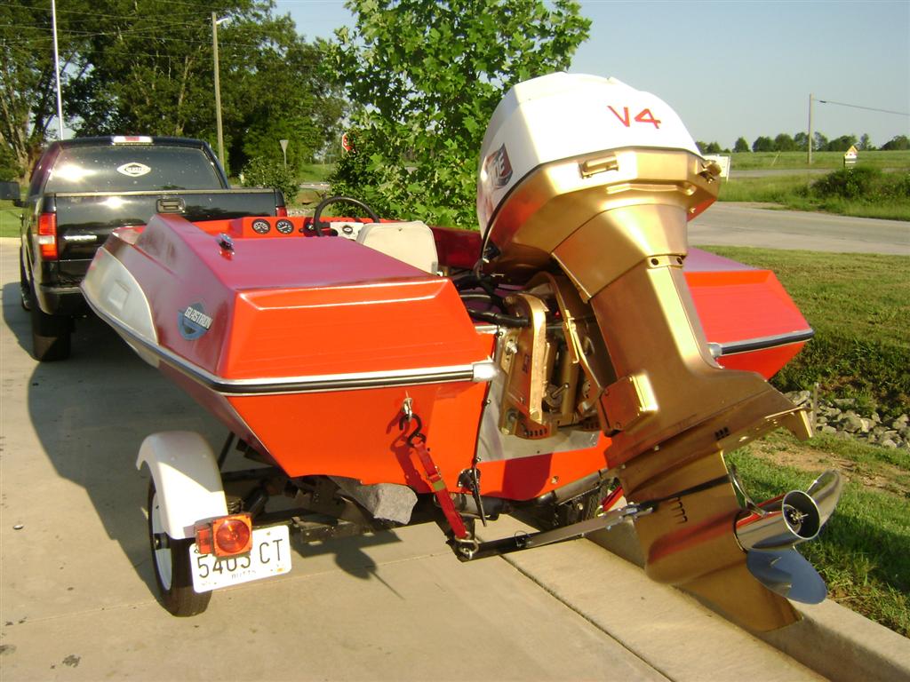

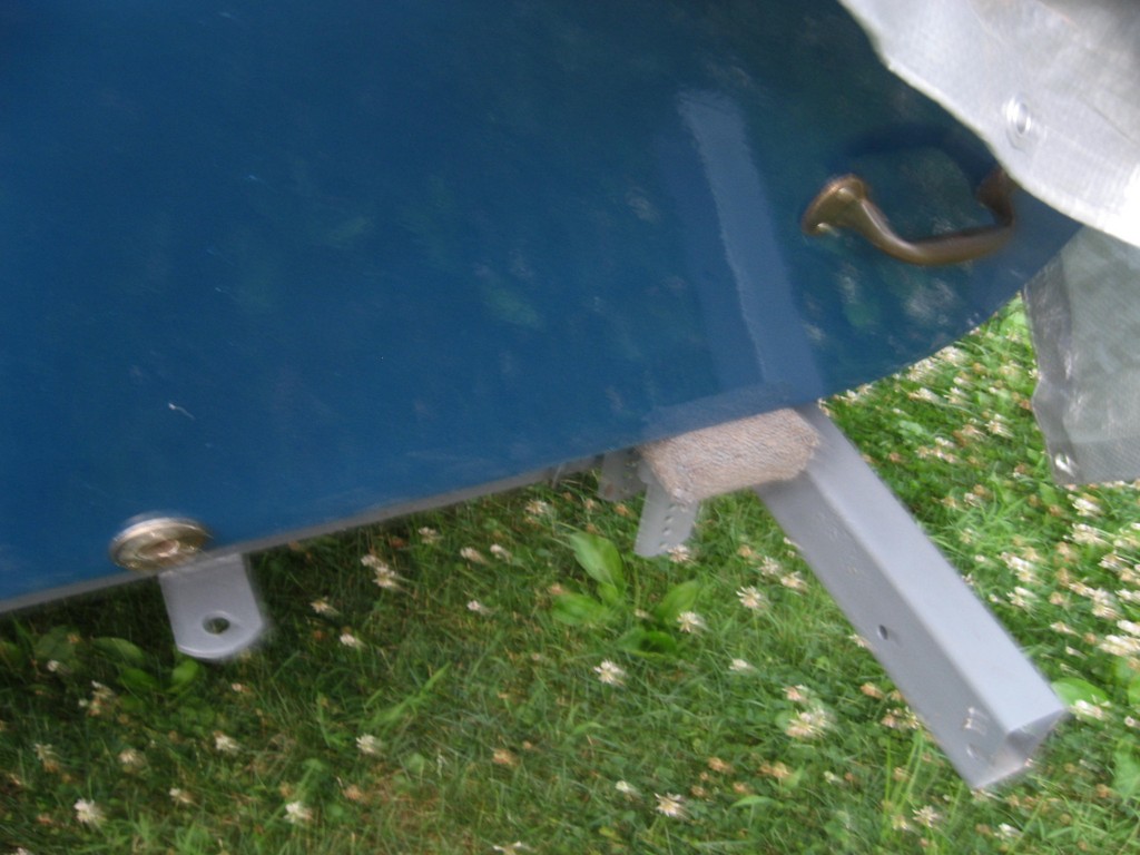

A wise person once told me that you probably do as much damage to a transom when trailering than when bouncing across rough water ! Made sense to me, so I've always used a brace since then Cal.
My most recent one pins to a cross brace (home fabbed the cross brace out of 1" angle iron). Joe (Ferguson Poole Marine) had them on sale for a price the discount stores couldn't even beat, so it was a no-brainer for me. I used tie down rings to secure the cross bar, and killed two birds with one stone. ;)

Mark, pretty sneaky way of showing us your beautiful work :)
Re:trailer/motor brace 11 years 4 months ago #90346
That brace will be great and secure too. Awsome boat and outboard there Mark.
