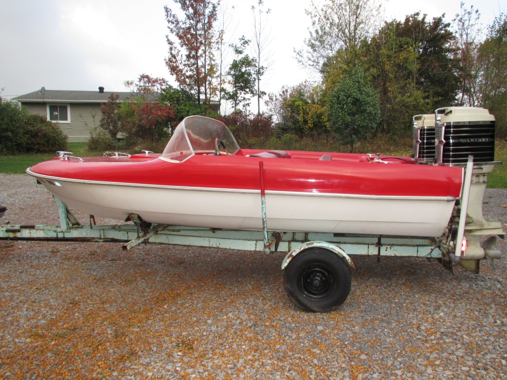

1961 Craig Kit Kat 11 years 4 months ago #90285
  • luke
  • luke's Avatar Topic Author
  • Posts: 19
Acquired a 1961 Craig Kit Kat 14.5 ft with twin 1962 Merc 700's on it from the original owner back in the fall. Have had the engines tuned, etc and went out in late fall and tried her out. What a blast. I have since replaced the rotted transom with Corecell, front seat is at upholsterers now due to winter nesting of the mice before I bought it. Thought you might like to see her.

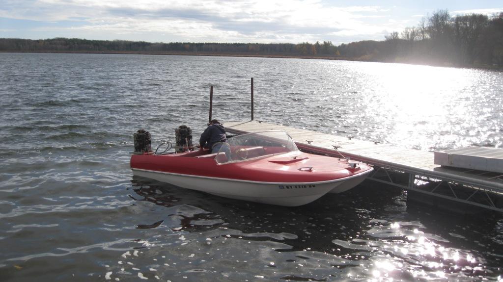

1961 Craig Kit Kat 11 years 4 months ago #90331
  • luke
  • Posts: 19
Pic of first time I had it in the water after 5 yrs on a trailer. Ran great but will run alot better with imrpovements and some run time.

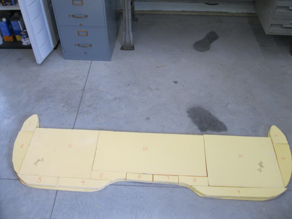

1961 Craig Kit Kat Corecell transom 11 years 4 months ago #90332
  • luke
  • Posts: 19
2 layers of Corecell for 1 1/2" total w overlapping.

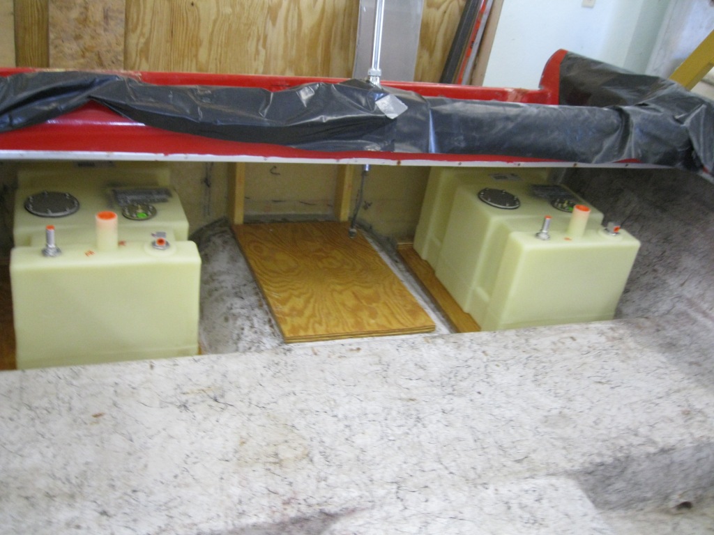

1961 Craig Kit Kat Twin 12 Gal Moeller 11 years 4 months ago #90333
  • luke
  • Posts: 19
2 tanks set in epoxied frames with two trim pumps to be mounted in center. This is current progress. More to follow in a few weeks.
