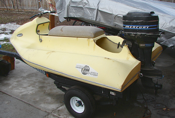

I'm about to pull the hydrocycle out of my parents garage and had a question for anyone willing to chime in.
The motor is a 73 20hp merc. It has no controls at all and no external controls. They were trashed.
My plan is to hook a motorcycle throttle to it and I'm sure I can get one of those... but I"m interested on how many out there have done this type of hook up? The throttle on the motor doesn't seem to have a return spring. Any thoughts?
I'm sure I can use a traditional setup... but then I'll not be holding on with both hands.
THanks in advance,
Kelly

Kelly- We have been looking into this same question for the cycle we are building for my son (and myself!!). The biggest safety question I see is how to kill the motor if you fall off. A modern jetski does not have a transmission and if you fall goes to into a idle spin. The throttle return gets it slowed if you fall off but not stopped. I think it would be easy to add a light spring on the steering that would get it into a spin if you are not on board, but if it does not kill the motor you have a prop to deal with trying to get back on! We have floated ours and it would take quite a bit to flip it, but falling off is always a concern.
Here is the one we are restoring this winter. Any help with an ID would be great. The front looks more like an Aqua Looper from Canada, but the hull looks more like Hydrocycle. Not sure what we have, but it will be fun!

Nice looker there. I think that's a later Aqua loop. Del VanEmerik has one I think.
I was thinking of running a kill switch wrist band from the kill switch on the motor to the handle bars. Fall off = Motor dies. It shouldn't skip too far I'd assume without me on it.
