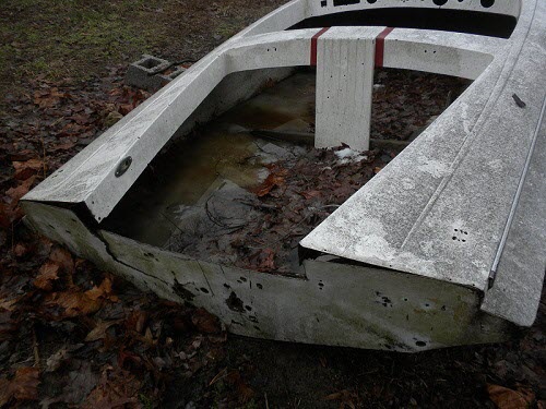

The first step in restoring my boat is to clean out the dirt and grime from seams and spider cracks (25 years worth in my boat's case). What do you do before you patch, add new fiberglass, sand, or grind on these seams and cracks?
Re:How did you clean the dirt out of spider cracks? 11 years 4 months ago #89650
Seabuddy, in viewing your picture, I would start out with a dust pan and literally clean all of the leaves, gunk etc out of the inside of the boat. If the remainder is dry, then I would move on to the shop vacuum. It looks as though you have a fair amount of tree sap on the deck. At that point, I opt for the pressure washer. I like to spray on Westleys Bleche White in a light coating and let sit on the area for 5 minutes before spraying. After the presuure washer, I usually take a bucket of very hot soapy water and a mitt and then go over the entire boat with that. Then rinse thoroughly and reassess at that point. If the hull has severe bottom growth or staining from being stored in the water, I use toilet bowl cleaner at the car wash. (be sure to wear a respirator, goggles, old portective clothing and gloves when doing so) I put the toilet bowl cleaner in a bucket and then use a large handle brush to apply to the hull. It may bubble a bit. I usually let it sit for 5 minutes and then wash off with the pressure washer and move on to the next area.
For your Spider cracks, the pressure washer will be about your only hope for cleaning. It will also drive hot water into them and cause further damage, but that is beside the point, as you will want to grind them out with a Dremel tool or die ginder to start he repair process if you are restoring the hull. I ususally like to blow the boat off with compressed air as well.

Oh boy - I think spider cracks are the least of your worries at this point!
Re:How did you clean the dirt out of spider cracks? 11 years 4 months ago #89765
X2 You're a long way away from worrying about cracks and crazing . At this point think demolition and assessing structural repairs .
Re:How did you clean the dirt out of spider cracks? 11 years 4 months ago #89766
Seabuddy, all of the above comments are a good indicator for you. What I failed to mention is that I prefer to get the boat as clean as you can possible get. This allows you to assess what you are up against. Just from the one picture that you posted, I would assume the worst. 50 year old hull, obviously spent a good portion of that time outside without cover would at least to me indicate major sturctural issues. Floor, stringers and transom will most likely need replacement. Then you would want to address the asthetics, (Stress cracks, holes etc).

Seabuddy, I honestly mean no offense,but I'd look for a better boat to start with before I got too involved with this one.

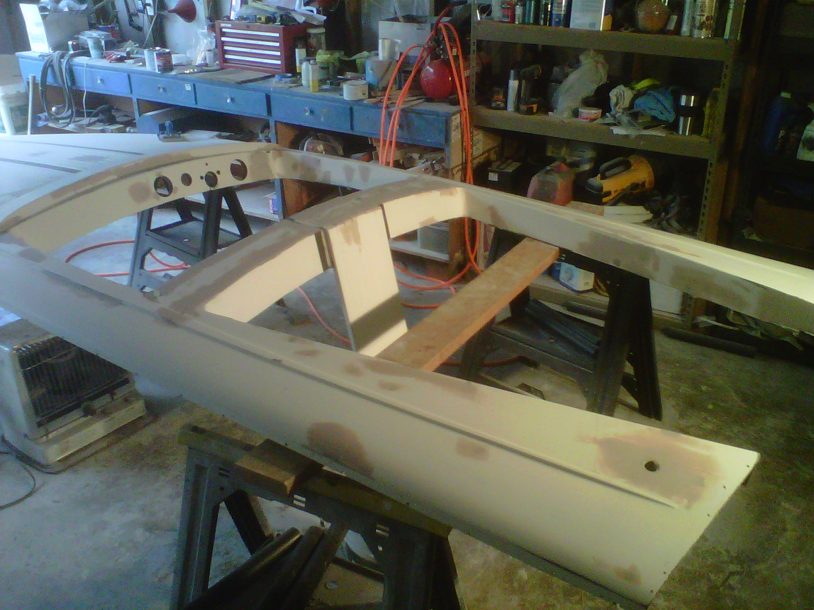

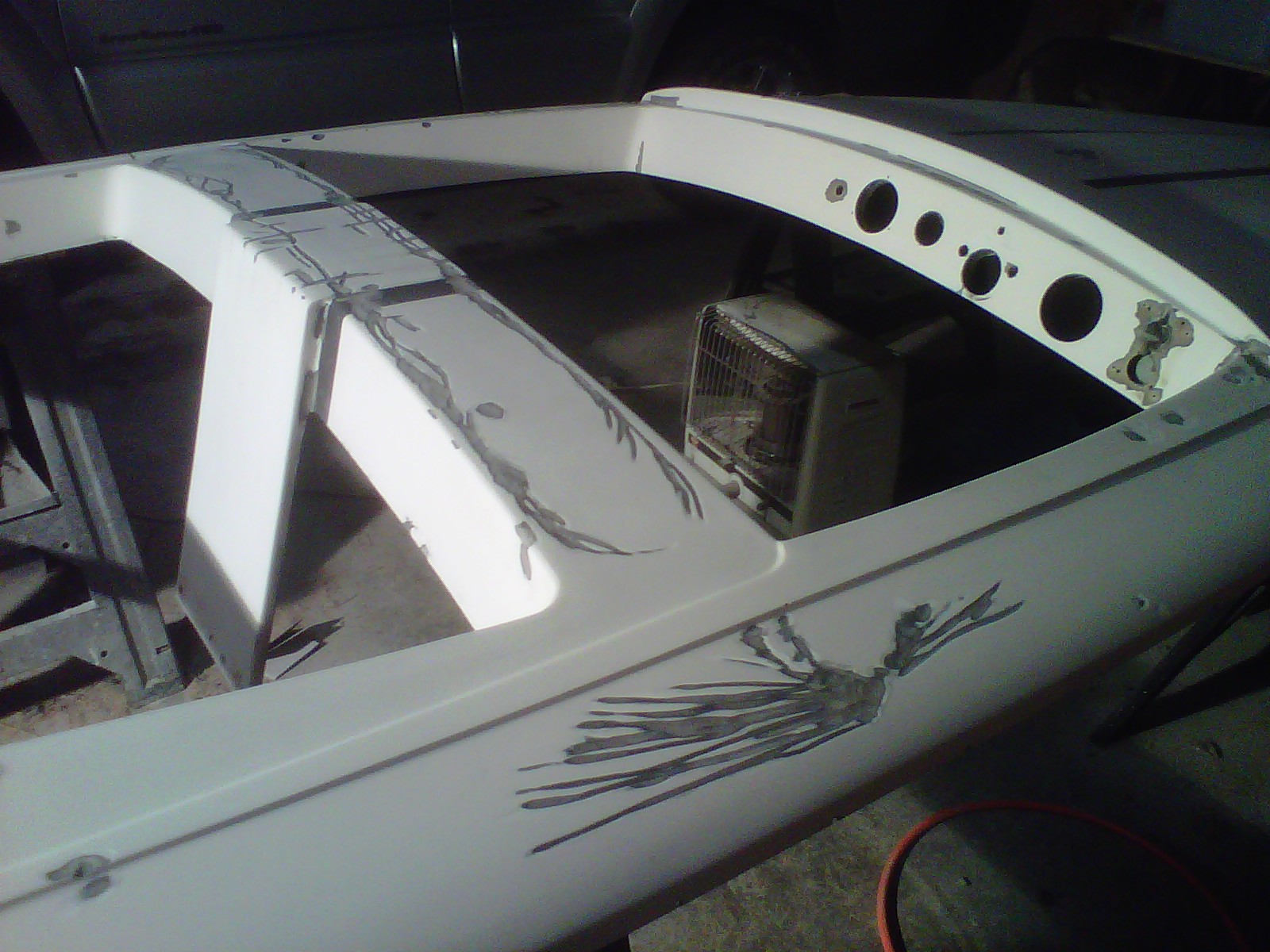

I will tell you what I did... Each and every spider crack was ground out with the edge of a 4" angle-grinder grinding wheel. Very tedious, but you can't just clean them and fill them... or your new surface will soon see the cracks come back. After the grinding was done, I used a fiberglass-filled fairing compound, then sanded the areas smooth, then spread a think layer of (non-glass filled) fairing compound and sanded the areas until the surface was perfectly smooth.
Here is a shot after the first pass of the grinding, so you can see what I mean:
Here is a shot after the fairing work was done, when the boat was ready to head to the paint shop to get the Awlgrip finish:
I think I had about 18,000 hours of sanding into it... I developed Popeye arms... even though it looked splotchy, it was perfectly smooth. I was addicted to sanding... after it came back from paint, I wet sanded the whole finish (w. 1500 grit then 2000 grit) and went back to the painter to have it buffed out. It was all worth the effort.
