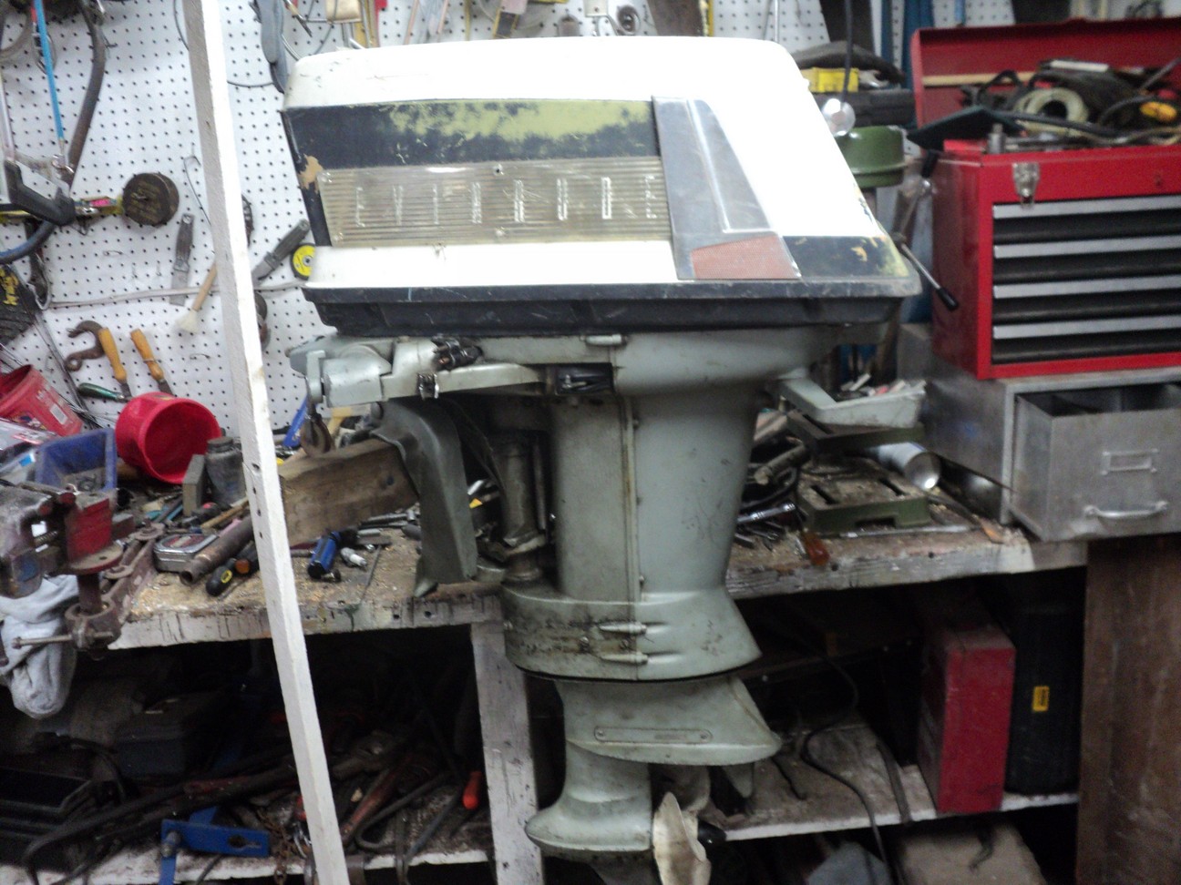

Re:What is the best motor? 11 years 4 months ago #89659
I had a Merc and loved it. But I now have a Johnson and Evenrude and a Honda. The Honda is not old and great on gas but a pain in the ass because the carb plugs up even when using fuel conditioners. My Johnnyrudes are very easy to work on. The cover will be the next project.
