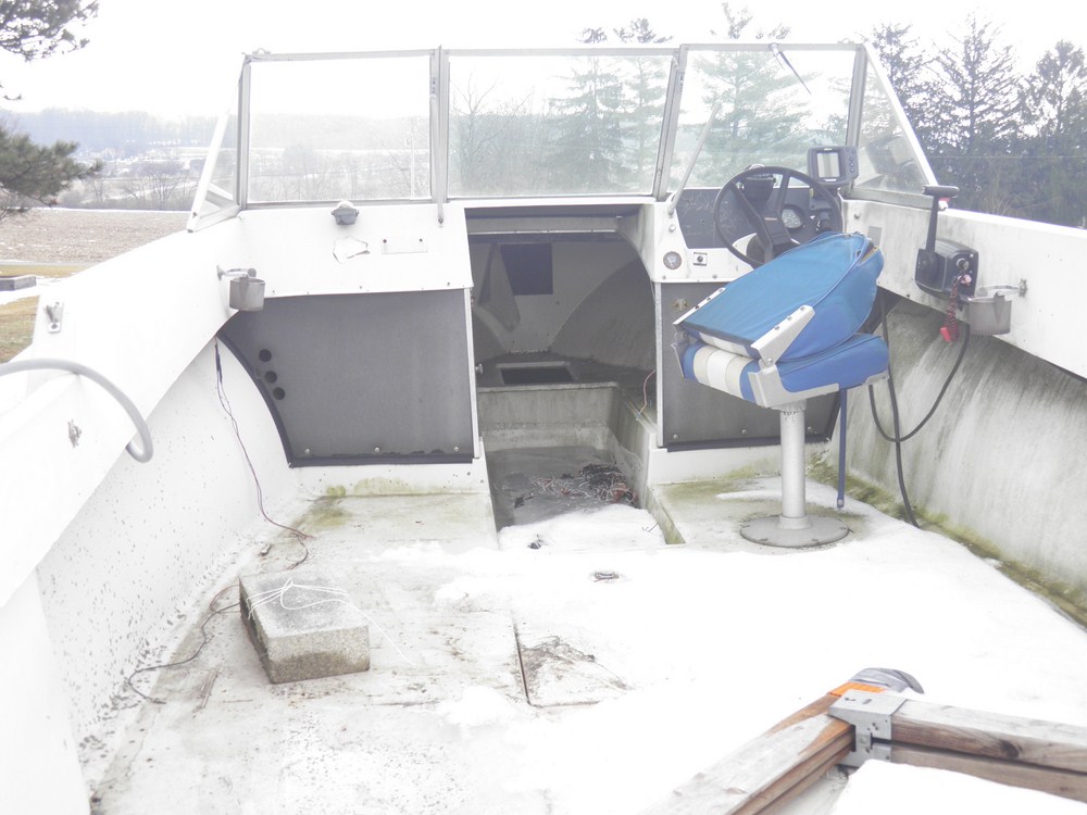

A friend of mine has a the above boat that has not seen water in 4 years because of some health issues.
It has a new Merc on it, but he would want to keep that.
He is thinking of selling it to me since he saw my Merc twins the other day
The trailer is a 1985 and needs some work, too.
NADA.com says it's worth about $2,645.
He says he has a hard top for it. Also the front rail with new mounting hardware. He uses this boat at his place in VA, would take it down the river to the bay, so it has seen salt.
What do you guys think?
And, would 2 motors fit on the transom? How wide does the transom area need to be?
Cheers!

Oh and how do you check stringers and transom without cutting into it?

I would not pay more than a grand for a 1975 boat with no motor. Yes the trailer is worth 6-800 if the brakes work. The interior needs work and what condition is the transom in ? I would also stick with one motor,two is twice the headache and with the extra drag fuel mileage will be less than a single.To answer your question that boat has more than enough beam to hang two. I do not think any one will be beating the door down to buy that without a motor.That NADA value is without a motor ?? Just checked and it is 1900,the 2600 was for one with a I/O 165 in it. To me that is still too much, 1 G would be my max offer IF the hull checks out 100%

You can check the transom by taking a awl or something similar and probing it around in the holes left by the motor mounts and see if you get dry shaving vs black pulp. As far as the stringers go not having a i/o helps as there should be zero holes drilled into the fiberglass encapsulated stringers. You can drill a few pilot type holes[with the owners permission of course] and again check or take a screwdriver and tap around making sure you get a consistent sound with each tap.The 1000's look good on any hull and most people can't tell what year a Tower is,including people that own them.Depending on what you plan on doing running only one probably will be under powered for that heavyish well made hull.The minimum HP should be either 65 or 75% of the max rated hp. So if it was rated for a 100 the min is 65 or 75.With that hull and a smaller engine you will be running her close to WOT all the time and them Towers will suck fuel under those condidions. They are really decent on fuel when loafing along but most of us ,like the song,can't drive 55 gotta be WOT baby!

At the kind of money you are talking about here... Hire a surveyor for a couple hundred bucks. You should tell the seller that you pay for the survey if the boat and trailer are exactly he has said it is to you. Seller pays for the survey as it is not as you were told.
Deals between friends should be on the up and up.
Frequently, when a seller is presented with a survey payment choice like this...the truth about his knowledge about the transom and stringers will come out before the survey starts.

Like some of the other guys, I was thinking the asking price sounded high, with no motor and needing a fresh interior. But they sure are nice boats. Another way to check transom condition is to tap around the transom with something like a plastic headed mallet. Solid areas will return a nice hard knock while soft areas are more of a softer "thunk". If the transom is going soft you'll definitely hear the difference where it's soft, usually in the lower transom.
