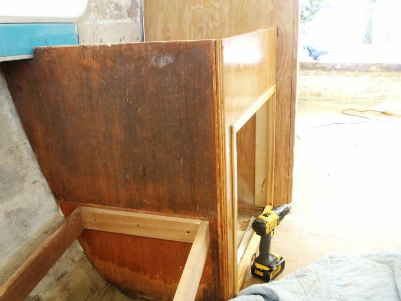

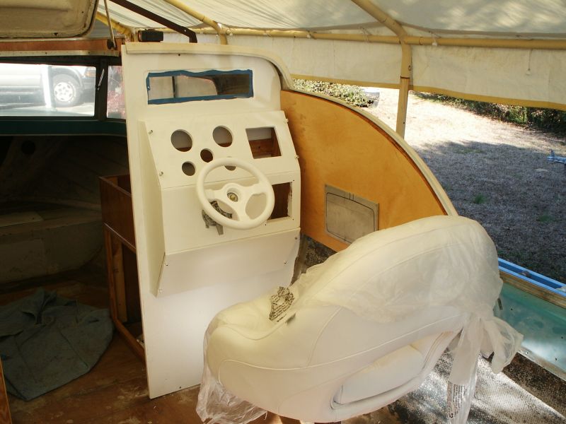

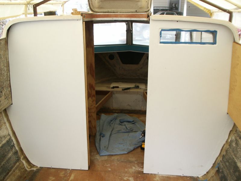

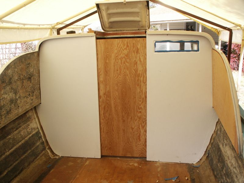

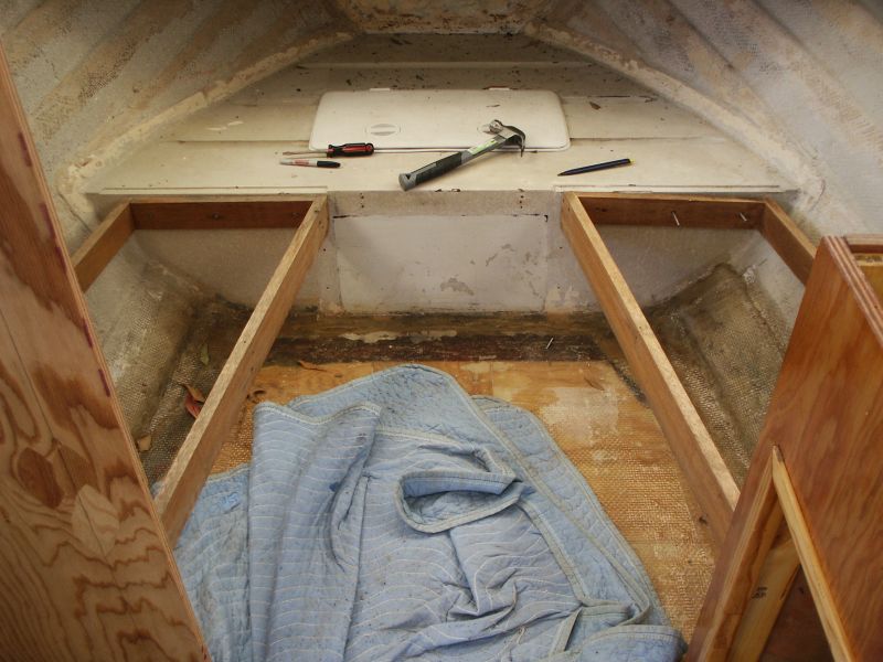

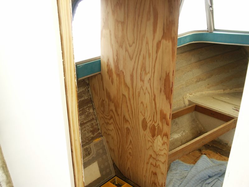

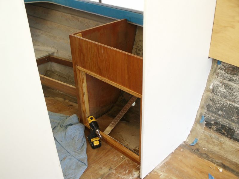

ok after the snow jam it is a cool 60 degrees today. so i got out and did another test fit and marked for some wood cleats for the walls and located my controls and the mounting plate. measured for some trim. and got a few more pieces to get primed. it is beginning to look like something now. i can use the old bunk frames and cabinet doors . i need to cut a few more pieces from my patterns but all in all it was a good day.

Looks Great!
What are the white pieces made of? Painted plywood.

yeah the 3/4 marine plywood i am using interlux so i had to seal the wood first with two coats of wood sealer and then that is the first coat of primer i need to sand and one more coat of primer then sand and two coats of brightsides. white. im getting to the point where i need to make sure everything is where i want it before i paint it. i think they want to sell products because there is a lot of prep.
