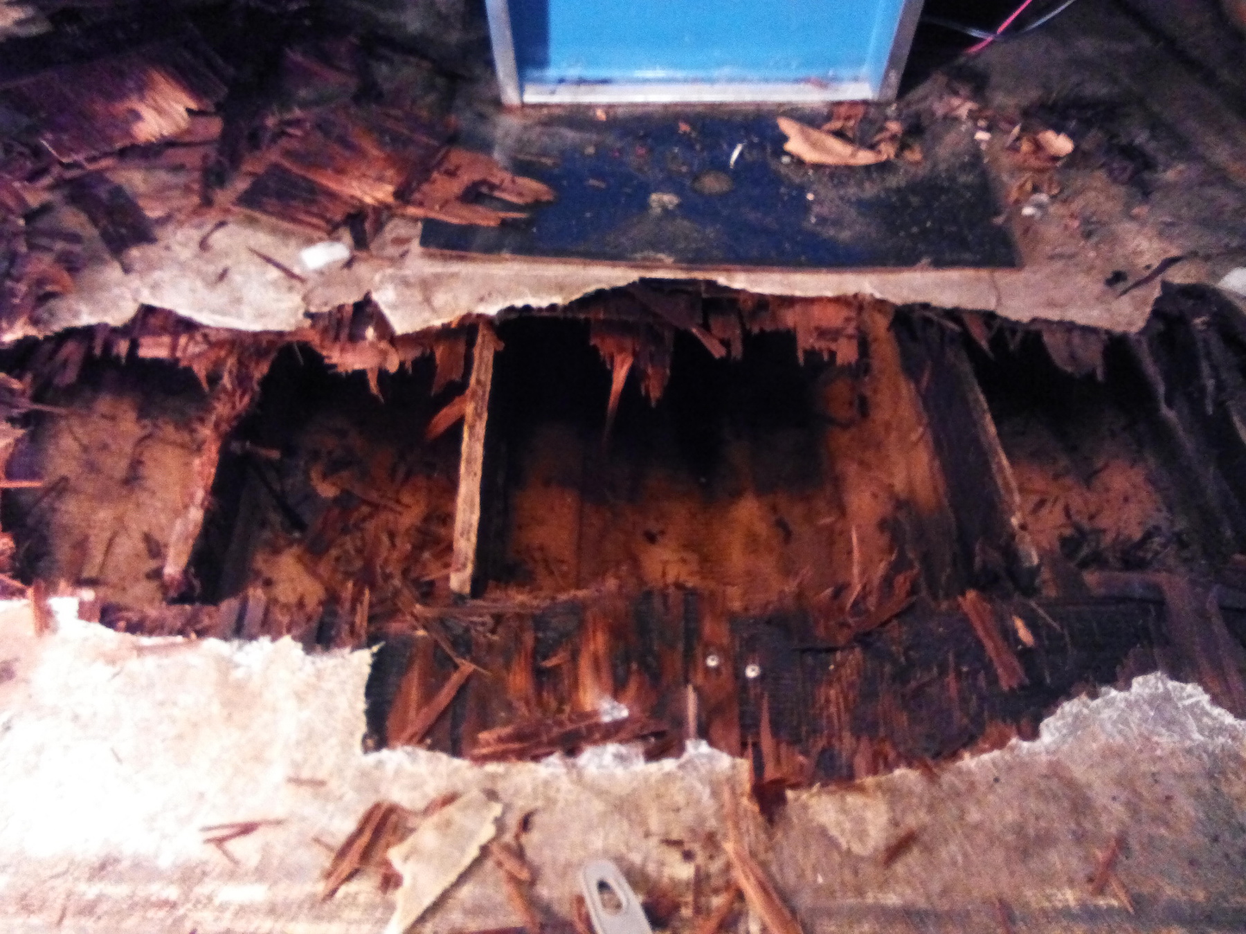

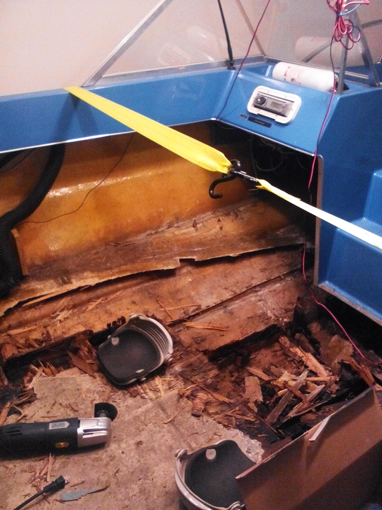

This is what i found when i started tearing into her:
I was told there were never any major repairs, but that coulda been a lie. But those are plywood stringers and plywood floor. It is a 68 mfg Chevron, 17 ft.
Thanks! we might be down again this July.

PS. that black piece of metal was from me. I jammed that in there this summer when i noticed the steps going through the floor!

That's not Fiberglass! WOW! So much for truth in advertising. I have done several wood stringer boats. A lot depends on whether you have to separate the deck and gunwales from the hull to do the whole floor. Can you post a shot up thru the boat from behind the transom. Some open bow boats you have to and a few you don't.
Al

Re:General floor and stringer restore questions. 12 years 7 months ago #89588
  • dlatshaw
  • dlatshaw's Avatar Topic Author
  • Posts: 486
  • Karma: 8
So here it is. I got an oscillating tool. I was playing with that and getting a feel for it.
After measuring i wrapped 2 large ratchet strap around the not to help it stay still.
I tapped around the transom with a rubber mallet just now and don't hear anything I think sound like rot and the transom is straight. But only getting into it will tell.
Dan
