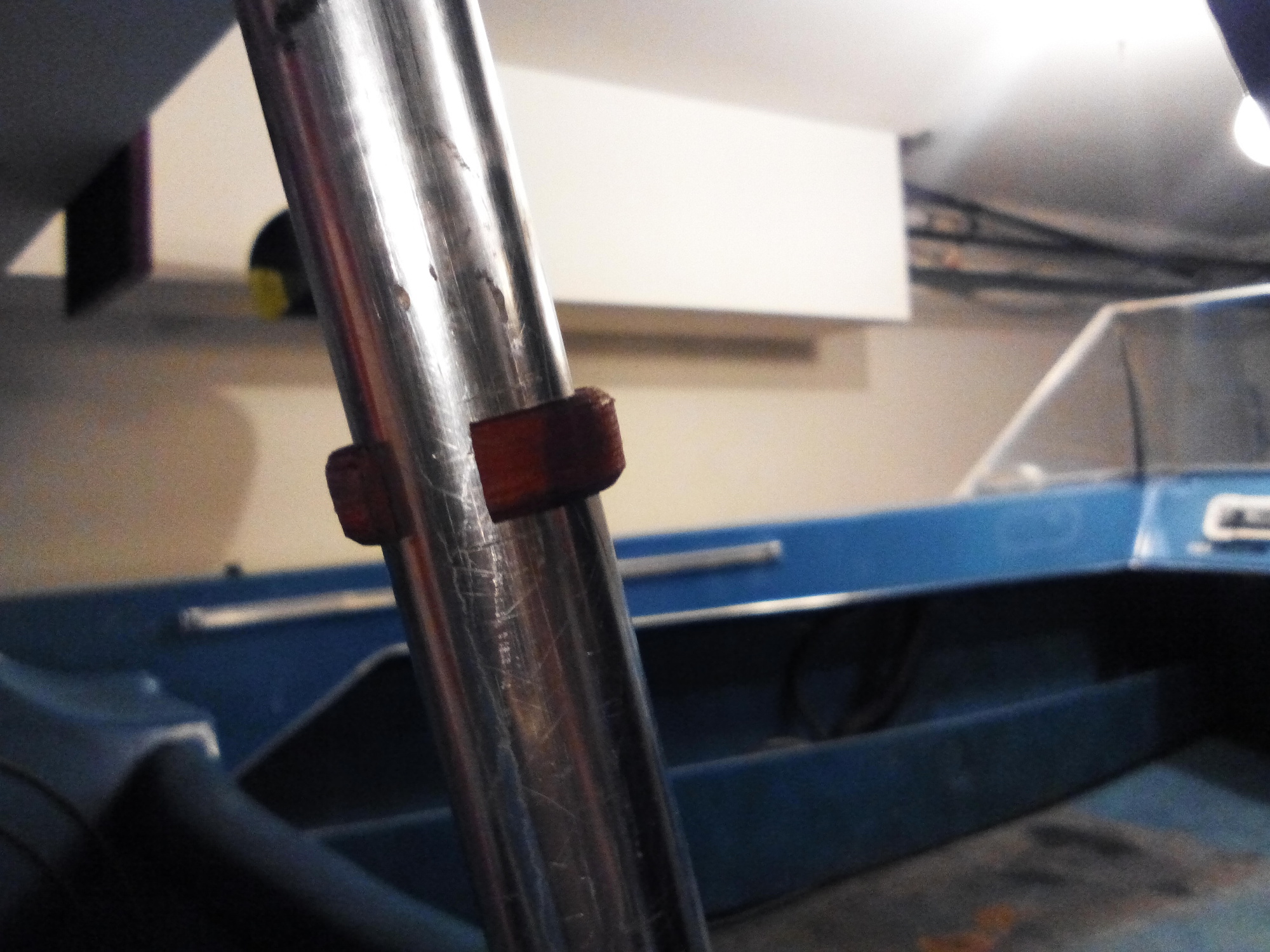

I need this rubber piece to keep the light up so my flag stays up.
I've tried a couple of things rig it but can't find on online to buy.
What do i call that rubber part to search for it?
Dan

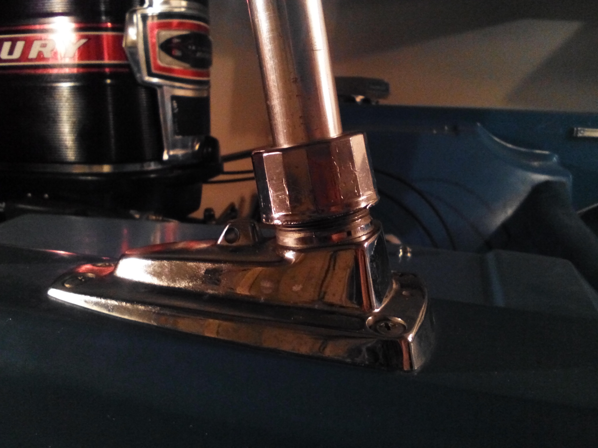

Could you post a pic of the light base?

Sure.
I'm also trying some rubber revitalizing tips I found on a motorcycle forum.

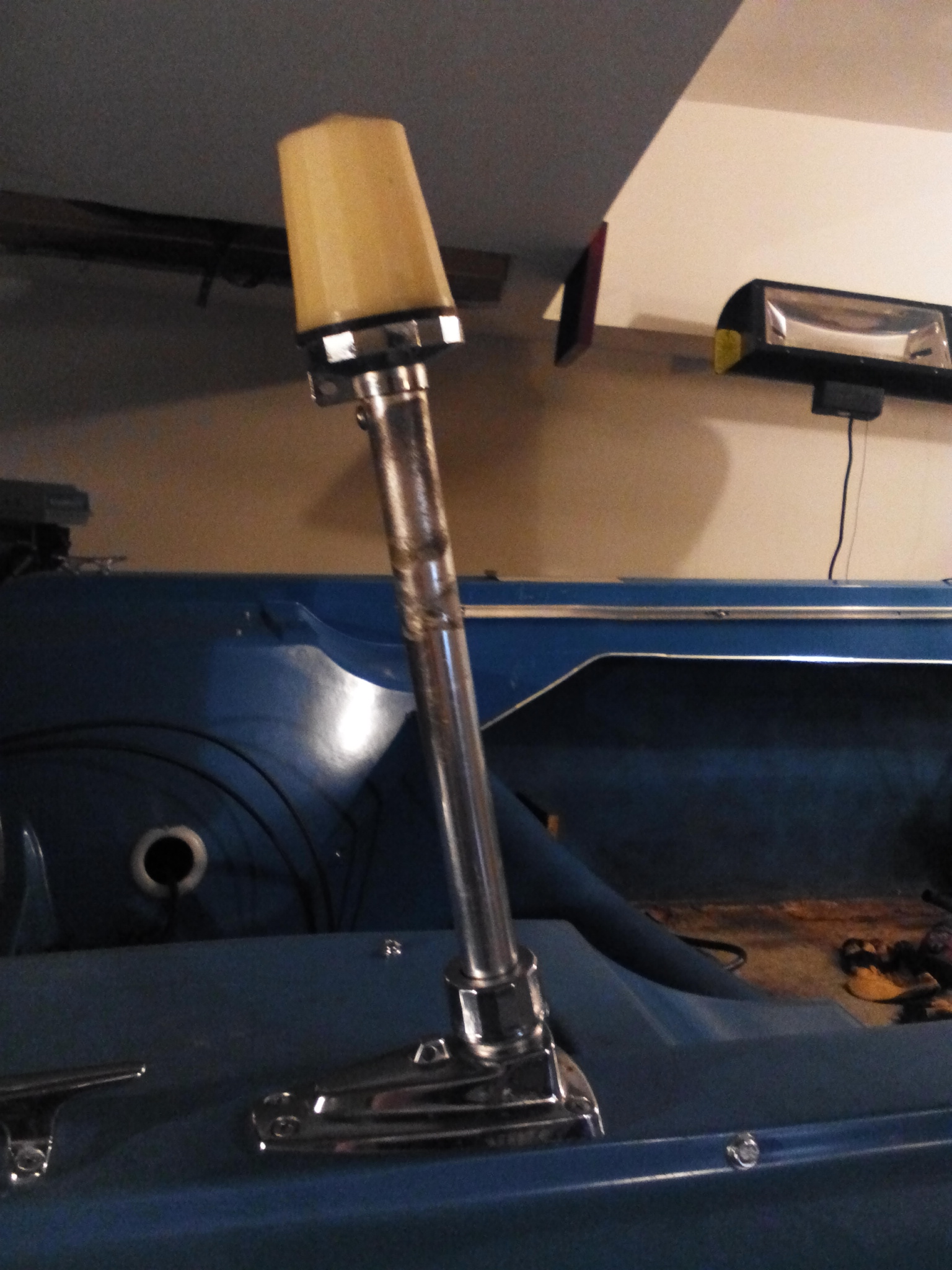

The whole thing

The base

diatshaw, I believe that you should have a nylon ring under the nut on your base, and when you tighten the nut it will squeeze the nylon ring. kinda like a ferrel fitting. frog

Thanks for the ideas. I've tried large o-rings but even when i tighten it the pole slides down when under way.
The red ring in the first picture goes under the nut and when you tighten it, the ring is just to old/hard/smooth to hold the pole in place.

I drilled and tapped a hole for a small set screw, on the front side of the base. Worked fine. Eventually I found a used light for $1 at a yard sale and it had the needed compression ring.

Its either a Perko or Attwood fixture and a local marine store should be able to get the correct piece. Failing that, try looking for a second hand boat shop.

I found on another site, honda motorcycles, about using different things to revitalize rubber.
I used a mixture of, wait for it, olive oil and white vinegar!
Put the part in a dish, all but covered it with olive oil, then covered it with vinegar. put it in the microwave for about 45 seconds until it started to boil.
When i pulled it out the piece was swelled up to about twice it's size!
I put it on the light pole above the nut and let it sit for a week or two while i plowed snow.
When i finally got around to working on the boat again today i noticed it had shrunk and was more pliable. I put it on the proper way and when i tighten the nut the pole stays up.
One thing they recommended was Oil Of Wintergreen. The chemical in it is the same chemical they use in rubber revitalizer products. Buy it smells up the whole house.
Anywhere, your mileage may vary, but there it is.
