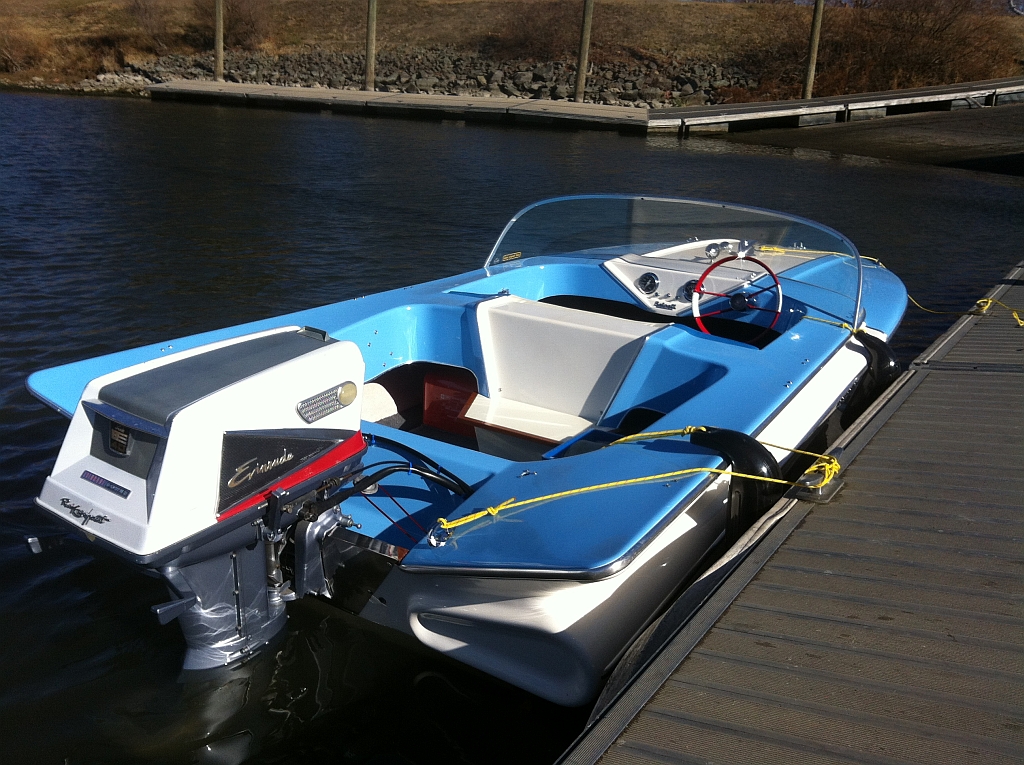

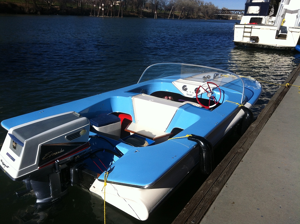

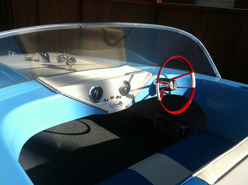

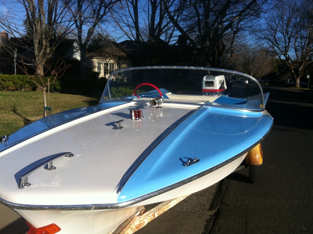

…was a total success. After working on any of my past glassic projects, all shakedowns are pretty exciting. My ’64 Sea Ray 700 in ’06, ‘58 Dorsett El Dorado in ’07, and my most recent one ’59 Bell Boy 265 Hardtop in ’12 were mostly cosmetic. I did extensive work on my ’58 Bell Boy Banshee in ’10 so that was very rewarding to have her on the water. This shakedown was pretty similar to my Banshee project as far as the extensive work, but this Jet Flight shakedown was different so it seems. Maybe because after driving Bruce’s Jet Flight in ’10, and just the cool factor, how she performed on the water, and the rarity of this model winged glassic, who wouldn’t want one? “What are the chances of that?” I asked myself. “They’re just not around. Even if one pops up, my chances of owning one was probably nil.”
Well that’s what I thought in year 2010. For this winged glassic, it was over 10 months ago when I brought her home for the first time and I’ve been working on her as much as I am able. This took longer than I had hoped but waiting this much longer for this day made it even more rewarding. This shakedown was amazing. Other than an idle adjustment, this glassic performed better than I imagined. This setup is similar to my former ’58 Dorsett El Dorado and '58 Johnson Super Sea Horse 35 hp, but this one rides more comfortably, cuts through the wakes smoother and when you are sitting midship rather than fore, and with her long bow, you feel like she’ll fly on the water. The excitement for this shakedown just felt different in that way; it was incredible. There are just a few little things to do still but she’s about done.
There are few members here that I want thank. Neil from Idaho. Anything I ask of him, he always comes through. I appreciate that Neil. My cousin Gemmel for mentioning the Reinell to me. He told me about this boat when he first saw it advertised and I happened to be the lucky person to buy it; I’m very fortunate there. Thanks cousin. My good friend up north, Bruce Gerard (Motorhead), who helped me get this motor dialed in and to have it run the way she does now. This was in the time span of almost two years, with the recent work being done the last few months knowing that I planned to use this same year motor as the Reinell. Bruce helped me replace all the lower unit seals, water pump, tune up with new parts, rewired, and carb rebuilt. Together with the Jet Flight, the ’60 Evinrude Lark II 40 hp motor and boat compliments each other nicely I think, the look and performance wise. Yes, she can handle more power but this setup seems to feel right with me, the balance of a light boat and mid range power. Thanks Bruce. Lastly, I’d like to thank Larry McKay. I’ve consulted with both Bruce and Larry many times on this project and both of them helped me tremendously. So thank you Larry for your time as always.
a couple more...

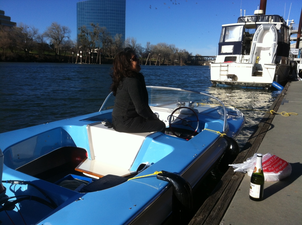

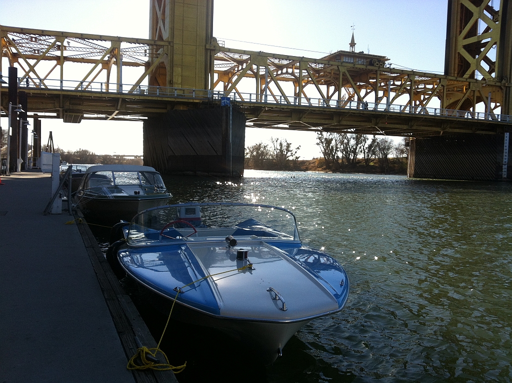

So not only did we have a successful shakedown, I had also planned to do a christening ceremony to celebrate our new old boat. I’ve never done one before so I thought let’s christen the Reinell, and that’s what we did. After almost 10 miles of testing the Jet Flight, we all cruised to Old Sacramento where we tied up our glassics. We celebrated the christening with sparkling cider, snacks and some homemade cookies. Three toasts and the christening of “Sweet Isabel” was complete. The name Sweet Isabel is from our very first grandchild, just born on the 28th of December, 2013.
Christening Sweet Isabel @ Old Sacramento
That's my wife Mercedes, my #1 supporter for my passion of glassic boats.

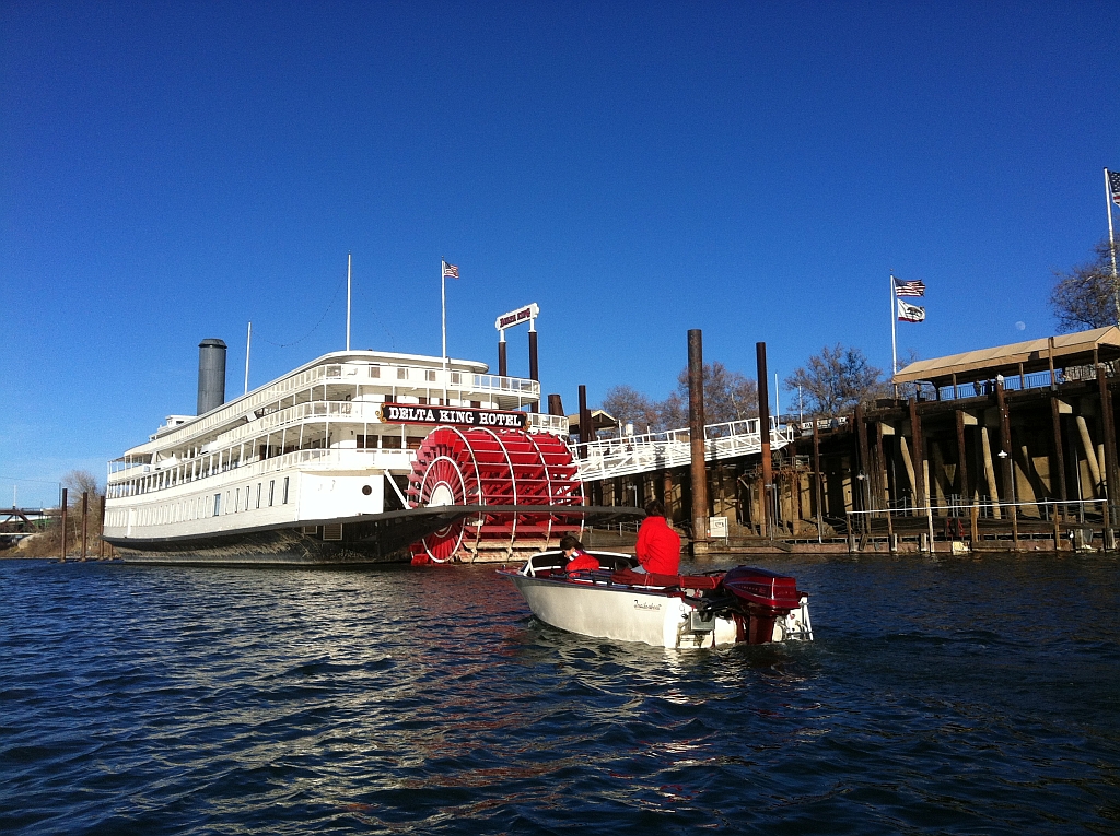

It's been a while... 11 years 5 months ago #88734
  • Eduardo
  • Eduardo's Avatar Topic Author
  • Posts: 309
  • Karma: 35
  • Thank you received: 5

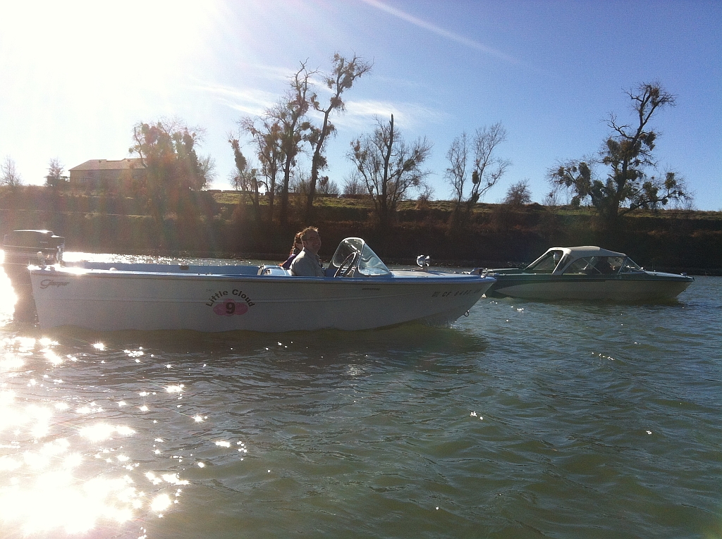

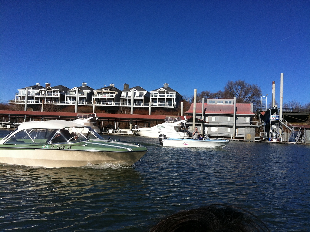

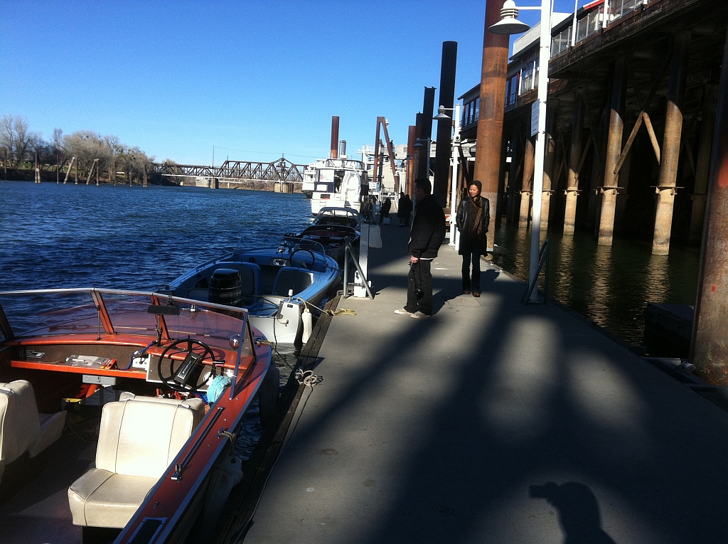

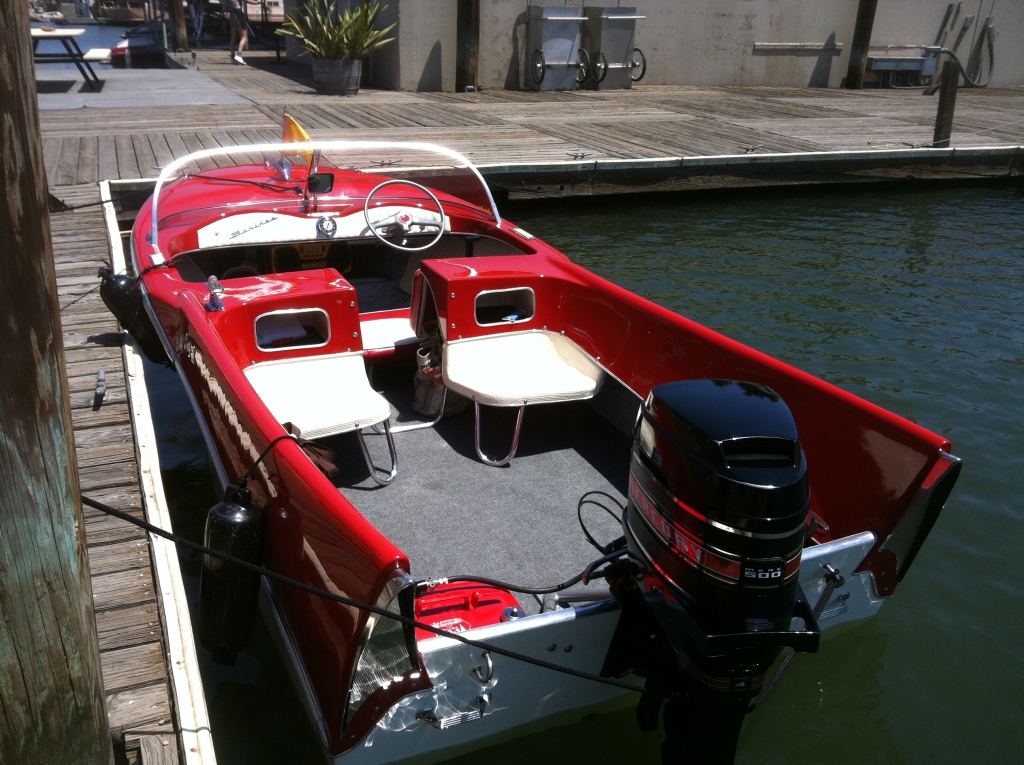

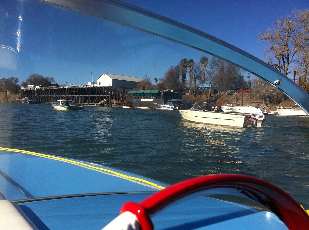

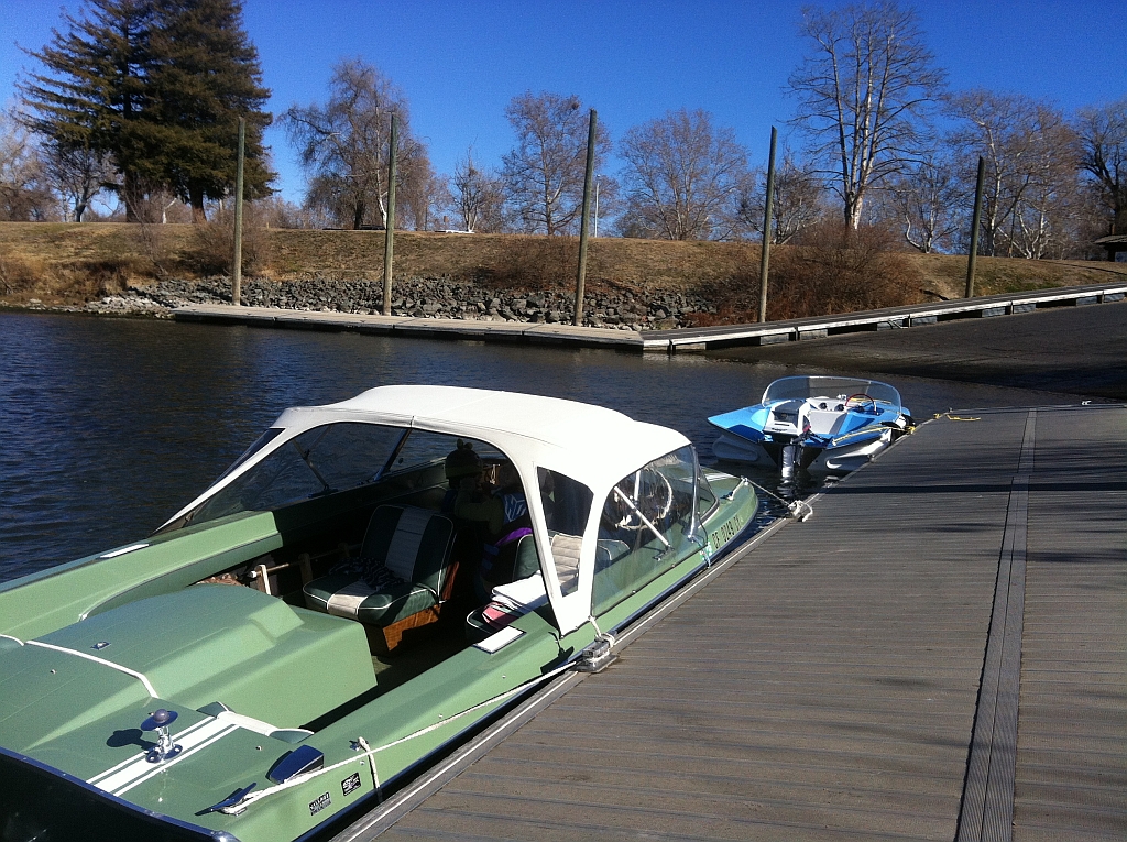

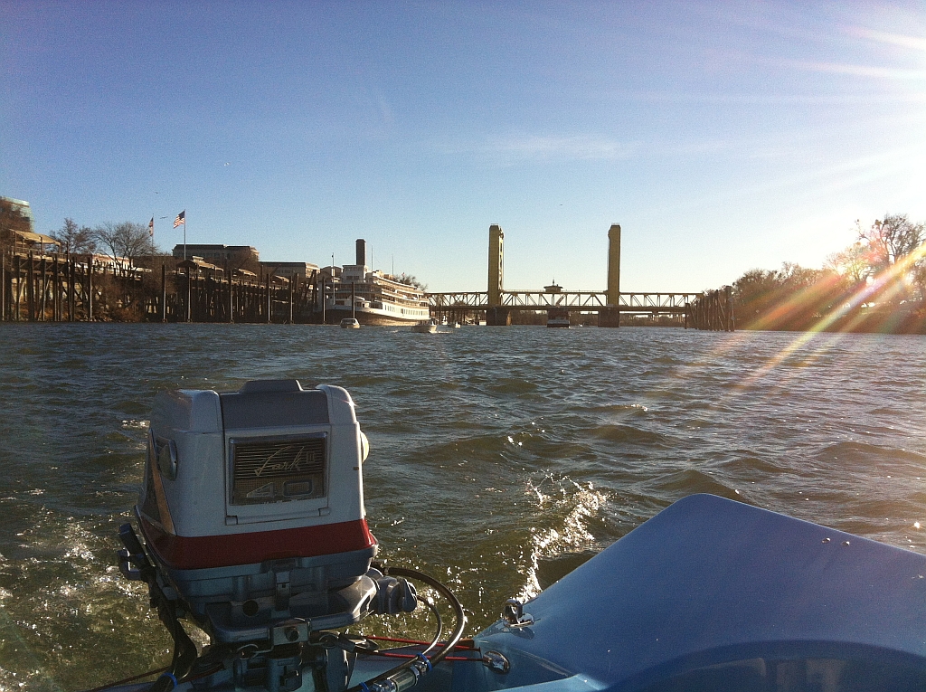

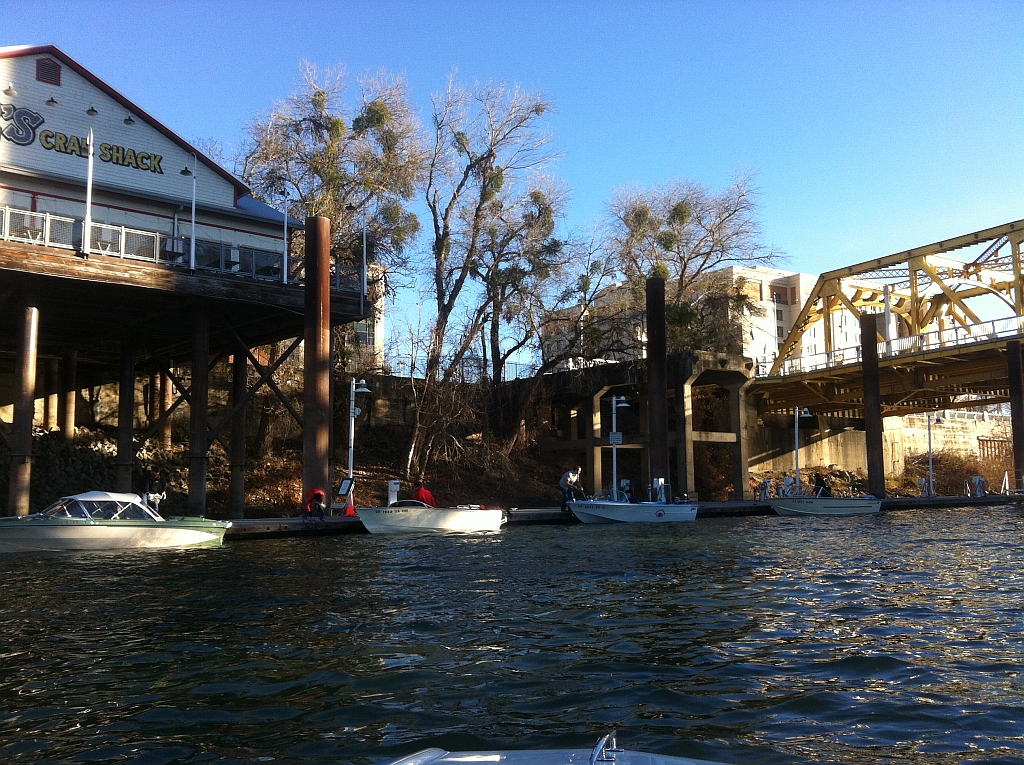

...since she's seen any water, over 25 years. I'm glad this winged glassic will now cruise our waters and will be truly enjoyed by her family and friends. So cheers to all who were involved, to all that were present to share this day with Mercedes and me.
Leaving Old Sacramento

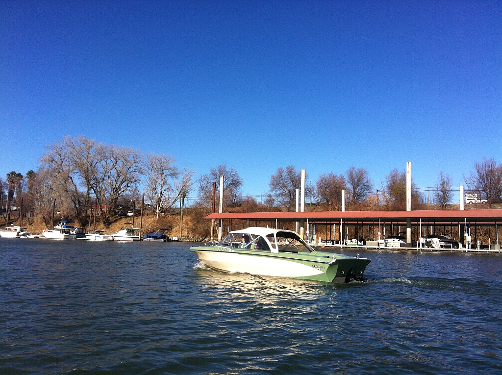

This is my good friend Glenn and Lan in their '62 Trailorboat Savoy. This is the boat that got me into these glassics. He's been there for me during all my shakedowns. Thanks Glenn.

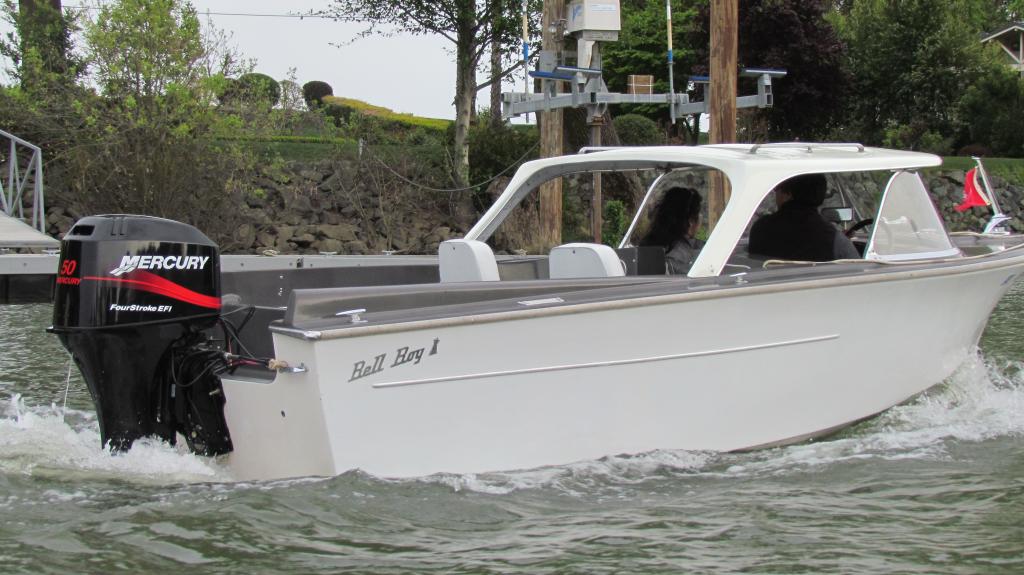

Thanks Doc. I appreciate that coming from you. I gave my '58 Dorsett El Dorado to my nephew and his fiance then. They enjoyed her in the beginning then he was busy with the wedding and hence, didn't look after her. So I encouraged him to let her go. So now she is in the good hands of a friend of mine in Bakersfield, CA. I sold the '64 Sea Ray in '06. I still have the '58 Bell Boy Banshee and '59 Bell Boy 265 Hardtop. You'd like the Banshee because she is powered by a Merc. Matter of fact, both Bell Boy boats are, the latter is a modern 4 stoke Mercury. I'm thinking of selling the Banshee now that the Jet Flight is done. It's hard to let her go though; she's a beautiful finned glassic.
Eduardo
Can you tell, I'm a fan of the Northwest glassics.

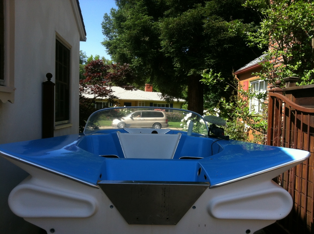

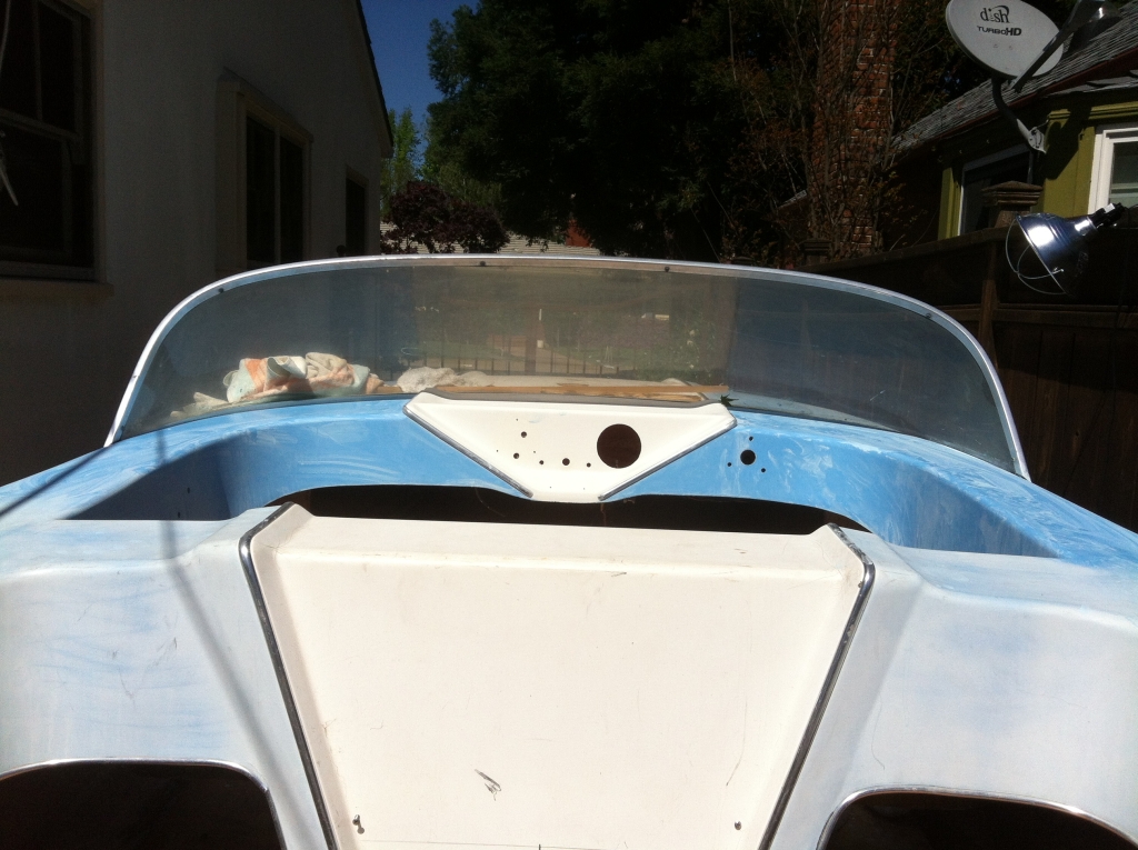

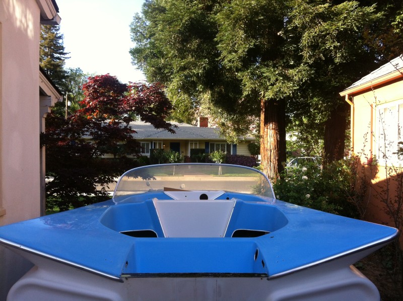

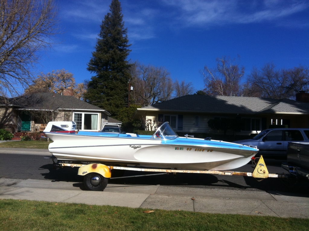

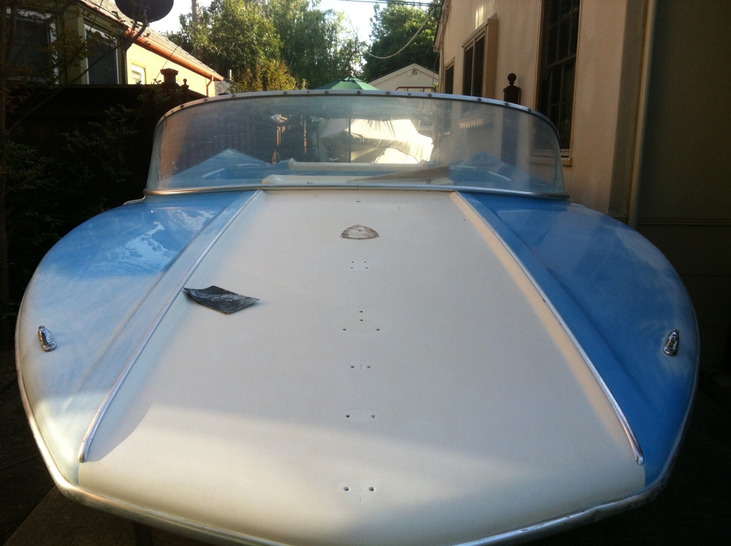

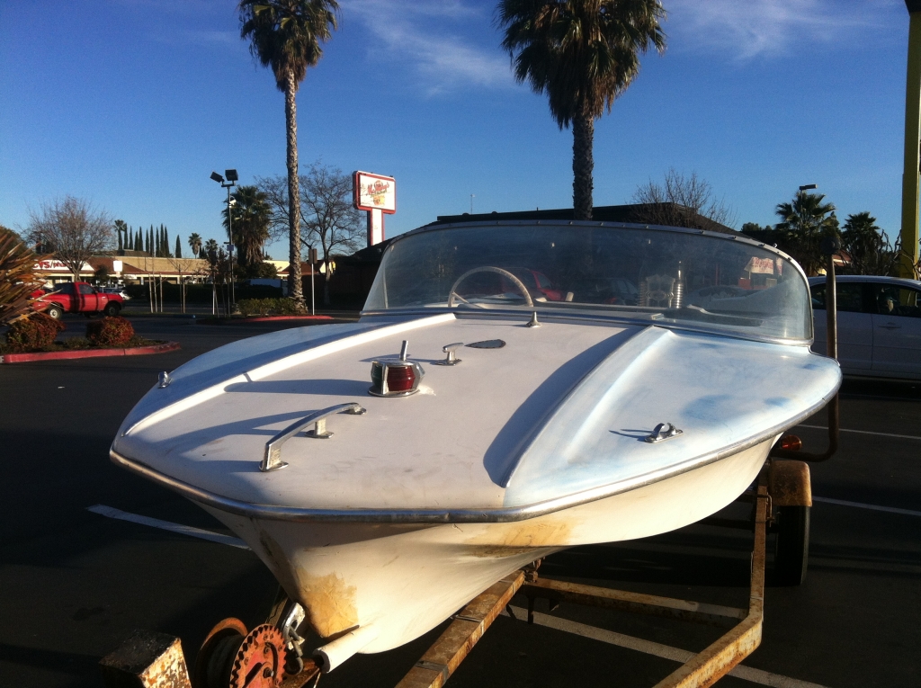

Before and after... 11 years 5 months ago #88781
  • Eduardo
  • Posts: 309
  • Karma: 35

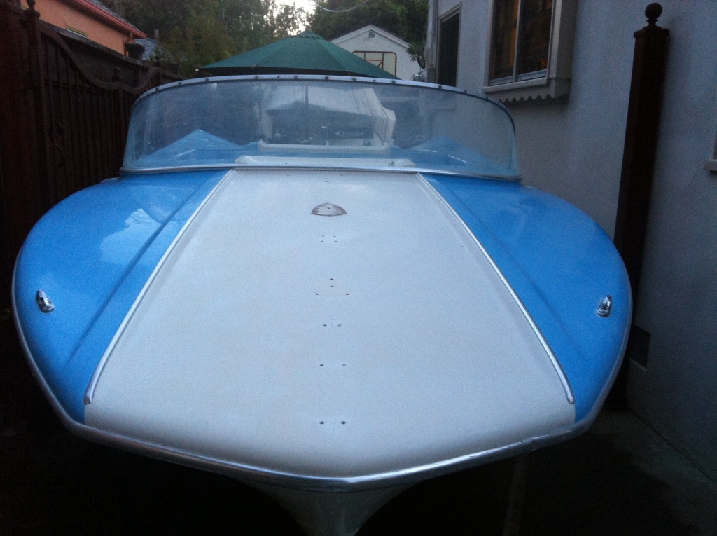

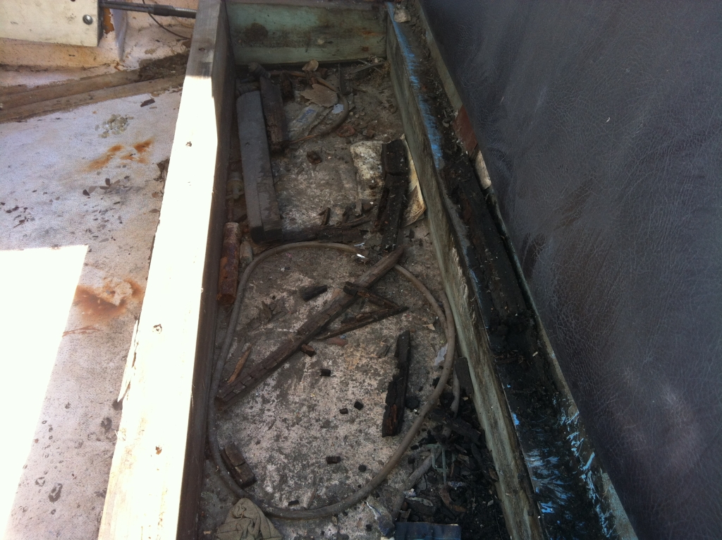

...images.
Sanding process next...

Great Job Eduardo ! Love all your Northwest Boats - nice to see them coming back to life. Whats up with the red Reinell from Arlington ? Now that I have my Trailer done I hope to get the cob webs knocked off the flyer and possibly get it wet this year ??

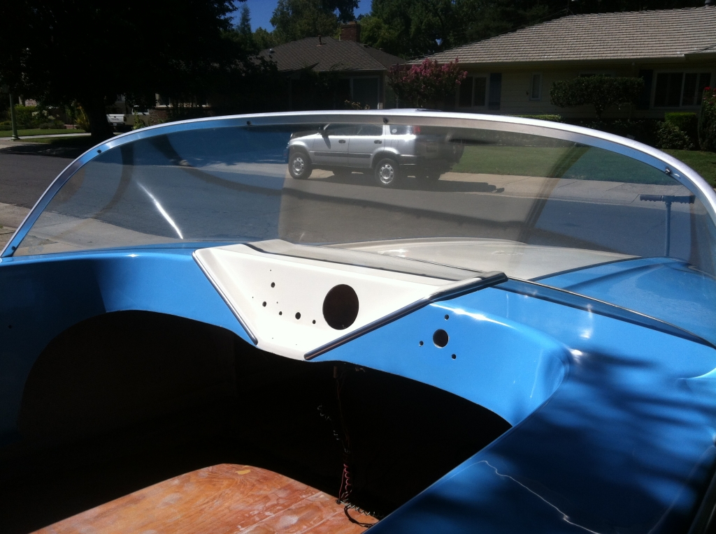

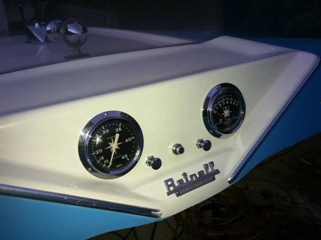

Re:Shakedown of our Reinell Jet Flight... 11 years 5 months ago #88783
  • Jim L
  • Jim L's Avatar
  • Posts: 1426
  • Karma: 60

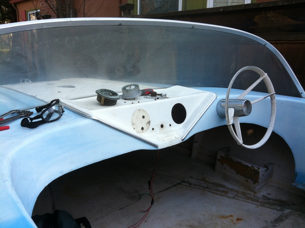

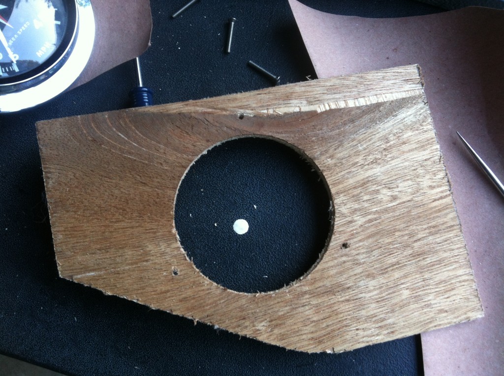

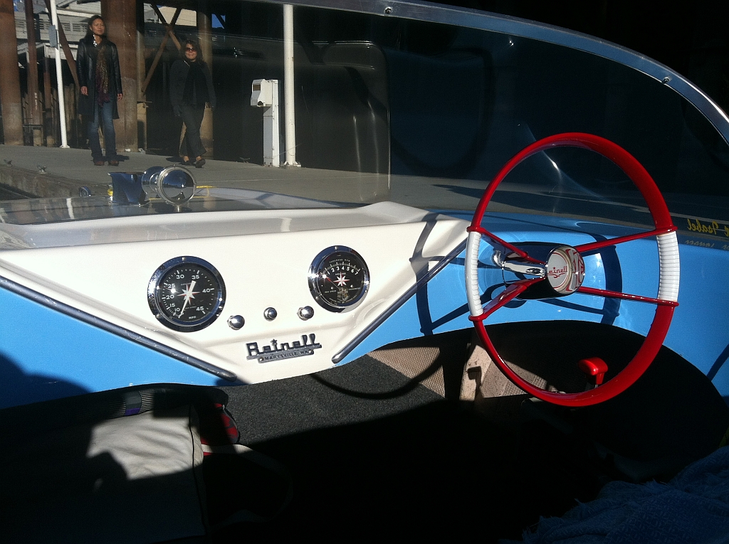

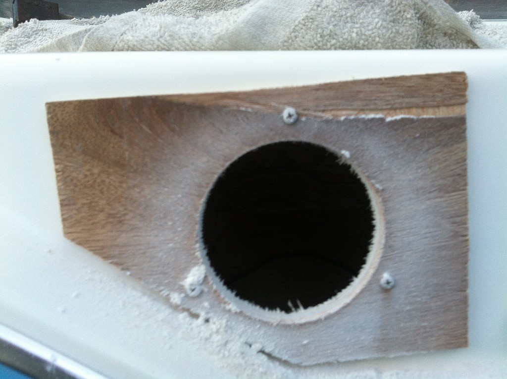

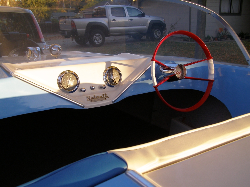

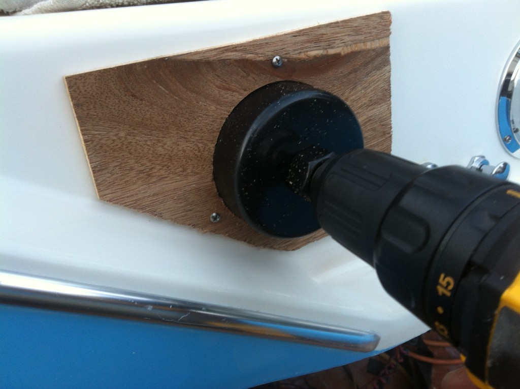

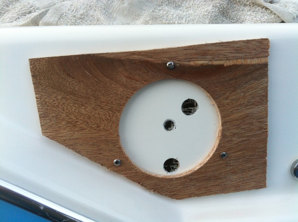

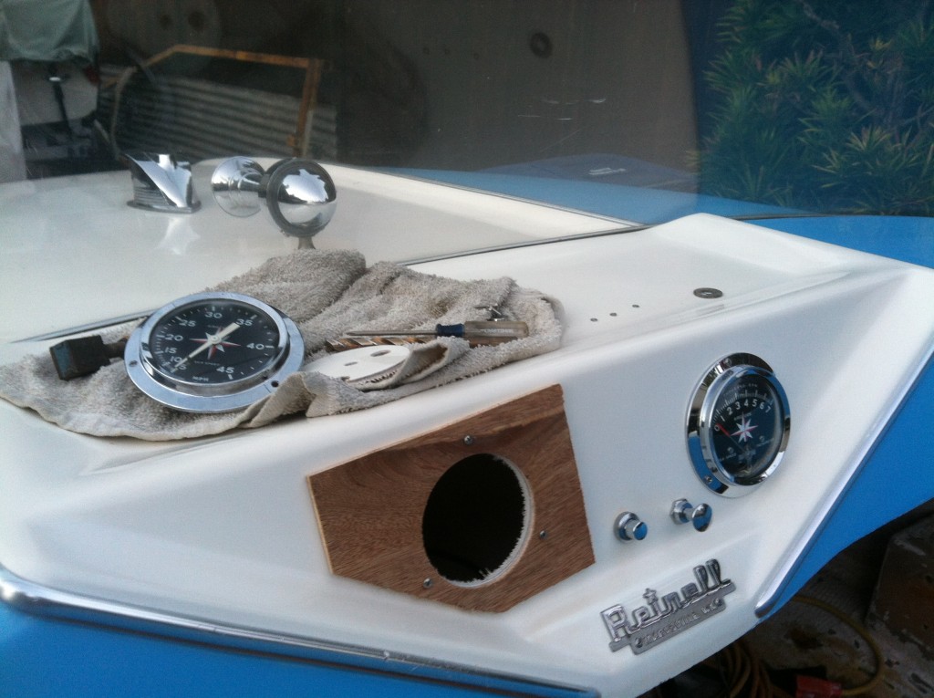

I noticed you cut a hole in your dash for a flush mount speedo. I know from experience that can be a little intimidating lol.

Thanks Rick (bhamrick). Yeah, I’m crazy for these Northwest boats, this one in particular. Yes, I'm in love with our newborn granddaughter, but as far as glassics, I’m also in love with Sweet Isabel. You’re next my friend, to see that beauty of a ’59 Larson Falls Flyer on the water this year. Looking forward to seeing her on the water.

2nd Airguide gauge in... 11 years 5 months ago #88819
  • Eduardo
  • Posts: 309
  • Karma: 35

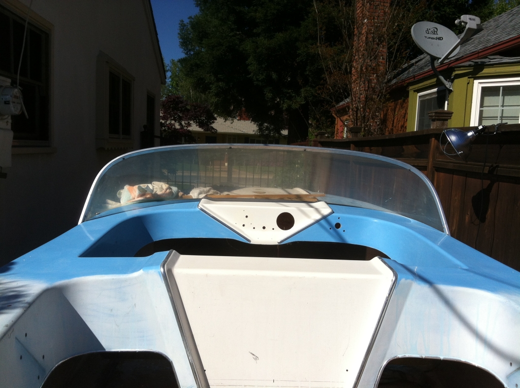

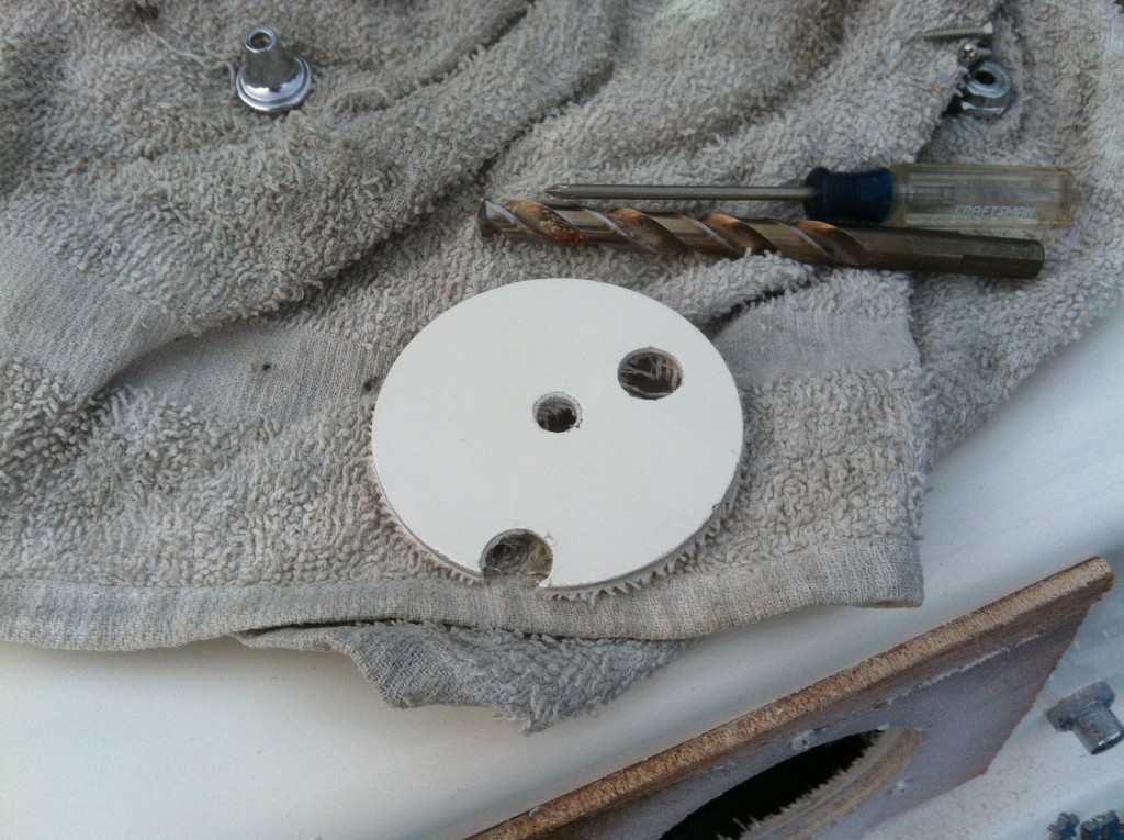

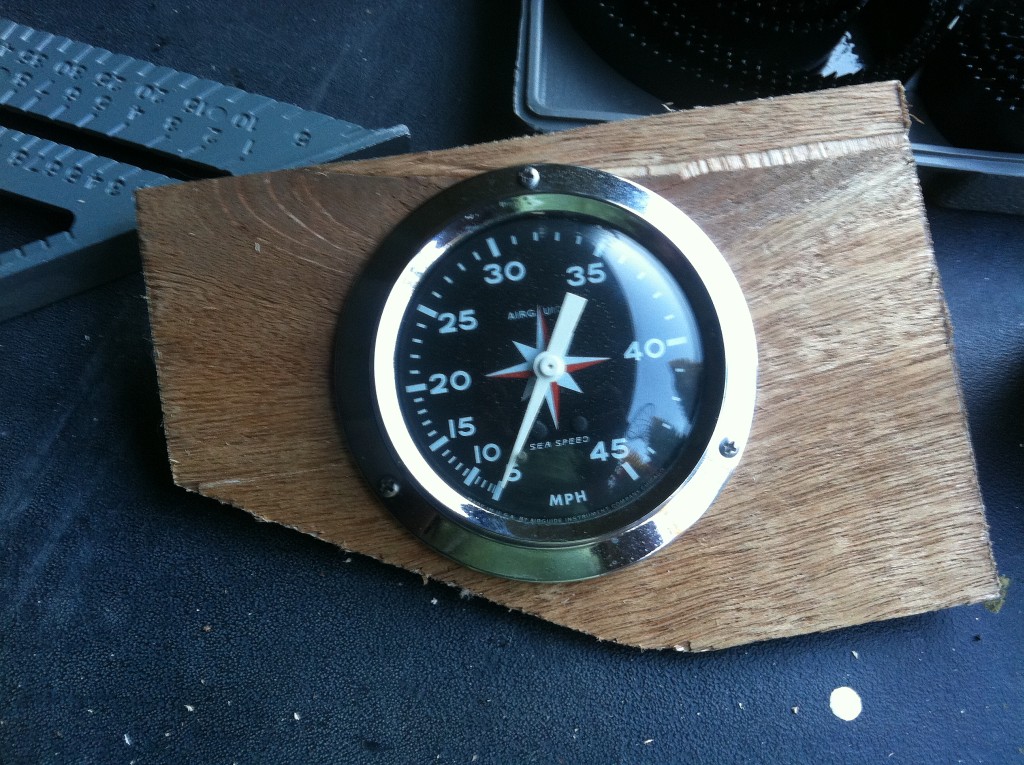

Jim don't get me wrong, I was thinking to myself, "Don't screw up Eduardo." I surely didn't want to make a mistake on this one. The right hole had a Stewart Warner gauge flush mount. The left gauge was a surface mount. The right hole is actually bigger than the outside diameter of the three screw holes on the Airguide tach that I intended to use. So I made a large size stainless steal plate cut like a big flat washer to fit over the back of the Airguide gauge and yet wide enough to overlap the size of the open hole. I drilled the three holes on the SS plate for the tach, and that’s how I secured the gauge on the right side of the dash. Now for the left gauge, I had drilled a hole in the middle to accept a surface mount Airguide gauge. My sister was visiting and I wanted to show her how the gauges would look when done. Not knowing that I needed the center to drill out a 3” hole for a flush mount gauge. When I was ready to drill out the hole, it dawned on me what I had done. I think it was meant to be. I thought about it a while. I made a template instead. The three holes for the screws on the bezel were already drilled in the dash, so I had to make sure that the 3" hole on the dash would work with the existing holes for the screws. The template served two purposes. One to help drill the 3" hole exactly where I wanted, and secondly the template helped to prevent the hole saw from getting away from me. It worked great. Take a look.
Airguide template
Template secured to the original three holes in the dash...
Hole drill out

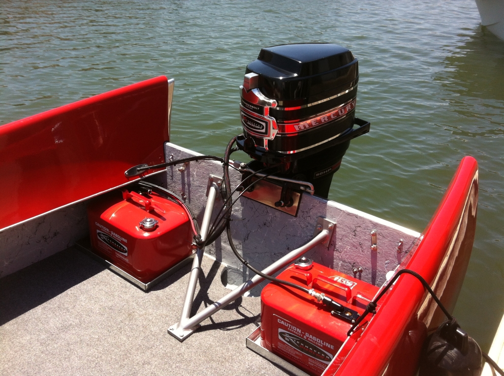

Thanks 1960RedG-3. We have something in common. We both have modern 4 stroke Mercury outboard on our glassics. I used to own a ’60 G3 as late as spring of 2013 before I sold her to a good friend in SoCal. Btw, your red G3 is beautiful. The Jet Flight and the G3 have subtle similarities like the long bow deck , seating at midship and dual cockpit. Even the hull are similar in design. The Jet Flight is just couple of feet longer.

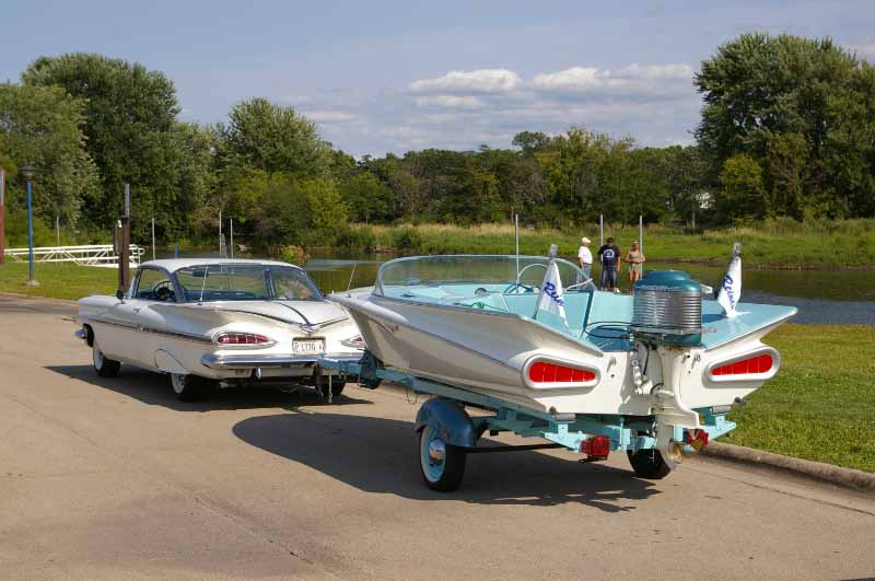

Nice Job,, I have had these side by side with a G-3 and the bottoms are very similar not 100 percent but close,,,I have ran 6cyl mercs and 4 cyl mercs and lovr running this boat,,Glad you got it done you will enjoy it Bill

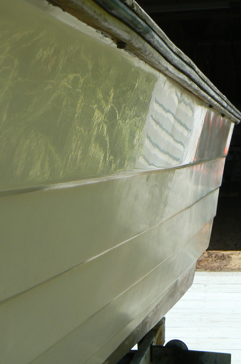

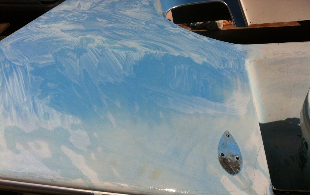

Bringing her color back (sanding)... 11 years 5 months ago #88892
  • Eduardo
  • Posts: 309
  • Karma: 35
…was a challenge. She was heavily oxidized. First I started with 800 but that didn’t seem to work that well, so I went down to 600 wet sand paper, one pass, a couple passes with 800, then 1000, and worked my way to 1500. I was fortunate to have a decent thickness of the original gelcoat, because of the condition, I really had to be aggressive to get her original color back. It’s hard to say how many hours I put in her with just sanding alone, but I probably put in over 50 hours. Even after sanding with 800, you could really see her color coming back. I sanded the last pass with 1500. Take a look.

Re:Our '60 Reinell Jet Flight... 11 years 5 months ago #88911
Excellent job. i did the same thing with my hull, only I started at 400 and went to 2000, then rubbing compound, polishing compound and then wax.

Re:Our '60 Reinell Jet Flight... 11 years 4 months ago #88990
  • Eduardo
  • Posts: 309
  • Karma: 35
Hello Bob. Thank you. Wow, you really had to be more aggressive starting with the 400. I was a little apprehensive starting with 600 grit. To which boat are you referring? I don't think I've seen your fiberglass boat?

Re:Bringing her color back (polishing)... 11 years 4 months ago #88992
  • Eduardo
  • Posts: 309
  • Karma: 35

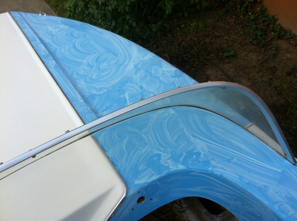

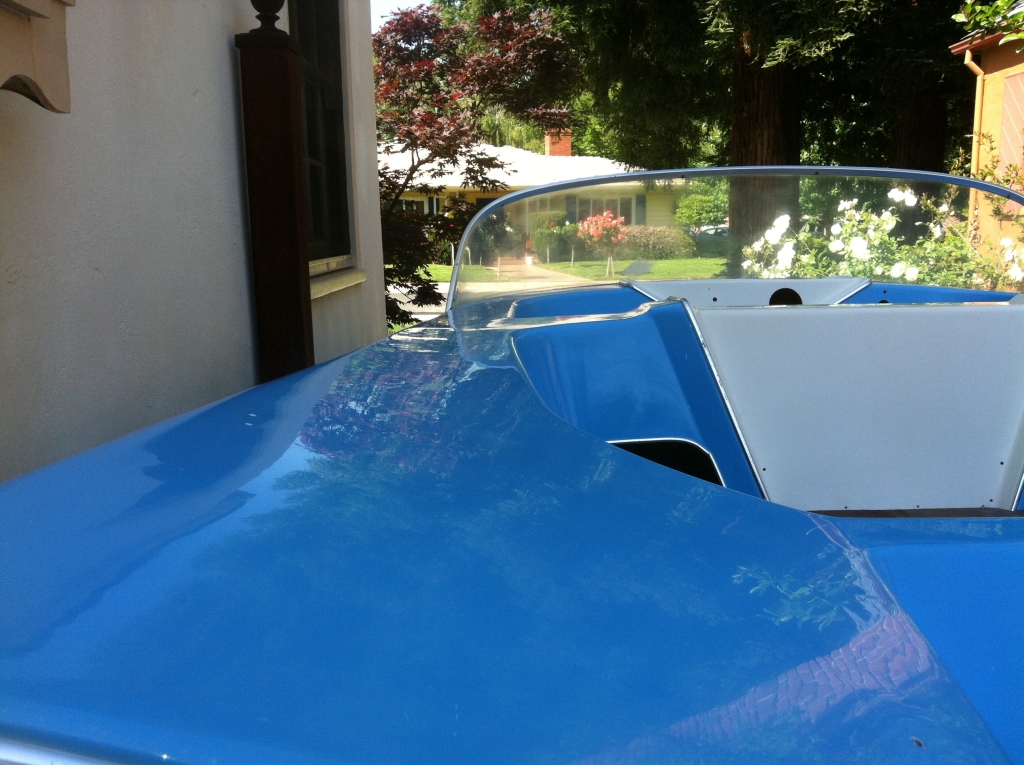

After the sanding was done, the next step was the polishing process. I polished first with a heavier grit polishing compound, then went with 3M Finesse It to finish it off. Then two coats of sealer, Starbrite with Teflon, and then finished with 3M Performance Paste wax, as described here on Fiberglassics.
It’s amazing to me how gelcoat can be restored to look not quite but almost new. I don't know but it's something about a gelcoat finish, maybe they way it feels or the warmth that it gives you. This finish turned out beyond my expectations. I mean I didn’t think the outcome would turn out like this. I’m very lucky I was able to restore her original gelcoat finish rather than having to apply a new finish. It's not perfect, but it's very presentable. There are stress marks hear and there, at a couple of corners of the center deck, and aft, the common areas. But these are very minimal, character marks I call them. I love this vintage color. What’s interesting too is the way they finished the color combo on this Jet Flight. Usually you’ll see the color along the center of the boat. This Jet Flight was the opposite, with the white color along the center and the vintage blue all throughout the deck. It's a great look. Here are some pictures after the polishing process.

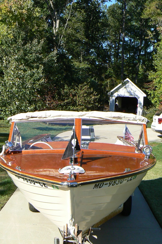

Eduardo,

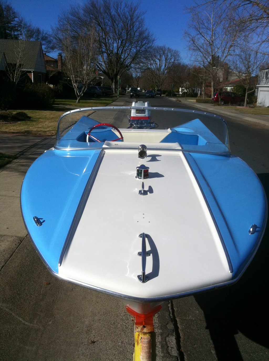

Here are before and after shots of the hull and whole boat.
1960 Wagemaker Empire Clipper 18'

Eduardo,
Bob, way to get her shine back. It's a lot of work and a lot of sanding to get her looking like that. She looks fantastic. Well done.
