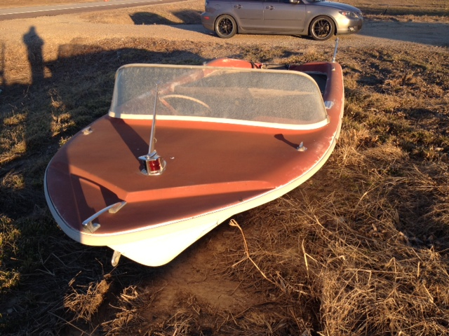

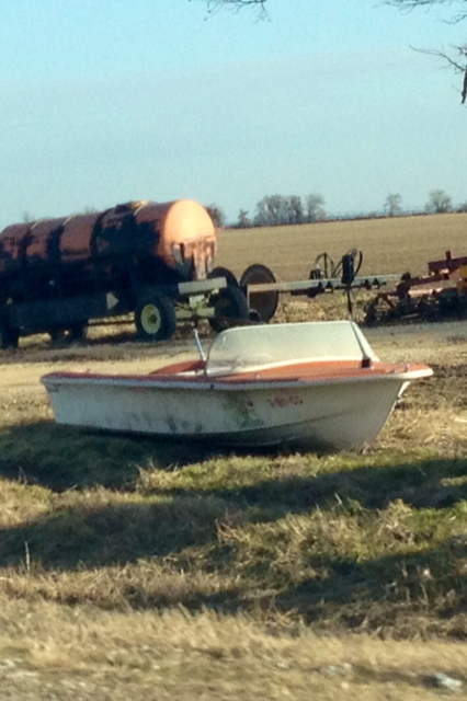

Looks like a 60's Razorback, maybe the Utility series or ski-master. What do you guys think? Just found it on the side of the road in a field, no houses around, just a farm. What do you guys think?

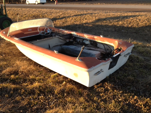

More pics
Re:60's Razorback 11 years 5 months ago #88726
More pics

Very cool looking boat. Nice bow light. I's see if it was for sale if possible.

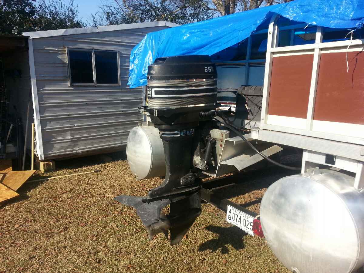

Yea I love that it has all the trim pieces on it! I want to do it up so bad, already hitting up craigslist for motor. Think a 1978 85HP Merc too much for this little 15 foot?

I think an 85hp 4 cyl Merc would be perfect for it.
It looks like it may have a short 15" transom and unless you would be putting in a new transom that is 21" high for a more common 850-4,...Finding a shorty DSH (drive shaft housing) & lower unit for an 850-4 cyl a challenge.
The bow light & pennant or burgee staff look to be a great find.

Oh so the long shaft wont work on a short transom? Sorry VERY new to boats, a buddy of mine has a 58 commando that he takes out every summer. I rebuild old stand up jet skis, not old boats! But I have always wanted one. For some experience I helped overhauled a 1976 VIP, took a couple months, did all the interior and fiberglass work by hand. Even painted it in the garage. It was work, but I had too much fun.
Anyways back to the transom, yea its short, around 15 inches. So I will need to get a short shaft motor? Im assuming this thing I found on craigslist wont work then?

You really should NOT exceed the USCG rating for any boat. - In this case: FIFTY HP.

That boat would be real sharp restored. I like the rounded gunwale and above the transom. Are those side mounted seats?

And the pontoon motor looks like a long shaft OB:
And is 70% overpower if it's an 85hp, not wise, IMO either.
