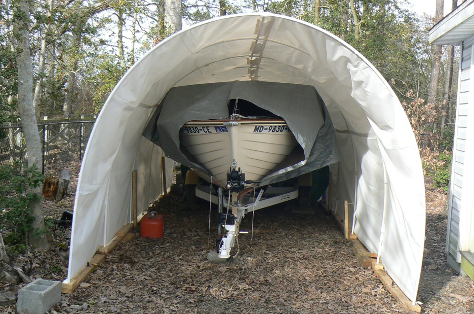

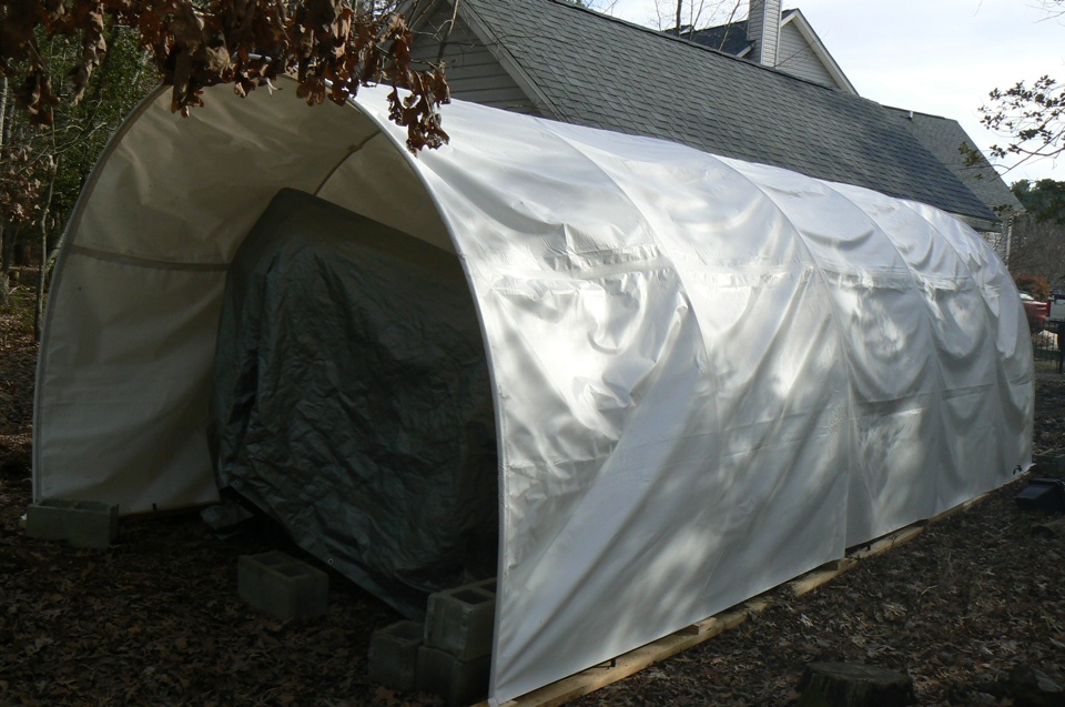

Ok, so I haven't made any posts of my own for a while so here goes. After reading the thread regarding winter storage I decided to get the Billboard Sign vinyl, 20'x25', was actually only $50 and considering the $35 gray ones have only lasted a year at beast I figured money well spent. I used 3/4" PVC down the middle with 1/2" PVC for the frame sides. The 1/2" bends easier with out breaking. I made glued a few strategic straps at each side brace to keep it from shifting. Also glued some longer sleeves to the top to hold the 3/4" so it won't shift around.
I recessed the side braces into 2"x4"s with galvanized bugle head screws put through them so they won't lift out, then I used 3/4" black spikes from Lowes, the ones with staggered holes in them, and pounded them into the ground, through holes I drilled into the 2"x4"s. Shouldn't go anywhere in the wind now. It's been up for about 2 weeks now and no problems (knock on wood)! LOL

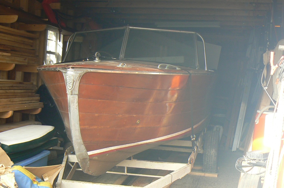

I now have the Century in the shed so I can get started on restoring her. Sorry the pics is a little washed out due to the bright sun behind me.

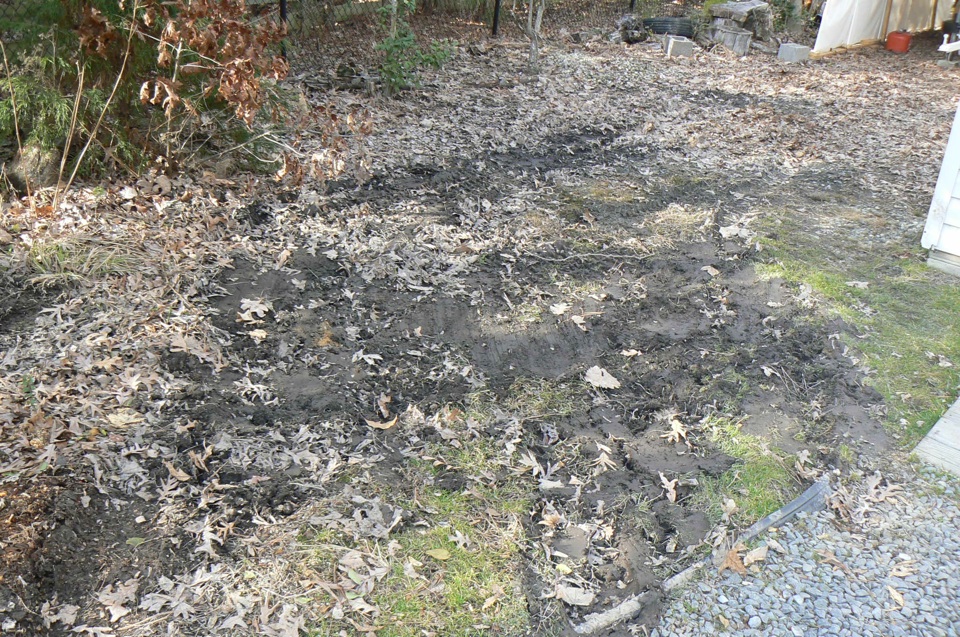

It wasn't easy getting the boats moved. It's been so darn wet here that the ground was too soggy to use the lawn tractor/boat mover I made. I couldn't get any traction, darn turf saver tires really do save it! LOL I guess I'll need to get some chains since I still want to use it for the lawn.
I had to finally have a buddy come over with a John Deer with a hitch on the front bucket, like Ron's, to come in and move them for me. Tractor never got stuck but sure made a mess of the soggy area. We dragged the bucket across it to knock it down some. I think I'm going to give up on the lawn idea there and just put down some gravel like in front of the shed. I can probably use the truck then. Tried using it before I called my buddy and ended up getting it stuck! Guess I should have gotten the 4 wheel drive model after all, the heck with the gas mileage. ;)
I'm now working on building the cradle to put the Century in to do the restorations finally. well that's the the Admiral says, "you finally going to get started n restoring that wood boat?"

Well the new boat storage works fin for wind and rain but not so much for snow. Sorry no pics. It was dark when i went out to shovel the driveway before going to work. That's when I discovered the problem. I guess there was just enough flat surface for the snow to stay on it and not slide off. It didn't break any of the PVC just bent it with the weight of the snow. The tarp material is great! Not problems with it. I did design it so the the smooth side was out. (There's actually a smooth side and a rough side so to speak. The rough side is waffley due to the fiber mesh between the vinyl layers.) I had to crawl into the boat and push the center up to get the snow to fall off. Unfortunately I bounced it up and down a little instead of just standing up and holding it there so I broke one of the center PVC cross joints. no big deal though only cost a couple of bucks and I'll be back in business. guess I should have gone out and checked it last night when I had a gut feeling. Oh well live and learn. ;)
Re:What I've been up too 11 years 5 months ago #88681
Modify your centerline PVC to include some 3way tees instead of 2way couplers. Then run a 4 vertical legs down to the boat's deck. 1 as far forward & aft as possible, then 2 spaced out evenly in between. You can use another tee as a foot on each vertical leg to help spread the load. That also allows you to run a length of pvc between the feet to keep the verticals spaced out & helps prevent them shifting and no longer supporting the centerline ridge.

JB, thanks the center lines are actually connected with 4 way couplers. Good idea though so what I did do was buy a couple of 3/4" tees and drilled them all the way through for 3/4". Basically drilled out the stops in the middle then cut them in half. Now I can put them up against the top pipe anywhere I need them. Thanks for the idea.
