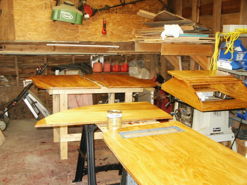

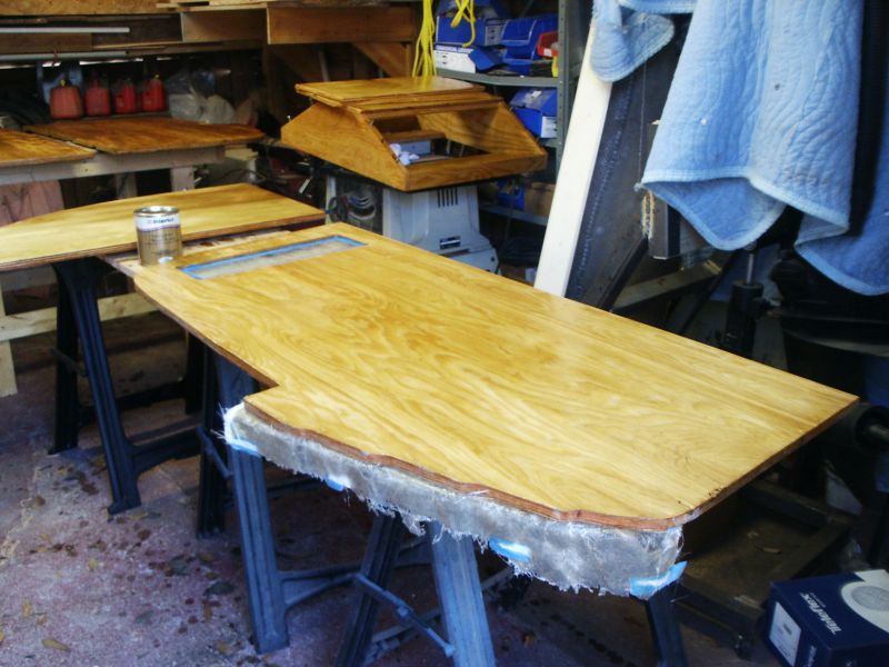

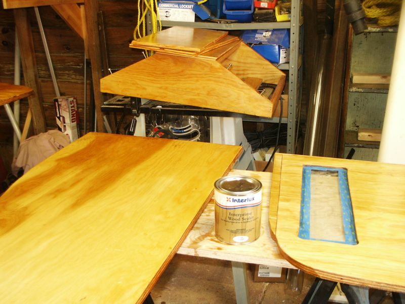

ok we have had some 50's weather for a few days here in georgia, so
i got out and i had some partitions that were bare wood so i got some wood sealer and finally got to soak some wood . a little more trim ad i can finish and then two coats of primer and then on to the bright sides . i thought a few pictures were needed

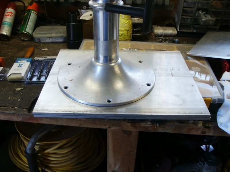

i also got two pieces of aluminum plate to make my seat bases. i will sandwich it between a piece of 3/4 plywood and a piece of 1/2 . i will drill and tap the first set of holes. then if i need to change pedestals i can just drill and tap them in the floor . i will route out the 3/4 then glue the two pieces of wood together
