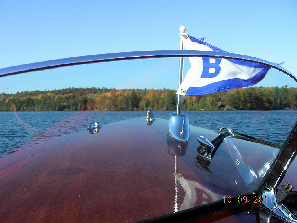

Here's a picture of the windshield with the chrome-like plastic car trim, that I tried to send with the original post.
Re:Windshield edge trim 11 years 6 months ago #87645
Sorry, But I seem to be having problems getting pics to upload?

Re:Windshield edge trim 11 years 6 months ago #87657
Randy,
The trim I used was NOT the U-shaped door trim, but rather something trim that might be used to high-light a horizontal line, or maybe around a wheel-well?
It is D-shaped, and sits on top of the flat edge of the glass.
I'll try again to post a picture,
Bill.
Re:Windshield edge trim 11 years 6 months ago #87660
Pic?
Re:Windshield edge trim 11 years 6 months ago #87661
The pic is 2.93 Mb, but is being regected as too large.
I must not be selecting it from its file correctly?
Re:Windshield edge trim 11 years 6 months ago #87665
Found a smaller pic.....Trying again.
