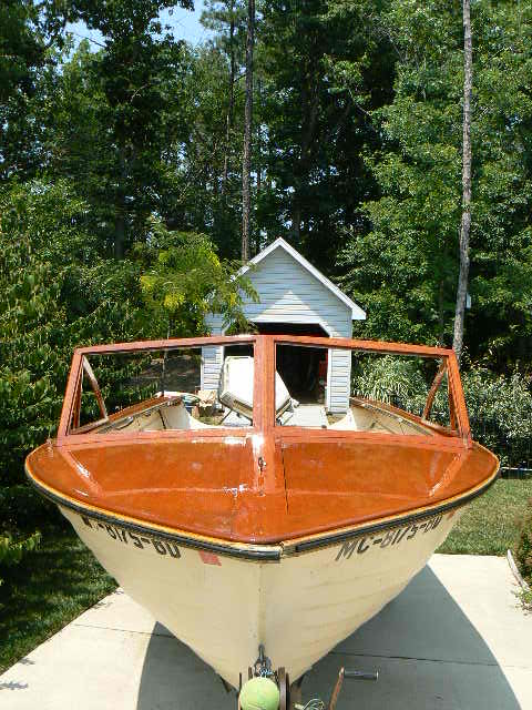

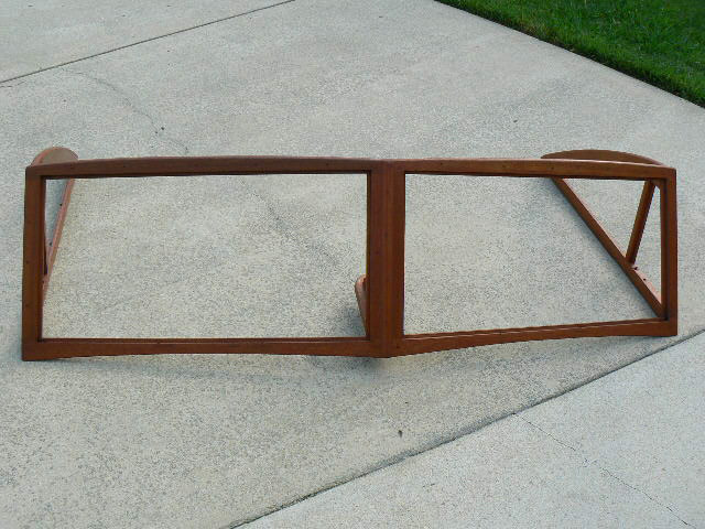

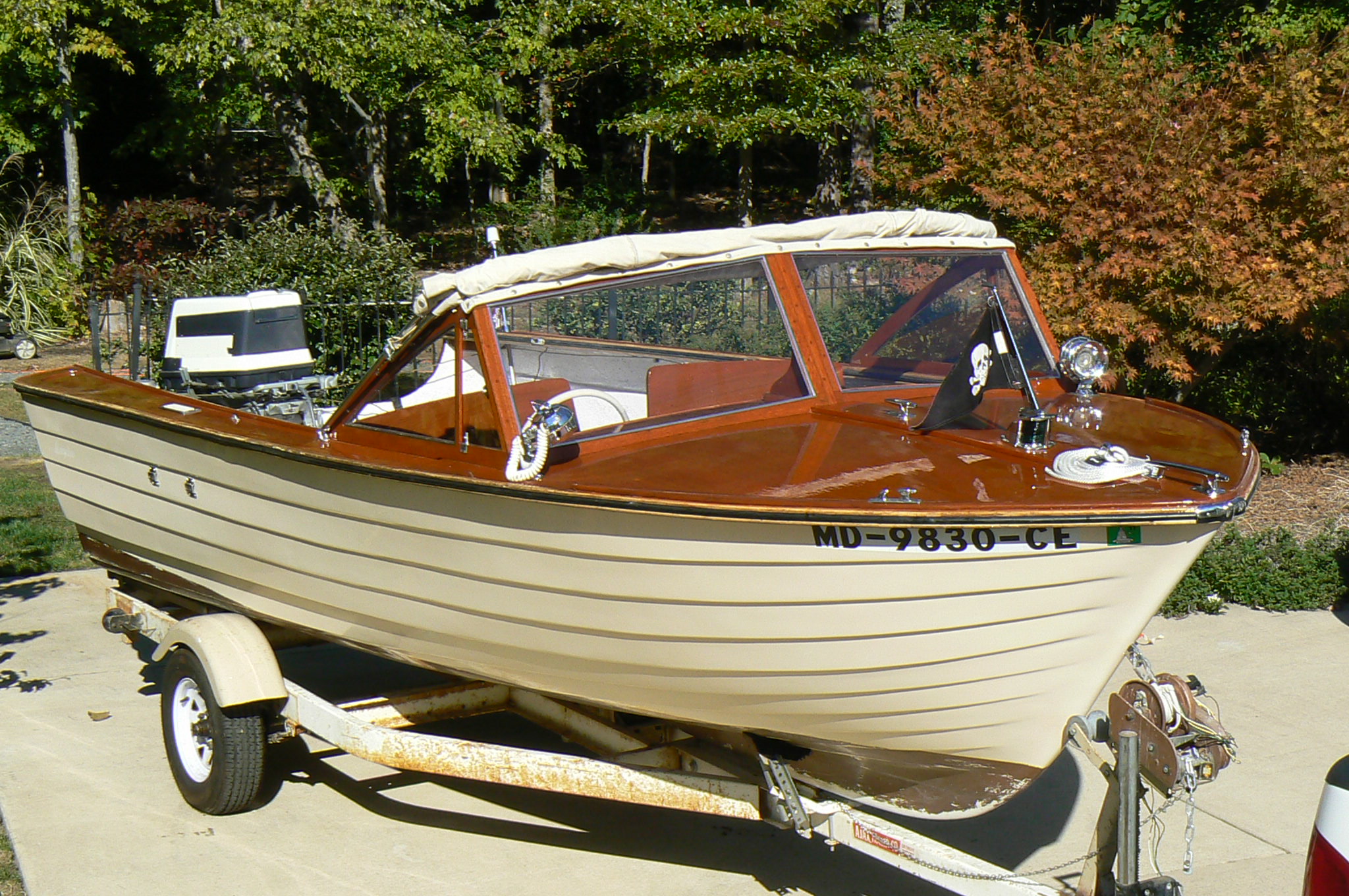

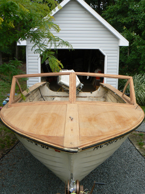

Ok didn't know how to post these to the gallery so I'm trying here.
This was my grandfather's boat. When he died my dad bought it from my grandmother and he passed so now I have it. It's been a lake boat all its life. It's been in a garage all it's life and hasn't seen water since 1980. Is hould have taken some before shots but I forgot. Also my dad had already stripped it and started refinishing it but left a can of oil on the port bow. It leaked and raised the varnish. I stripped the whole thing and started from scratch. I wasn't sure what color filler stain he used or what was factory so I just used Interlux CC Red Mohogany.
Yes that is a 1959 Evinrude "Fatty" Fifty on the back. I have the original Jubilee starter/choke plaque and Attwood steering wheel. They're off in the garage for the renovation.
Here are the stained pics:

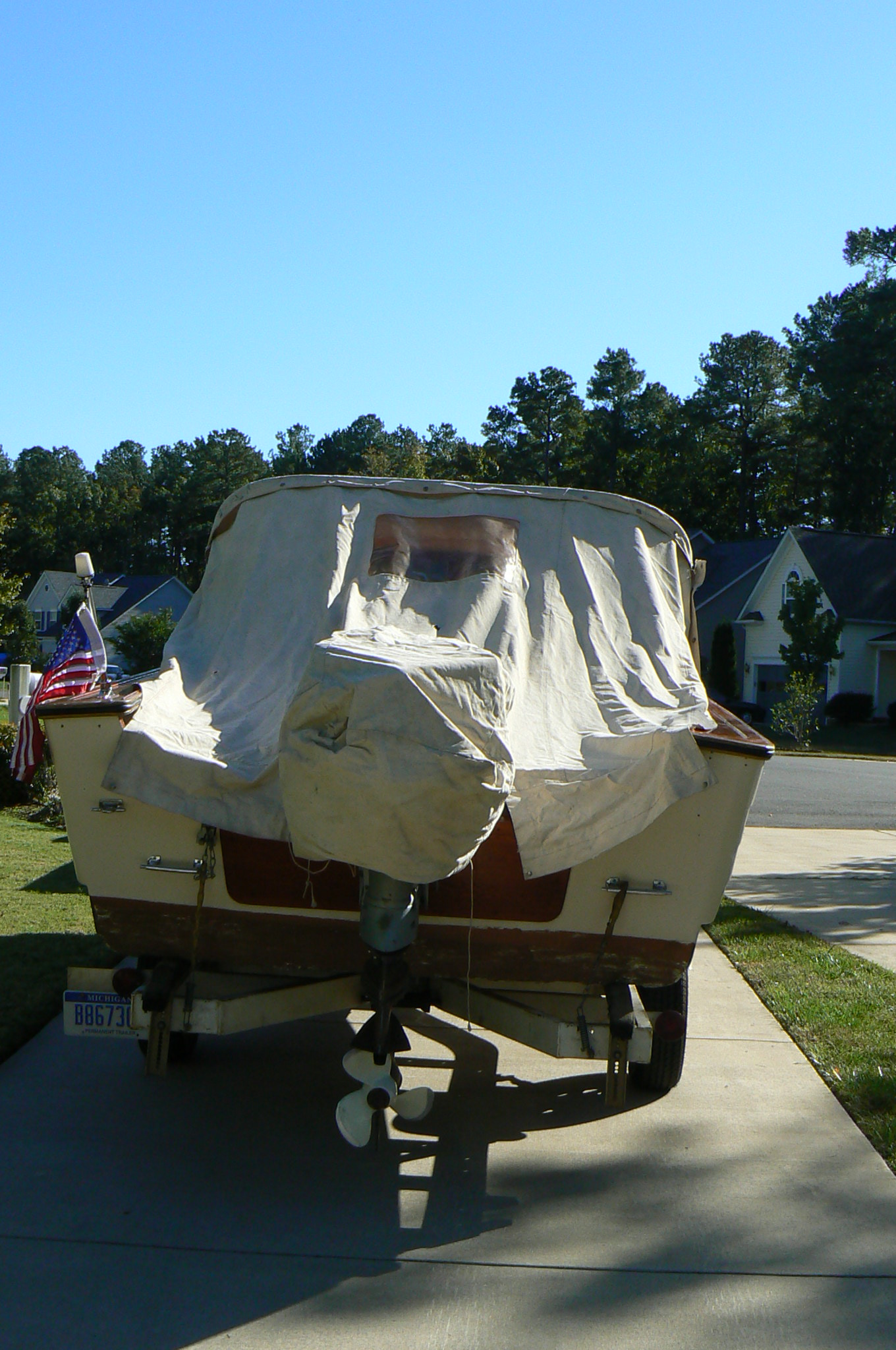

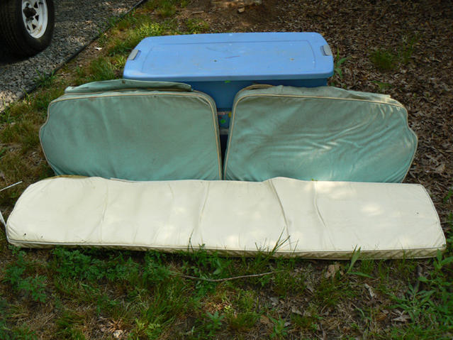

These are the back rain cover and cushions. The cushions will be remade to original specs.
I'll post more once the varnishing is done. I'm coat 3 now with 9 more to go.
Let me know what you think.

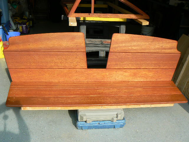

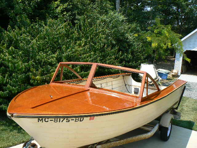

Ok, here are some more of the long awaited update pictures. The bench pic didn't come out good so I have to retake that one. My scanner is on the blink so I haven't been able to scan in the original Wagemaker brochure. That's coming soon.
The reflections on the bow are from the bushes. Not the best area to take pics but it will have to do until I can get her done and launched for some good water pics.

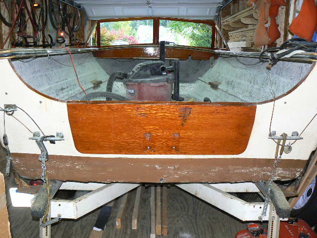

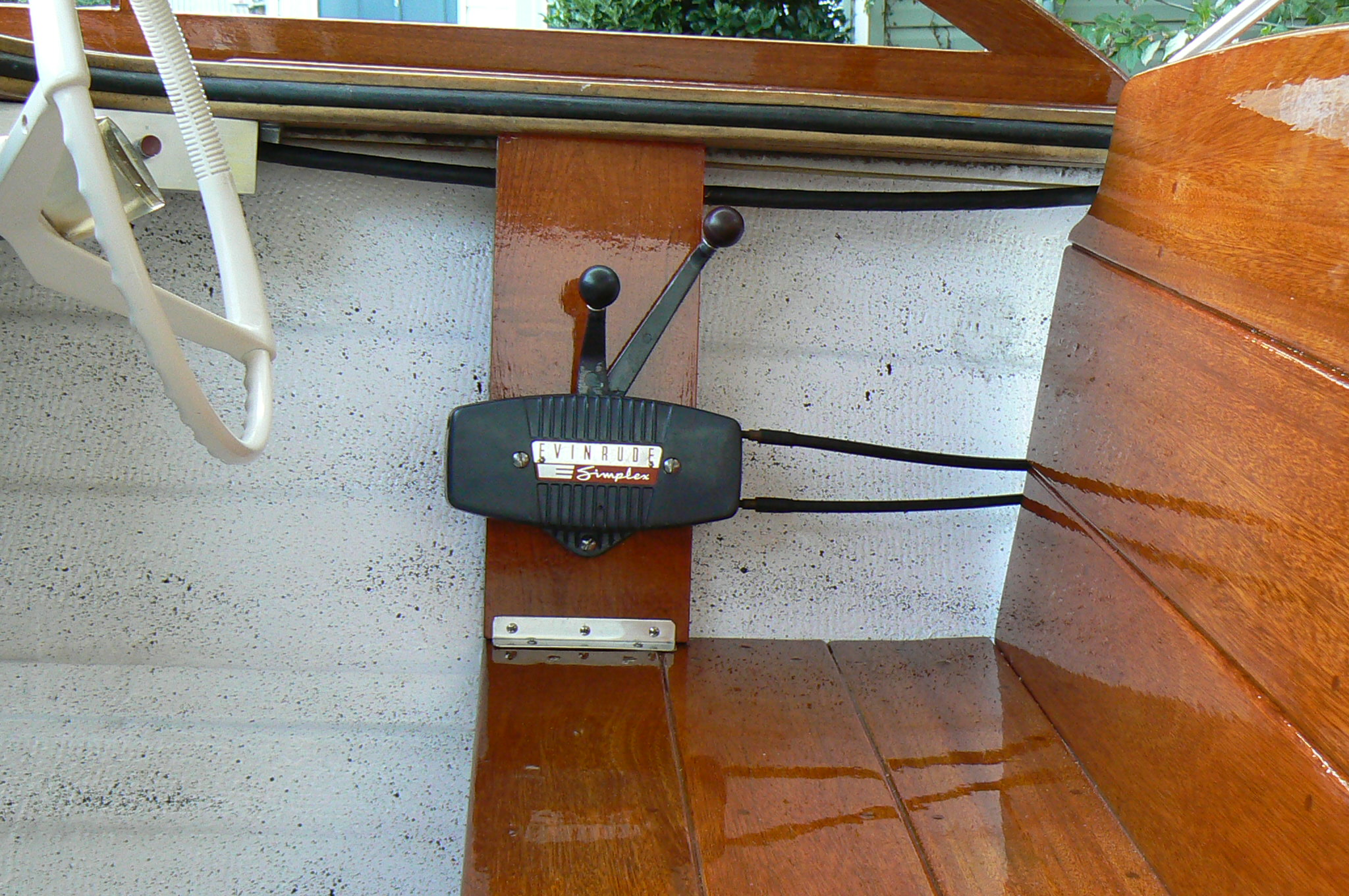

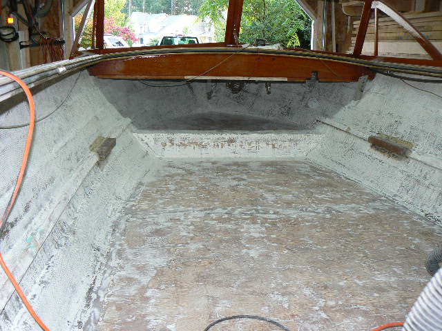

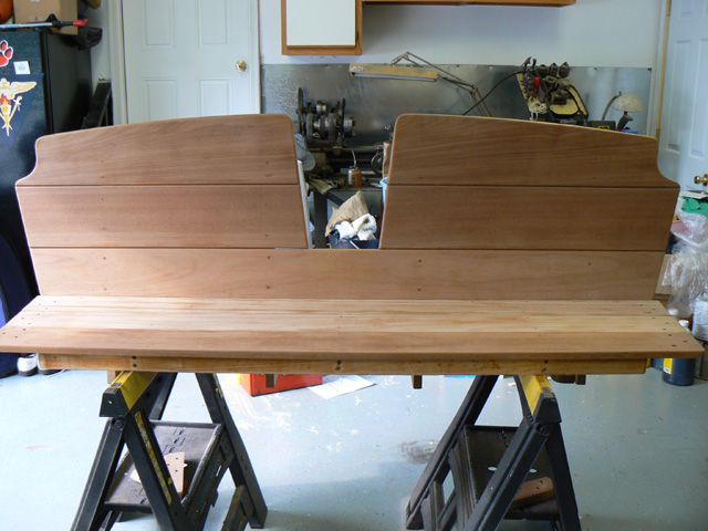

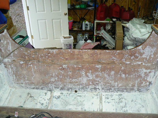

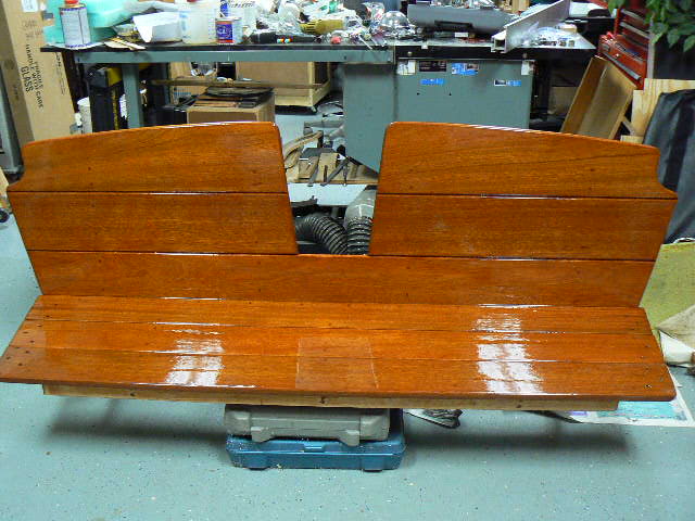

OK, here is the long awaited Bench pic and some pics of the inside stripped.
As you can see I still have to sand add more varnish to the transom engine support.
I also have to decide how and what I'm painting the inside. That question is actually on my 1960 Wagemaker transom help thread.
Re:1960 18' Wagemaker Empire Clipper restoration 16 years 1 week ago #11310
The ad from 1959 suggests a light color (white?).
Just bear in mind you'll have an engine over those marks on the transom, so don't get too crazy with it.
Still jealous. :-)

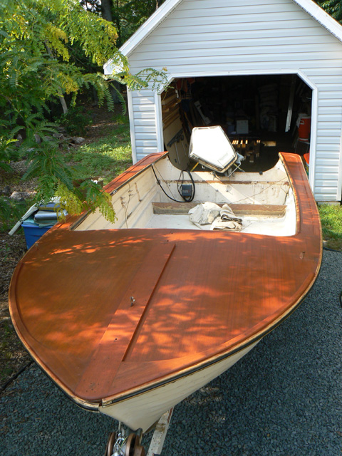

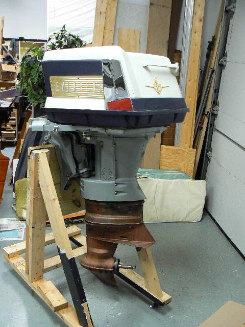

OK,Here's a couple more pics.
The motor off the transom and on the fresh built stand.
Used some 2"x4"s I had left from building the shed. Along with a couple of 2"x12"s instead of 2"x6"s, since I didn't have any.

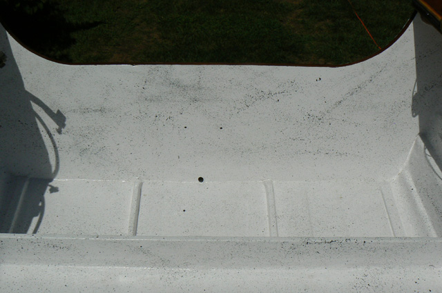

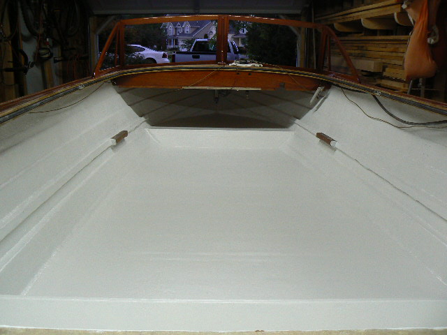

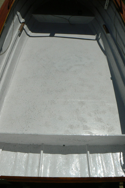

Here's the inside primed. Still have to sand with 320 (per Interlux directions on the Brightsides can).
Hopefully I can start first coat tomorrow after work. This is taking awhile since I can only work on it afetr work and weekends. It's been damn hot here lately! 100 with heat index. Southern Maryland doesn't usually get this hot. Thought I was back in Pensacola FL for while there.
More to follow soon I hope.

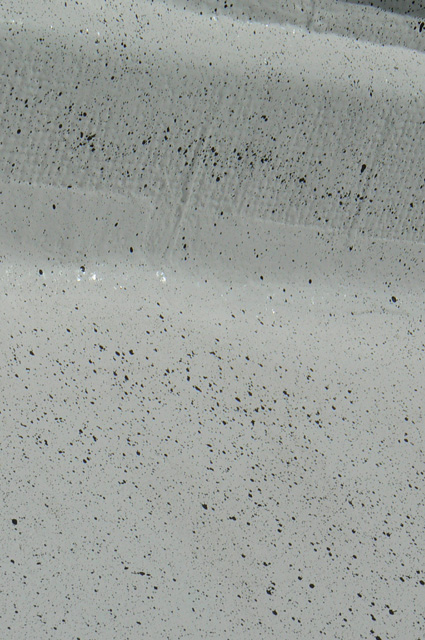

OK so the speckling job isn't as good as I'd like it but not too bad for the first shot at it. Who knows, maybe I'll get it completely right on the next boat! ;) Yeah wife will love that.
I'm working on the hull now, wet sanding. This is with 400, plan on using 800, 1000, 1500 and 2000, then rubbing compound and polishing compound.

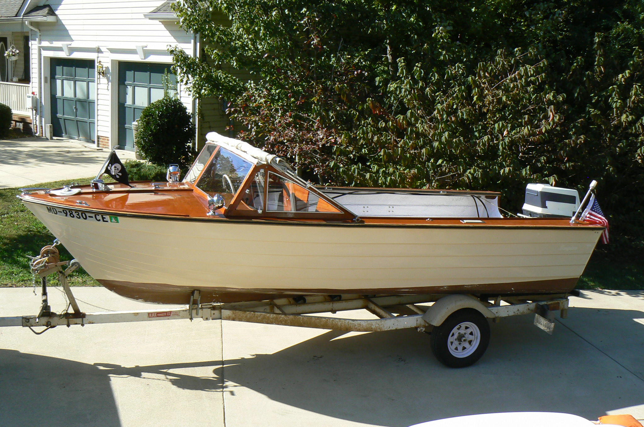

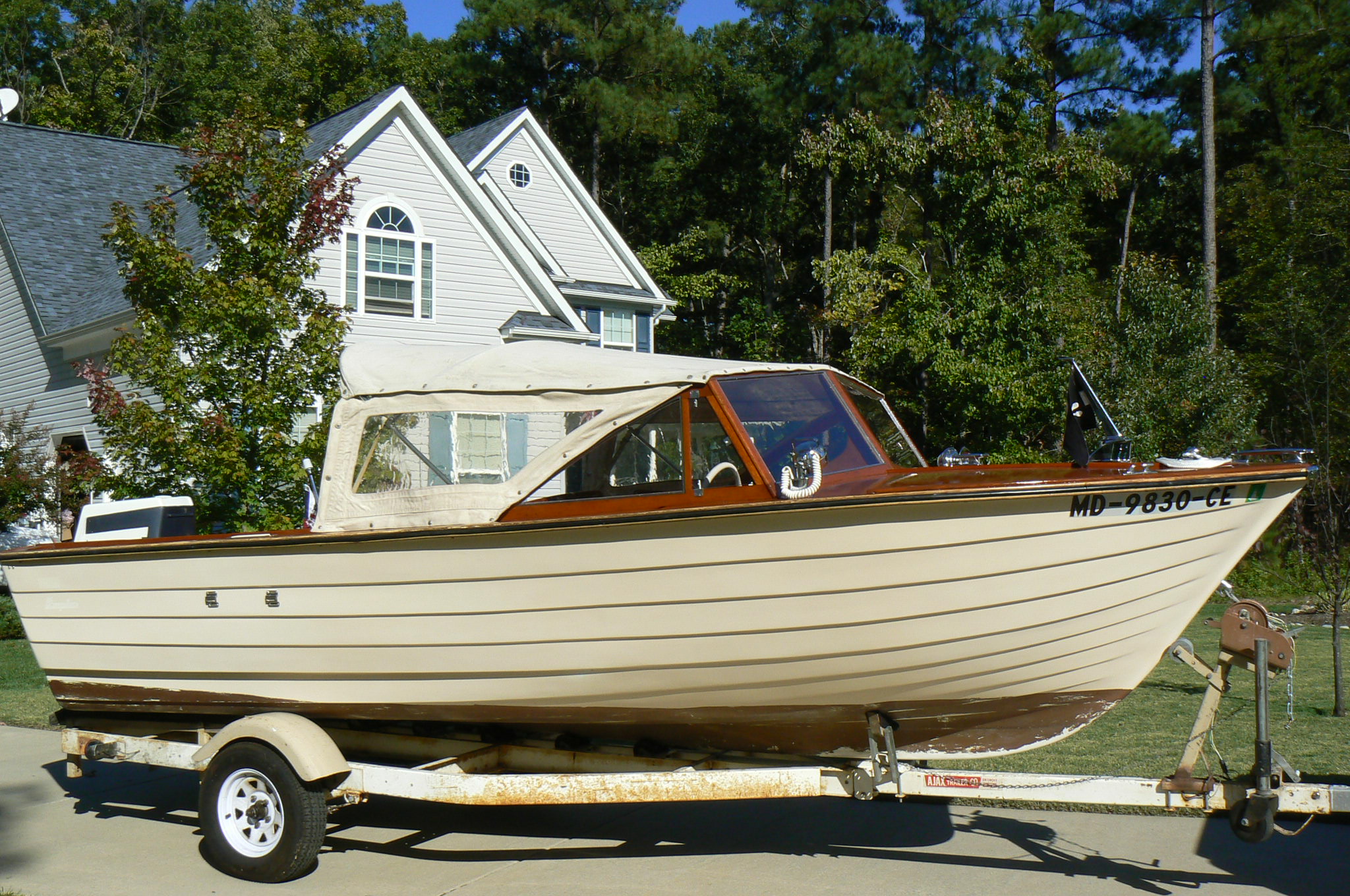

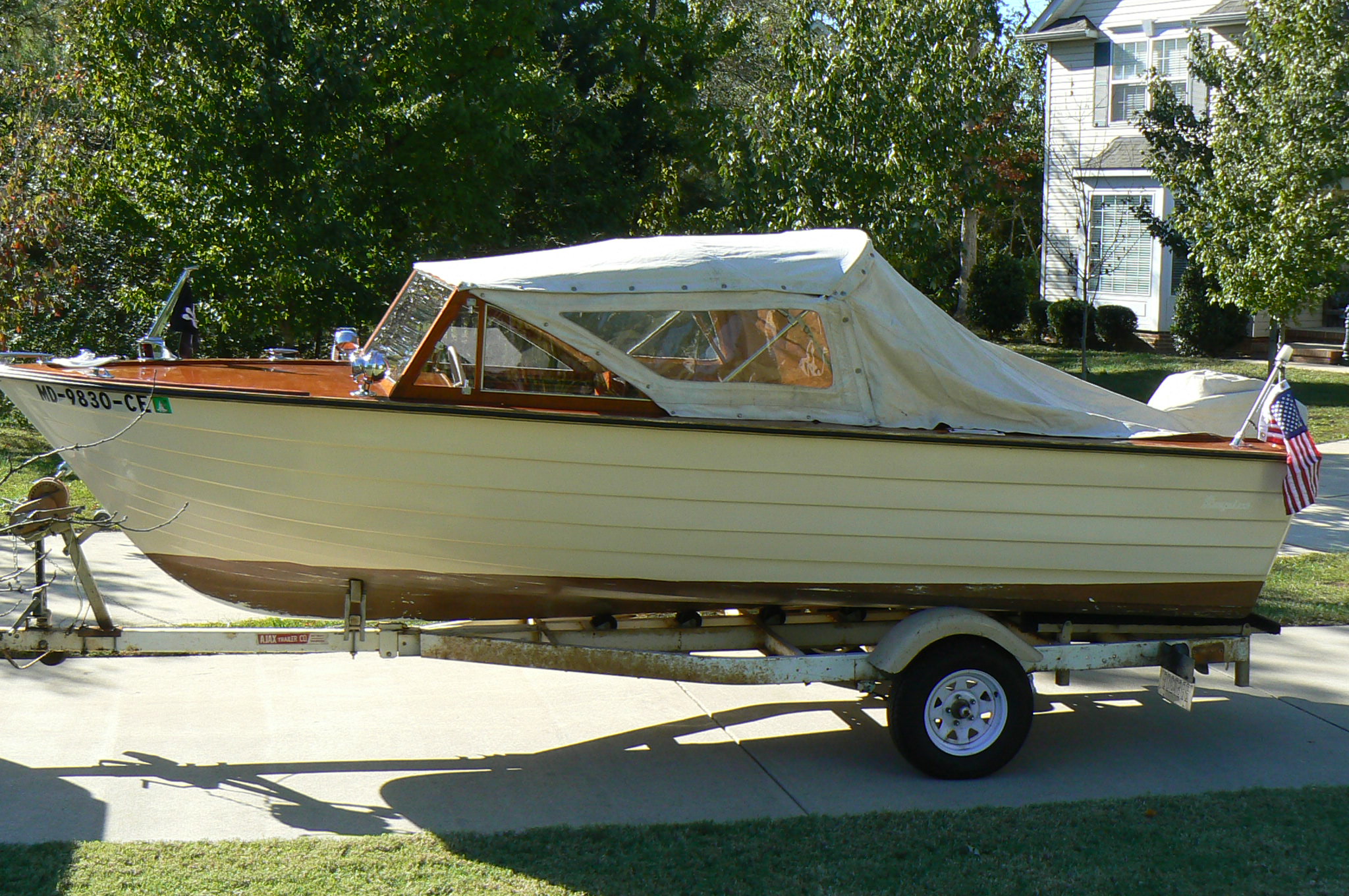

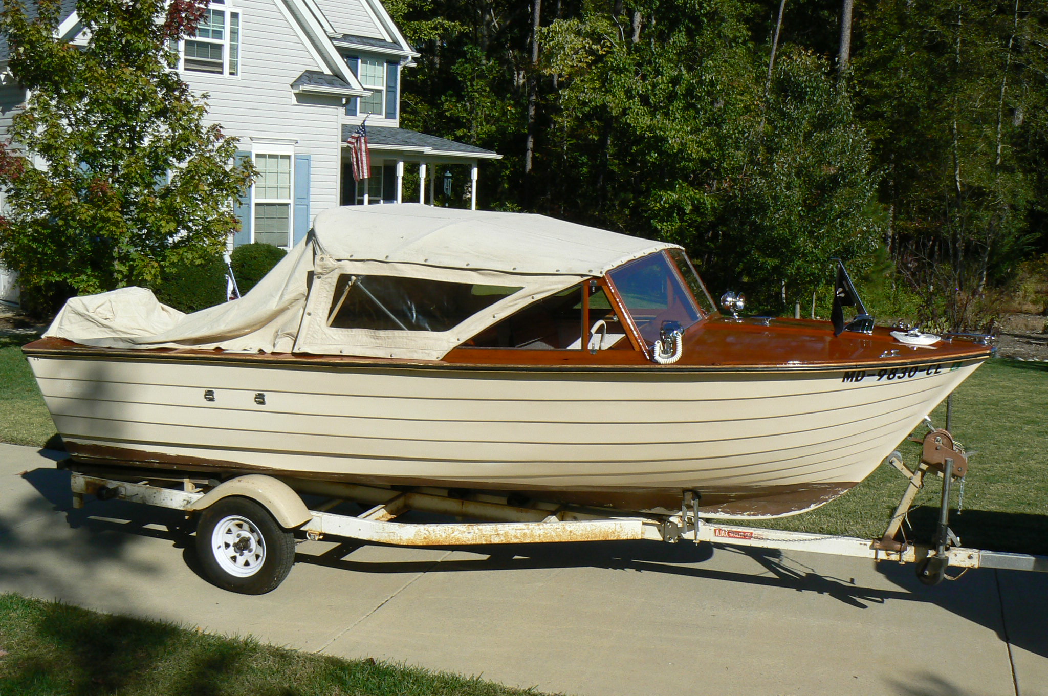

OK, it's been slow going but here are more update pics. She's just about done. Windshield is finally in, along with the vent windows. I have to clean up the rubrails since I still can't find any to match and I also have to paint the Rude Fat Fifty cover. She's been in the water once to tweak the engine once I got her running.
Here she is in half rain gear.
Now in full rain gear.
I have to install the new snaps as you can tell from the droopy cover, but you get the idea. I still need to get the cushoins made also. Plan on taking her out this week if the wind will cooperate. Still plan on doing the antifoul this winter. Haven't decided if I'm going to strip the paint and polish the hull or strip and repaint the whole hull. Lots of little scratches in the gel coat that need tending. Also filled a couple of bubbles but used marine tex, so I'll have to paint.
