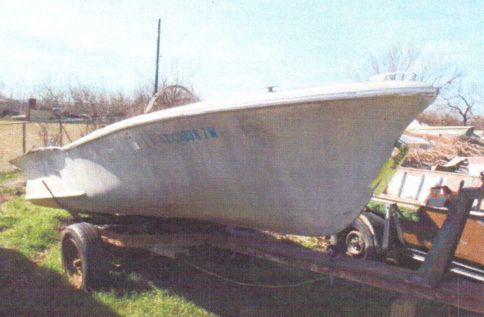

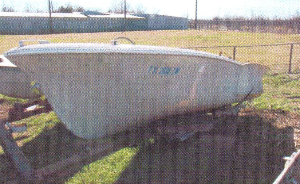

Didn't make the big auction, but someone who did bid on my behalf. I'm getting ready to leave on a 600 mile one way trip to get the boat, plus one someone else bought.
The question is, what did I buy? it's not a '58 or '62 Glastron, as their various listings say. Can anyone put a name on it?

For some reason,I'm thinking Beeline Sapphire.Just a guess..

Hello all,, I saw Genes boat today,It is not a Beeline,, this has several unique things,, it has a bow in the transom,thicker fins, built in splash rail in hull reveal,and a lot deeper v hull than a beeline,a very unique boat,Yes very similar,,looking forward to seeing it all dressed up for the big dance,,He will do it proud,,Bill

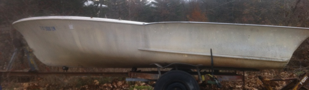

I'll get some more pictures Saturday.

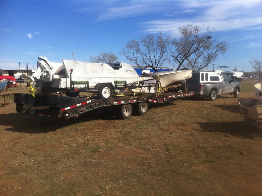

In the meantime, here's the load leaving the auction site.
Re: What did I buy? 11 years 7 months ago #86677

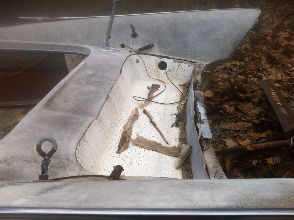

Ok, pictures. There are several unique methods used here, so these may point to some builder.
A little deeper than many this size.

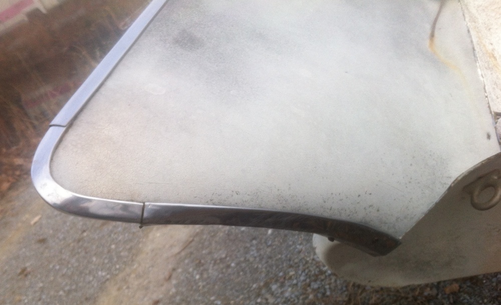

Fins are covered in metal, probably from some car. Looks similar to a 59 Plymouth.
Sides have sort of tanks built in. I expect there is foam involved, but will have to dig deeper to tell.

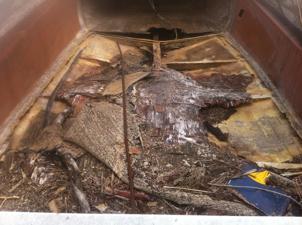

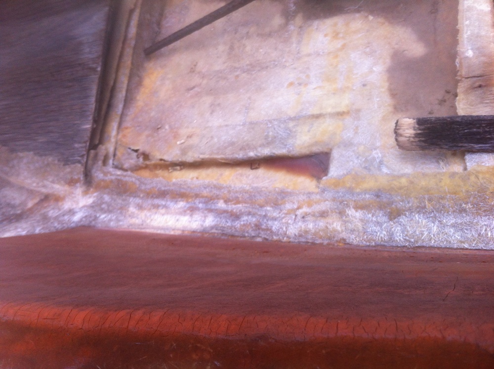

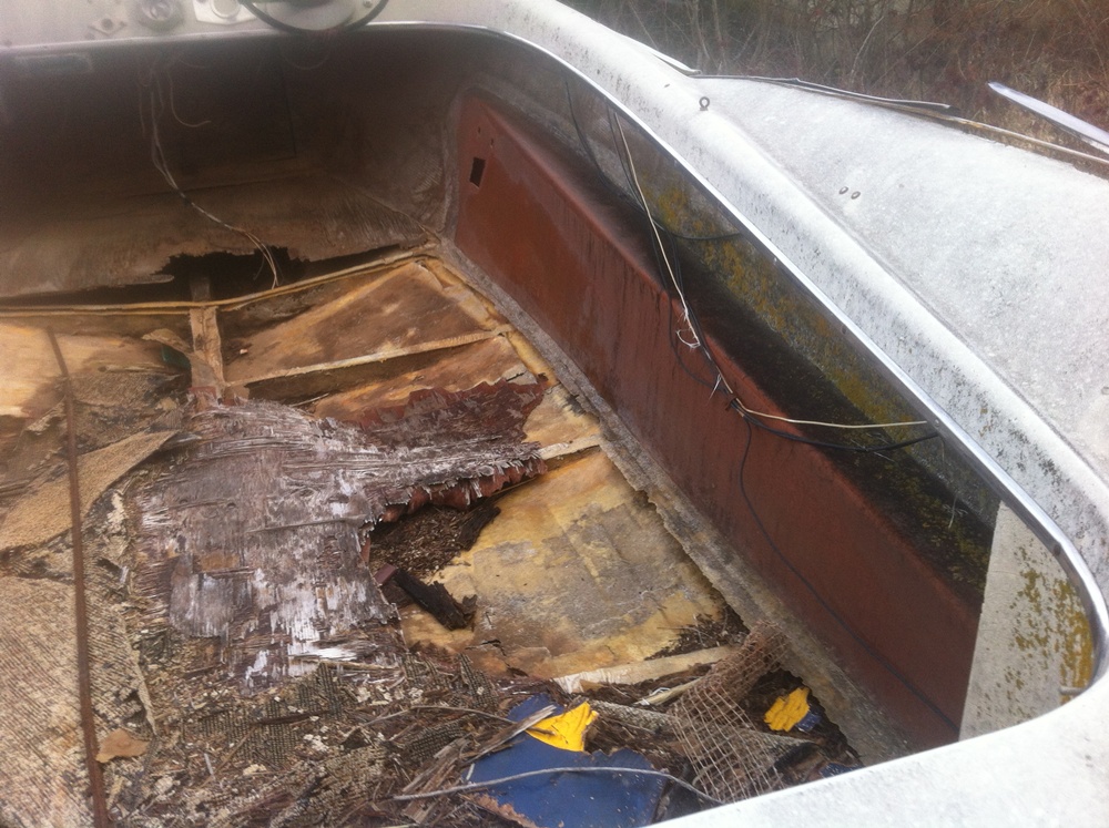

Floor is cored with what appears to be blocks, like an early Skeeter bass boat, following the angled floor. It has stringers cross ways, at a slope,then plywood over the stringers. Doesn't appear there was foam between The coring and floor, with a couple inches of air space.
Here you can see more detail of the coring. The outside hull is showing in the long wedge shaped spot, above is the coring (about 3/4" thick), to the left and right the crossways stringers, and to the bottom the edge of the fiberglass that once covered the plywood floor. I don't know if the coring is under the stringers or between them, but I suspect the coring covers it all, then stringers over the coring.

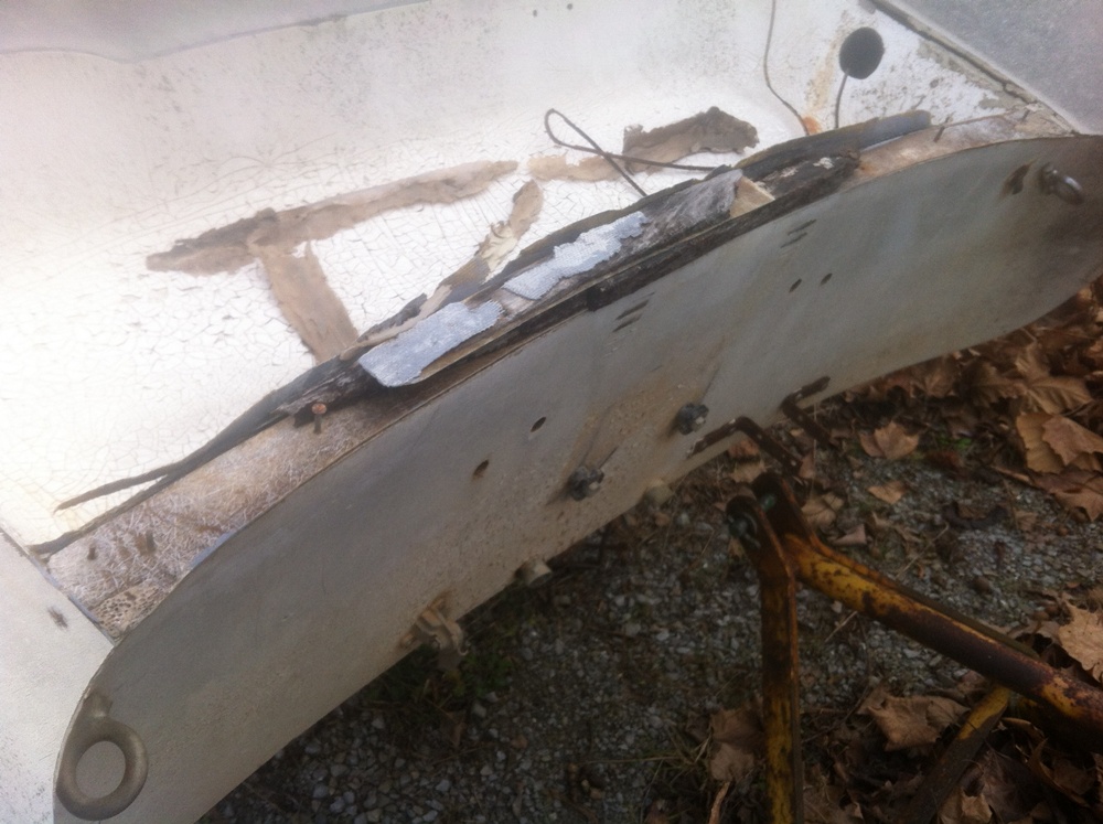

The well is not part of the deck, I haven't seen this elsewhere. It's a dropped in piece, sort of cheap, but will help greatly in replacing the transom. There is no way I can split the hull and deck on this, so it'll give me access to fix the transom. But, it might be a clue as to who made it.

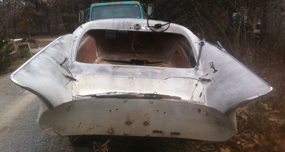

Here is the rear of the thing.
And a curved transom.
Any thoughts as to what it is?

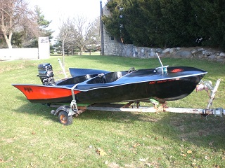

Based on these pix:
belfryboard.websitetoolbox.com/post?id=5876693
I'd guess Jim is most likely correct
