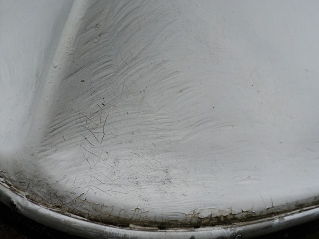

Hi everyone,

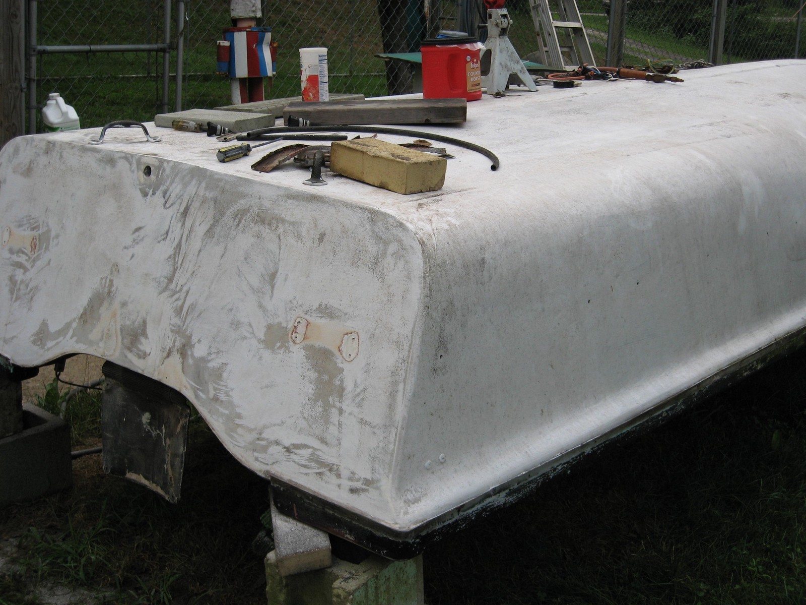

I am posting regarding a 1961 Arkansas Traveler that I have. The boat has crazing and stress cracks all over the gelcoat. I have done some glass work, but never restored the outside of a fiberglass boat cosmetically. What would be required to restore this boat so that the result would be a finish that looks good and is long lasting before cracks begin to return?
Re:Help with a rough boat 11 years 7 months ago #85902
Chine area
Your feedback is appreciated
Adam

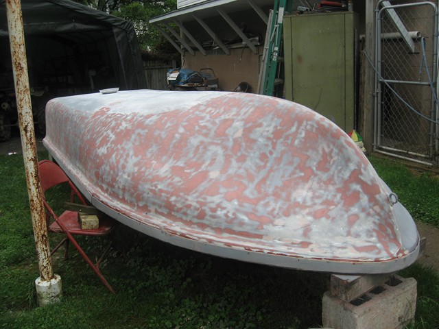

I sanded mine the whole long way down to the fiberglass mat. That is how far the cracks went. It is hard work. Like was said, "Better Like that boat."I fiberglassed, filled dips, repaired holes did the whole bottom in spot filler and primed and painted. I had the opportunity to sand several layers of paint off as well as repair the grinding marks from somebody else's failed attempt at removing the cracks. I think next time I will choose another boat.
