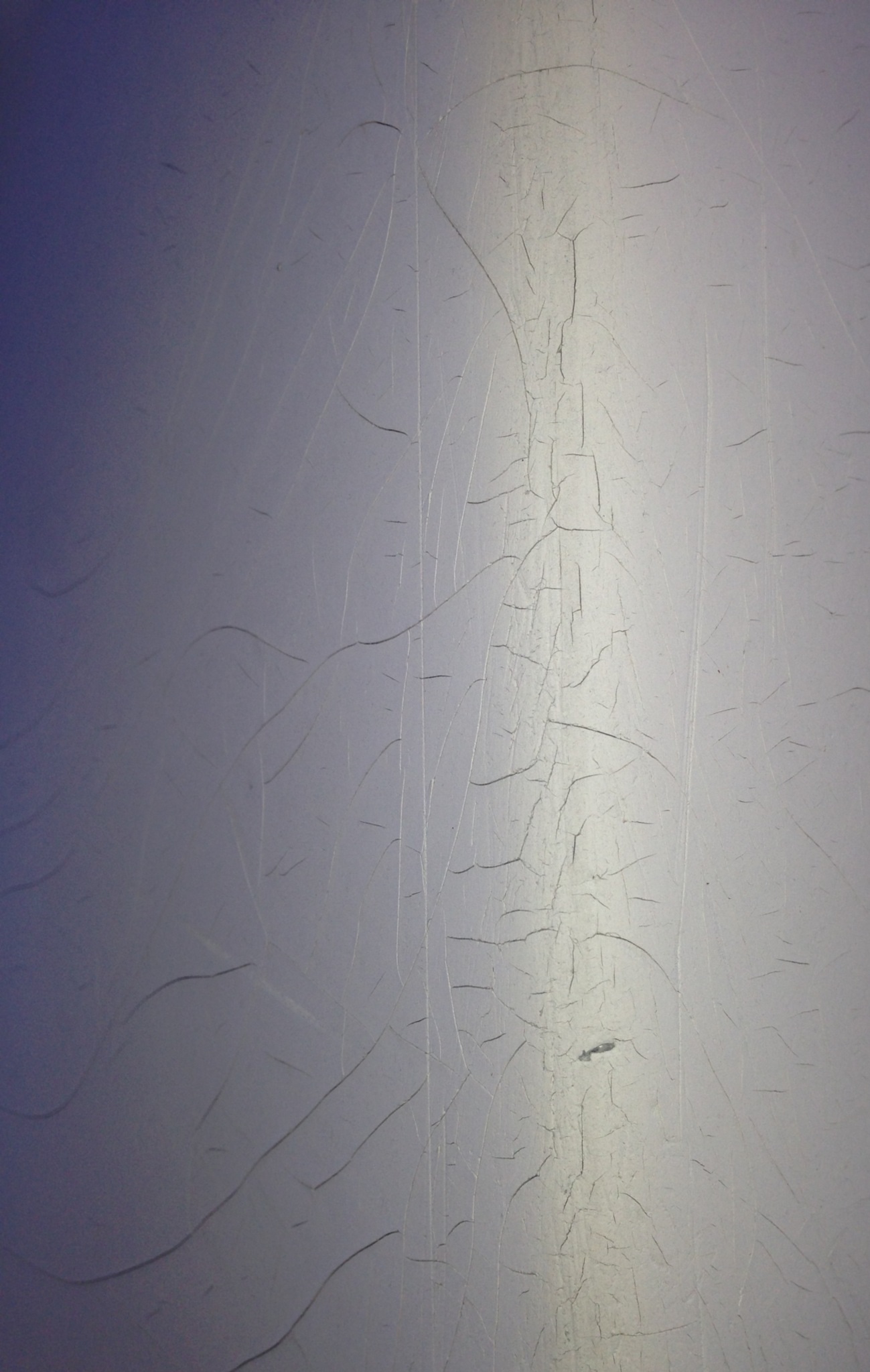

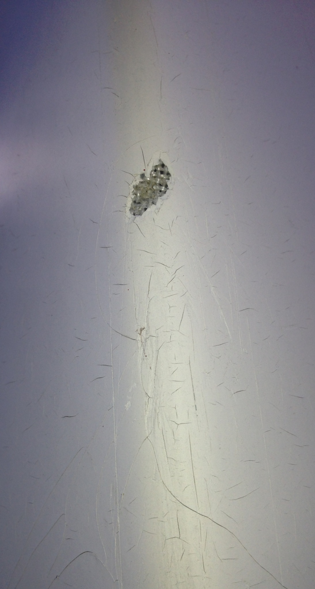

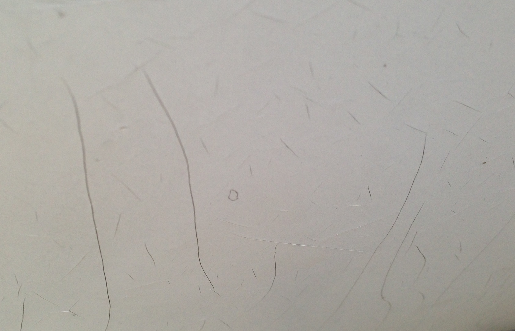

Re:Just purchassed a 1960 Owens 15 FT 12 years 7 months ago #85802

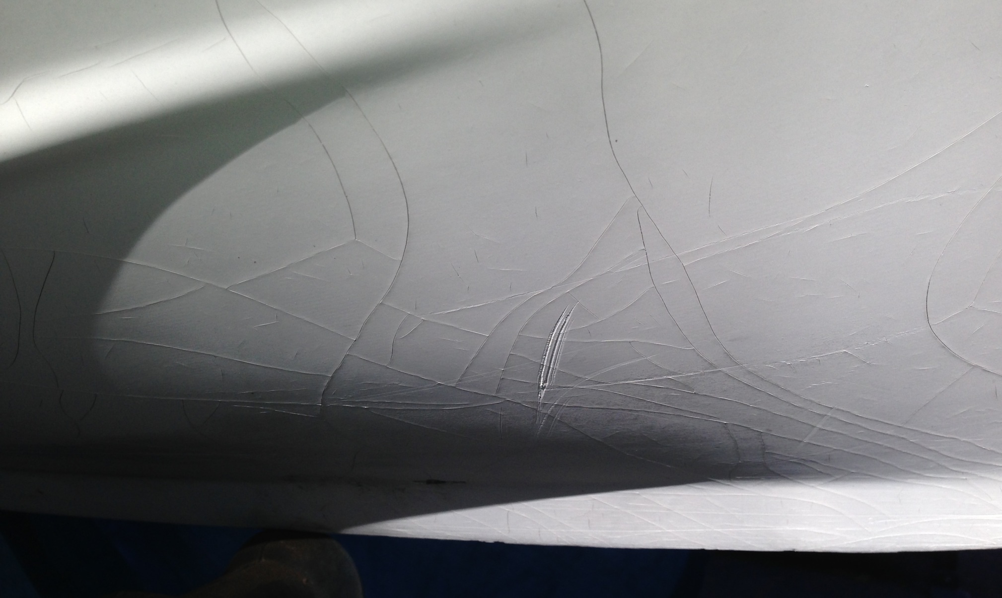

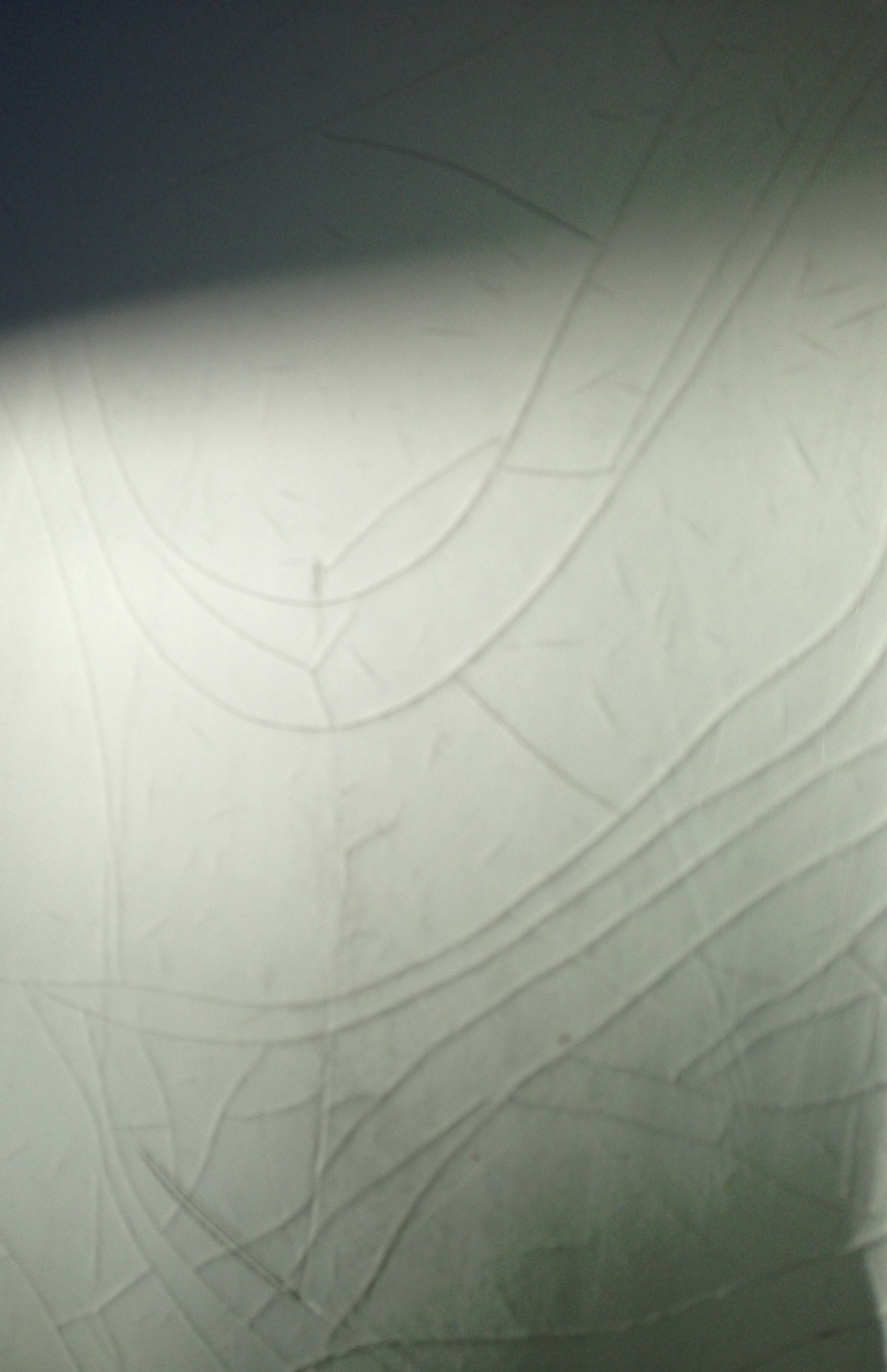

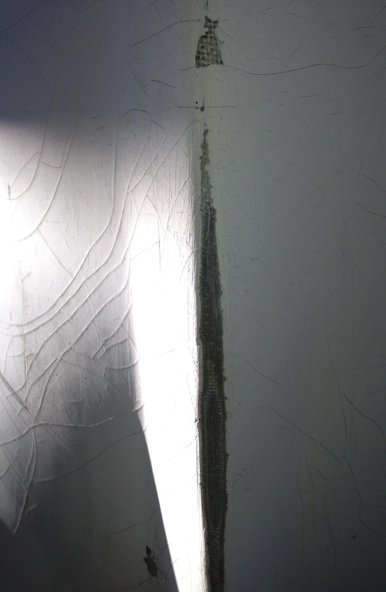

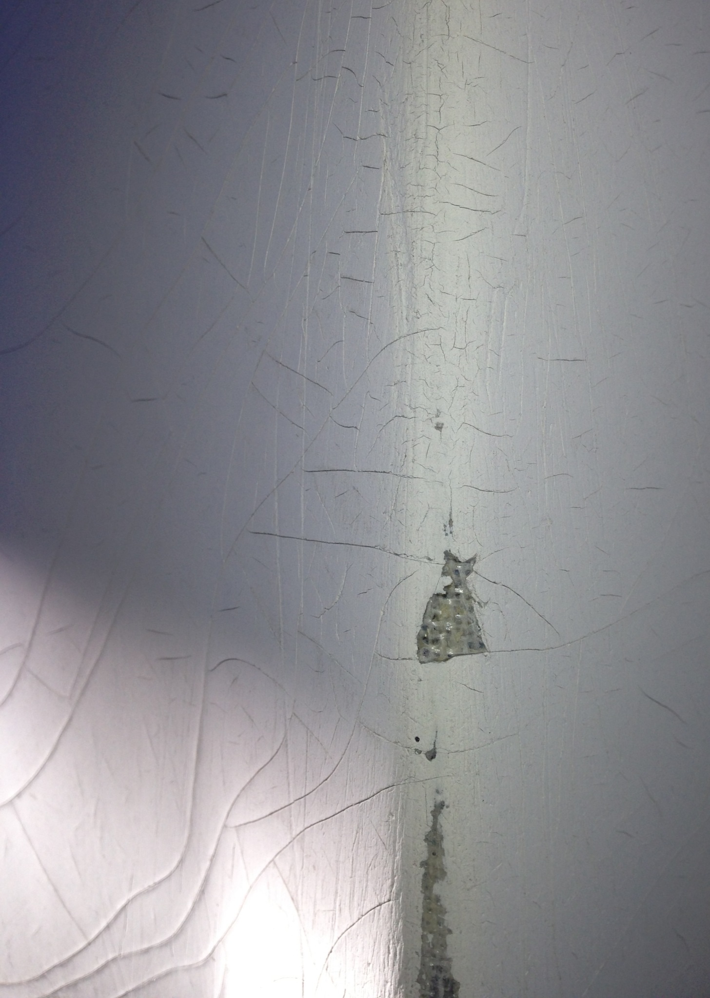

welcome,the pics of the red topside looks like paint blisters,it looks like someone painted it before.
as for gel coat cracks I would suggest grinding the cracks into a v groove with a rotary tool,then I use fiberglass gel,its a lot like bondo to fill,then use filler primer,and sand smooth.
its just my opinion though,im sure there are other methods that the guys have here,all of them good,john
Re:Just purchassed a 1960 Owens 15 FT 12 years 7 months ago #85804
Thanks John. You are correct someone painted the top with some kind of paint that looks like splatter. I am going to try to sand and see if I can get to the Gel coat.
As far as the cracks thanks for the valuable info.

Yes welcome aboard. Nice find, she should be a fun boat when done. I'm with John, grind the cracks, fill, sand, prime and paint. Strip that topside and see what the gel coat looks like underneath. you may be able to bring it back if it isn't cracked anywhere like the hull. If it is, same procedure as the hull. I would check the transom real close, it's probably rotted but can't tell very well from the picks.

Nice to see you have a complete boat! Only thing is I think your seat backs are reversed- you should have the walk thru part in the front so you can go between the seats. It originally used small brackets, not those huge ones.
Agreed that it does look like paint on top, but it could be a sign of things underneath as well. I have a few random spots on the top of mine like that (but much smaller). When I sanded them off, I had some small holes there, like the fiberglass bubbled up and was very fragile to sanding. I haven't tried filling these yet.
I had a few spots on the hull like the other pic you had and they were small enough that some marine filler filled them over without a major repair.

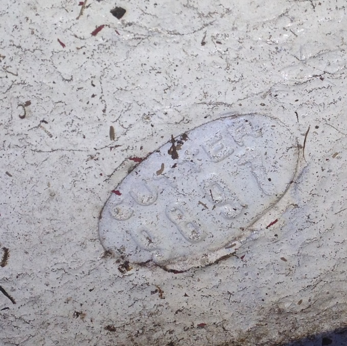

I am not sure which model it is. They are good looking boats but not enough info. On them. I found : tags on the boat. Front dash says Owen but one in the transom are and it says Cutter 9897.
Hopefully I will get better pictures of the spider cracks when I get it home. If you do not mind can you pist pictures of your floors? I want to see if they look the same as mine.
Re:Just purchassed a 1960 Owens 15 FT 12 years 7 months ago #85831
Cutter and Owens boats were basically built on the same line from what I understand, so it's possible the mold for your boat was a Cutter mold and had a number stamp on it.
The difference in these small boats was just like Ford and Mercury a couple years ago- same product, different badges.

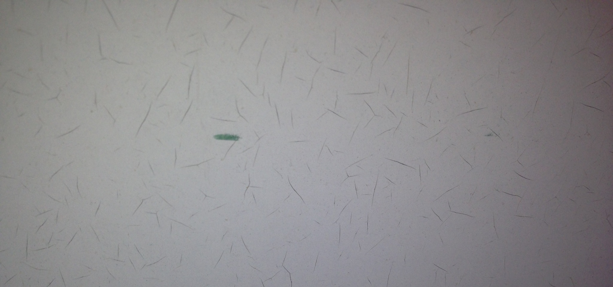

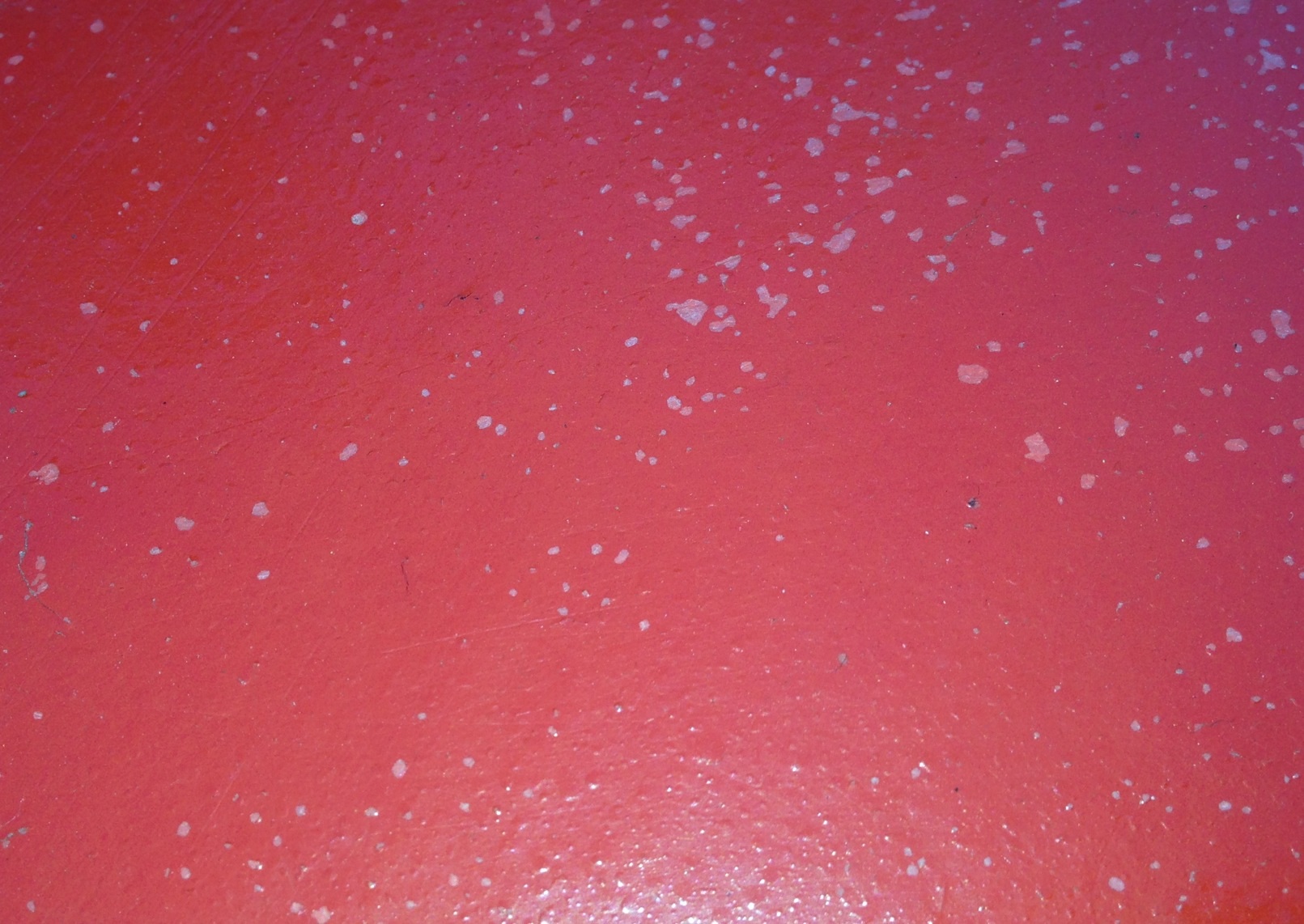

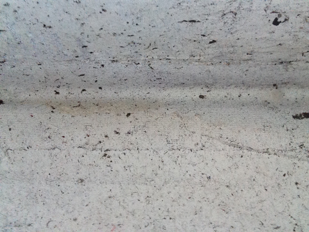

What do you want to know about the inside of the boat/floor? It's just white with red/black splatter paint like in your pic. My boat isn't at home, so I need to know what to take pics of when I do go out there.

If you look at the floor you can see the fiberglass weave. I wanted to see if they all look the same. The other thing the seat risers do not have any flotations in them. They sounded hollow. I will post new pictures by the end of the week. Don't go out of your way to take pictures.

Pictures of my floor for you. It does have texture to it despite being splatter painted, so it wore off on the high spots.

I see. Same as mine like the 1st and the 3rd picture you can see the woven Fiberglass. I Finally got all my paperwork done an transferred to my name today. So I can say that I am the proud owner of a new Owens project lol.

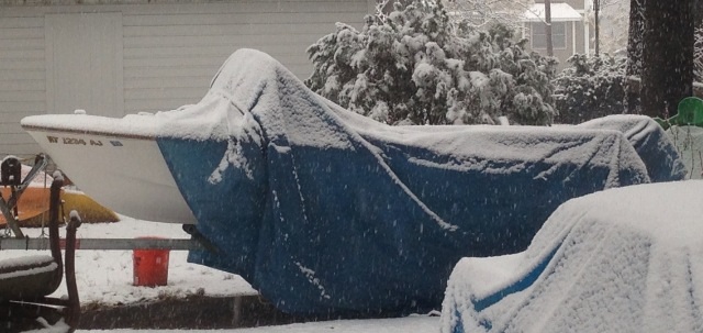

Finally towed it home this afternoon from Long Island To NJ. Will post more pictures tomorrow.
Re:Just purchassed a 1960 Owens 15 FT 12 years 7 months ago #86084
Here is a picture from today.

Good looking rig.

Re:Just purchassed a 1960 Owens 15 FT 12 years 7 months ago #86125
Congrats on getting it home safely. Now the fun begins!

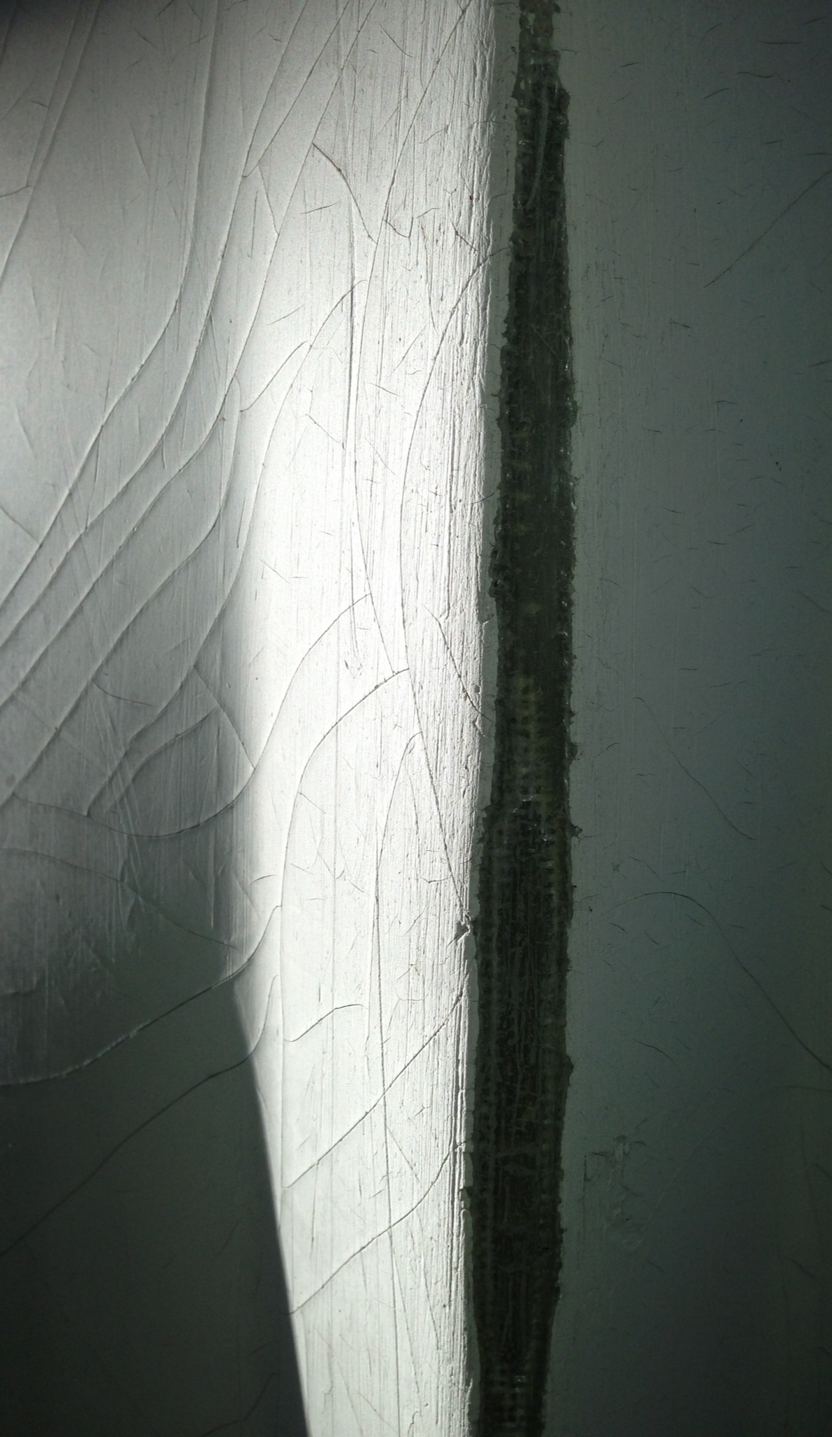

It has been a hectic week at work and finding out that I need to have a hernia surgery that slowed things. Have not had a chance to work on the outboard or the Boat. I got new Johnson Gear oil Premium Blend for the electric shift. hope will be able to change the fluid this week. I washed the boat to see what was hidden underneath the dirt. I have taken some pictures and Is see a lot of cracks in the gel coat. Also the keel gel-coat is gone due to the roller rubbing in the wrong place. The whole boat is not sitting correctly on the trailer. I got to figure out a time to lift it of and adjust the trailer pads.
Here is my plan since we are getting into winter and cold weather:

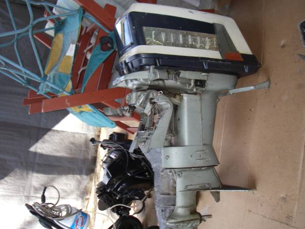

1-remove the outboard. Going to try to salvage. In the same time I have been talking to a guy that have a 1969 Johnson outboard running that I might end up buying for $150. He stated it ran great the cosmetics on the outside of the outboard are not the best and needs to be refinished. He is a technician by trade and have done all the work on the outboard.
2- Start sending the areas with the cracks and prepping them for repair come the spring.
3-Sand the top paint with and orbital sander and 80 grit paper to get to the Gel Coat. Any better ideas on how to strip the paint?
4- I am concerned about the transom. Seem solid but have 2 sunken bolts. I will have to drill couple of holes to determine if it needs replacement. I looked at the hull and it seems with owens the top and the bottom are fiberglassed together. So I am not sure if the transom needs to be replaced from the outside.
5- Going to cut new boards for the seats and get them redone.
Attached are some pictures from today.
Re:Just purchassed a 1960 Owens 15 FT 12 years 6 months ago #87042
No time now, but I'll catch up here or over 'round the other joint..................
Looks like typical vintage gelcoat craze & cracking......

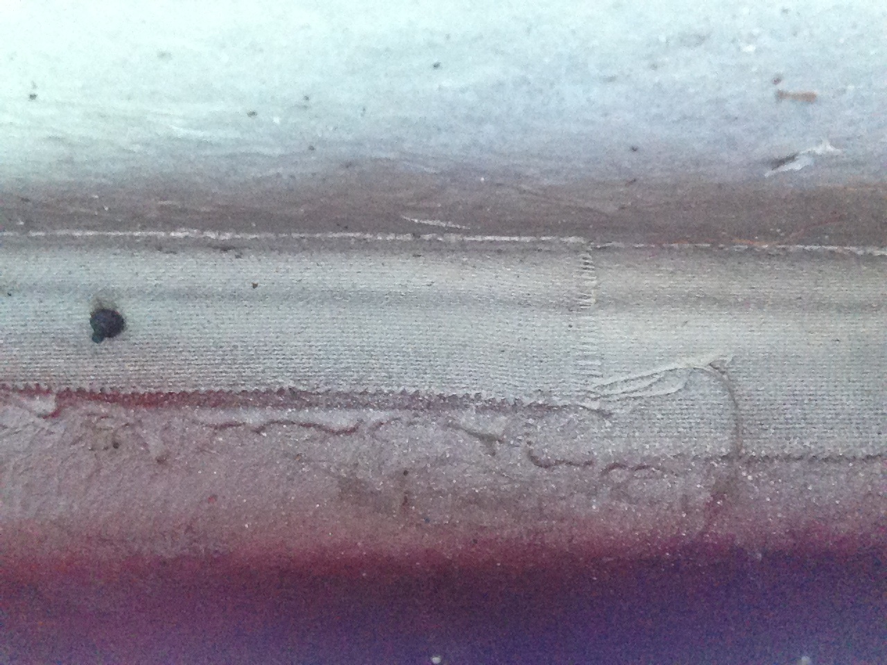

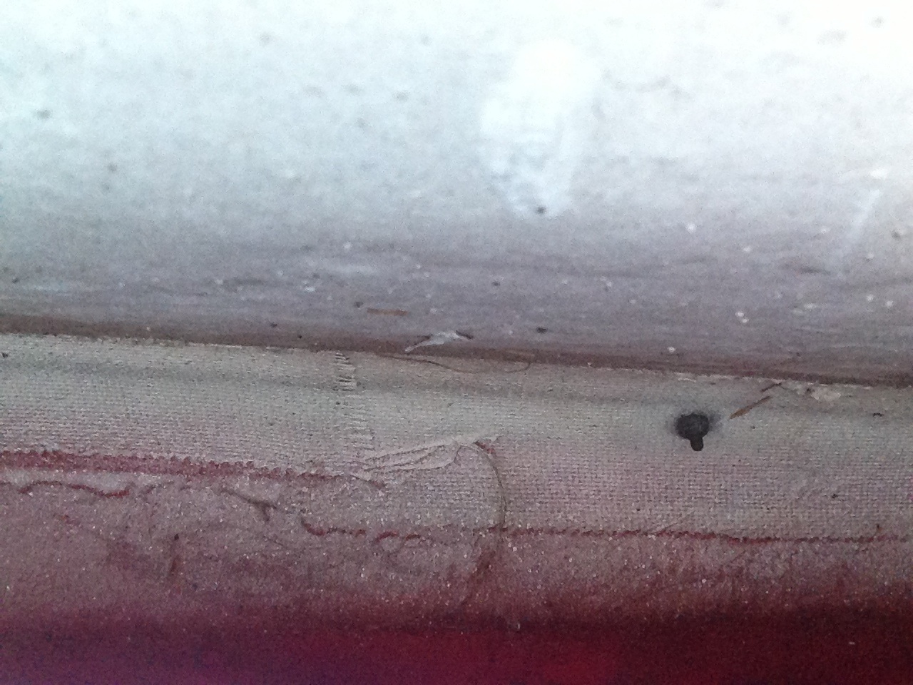

Here are some pictures showing how the hull is fiberglass end to the top part.

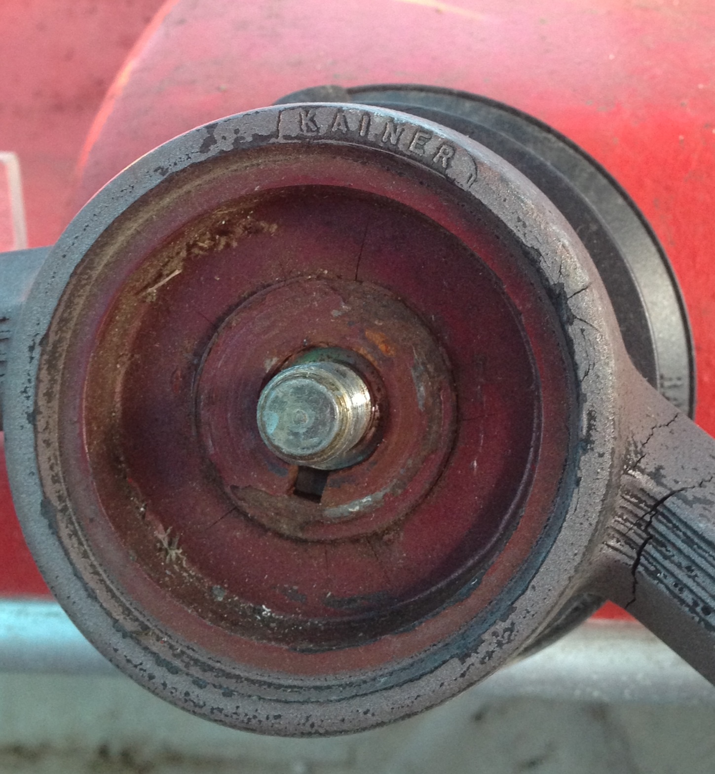

Another question is that I took the steering cover and the nut and washer out. I am not able to pull the steering wheel out. Am I missing a step tom pill the steering wheel out?

It's a tapered shaft with a key way, but they can be a real bugger to get off. I've found that if you soak the shaft area with penetrating oil for a few days it may help. Thread the nut back on just to cover the threads, leaving a little room between the nut and the wheel. (This prevents you from mushrooming the shaft and damaging the threads, hopefully!) Pull outward on the wheel while someone "whacks" the nut/shaft with a (rawhide?) hammer to help loosen the connection. Some have had better success by standing with their legs between the wheel and the dash, using your legs to pry the wheel outward off the shaft. (While using the "whack" method mentioned above.)

From looking at the photo I don't see any threaded holes to attach a steering wheel puller.
Re:Just purchassed a 1960 Owens 15 FT 12 years 6 months ago #87211
I loosened the steering unit behind the dash then put the nut back on the shaft (all the way onto the end) and whacked the shaft with a hammer a couple times and it popped loose.
Re:Just purchassed a 1960 Owens 15 FT 12 years 6 months ago #87227

No luck pulling mine from the front. No good way to grab the wheel and didn't want to risk destroying.
My grandpa looked at it and found a small pin through the shaft on the rear pulley. Like a keyway pin. He was able to hammer out that pin with a drift and then slide the wheel and steering shaft complete out the front.

Yep, the Pulley system on the rear is usually held on by a C-Clip or a compression Rolled Pin. I discovered that AFTER I struggled like a Crazed Lunatic to get mine of the other way!!!!!!
Re:Just purchassed a 1960 Owens 15 FT 12 years 6 months ago #87290
So I got to take it out with the hub, shaft, and the steering cable out? By the way it is a Teleflex rack and pinion steering.
Re:Just purchassed a 1960 Owens 15 FT 12 years 6 months ago #87314
OHHHHH that's another kettle of fish. Nope, no shaft removal.
