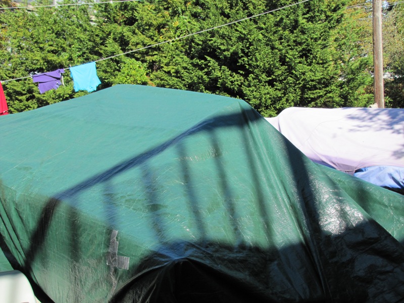

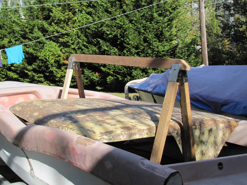

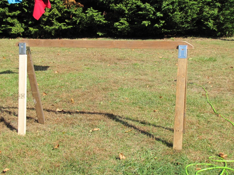

I'm not sure if I have posted this before, but if I have, you're getting it again. This is what I used as a frame for a winter cover. After trying a variety of options, this is the one that is easiest and works best. Essentially it is a large sawhorse. I use the standard metal sawhorse frame and make one over-sized. The one in the picture has 3'-6" legs and the cross member is 7'. (The dimensions can be modified to fit whatever boat.) The ends of the cross members I cut on a 60 degree angle and round the ends and edges with a band saw. I have used this arrangement for 3 or 4 years and have never had a problem with tarps puncturing at hard spots. The height creates enough of an angle so snow and rain run off without ponding. The nice thing is that you can use scrap 2x4s which keeps the cost down.
I also assemble it with either galvanized or coated deck screws so it can be folded up and put away for the summer and is ready to use the next year.
Hopefully this will help someone out there.
The assembled saw horse.
Placed in the Glastron.
With the cover.

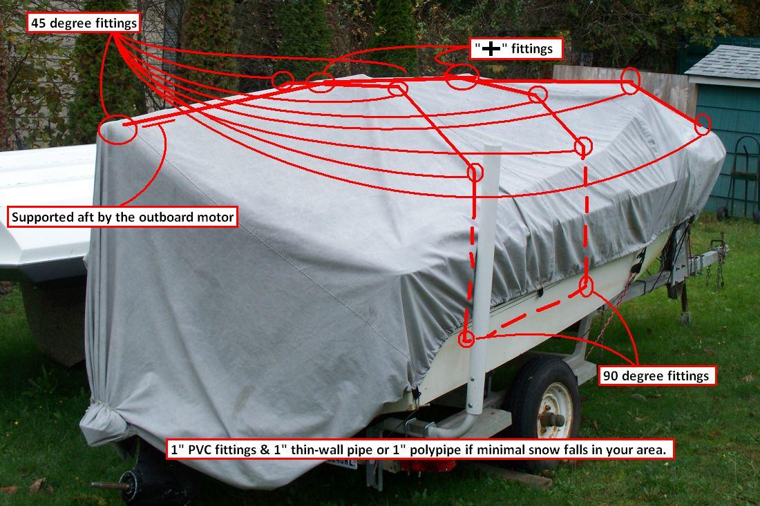

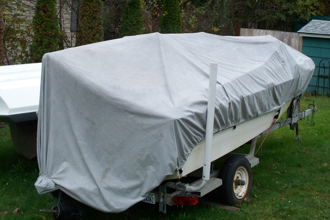

I've been using white 1" PVC fittings and 1" poly-pipe that I assemble each Fall to the shape of a dinosaur rib cage, to support my tarps or boat covers.
I think your idea probably wouldn't cost as much & would be very strong.

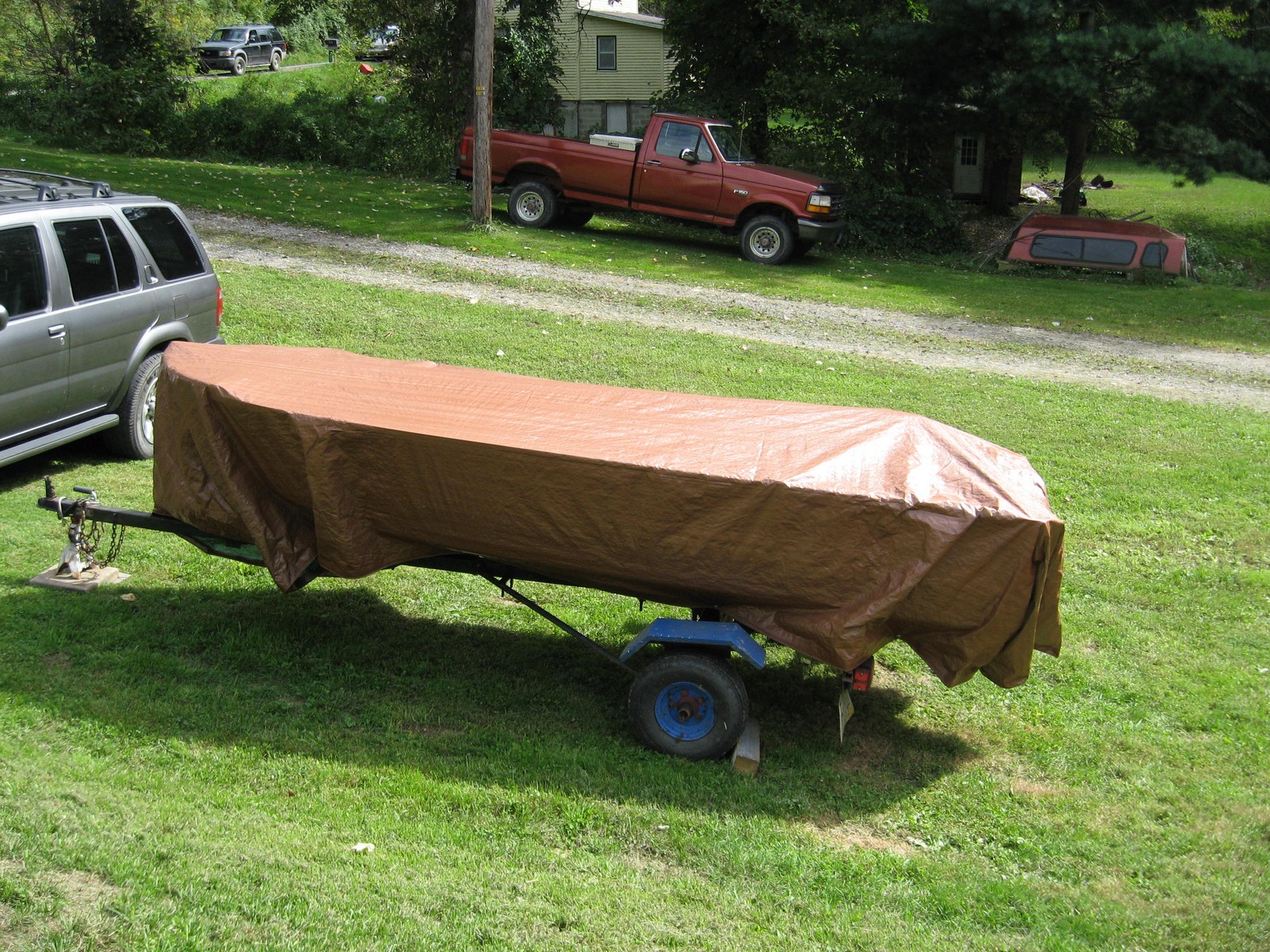

I run a 2x4 from the bow to the top of my rear most seat and angled tow smaller 5/4 x 3's to each side of the stern and covered. Been using it for years. I clear the snow as it falls on it. Although it has had over two feet on it.
