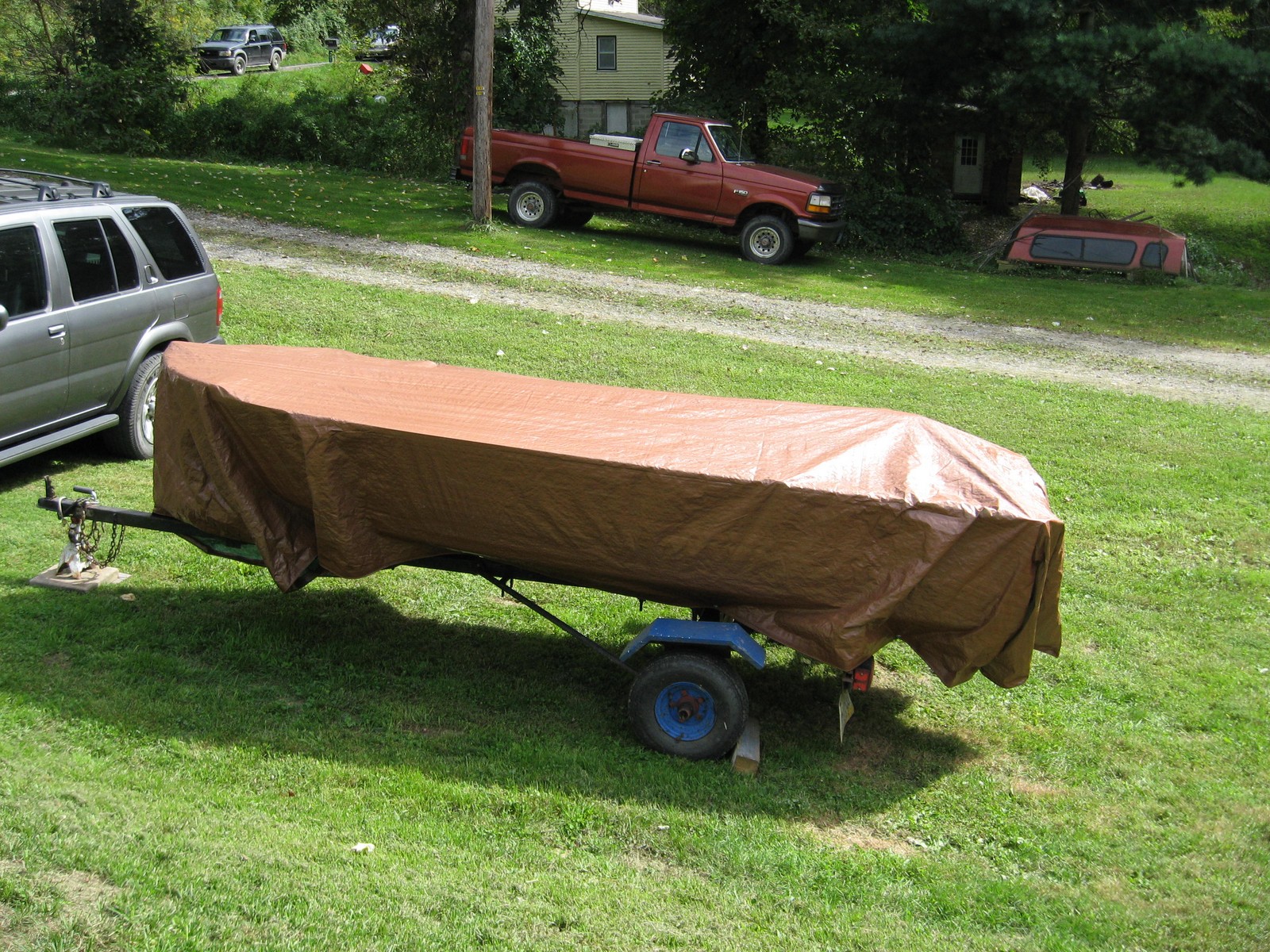

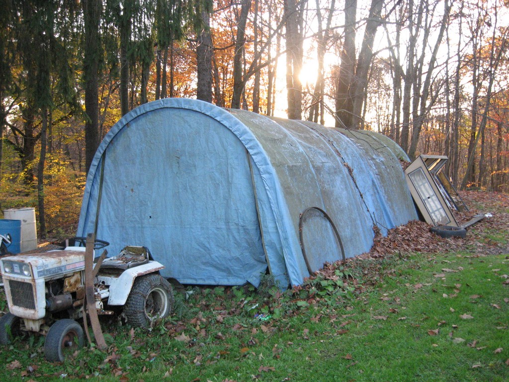

If you decide to tarp it ?
DO NOT get the blue tarp. those pieces of crap are not for outdoor use. A blue tarp will last maybe a week waterproof wise, and will in shreads within 3 weeks in any kind of wind. I use the silver tarps. Waterproof wise you'll get a month or two, shread wise you'll get about 4 months. How do I know this ? EXPERIENCE !
If you get a Harbor Freight temporary garage ? They are impossible for one person to put together. The fittings are so loose you have to duct tape all the connection points. I had to make my own rebar stakes to hold the garage down, because all you get is a bunch of useless 6" stakes. I also tied the garage down at all the crosses up high to keep it on the ground too. Once you get past the assembly and tied down, it works pretty well. But like I said the tarp part only lasts so long, befor you have to replace it.
I have since made my own tarp garages from 1" pvc pipe, fittings, drywall screws and tarps. I can explain how to make one if you'd like ? The problem with the purchased tarp garage, is it only comes in certain lengths. The pvc version you can make as long or short, AND as tall as you like. I only made mine as tall as the boat on the trailer (It was a small boat)

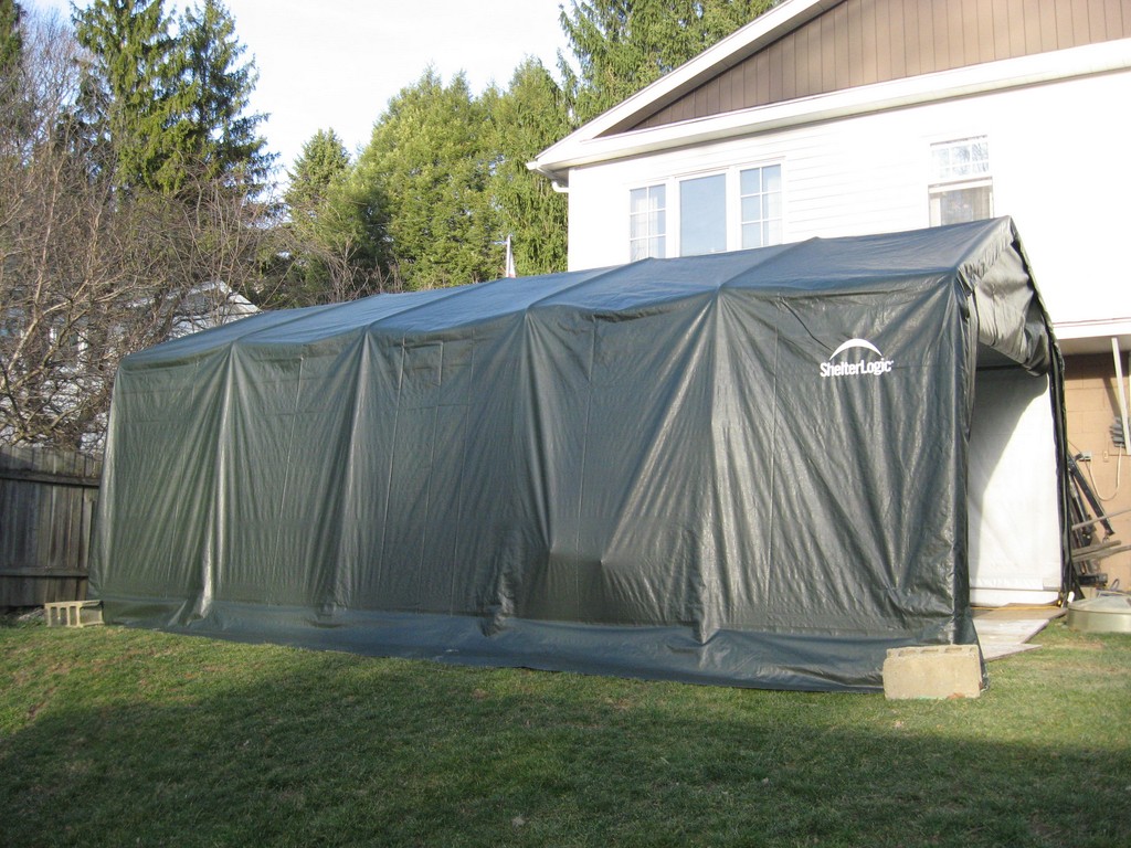

This temporary garage has been moved twice and is in excess of 20 years old. My F-100 lives in it. Some will last very well. It survived a micro-burst less than 70 foot away from a 55 foot blue spruce broke in half in the middle and about 25 yards from some very substantial oak trees broken off and pulled from the ground. Some will last very well. I think this number belongs to Shelter Logic now and I'm not real impressed with mine. This was taken before it was actually finished and tightened up. I have had some blue tarps last years also. Buy a better one, not the cheap one.

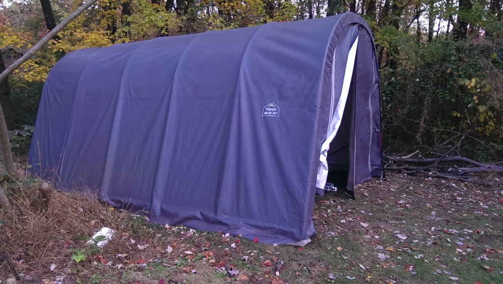

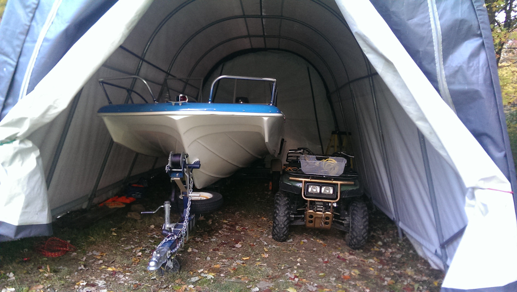

Here is the Chevron in her new home.
The ground is not level, none of our property is. We live on the side of a "mountain"
A buddy of mine bought this a few years ago for his camper. It's 20 x 12 and just fits the boat and trailer. He sold it to me for next to nothing.
Took 45 minutes to tear down and 4 hours to get it put back up! Then i spent an hour another day trying to get the tarp straight. No luck. Don't know if it's because of the cold or the unlevel lot. Can't find an owners manual for it.

Wow very cool idea. Thanks for the website. I think I may just get one to cover up the Clipper while she's outside and I'm working on the Century. Those Grey heavy duty ones I've been using barely make it a year right now!

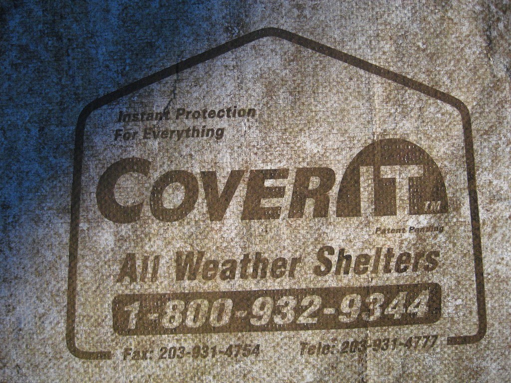

Re:Outside Storage Questions 11 years 7 months ago #85576
If you look in my earlier post, that domed shelter looks almost identical to my one that is over 20 years old. It is the original cover.

This one is not quite that old, probably not made as well as yours.
We finally had some rain to see if it was waterproof. Well i don't see any leaks so i can hold off on the tarp for now.

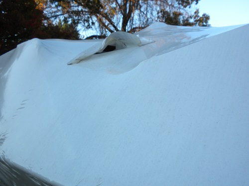

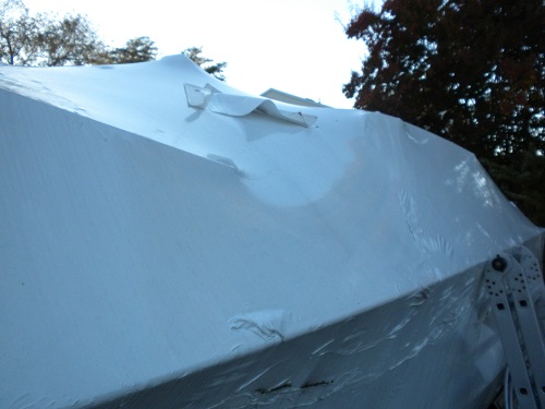

Re:Outside Storage Questions 11 years 7 months ago #85776
Cold is drier than warm. Sun adds heat. The alternating of colc and warm days makes solid covers sweat on the inside and all over your rig.
You need vents placed higher up in the cover to rid the underside of the cover of this moisture. These moisture droplets comes/goes on for many hours of many days as the seasons run their course.
Re:Outside Storage Questions 11 years 7 months ago #85779
another vent.
