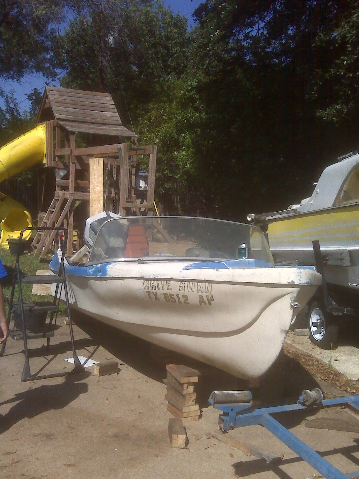

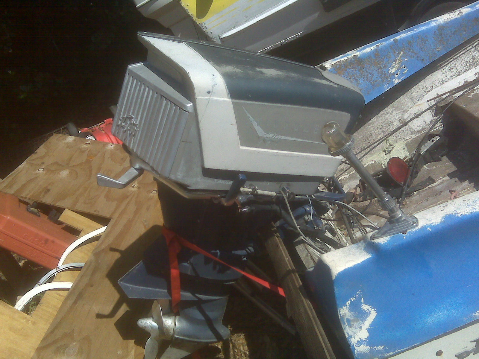

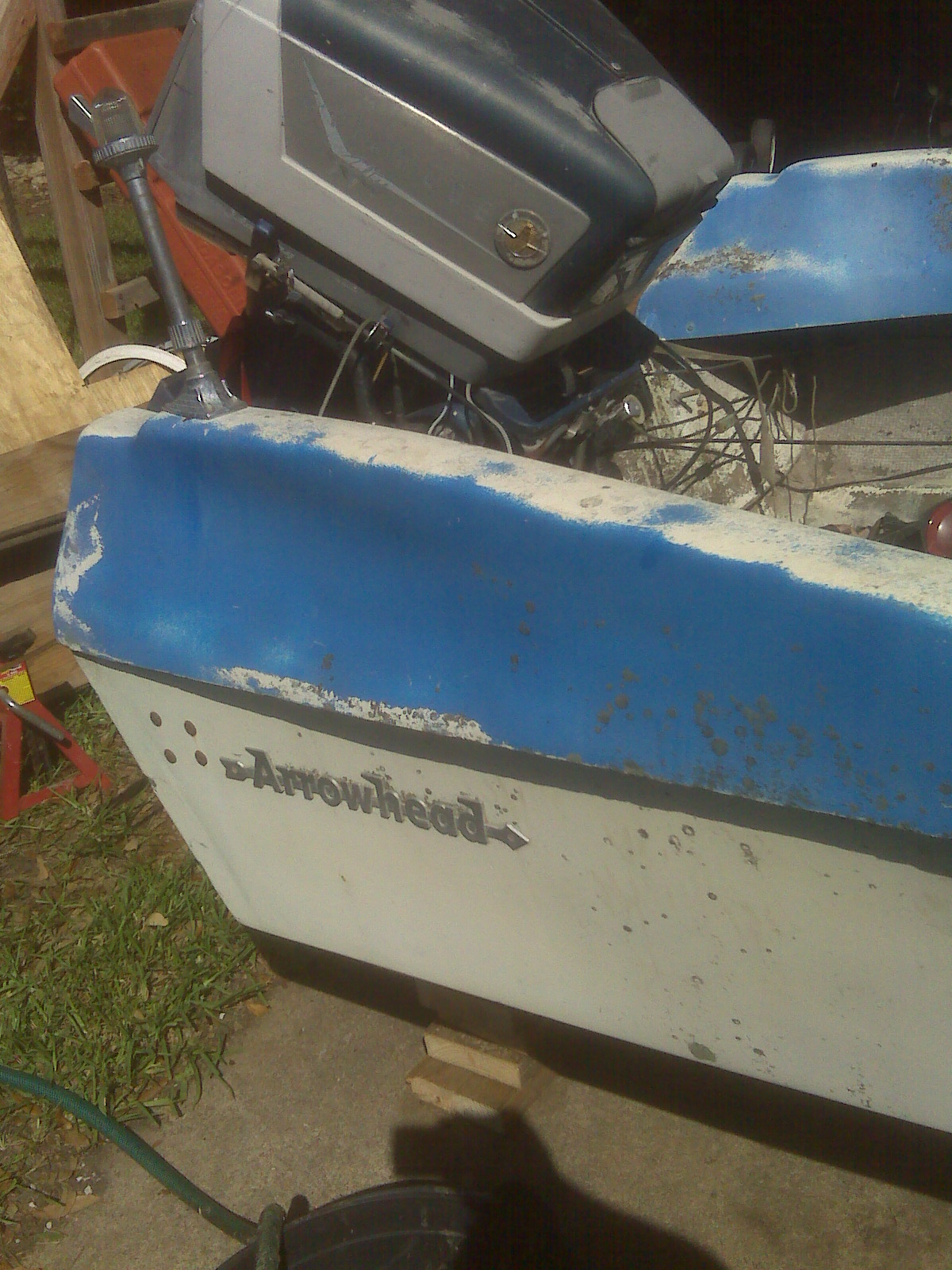

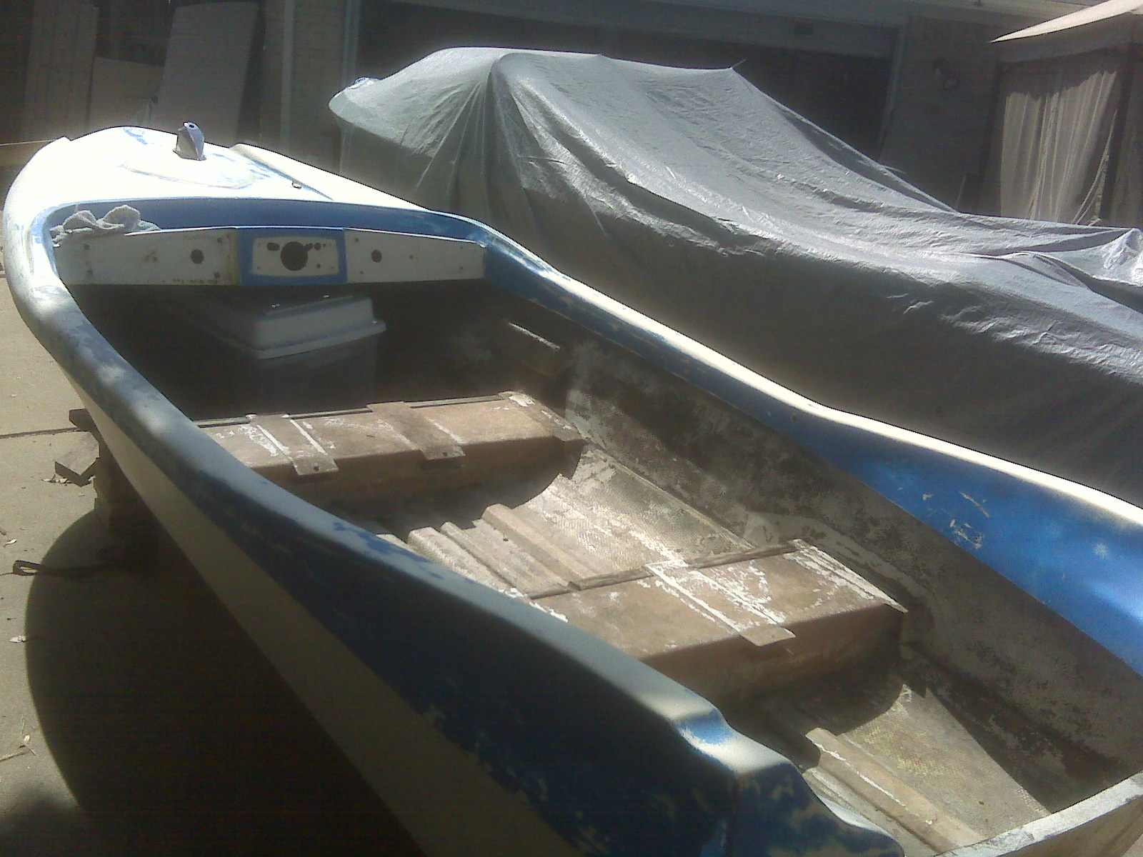

I came across this boat and picking up another one today, (they came together)and was wondering if anyone knows what type of boat it may be. I have not talked to Tx parks yet to see if they have any information on it which will be another battle because there is only a bill of sale.
I really only need the windshield off of one of them but they have a certain appeal about them. My son has already cleaned out this one and is waiting for the other one to start restoration.
It has an Arrowhead marking on the side but I cannot find anything about it.
Not sure if the pics are coming through
[img]http://www.fiberglassics.com/media/kunena/attachments/legacy/images/IMG00203.jpg [img]http://www.fiberglassics.com/media/kunena/attachments/legacy/images/IMG00201.jpg
Re:ID new "old" boats 16 years 2 months ago #8498
Certainly an interesting boat, a unique style. Am I getting this right, you will be picking up another one of the same model?
Hopefully someone here will come up with more information. I think this one deserves a page in the Classic Boat Library.
By the way, the Evinrude is a 1958 model (or at least has a 1958 cowel). See www.old-omc.de or the Classic Boat Library page: www.fiberglassics.com/library/Evinrude

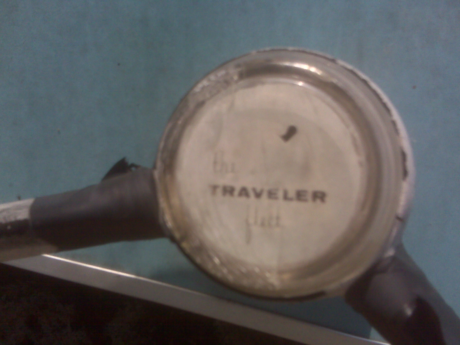

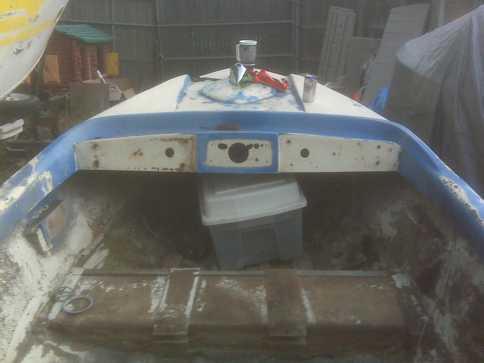

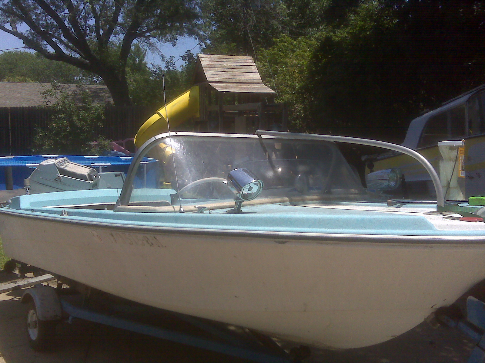

Here are pics of the other boat. They are both very interesting but I cannot find anything about them. The new one has Traveler on the steering wheel. I am not sure what the brace on the bow is for, it looks original. I did some search on the 40hp Gale and now know it is similar to the rude and johnson.

That helps with the motor. I am guessing the boat would have to be around the same age. The boat appears to be setup to put the steering wheel and throttle on each side. I have not had time to do much on them yet but will continue to whittle down on them.

Re:ID new "old" boats 16 years 2 months ago #8813
hi redeye,im on dialup and cant see the pics,but the one with the arrow head might be a arrow craft,my brother in law has an arrow head challenger with the arrow head stripe down the side.
and the other one might be an arkansas traveler,its worth a try,john
Re:ID new "old" boats 16 years 2 months ago #8814
Arkansas Traveler became Traveler - look at the 61-62 brochures...the earlier boats were lapstrake styled.
www.fiberglassics.com/library/Arkansas_traveler
Peter
Who grew up with a '61 AT Utility
Re:ID new "old" boats 16 years 2 months ago #8823
I was up all night looking through those brochures, I do believe you are right, it could be a 61.
Thanks,

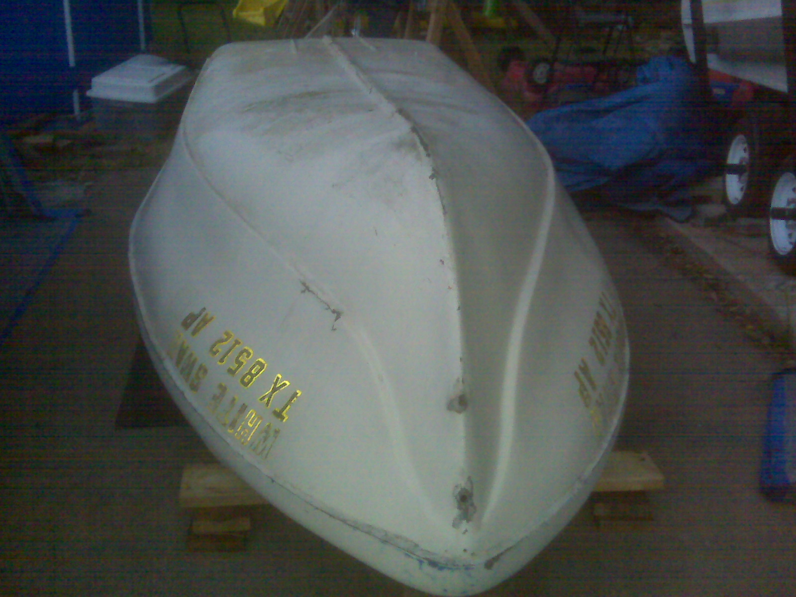

ok I have an update. I went to TPWD and pulled the title information. The Arrowhead is titled as a 1959 Arrow Glass and the other is a 1966 Corvair. Now begins the wonderful experience of getting a title because...........wait for it....the person who sold it to me is not on the title.

My son has been working hard on the boat, sanding.....he hates sanding, I told him to get used to it. He has been doing a wonderful job of taking the hardware off and labeling it then placing in a box.
We are debating on wether to change out the transom, it is curved and there is no way we can reproduce it. The wood strips on the floor will be coming out but the seats need to be grinded out first. he wants to put a floor on the boat so it is smoother.
The fat fifty is off and we are trying to get rid of it or swap it out.

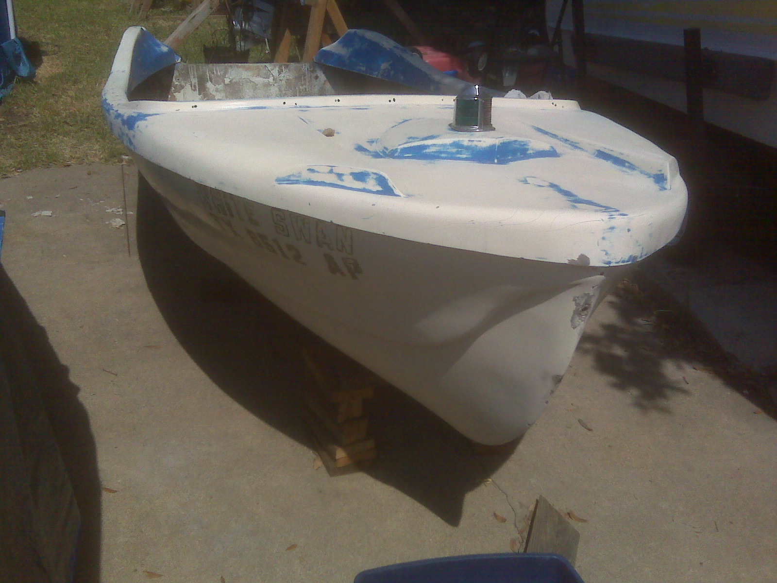

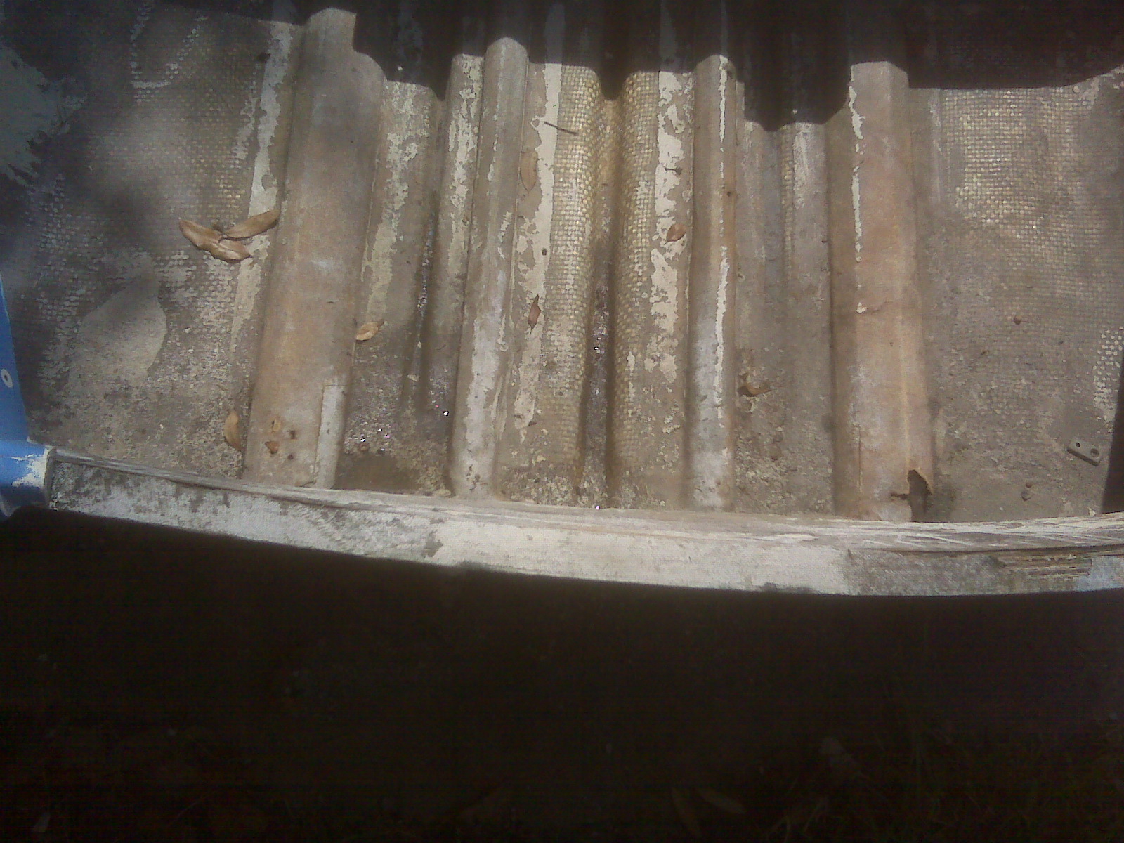

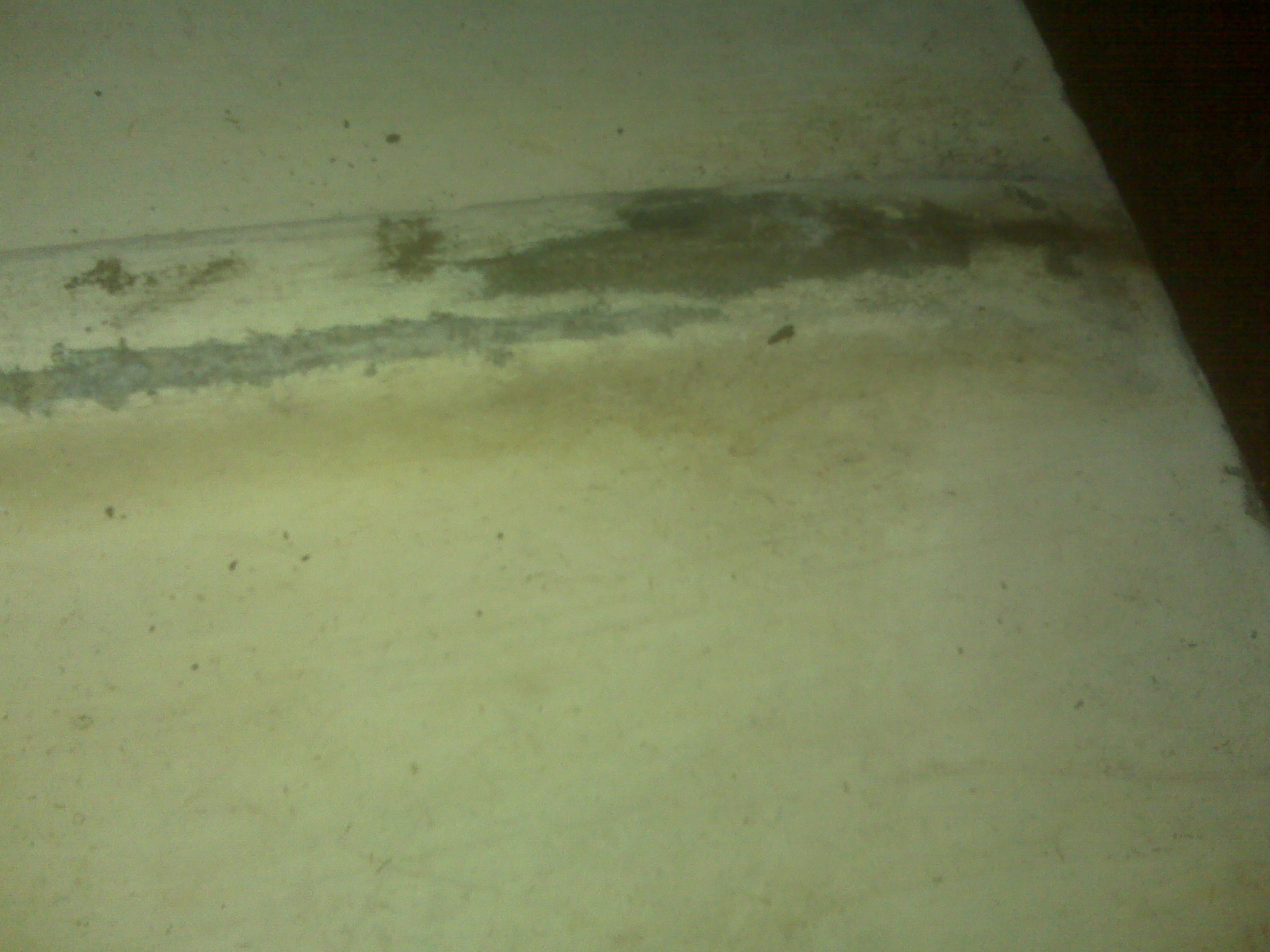

Well we got the boat flipped over. There are some concerns about the keel. there is no wood for the keel, it is used to drain the inside. Is this normal? There are quite a few deep gashes on the bottom, particularly on the keel. I do not think they are going all the way through but was wondering what is the best way to repair these.
I am also wondering the best way to paint the gelcoat, I was going to use rustoleum after primering. I have used it on my other boat and it seems to be doing fine.
Re:ID new "old" boats 15 years 11 months ago #14072
It all depends on what type of gashes. If they are just surface gashes where the gelcoat is missing.. scuff the surface around them with 40G sandpaper, and then fill them with tiger-hair body filler (glass-fiber reinforced polyester body filler). If they actually go deep enough to the glass fibers- grind the areas out 3" around the gash- and re-glass with resin and mat. If you have cracks all the way through from a substancial impact- then you need to re-glass BOTH sides of the crack. This may even mean grinding a groove where the crack is- almost completely through the hull.
Your picture doesn't show any substantial damage- so if that's the worst of it- you're in good shape. Tiger-hair and regular fillers will do that job.
PLEASE use a 2-component epoxy or enamel paint for the bottom of this hull. It will last much longer. Stay away from alkyds.
Yes, they will work just fine on a boat that only sees the water 3-4 times a year. and they don't fade much in the sun because they are on the bottom. But.. you are doing a whole lot of work already to skimp and save $50 in materials. What is your time worth to you?

My biggest debate is the paint. I am planning on putting 3-4 coats on but the good stuff is expensive. I have used it before and it did not seem to hold up very well..........I am sure it is how I applied it.
We have started the bondo process.........did not think I could fit the glass in the gashes.
