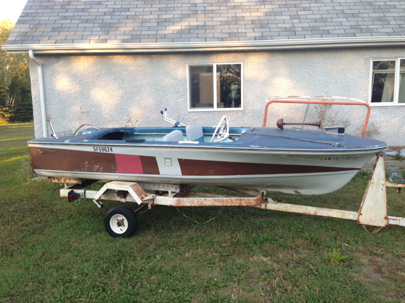

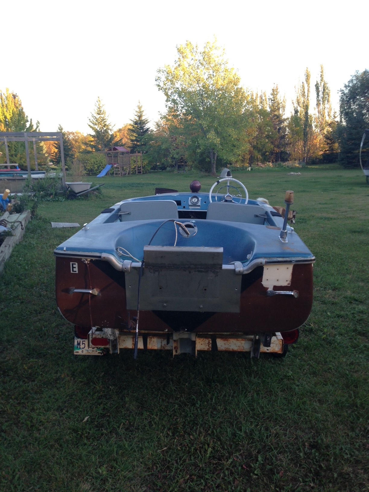

I picked up a boat from a neighbor fairly cheap
seems to be in decent shape for the year looks to be a 1960-62 Arkansas Traveler Rocket
As far as repairs go the keel needs some attention and a new paint job, The seats had been reupholstered not long ago plus it needs a windshield not sure where to find one but im sure someone on here can point me in the right direction
Previous owner had this in the water in 2006 and it been on a trailer ever since

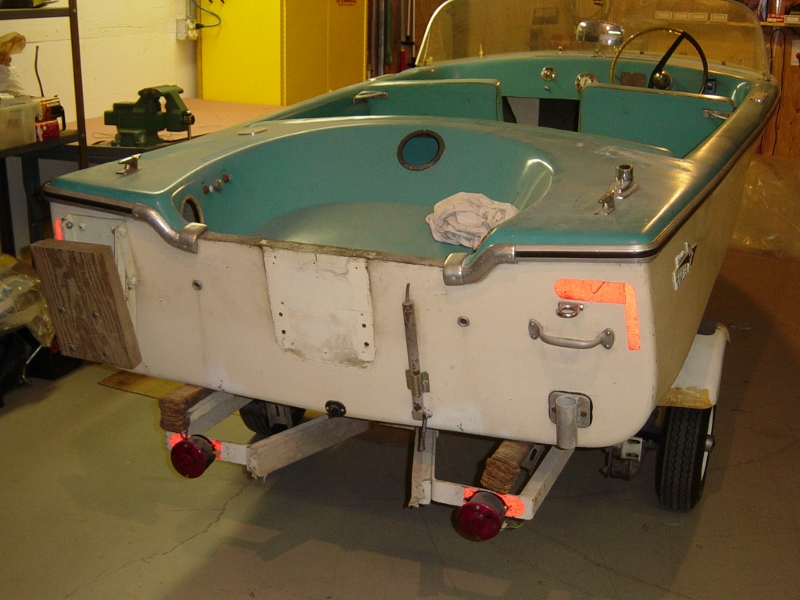

Re:New to FiberGlassics 12 years 10 months ago #84223

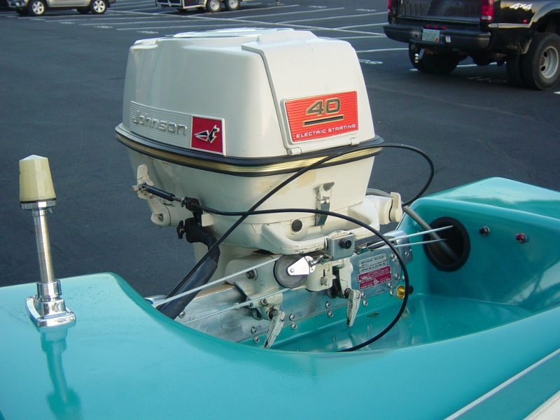

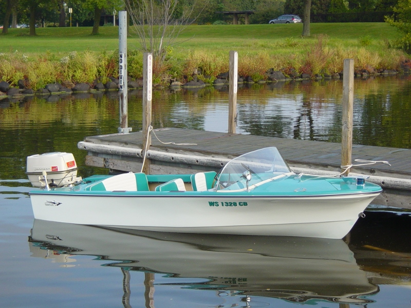

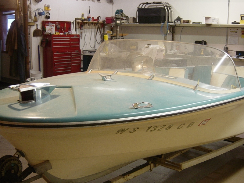

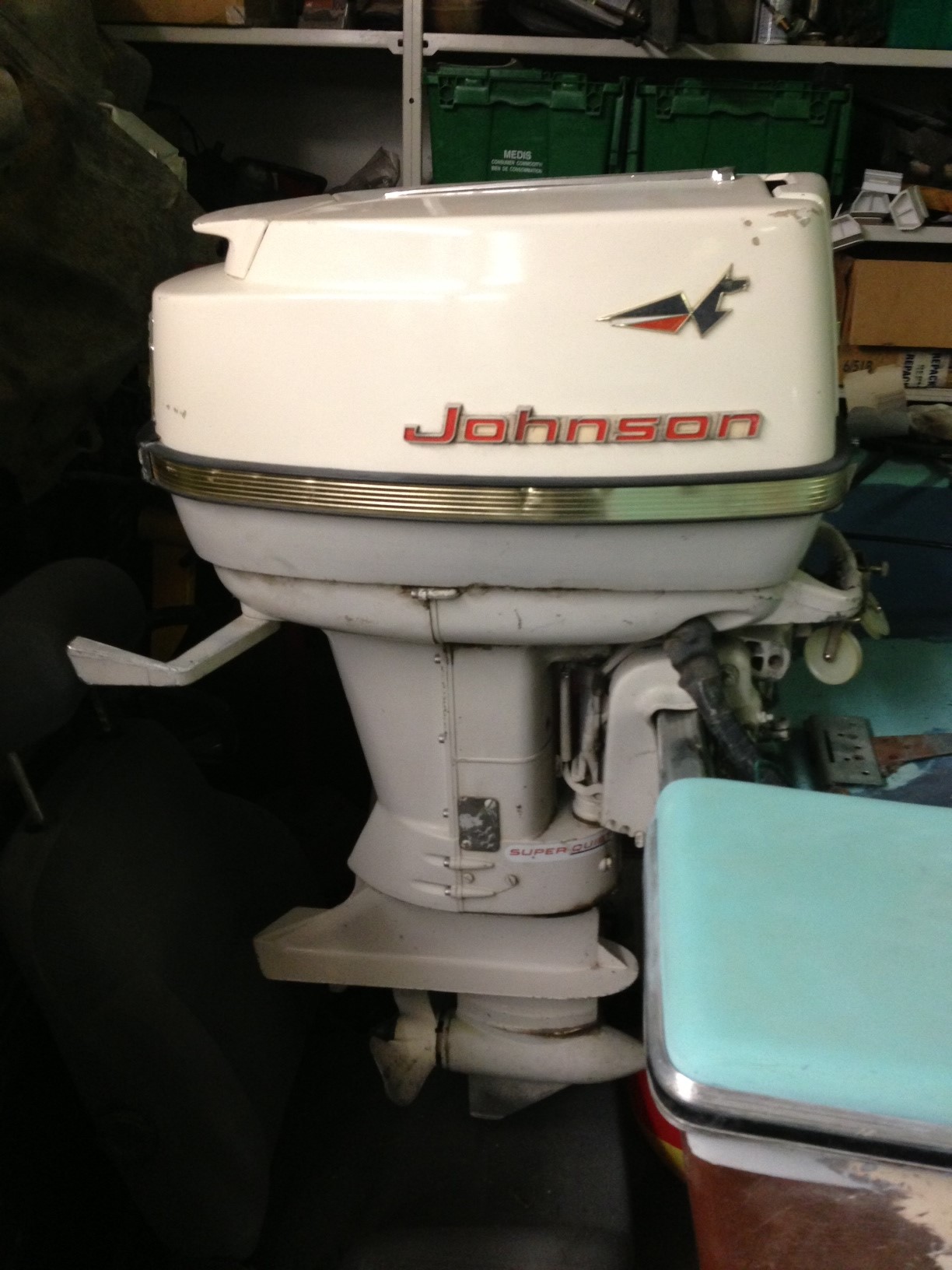

Attached are photo's of my 1960 Arkansas Traveler with a 40 HP Johnson. Nice little boat. If I can be of any help please ask away.

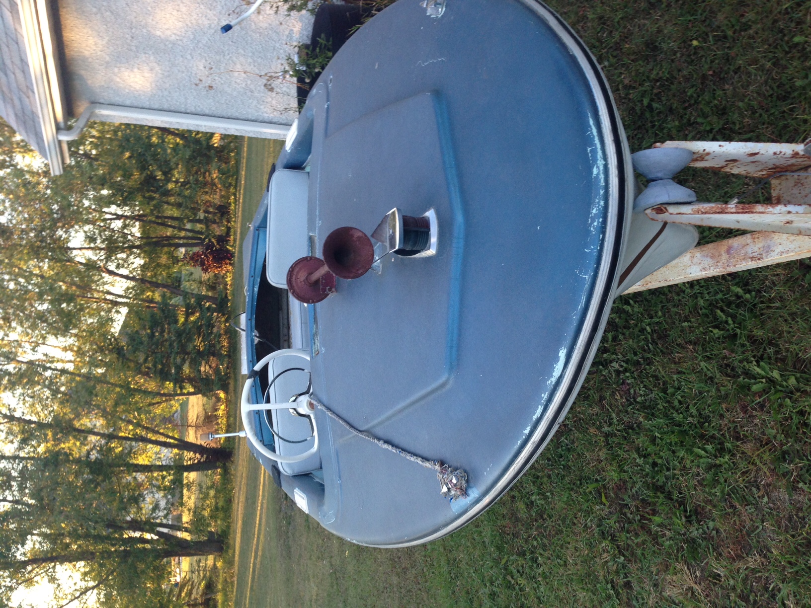

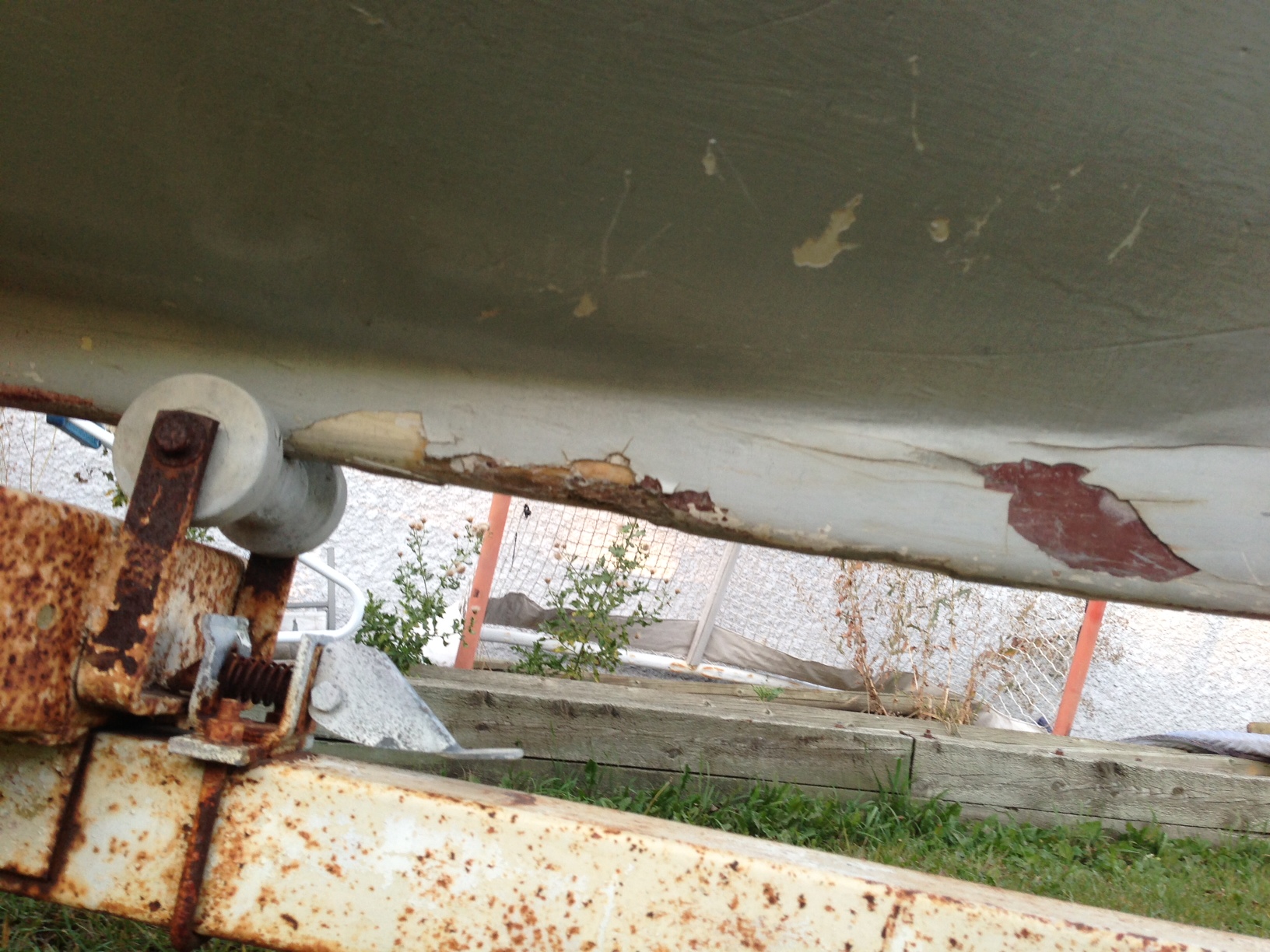

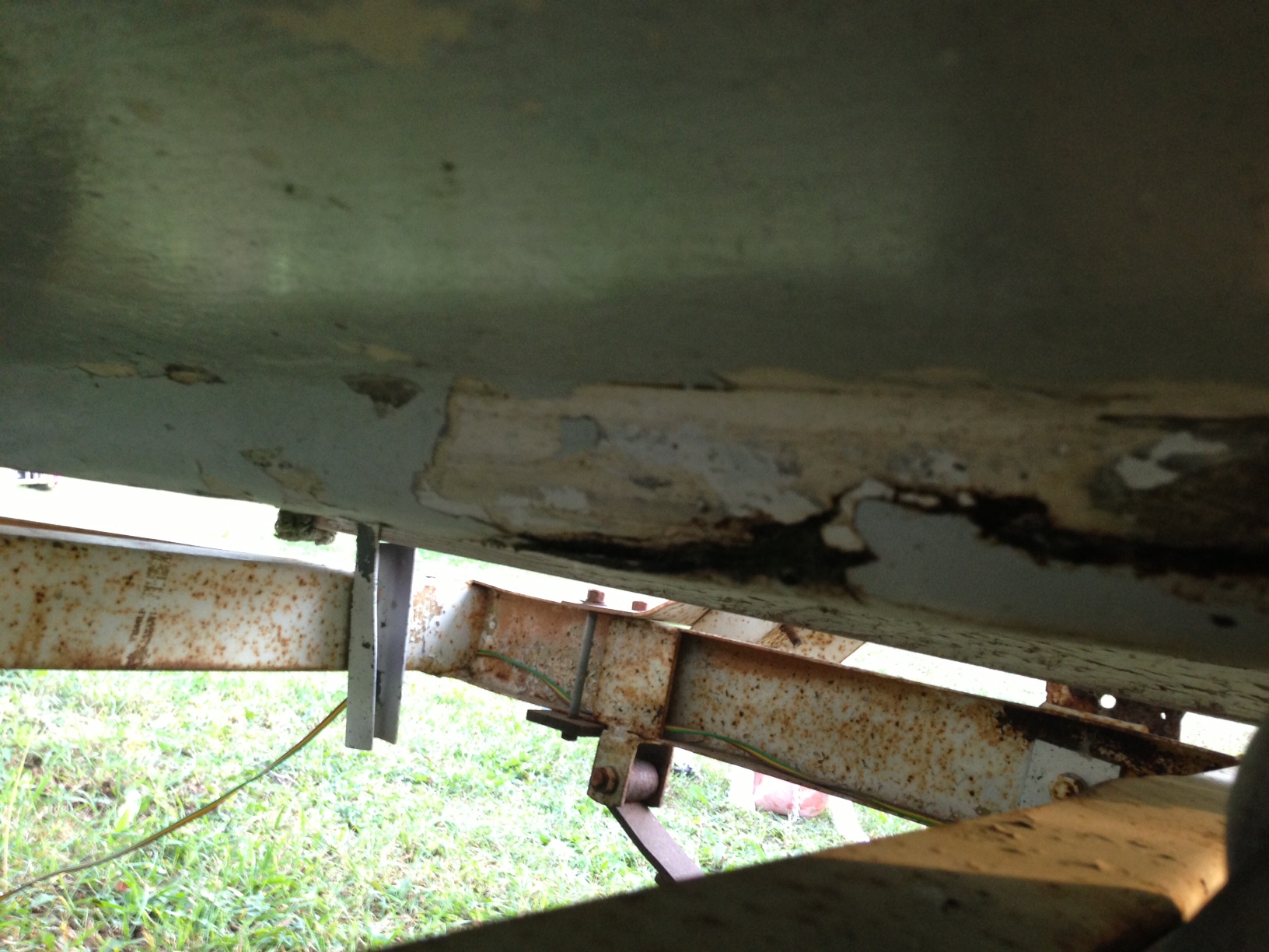

here are the Keel areas that need attention
Re:New to FiberGlassics 12 years 10 months ago #84256
Your Boat looks great I want to bring mine back to the original white and light Blue very similar if possible

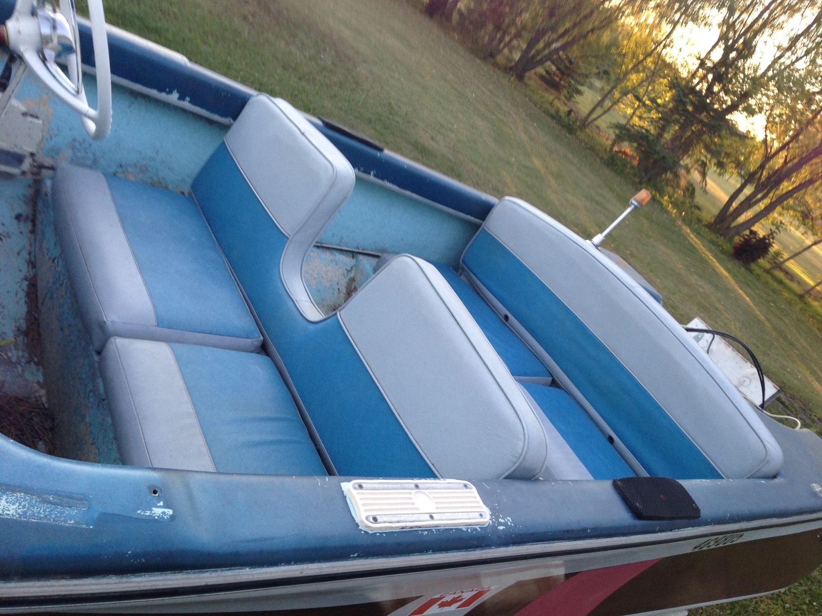

Re:New to FiberGlassics 12 years 10 months ago #84318

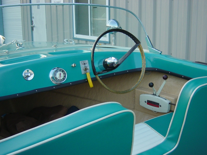

Someone did a nice job replacing the upholstery in an original style.

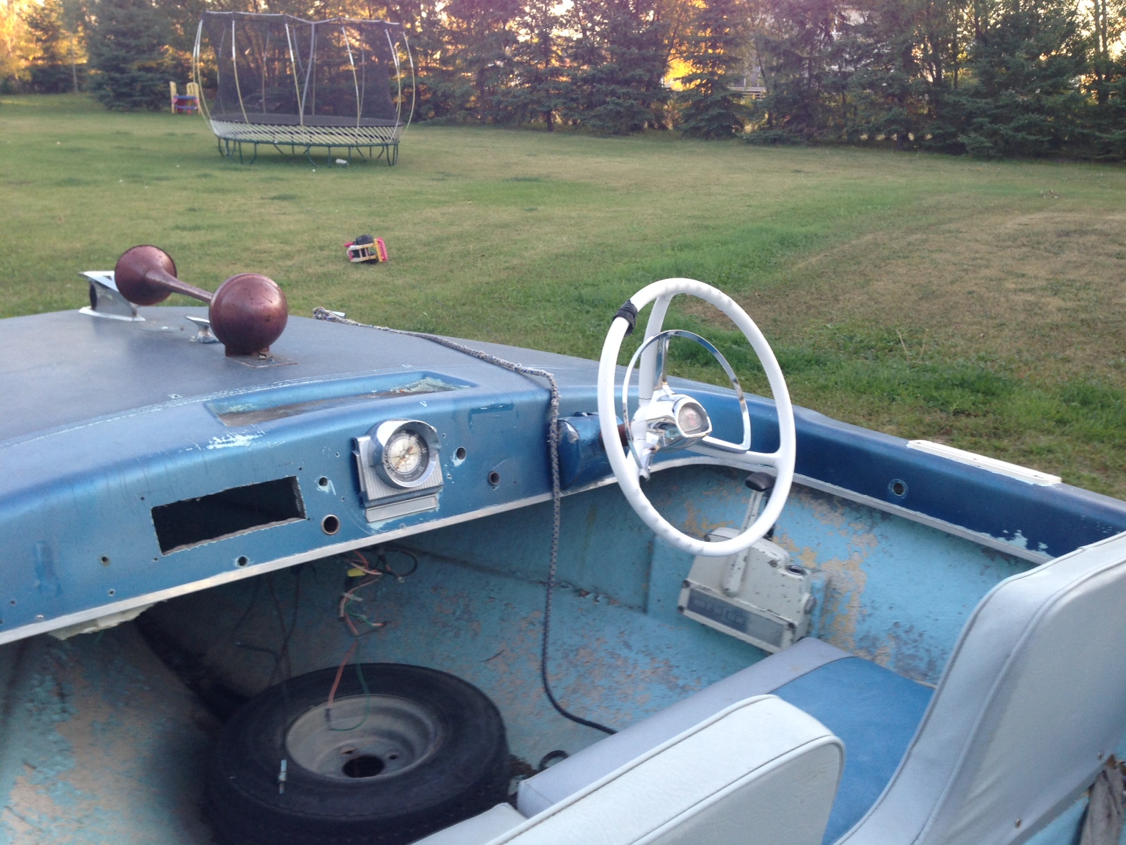

Is that a steering wheel from a car? Never seen anything like it on a boat!

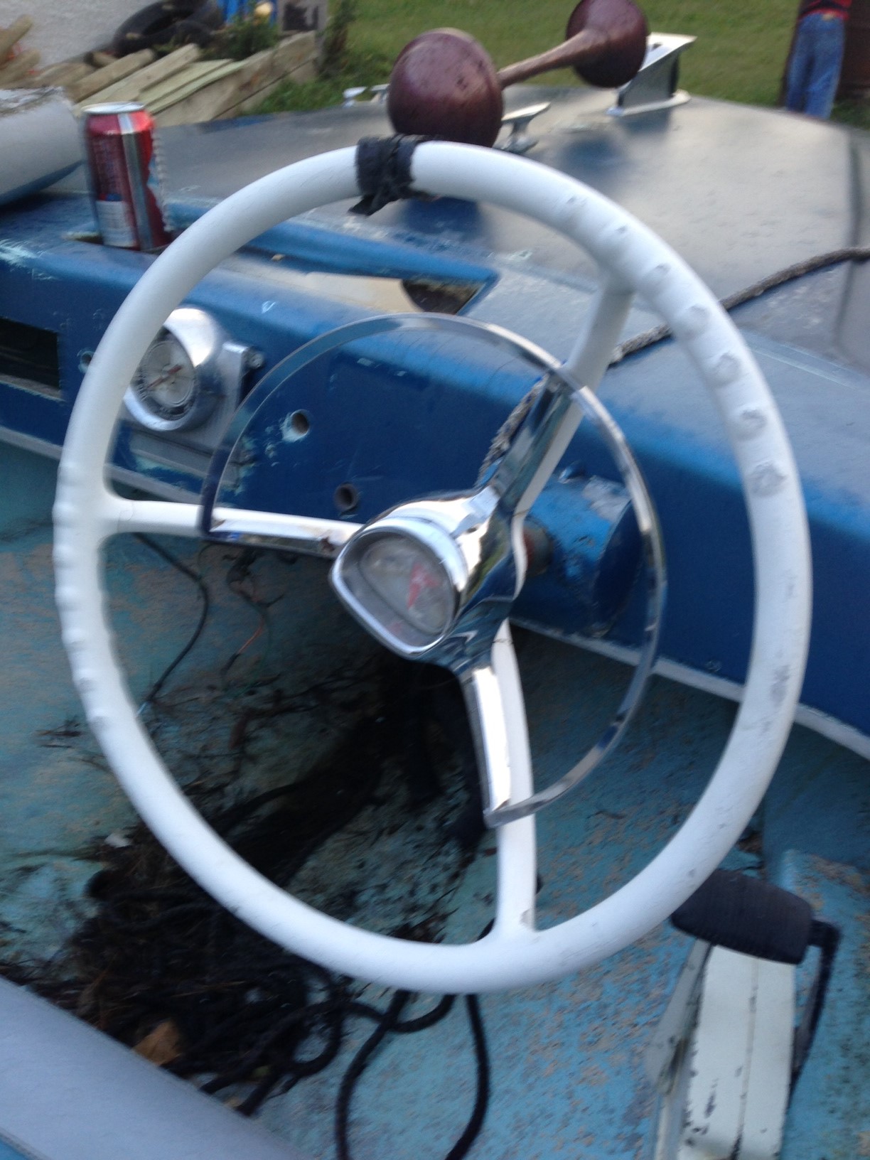

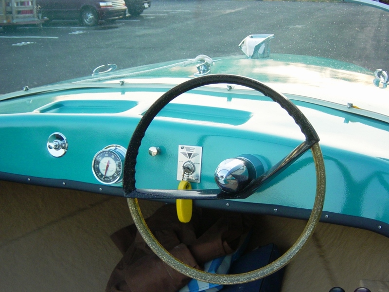

Re:New to FiberGlassics 12 years 10 months ago #84339

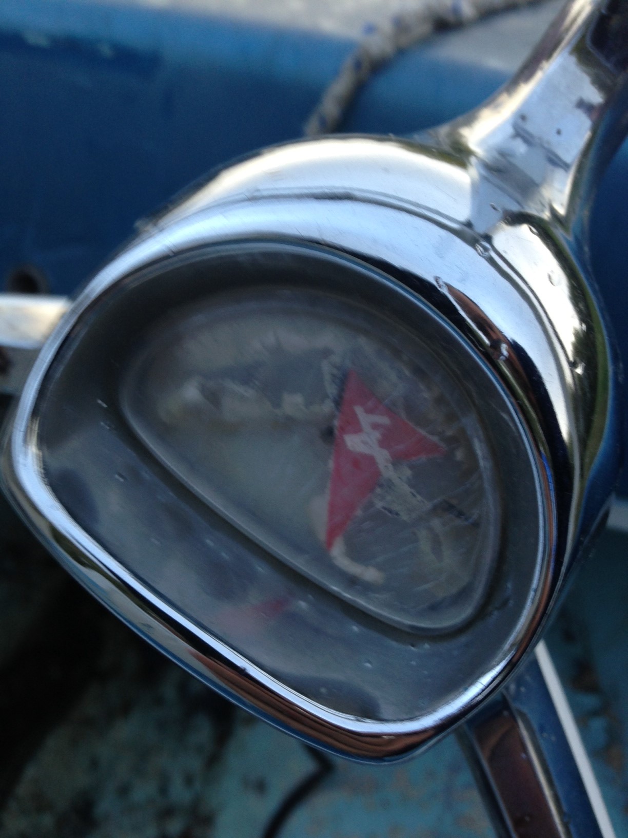

Hi HandyAndy as far as i can tell the steering wheel is original
here are some close up shots of it you can see the AT symbol in the middle for Arkansas traveler

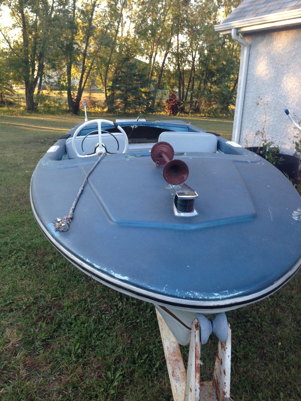

To me that horn says, GET OUT OF THE WAY!!! That boat is gonna be nice,

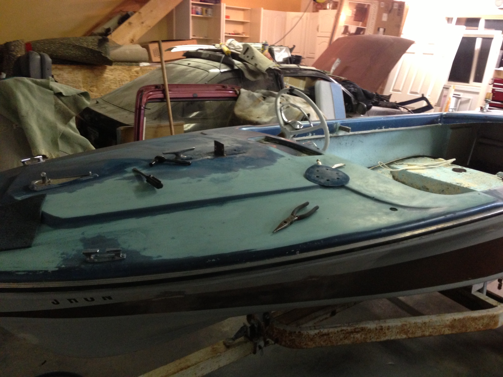

Re:New to FiberGlassics 12 years 10 months ago #84534

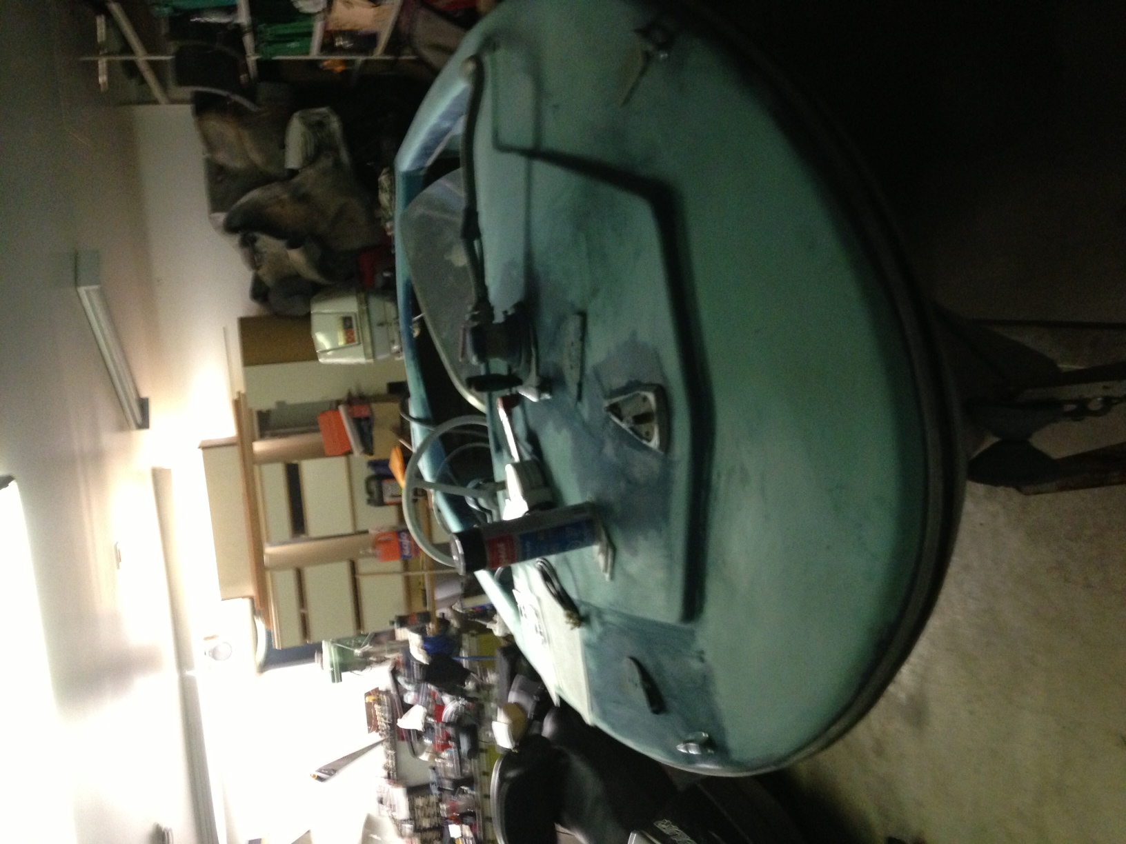

Started to buzz this down to the original paint long process but patience will pay off in the end
Anybody know if these thing had identification plates?

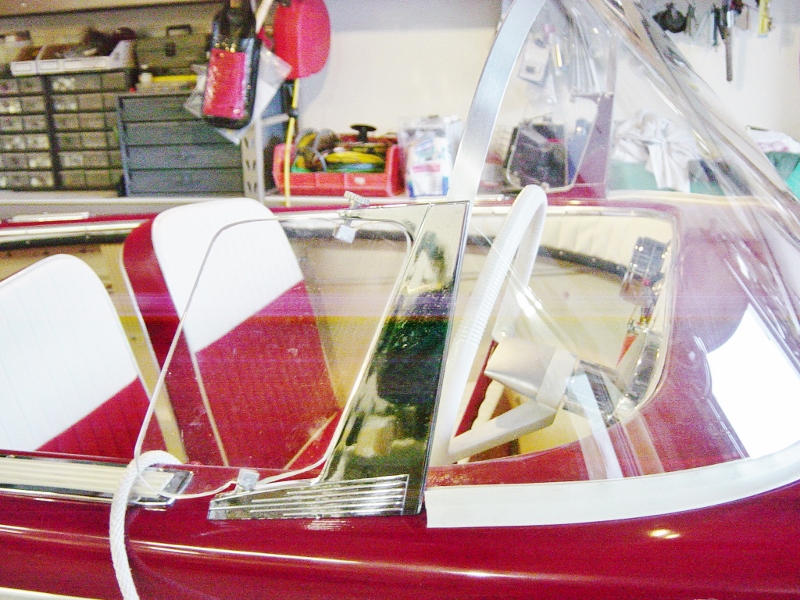

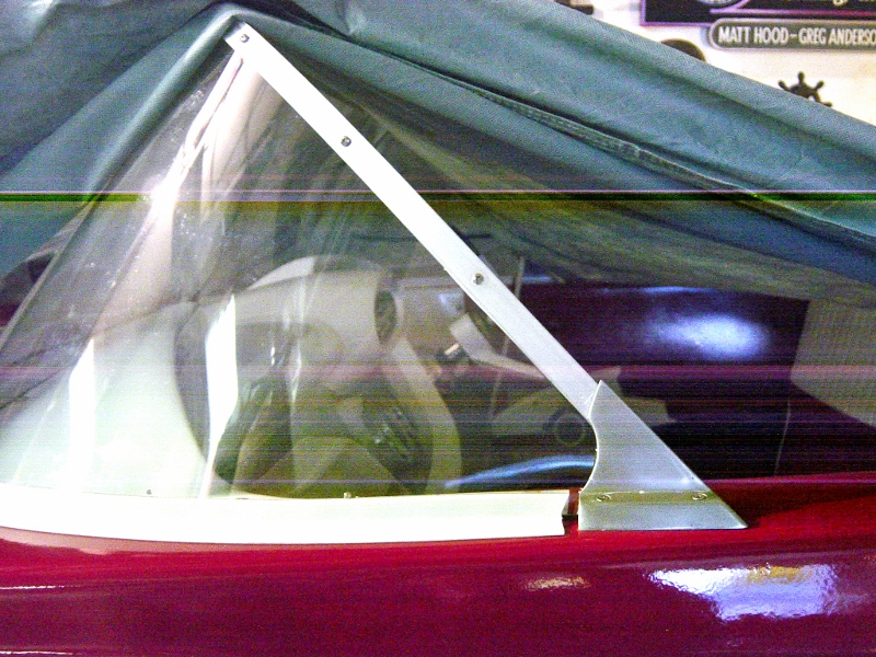

You could get your Windshield dimensions from your boat. From your photos I can see the outline where the original windshield was located. You will need the "tip to tip" dimension minus the hardware used to hold the windshield to the boat. The windshield on a Arkansas Traveler is quite small. If I remember right it was 62". The height dimension is not that important. Nearly any windshield height will work. I have gotten windshields off of eBay and Craigslist and had to cut them down height wise to make them look proportional. There is also flexibility in the "tip to tip" dimension. You can go with a 60" to 64" "tip to tip" dimension as you will find that the windshield is quite flexible. (Be sure to confirm the in place dimension of 60".) You can find quite a lot of windshield hardware on eBay if you keep your eye out. (Click on image to enlarge)
Hardware use to attach windshield shown in all three photo is off of eBay.

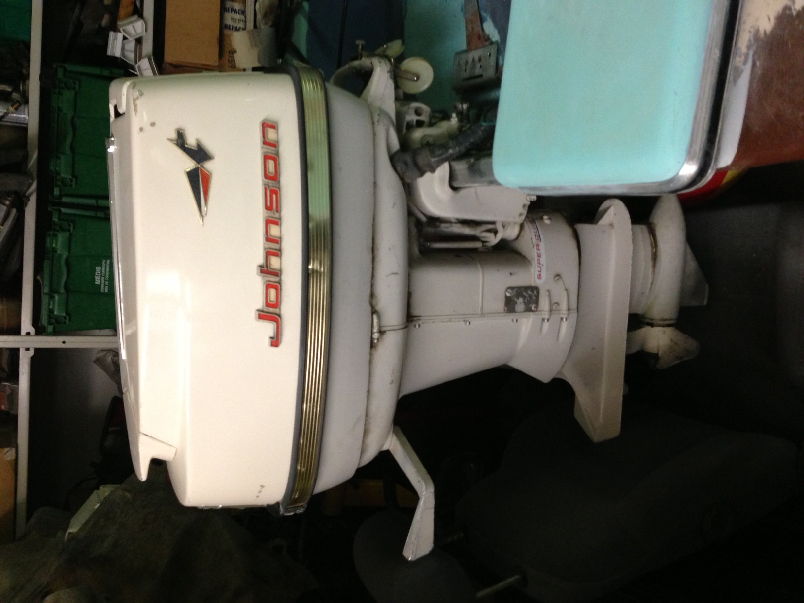

Re:New to FiberGlassics 12 years 8 months ago #86775

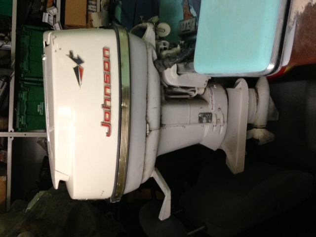

Small update I have been collecting some items for the project, most significant is the 1962 RK-24 40hp Johnson outboard,its looks to be in great shape hope she runs as good as the previous owner claimed
