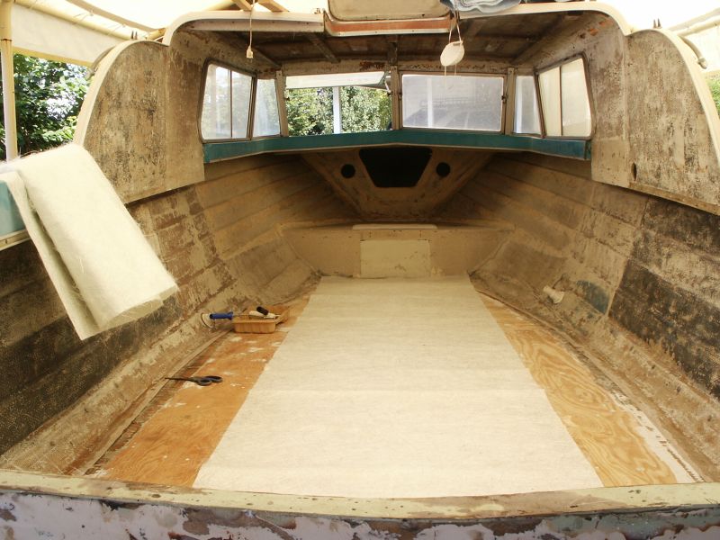

ok layed the first layer of mat down, i need to let it dry then crawl around and do the sides, then go and lay the cloth down...
i have a good question.... i will put my cabin walls up but i don't have anyway to fasten it. i was thinking of laying a few wood cleats down after i glass the floor. then glass those and then but my wall up to it and screw through into the cleats that way i wont be drilling into the floor.

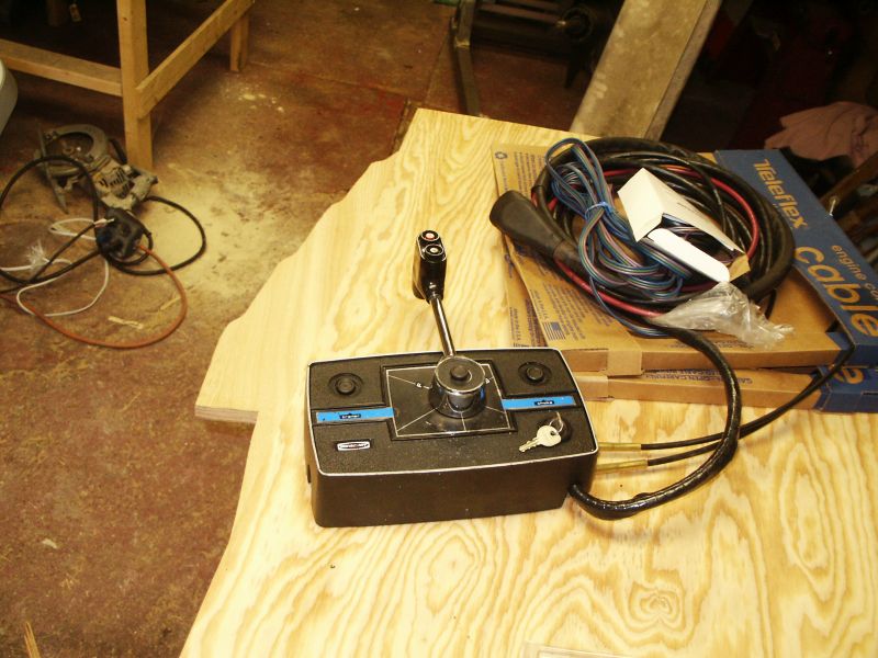

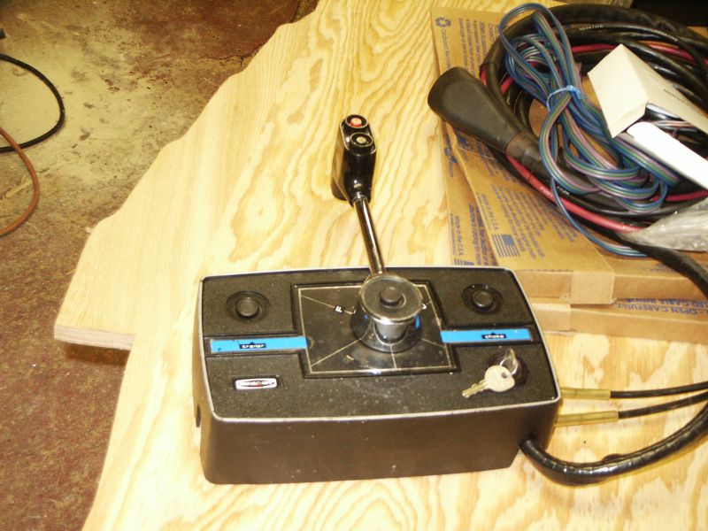

one more thing here are a few pictures of the merc controls from Joe.....

That is about the best way to do your walls. Looks like your going to have a nice floor area when your done there. Keep the pics coming, Skip.
