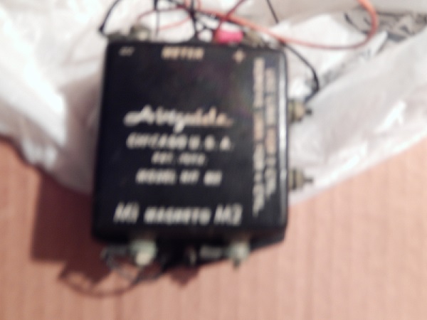

Rummaging through my old electric box and found this thing that I pulled off the Shell Lake last summer. The PO used it for something, it was screwed to the inside of the transom but not wired to anything. Anyone??
It measures about 3 1/2" square and about an inch thick.

Looks like a voltage regulator to me.

Best guess...sending unit for an Airguide tachometer.

I would concur with this

OK, I agree, never seen one before, are there any instructions that would go with it, does anyone need one. I don't know if it's any good though :)

Doesn't look like an Airguide unit to me. Most of those that I am familiar with were rounded. Maybe for another brand. The number looks like "6BY"

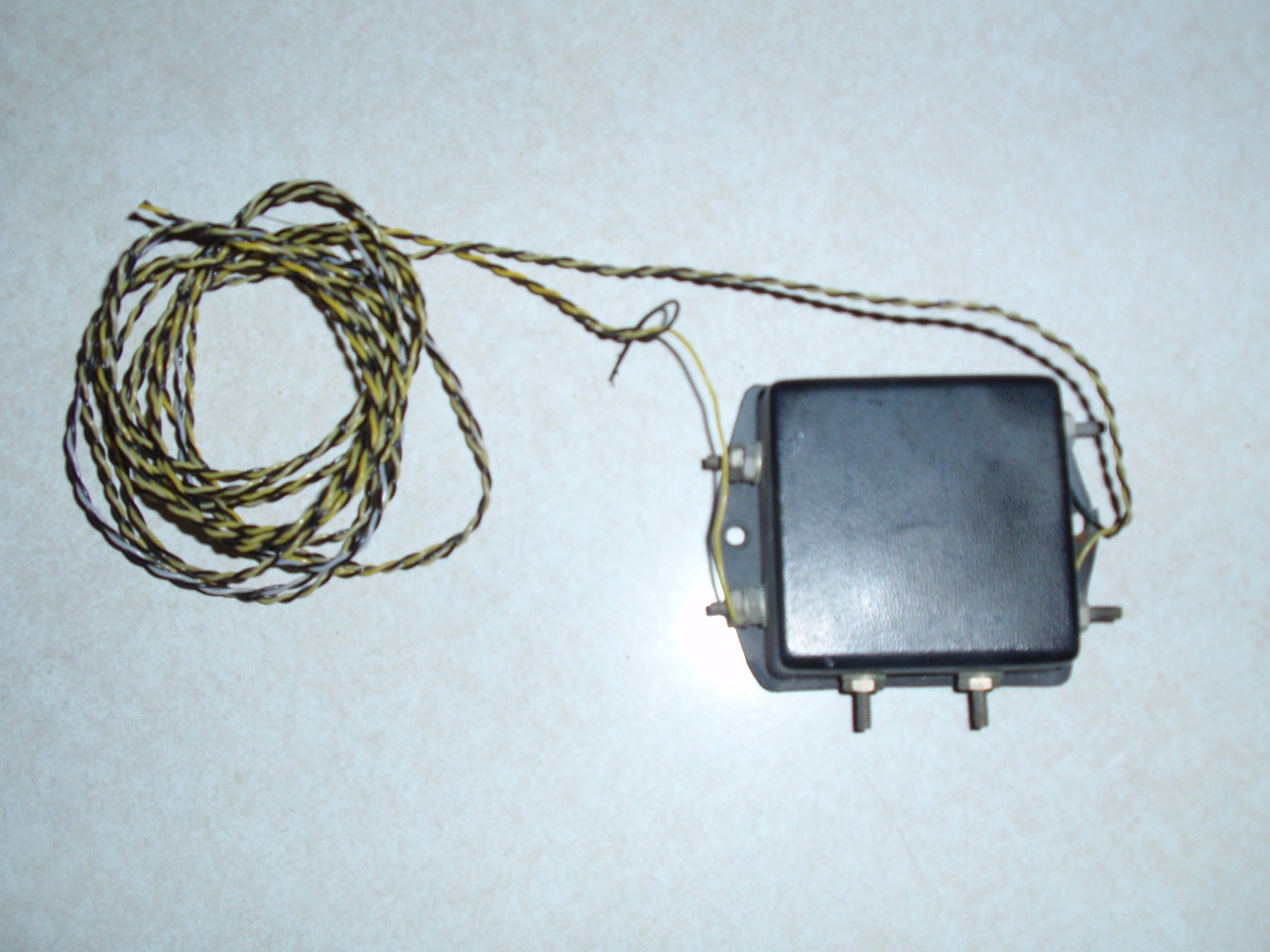

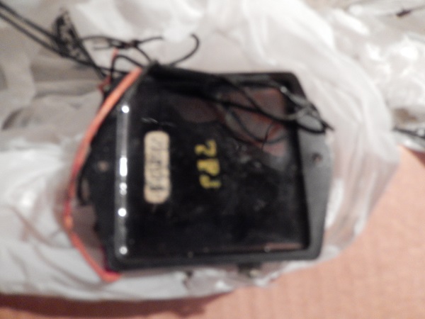

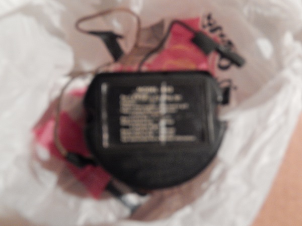

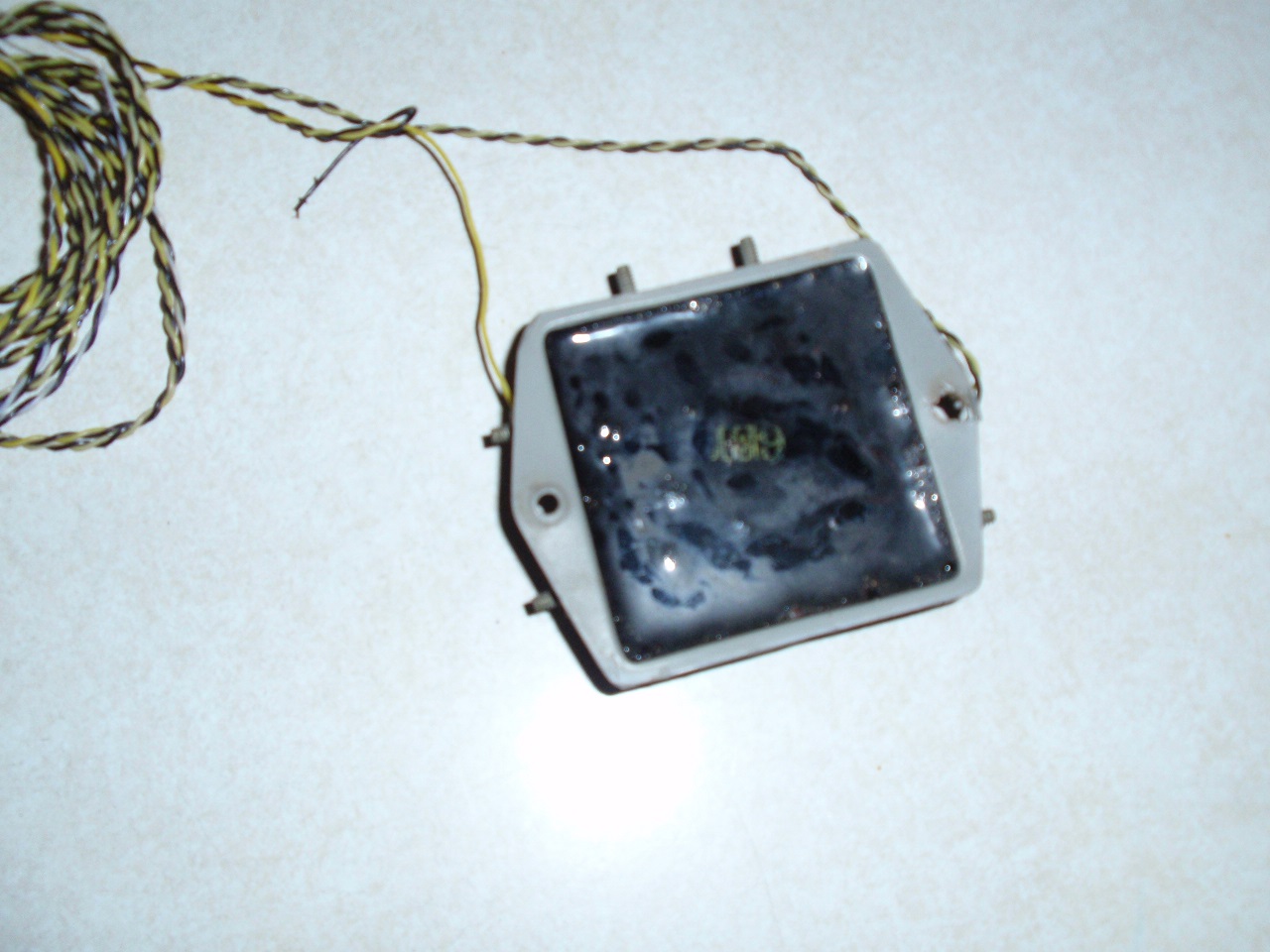

Couldn't find notes, but did get to my "stash" and remembered as soon as I saw it. The old round/halfround were original, replaced later with the square ones. pics should tell the story.
Re:What the heck is this?? 11 years 8 months ago #84367
Didn't get notes, but remembered as soon as I looked in my stash. Square are new, semi-rounds are old. See pics.
Sorry so blurry---I dropped my camera and think I messed it up!

That's probably the one. All the print is worn off the one I have so I don't know what terminals go where. I also looked through my stash and amazingly found an Airguide tach. Now if the two match up and are for a 1967 4cyl Johnson 100hp golden meteor with CD I'm in luck.

this will tell you what tachs go with what engines...just found the site...
www.classicboatwork.com/classicparts/gauges/airguide/airguideinstructions/Airguide_Instruct.html
I'll look at mine again, the square ones may have been made to be universal and depended on how it was hooked up - not positive of that though....
