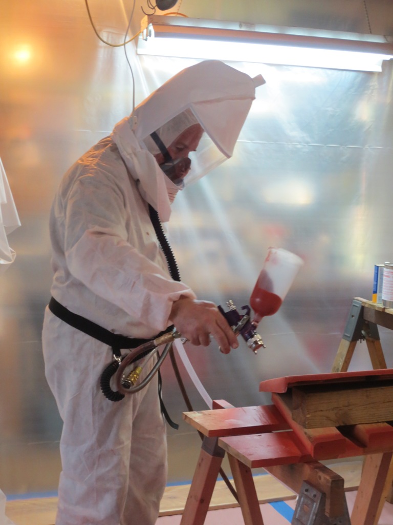

After years of suckin up stuff I finally spent the big bucks and invested in this set up.
www.tcpglobal.com/itemdetail.aspx?itemno=AXS+HB01
I was shooting gel-coat and decided to heed to the brain damage warning on the label. It is a great tool and my only regret is not buying it sooner.
I thought about trying to put something together but the drawback with shop vac is that the motor is cooled by the discharge air. I also heard that a large bilge pump can move enough air for a respirator.

The beauty here for spraying is the hood which is pressurized by the mask. Now you don’t have to duck and hold your breath when you happen to be in the way of the overspray or when you’re down stream of where the exhaust is pulling it. You just keep your pattern. The hood has a replaceable lens held in place by Velcro.
HobbyAir is near where I live so when I went over there and I saw this stuff I was sold.
The gear is in place when I enter the booth and does not come off until the cans are sealed and the equipment has been cleaned.
