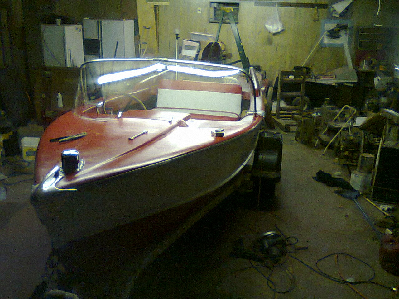

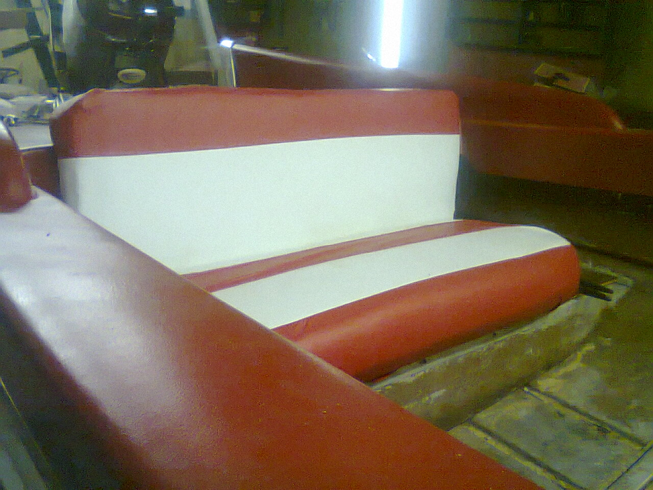

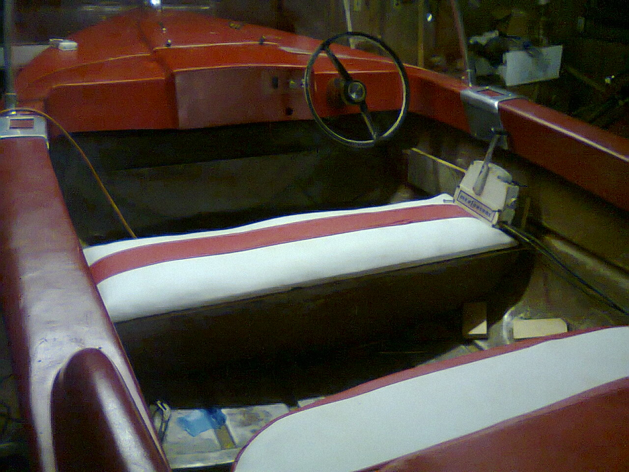

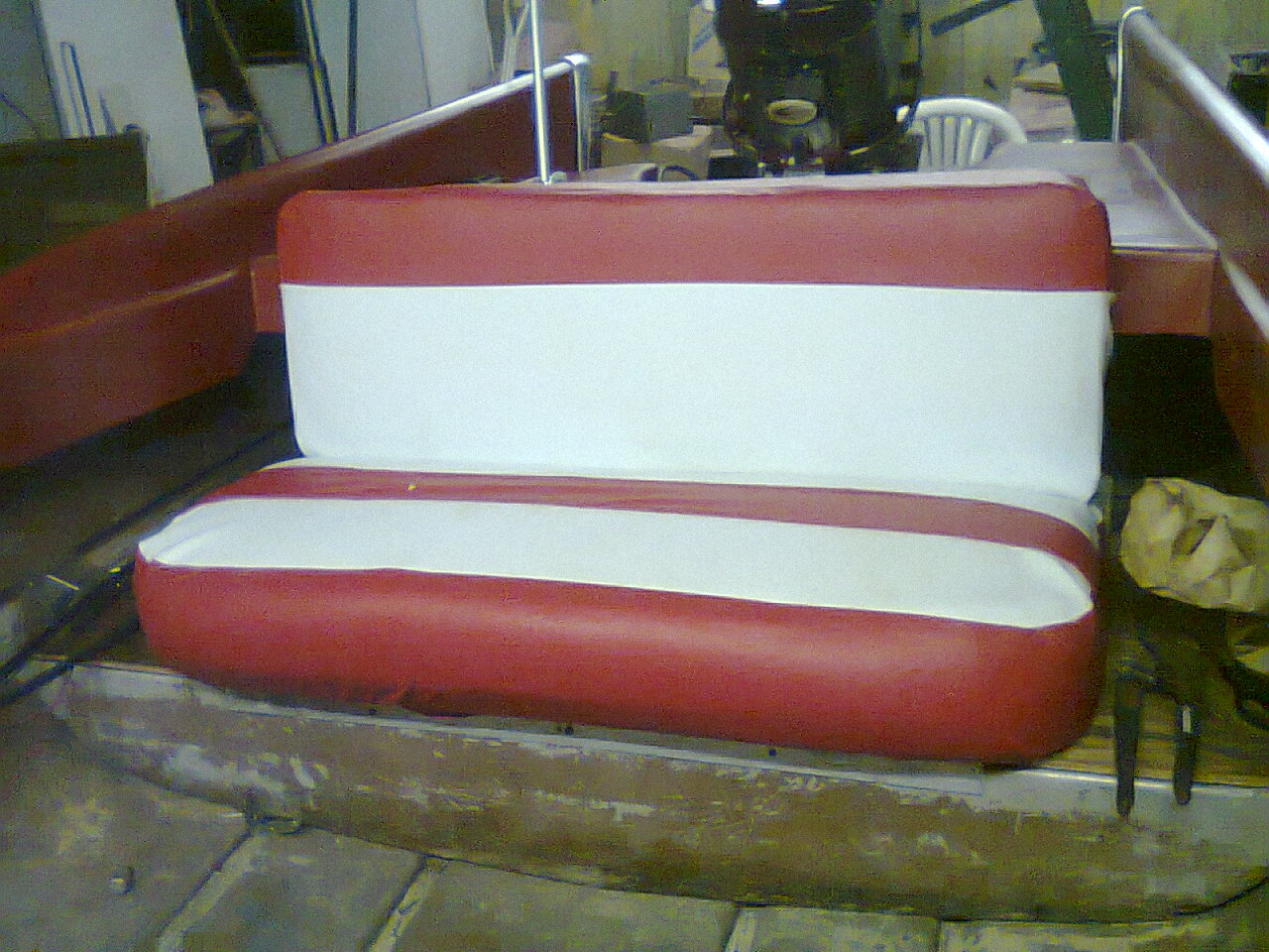

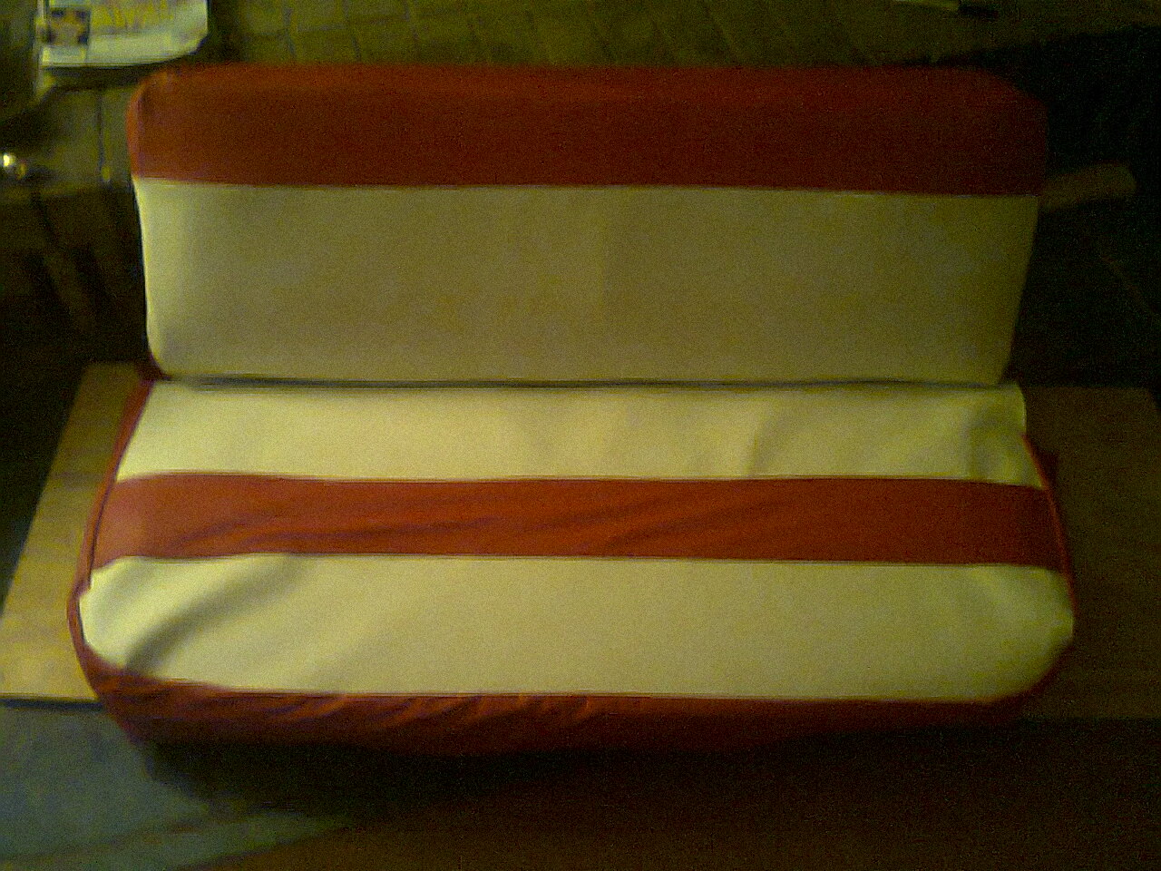

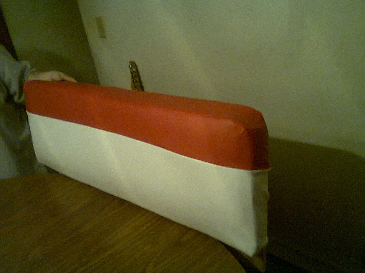

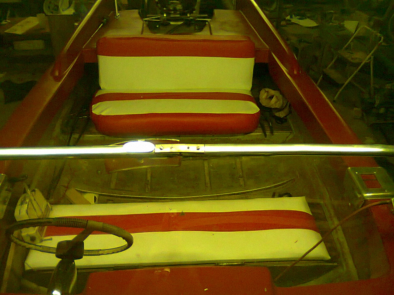

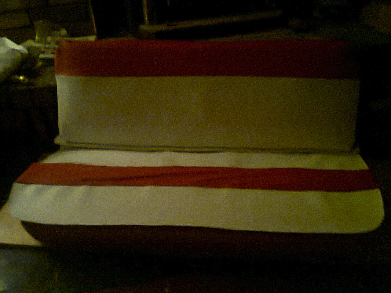

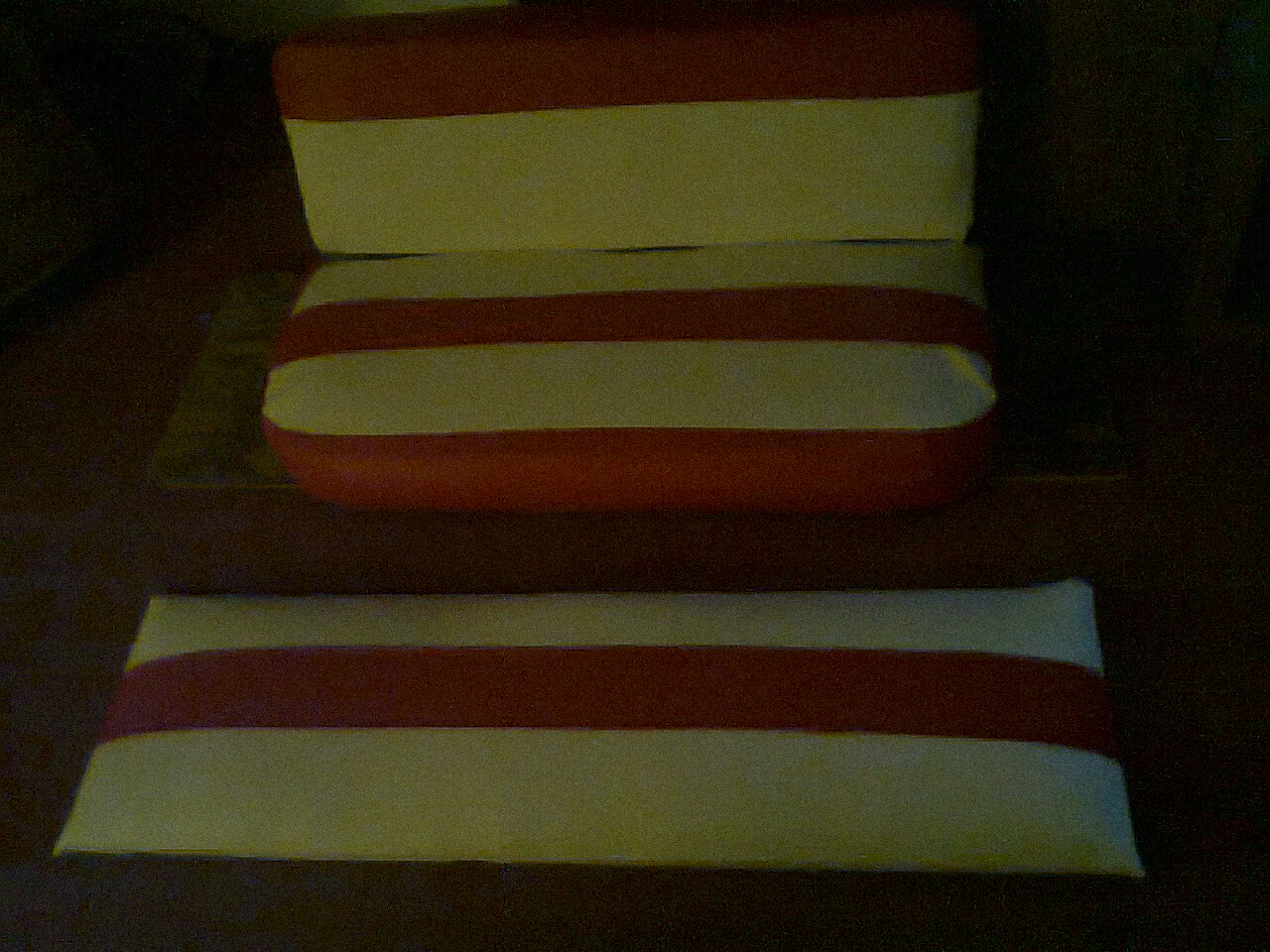

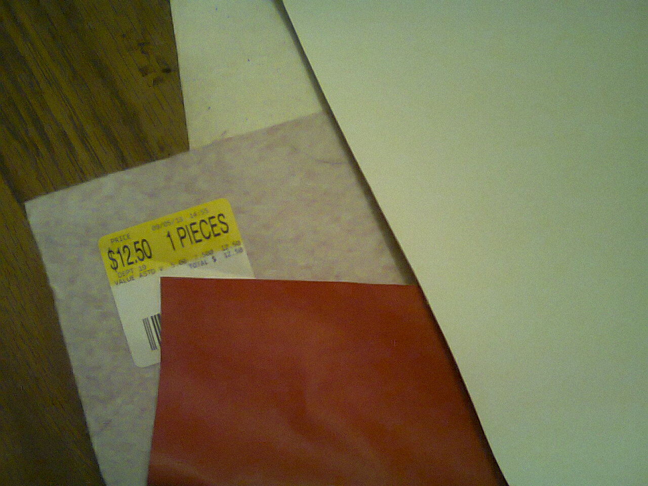

Ok ,The first step is to gather any and all dilapidated supplies you can find out in the barn, beside the driveway and the stuff that's laying under the old camper shell behind the barn. For the authentic antique look , never use new materials.
Tools you will need include scissors pliers knife staple gun a sewing machine and bolt cutters are optional

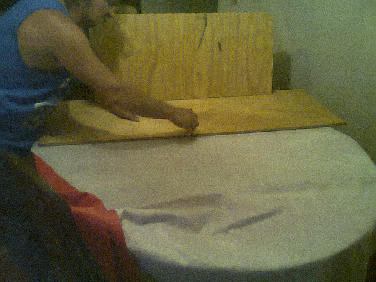

When deciding what to do with old upholstery in an old boat, take a moment to check everything over. In the case of this project, A 1957 Arkansas Traveler,I decided to remove everything and start from scratch. I have decided to redo the original looking setup,plywood and vinyl material. I have chosen 3/8 " plywood for the under seat frame platform,and the backrest ,the actual seat will be 3/4" plywood .The front seat is a simple bench seat with a thin cushion .It provides little comfort , just enough to be the right height for driving as the older style boats did not always give room for today's body build...
Given the rear seat needs to be large enough to for two adults I have snagged a 3rd row seat from a 1980 Chevy Suburban that is being stripped for scrap metal. The automotive seat, wrapped in plastic from the manufacturing process , appears to be in near new condition, and the one seat provides enough foam for both boat seats in this project.With 5 yards of new MARINE GRADE Vinyl I should have an excess of material. Now that i have all of the needed materials , lets get started with measuring vinyl and forming the pattern pieces to get them sewn together.

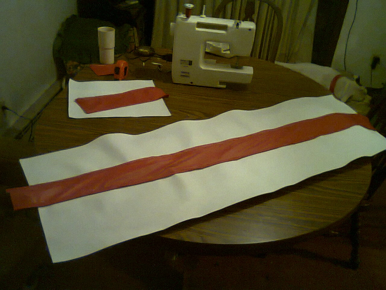

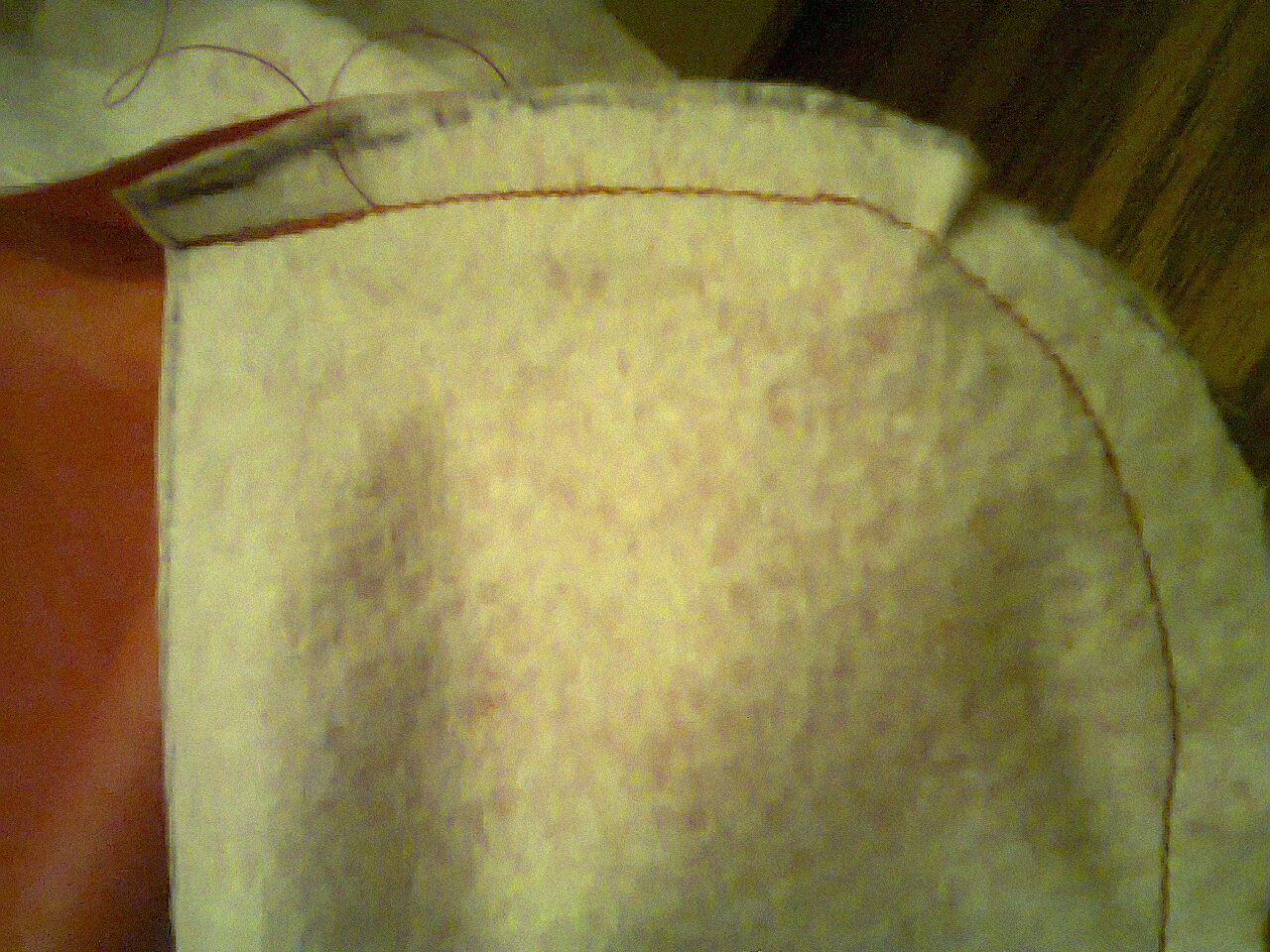

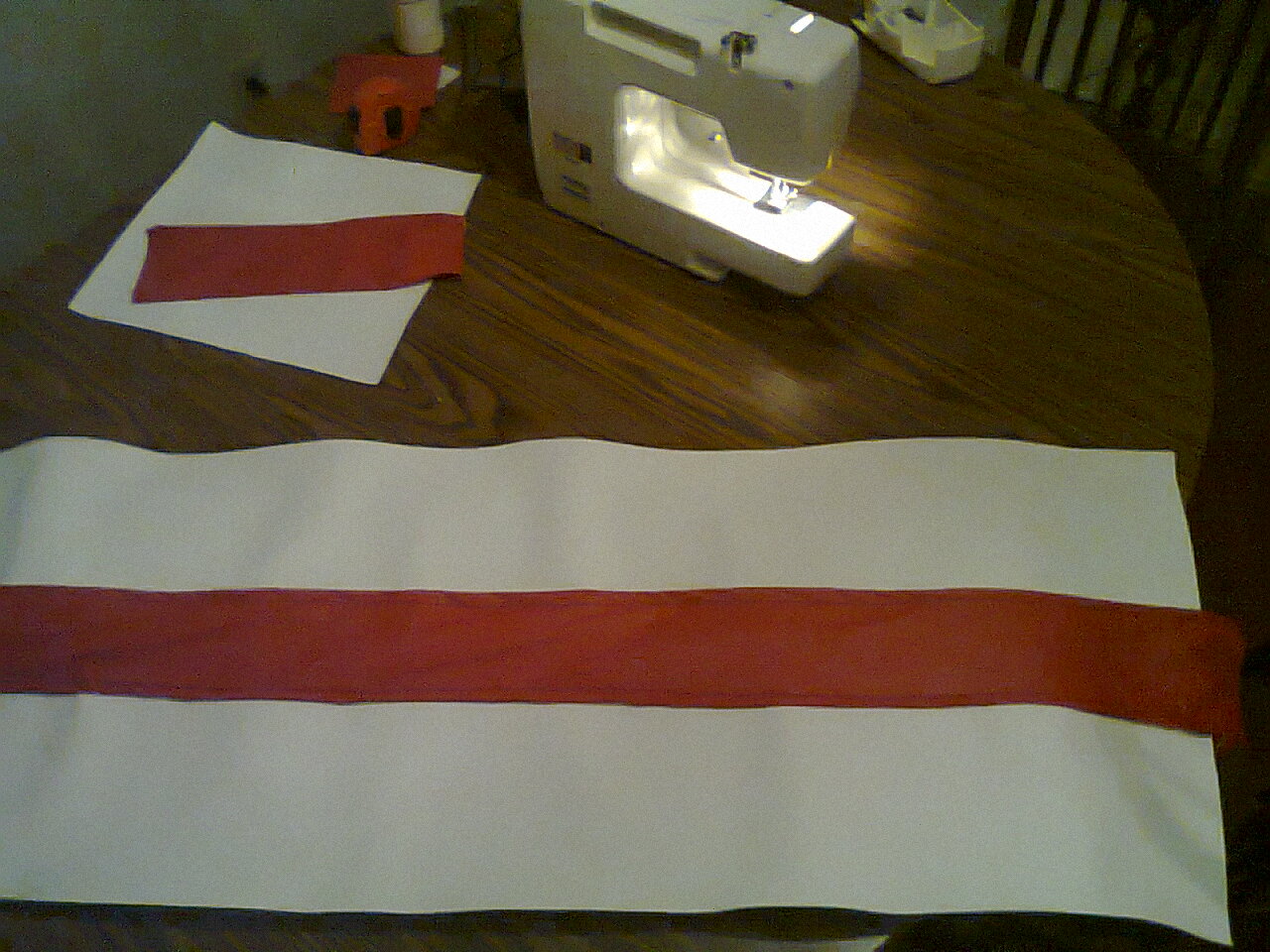

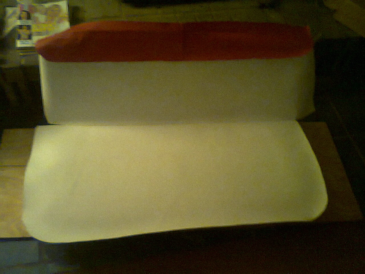

When outlining a pattern onto your vinyl remember to leave room for the seam ,as the sewing machine will take away from your available material , making your material smaller.I'm not going to go into the tuck and roll or diamond tucking or turfting processes as that is extremely time consuming.Once the pieces of vinyl / cloth have been cut and the sewing begins. Your project will come together very quickly.Once all of the fabric pieces are assembled ,you may choose to install the fabric and cushions using a header , usually a piece of wire that is sewn to the outside edge of the material , this gives extra strength and support when stapling the cloth to a wooded base or back rest.

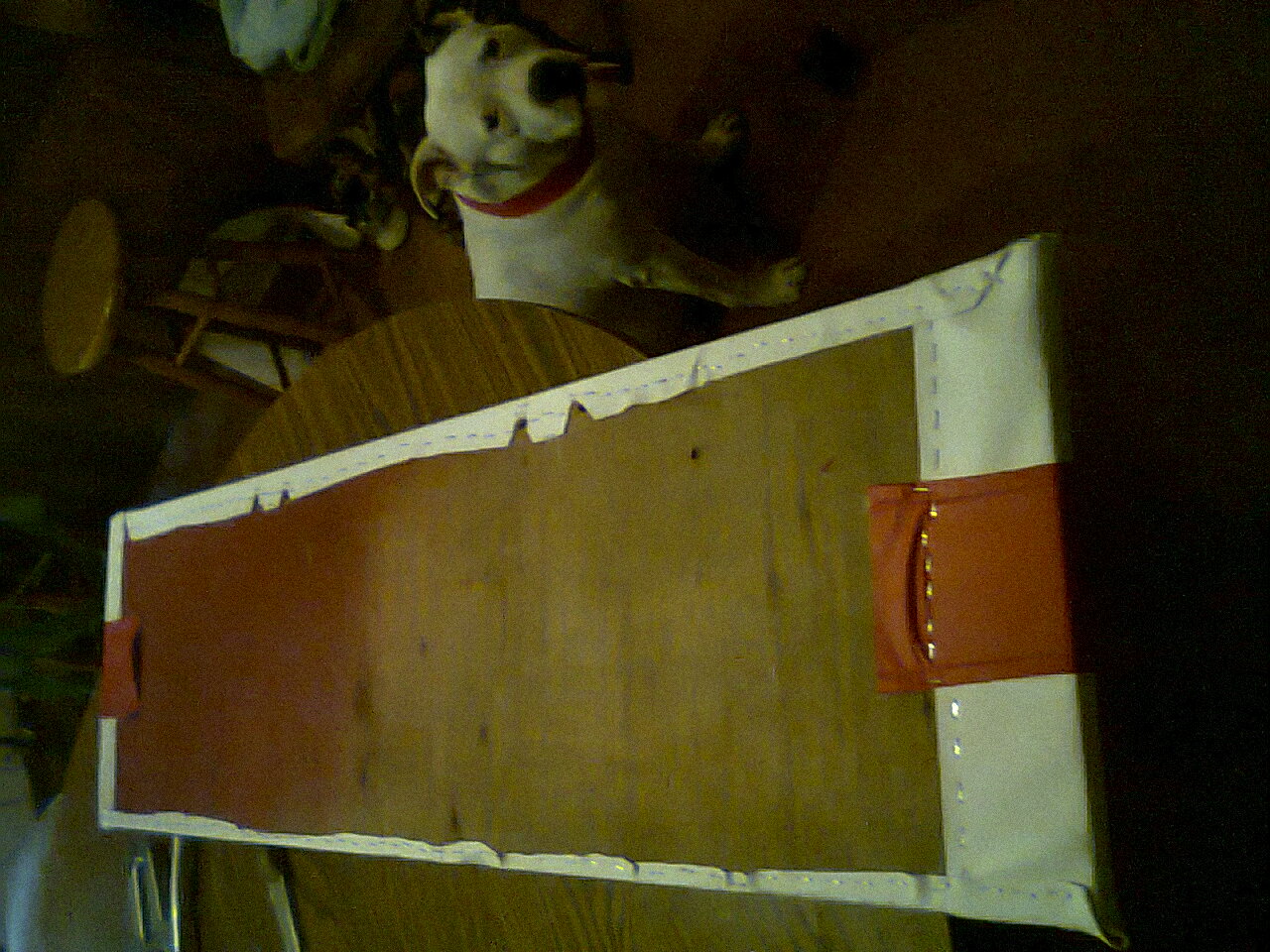

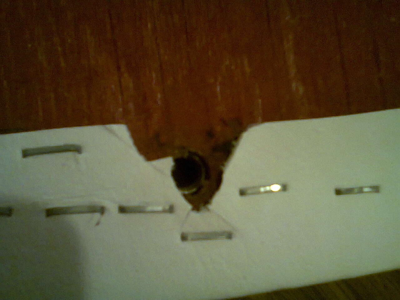

Beginning at a chosen corner begin stretching the fabric over your base and staple as you go , a helper will make this much easier . Keep in mind any screw holes that will be needed later , such as hinge bolt settings, covering them makes it difficult to mount your finished seat.

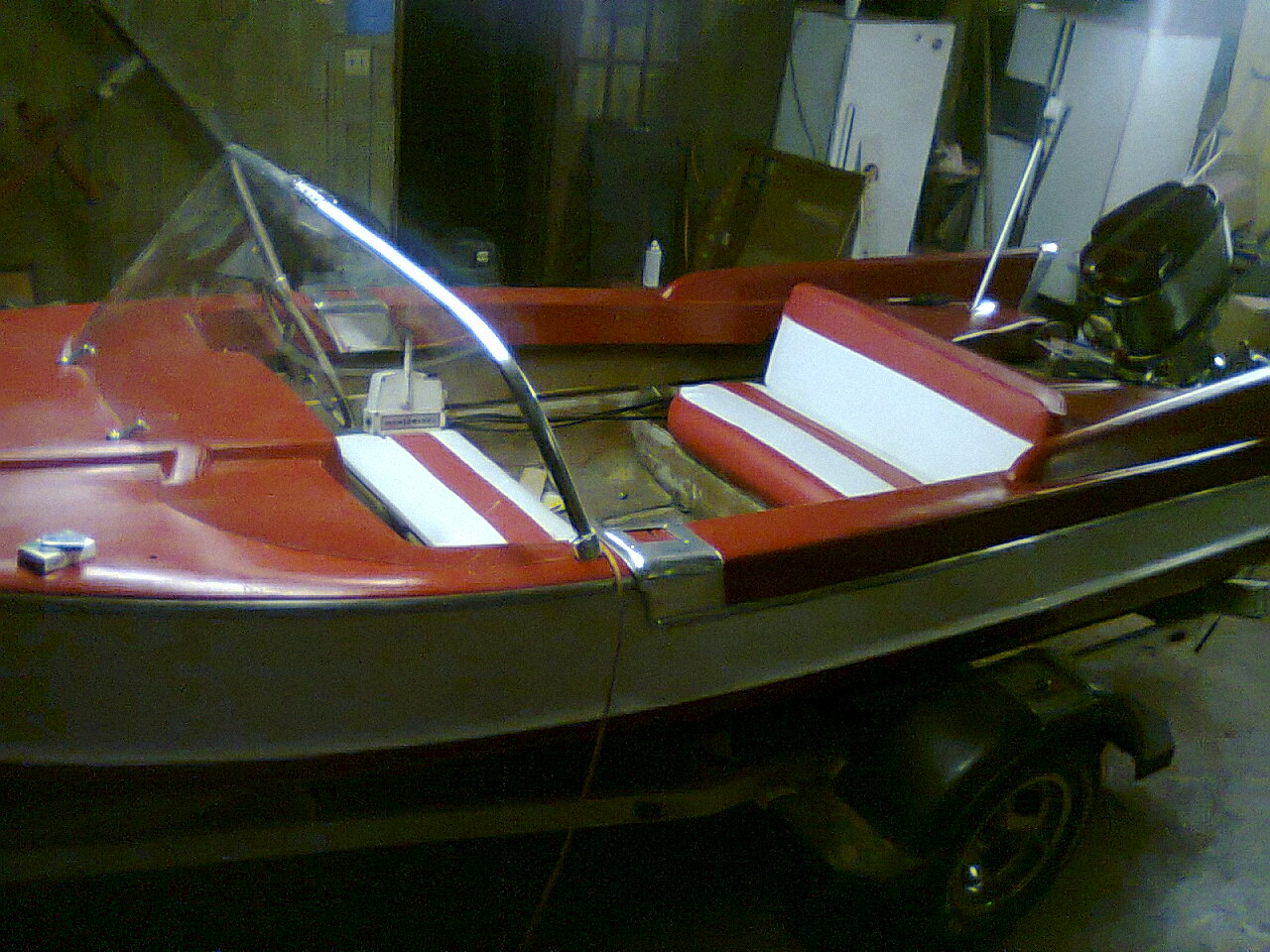

Wash rinse and repeat this process for all of the seats you will be working on and the end result is as nice as you make it . This is how my grandmother taught me many many years ago. Putting this together was a huge task,I feel i pulled it off rather nicely with out going over my $100. budget.
I Truly hope this is helpful to anyone and everyone,that is contemplating new upholstery in their boat ..
Thanks for looking .. David Bradberry .. Gainesville, Mo.

Very nice looking,David. The Tu-tone accents really make that cover POP. jim
Re:Do It Yourself Upholstery ! 13 years 6 days ago #83287
Looks great and the satisfaction of doing it yourself.
Re:Do It Yourself Upholstery ! 13 years 6 days ago #83322
Excellent, it came out Great!

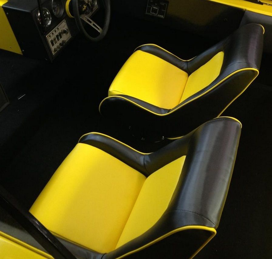

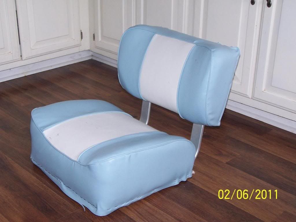

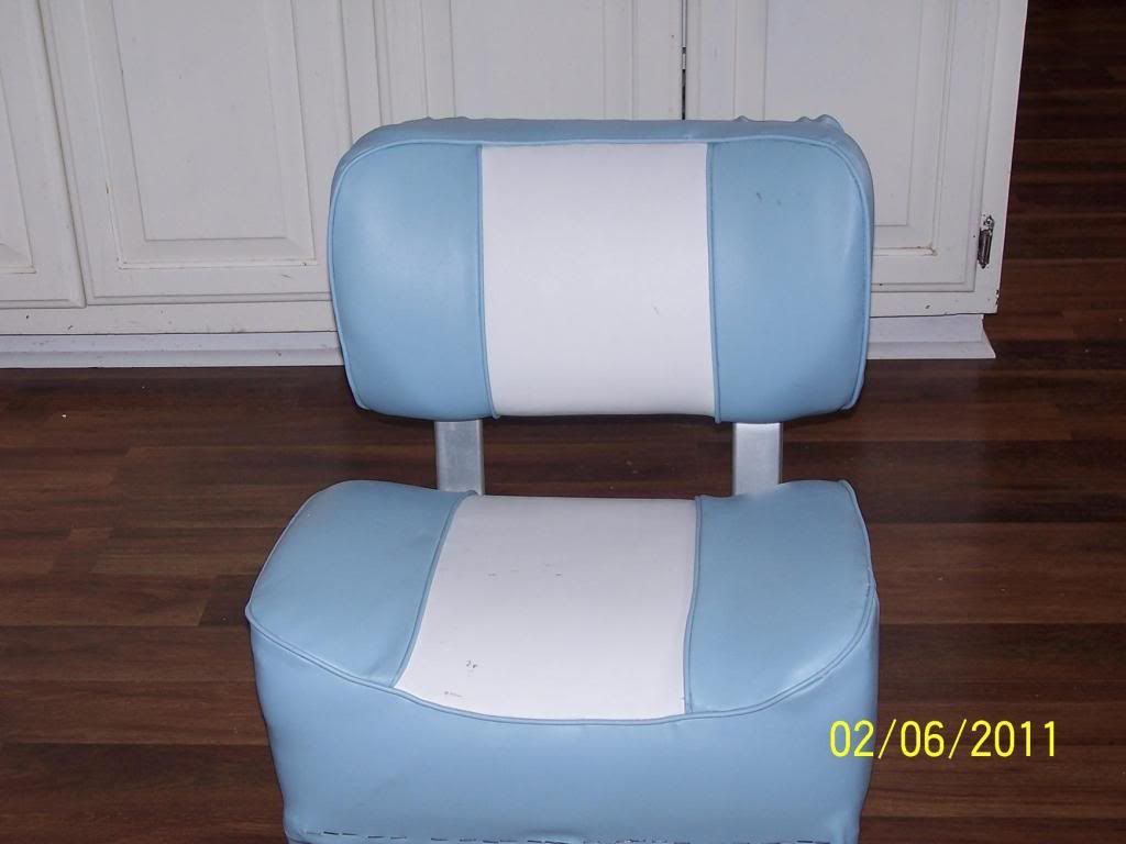

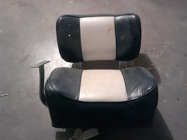

I too did my own upholstery. I started by purchasing some Old Bass Boat swivel seats that were Green and White and re-upholstered them using Baby Blue and White. I used a Kenmore Home Machine and the learning curve was pretty steep. I eventually determined the machine was not UP to the task of sewing thru 6 layers of vinyl so I upgraded to an ALL STEEL Morse Heavy Duty Machine from the 60's. Once I got it it was a LOT easier. Here's some pics of the Swivel Seats once they were almost done.
This is what I started with...
Here's how they turned out...

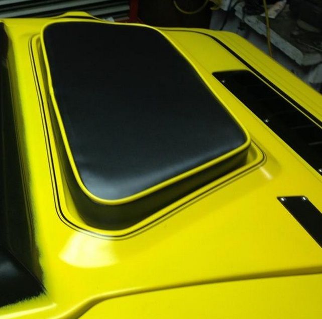

I know it will help me. I recently purchased a Like New 1949 Singer Sewing Machine and I'm re-learning how to sew with just this thought in mind.
Re:Do It Yourself Upholstery ! 11 years 10 months ago #101586
Mike outstanding work as usual! I forsee extra play money in your future! ;)
For what it's worth you can use Monel or stainless. Some folks prefer Monel as the stainless can be a little brittle. That's from the Century club guys. I can't say one way or the other as I've used stainless, but so far only on the new carpet for the trailer buncks. So far so good since the new install 2 years ago.
