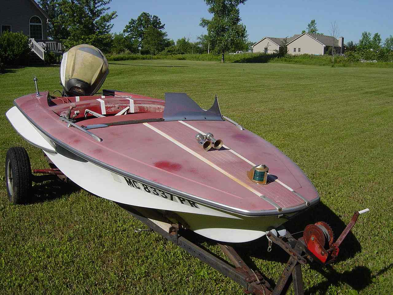

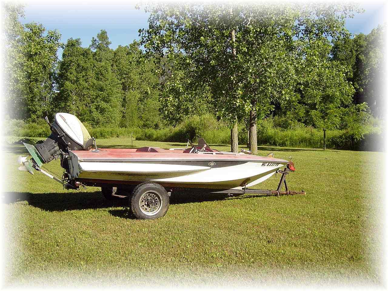

The deck is badly oxidized and requires the most crack repair (although most are pretty minor. The hull is not badly oxidized, but the gelcoat is worn off the bow where the centerline would make contact with the shore when beached. Other than that, it seems to be in fairly good shape. It's not real glossy, but it's not chaulky either.
The attached photos show the boat as I bought it.
