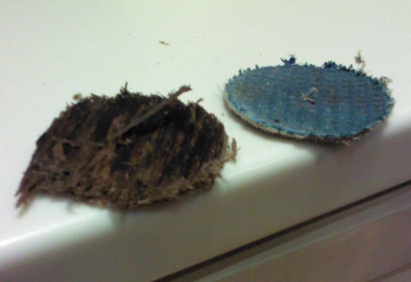

so I finally took a core sample. looks like they used 1/8 inch plywood or it has vastly deterioated.
my money is on rotted.
so it was probably 1/4 with fiber on one side.
so I'm thinking 3/8 with glass on both sides. or just resin on the bottom.

Gotta tell ya Dan that looks like wood to me. I guess the 68 brochure is incorrect for certain models.
I glassed both sides of the g3's I have done. The V-165 I just used resin on the underside and of course I glassed the floor side. I am not sure if glassing the underside was overkill or not. I know it will last long
enough for my grandsons to worry about it and I will be long gone (I hope).
At this point I am sure no matter what you decide, the boat will be
structurally sound. Have you given any more consideration to HDPE or PVC board?

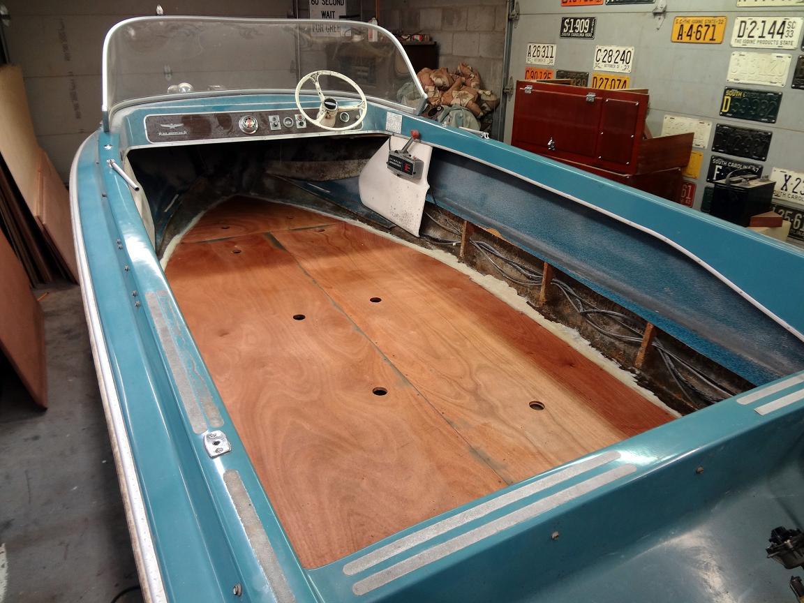

Hi guys, I'm a newcomer to the site. I have just finished restoring a '61 Alumacraft Torino (14') . My father won the boat in a 'sales' contest when it was new and it has been in the family ever since! I replaced the sole with 3/4" marine ply as I wanted no flex. I wanted to install the lounge seats with bolts coming up from underneath rather than lags from up above. First I cut and fit the sole feathering the edges about 6" to fit the angle of the bottom. Then I measured and positioned the seats where I wanted them and marked the bolt holes. I pulled the sole back out, drilled 1/4" holes from the top flipped it and countersunk and tapped in 3/8" machine bolts securing the last 3/4" with 4200 . Then I liberally coated with West System epoxy. The next step was to secure the sole to the boat with a thick coating of 5200 and covering it with marine carpet. Bolting in the seats was a breeze with studs, fender washers and nuts. I might add that I recently retired from 35 years as a yacht carpenter.
