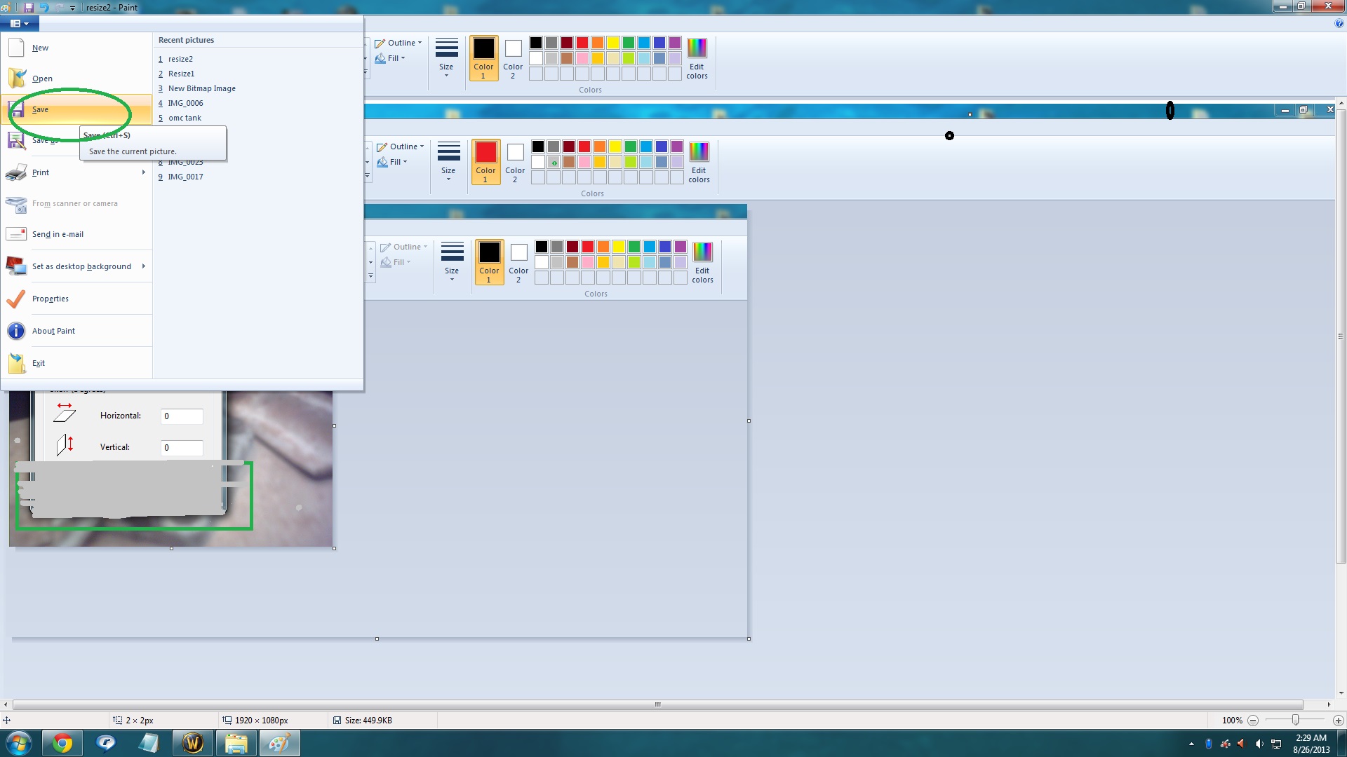

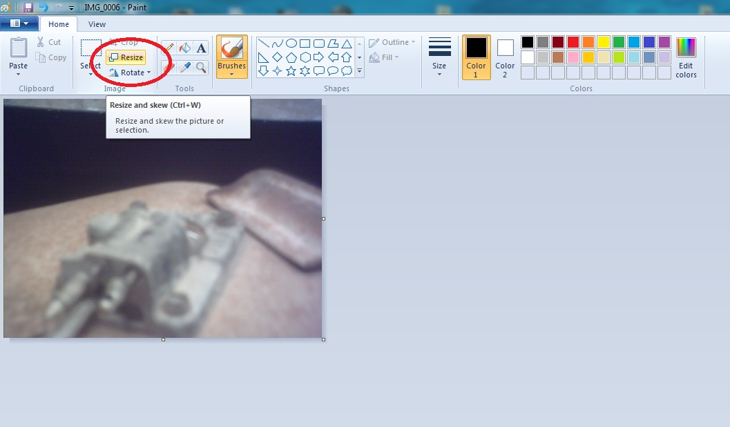

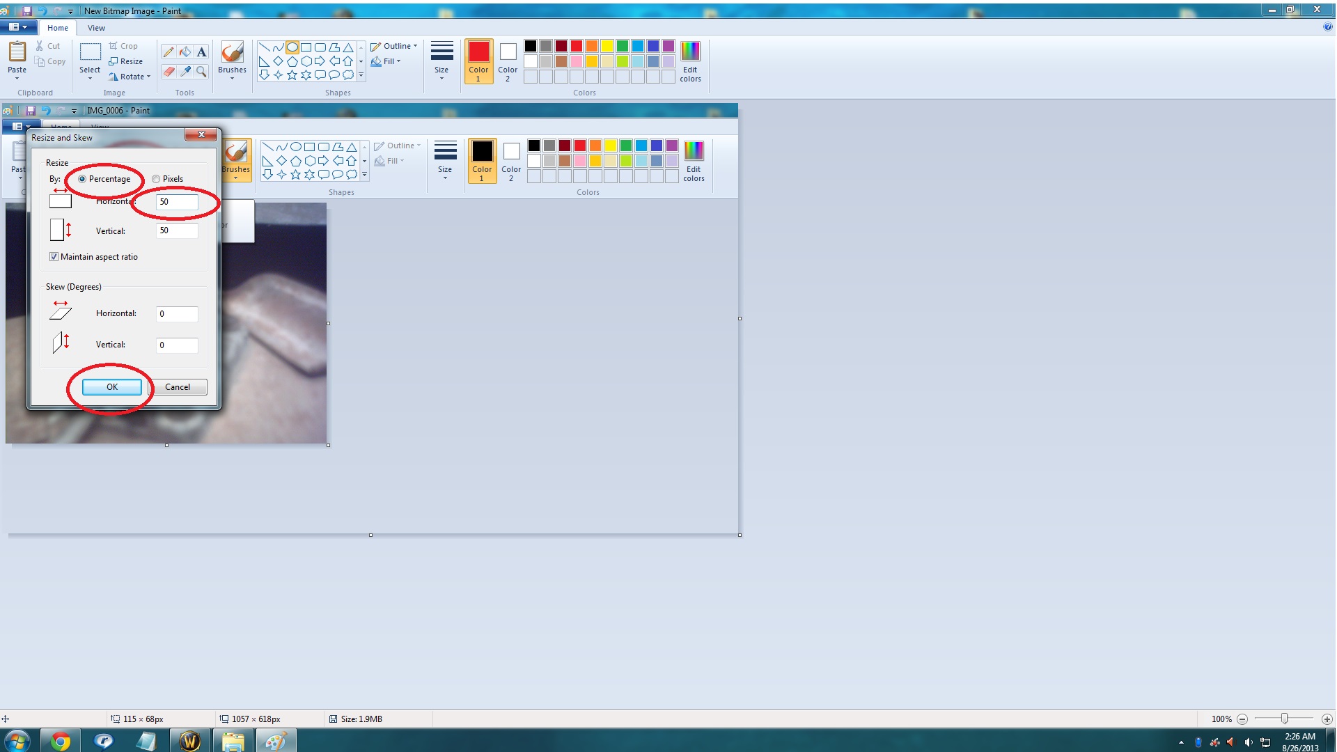

NVM / deleting my step by step resizing pictures post lol
