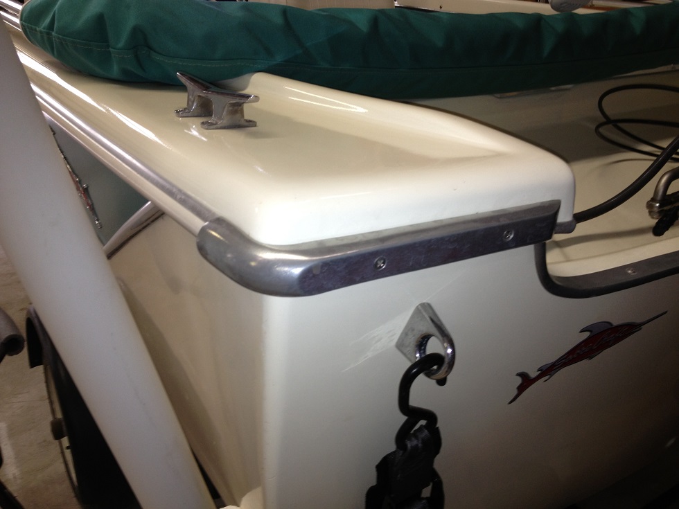

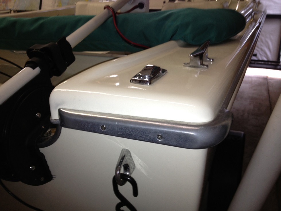

I have a 1968 Chrysler Charger 183 and I need a part. Below is the starboard side of the part I need for the port side. I emailed around and the only person that responded told me it was called a corner sating. I thought it was a rubrail corner. Any information is greatly appreciated!

I would suggest you get a machinist to make one. You may never find this part. If you do it probably won't be cheap so just have one made.

Actually, the one in the photo doesn't fit well at all and the sharp corner doesn't look very "boaty" which makes me think that someone already had that one made...slightly out of whack. They look like they'd be easy for any decent welding shop to fabricate...but have them make TWO. That way, they'll both fit properly, have rounded outside corners, have screw holes repositioned to hit a different spot and be a dead match.

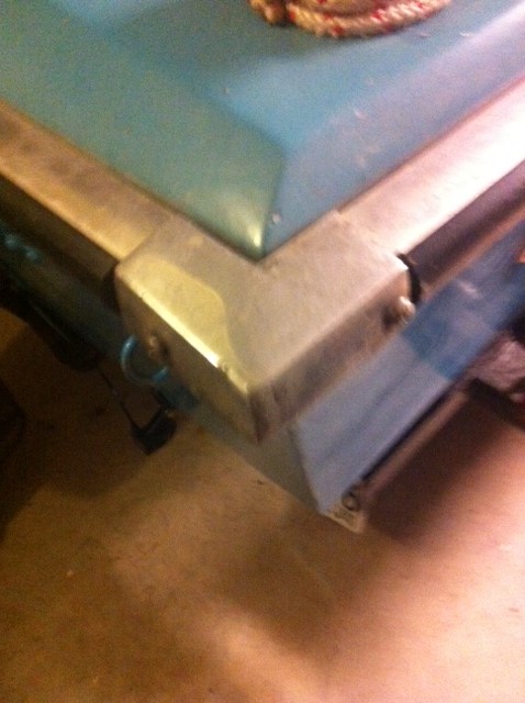

I'm going to suggest another way to approach this. I had the same problem with a missing trim piece on my Sabre Craft and I'm not good with metal work. So, I made one out of hardwood then covered that with a layer of 4 oz. fiberglass and epoxy resin. I then painted it with chrome paint. the results are not bad - the chrome paint being the weakest part of the project. But, if you can get by with a painted part, it works. Here is the result - the starboard part is wood, the port side is original metal (also painted so it would match).

That looks great! What type of wood did you use?

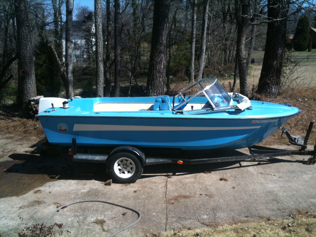

Here is a full picture of my boat.

Thanks, I used some very hard maple to make the trim piece. Just a lot of carving and sanding then glass it. I think it will be tough enough to do the job. Just wish chrome paint worked better.
Say, I don't want to hi-jack the thread, but can you say a bit about how that boat handles rough water? Say two foot chop and swells. There is one just like it on down the street that looks restorable. With that tri-hull and a lot of deadrise, I'm thinking it does very well in rough water.

To be honest I think the boat handles chop like a bath toy. That said I am on a relatively small lake (Lake Allatoona) and the only time there is serious waves is on holiday weekends. The boat was made in 1968 when there were not floating monstrosities with grown men over compensating for something driving them.
