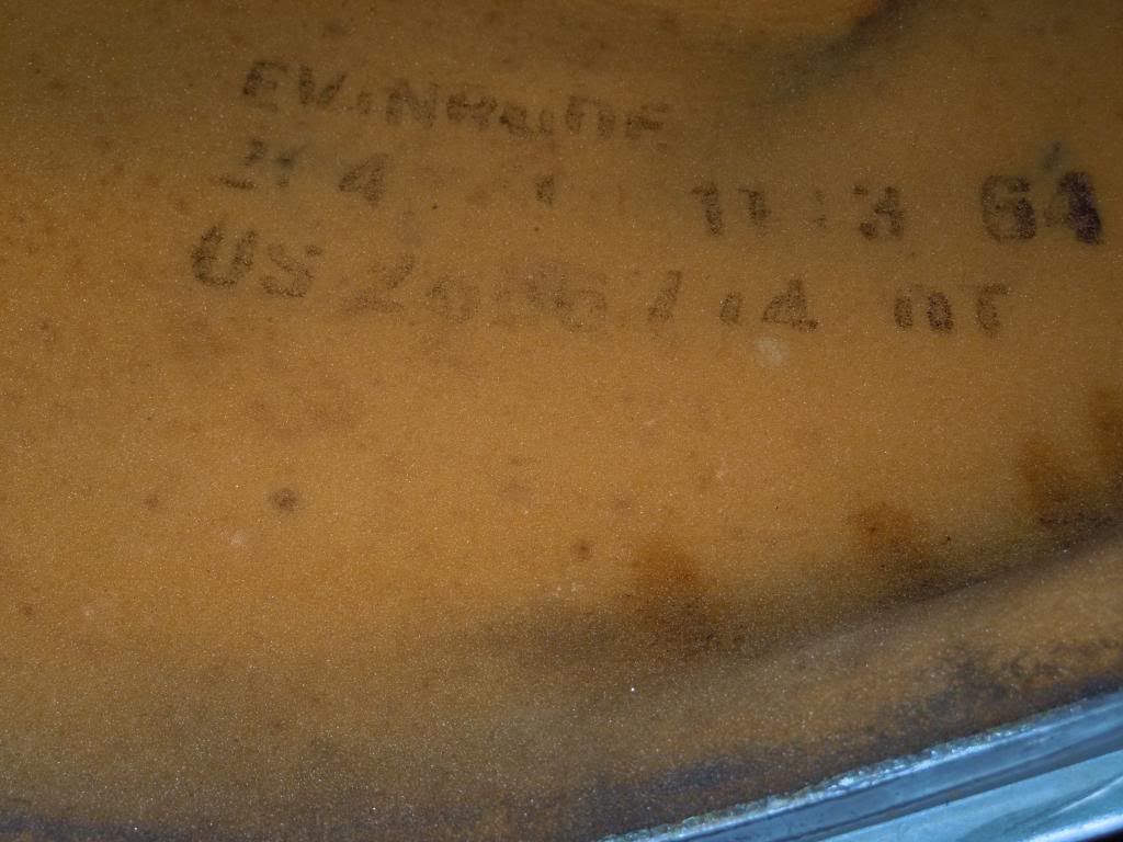

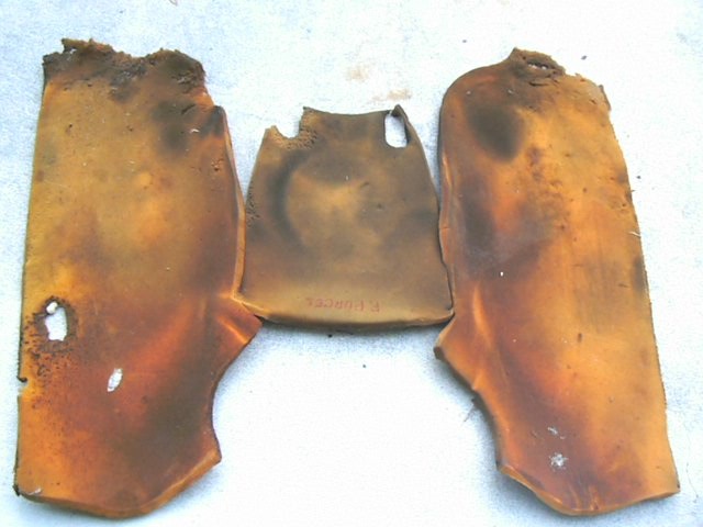

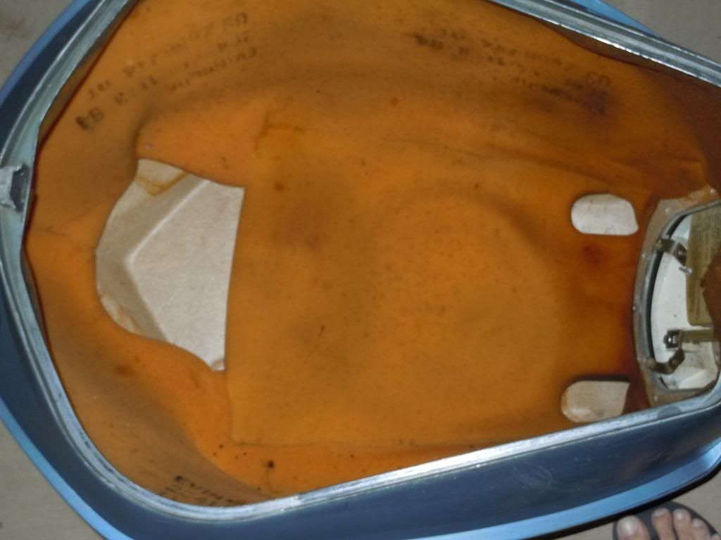

Ok so I thought I would post this in the main forum so I can get a general opinion from everyone. I don't believe Evinrude put this in from the factory and I know Mercury did have a sound deadening type insulation on it's wraps. here is what was in the cover of my 80 hp.
Do you think I can use that double sided foil insulation that you can around water heaters and ducting? It's actually only about maybe a quarter inch thick. Do you think it would work on the '61 800 Merc wrap I have?

Looks like factory to me Bob.

Why wouldn't 3/4" thick foam rubber from an upholstery shop work?

Hmmm, well I'll be darned, didn't figure it to be factory. I just figured the foiled stuff might last longer but if that foam is factory than it lasted pretty darned long so I guess it wouldn't hurt to use the same thing again. I know the Merc stuff has a kind of plastic over it's foam, almost like a plastic baggie with foam packed into it. I'm thinking that foil stuff might be better for the Merc wrap.

This subject came up a while back Bob, I believe someone expressed concern that the foil-faced stuff might hold too much heat inside endangering some of the electrical components. The hood/top cowl of my OMC had the same stuff you and Jim are showing, but it had deteriorated to the point it was "powdering" all over the motor so I removed it. I haven't replaced it yet, kinda getting used to hearing the old girl growl back there. ;)

hi bob,that is definatly factory foam,i have a couple of cowls with it in them,give me a call,ill see what shape they are in and get the foam out to you when im able to get away from home.john

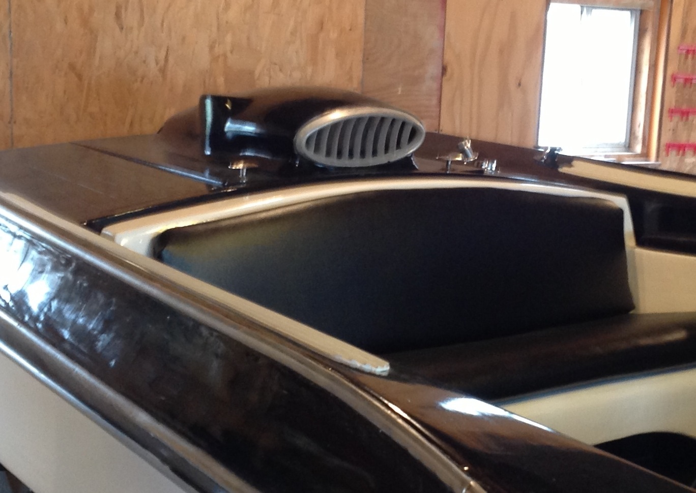

I have the same dilemma with my hydrodyne hood. It used to have fiberglass insulation that was foiled under the cowling and in the front. I am confident it needs something, because she is loud! I think I might try the water heater stuff. What do you think?

Wentworthto1 I think go for it since your original had foil coated then the water heater stuff should work just fine. of course that's just my opinion .
