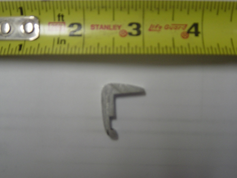

My boat is a 1959 Lake "N" Sea Arrowhead and I would guess is constructed the same as yours. I have what I call a flange joint. the top has a 5/8" flange and the bottom has the same flange. The top flange lies on the bottom on the bottom flange and they were stapled together. Then that joint was covered with the aluminum rub rail. (The last photo is the cross section of the rub rail.)

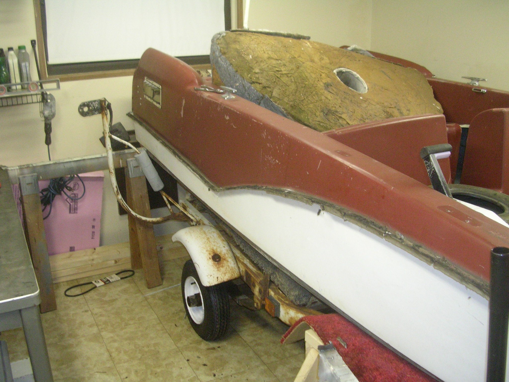

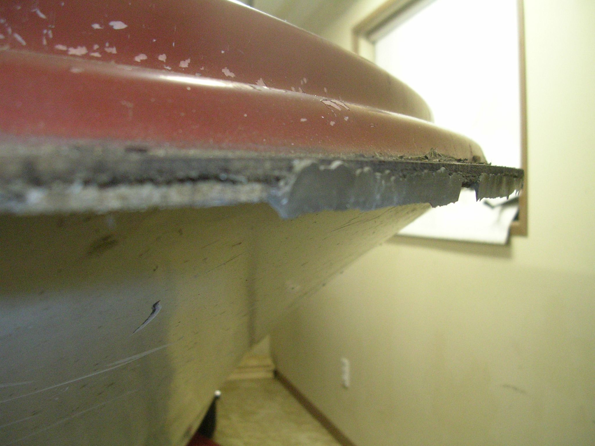

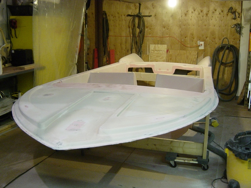

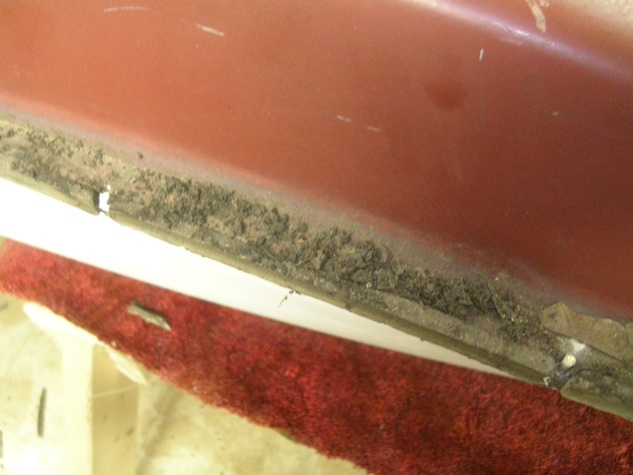

thanks for the pictures guys, it appears that I have a different setup than yours, my rail is fastened horizontally where as yours seems to pinch the 2 together and the fasteners go vertically. here are some pictures I've taken of my boat
I'm wondering if the hull follows the same shap as the deck making the two meet in the c channel that is formed
