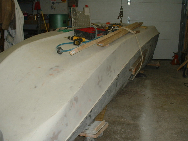

I have had to fight a few back together too. Put a two foot lenght of 2/4 on the side by the joint on both sides also a piece on the bottom of the boat each side. Then use a strong ratchet strap or a comealong. As you tighten up the strap it will push in the sides. You may need to use at least three or more of these straps. See Picture.
You also may need to get some flat six inch spats like the tappers use and also flat pry bars and a rubber mallet. Tighten, tap, and slide the bars and spatch. It will go. Oh it is a lot easier if you have at least two people.
Exactly what i had to do after hours of frustration getting mine back together.
