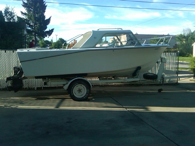

I recently bought a 1965 lee craft 18 viking sedan. The motor runs great and the boat is in very good condition. The Mercruiser controls and gauges all work and the tilt works fine. None of my panel switches worked so I was looking into it. I was stuck on a couple of weird issues. I had 12v at the switch to the wipers(two different switches left and right) and 12v to the bilge pump and 12 v to the blower in the engine compartment. As soon as I switch any one of them on my voltage goes to zero but I don't blow any fuses? I ran out of time and am thinking a ground issue. Any ideas are welcome.

That's a nice looking boat. I like the way the paint job makes it look finned.

I loved the look of the boat because it looks older than it is. The white that looks like the tailfin was originally a metal flake blue so it was a bit ugly. I love the color of your boat I have thought about a similar color combo on this one.
