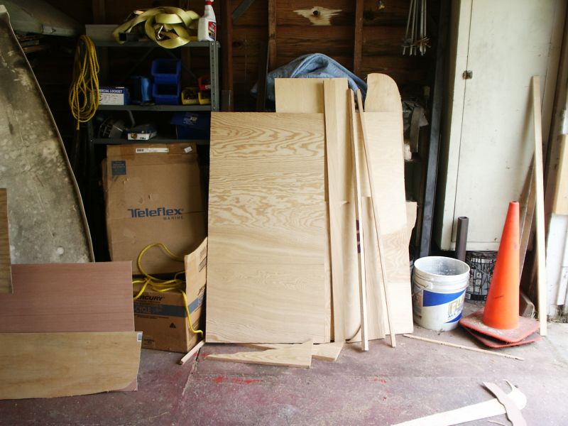

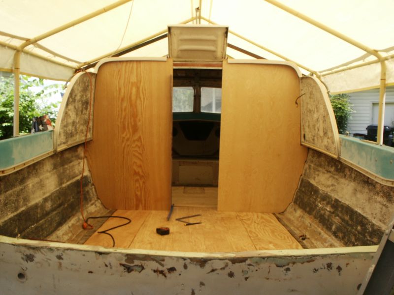

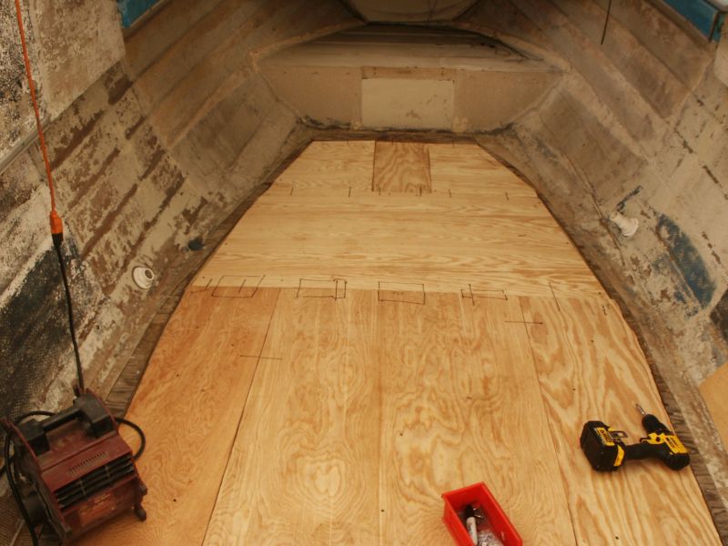

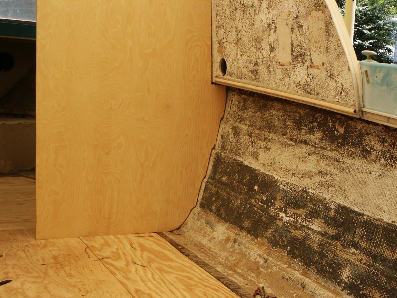

ok i am excited so i wanted to share . i got the floor the way i want it i wanted to add a little bit more under the floor for a deeper screw hold when i attach stuff, i got my 3/4 inch marine plywood and cut my two outer cabin walls out to see what i had left over in 3/4' then i made some fillers to go under the floor, in the process i decided to go ahead ad fit my walls . i took my compass and followed the slats in the hull and it worked pretty good. i am going to have to cut a window in the driver side to see the front of the boat through the cabin. I got the walls about where i wanted them. and i went back and laid my floor down and marked alignment tabs to fit it back one more time. so remove the floor resin the underside and i bought some stainless screws and bought my mat from a fiberglass guy and resin. 24 feet of mat and 3 gallons for resin 213.00 i think that is a good deal wait til the rain stops then go resin my floor. i wanted a picture of what 158 dollars worth of plywood looks like haha
Re: cabin walls and more flooring 11 years 11 months ago #80630
cap-n billybob,
LOOKS GRAND.
Re:cabin walls and more flooring 11 years 11 months ago #80637
The boat looks like it is coming along very well Billy!
Re:cabin walls and more flooring 11 years 11 months ago #80645
Excellent progress!!!!!!!!
Re:cabin walls and more flooring 11 years 11 months ago #80696
Your making the rest of us look bad. Great progress and it look real good.
